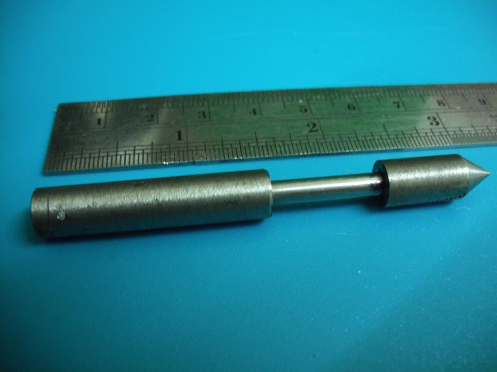

      Hi I've been searching for a device I've seen on various you tube channels. When tapping small sizes in the milling machine, people often use a spring loaded point which puts vertical load on the tap. Then with a small wrence they can turn the tap whilst the device pushes the tap into the hole. They look useful but can't find them anywhere on line. I wondered if anybody can point me in the right direction.

          Google spring tap guide you will be spoilt for choice
          #510943
          john halfpenny
            @johnhalfpenny52803
            RDG sell them, but easy to make
            #510949
            Nigel Graham 2
              @nigelgraham2
              I think ARC list them too.
              If you make one it's worth making the plunger double-ended and reversible, with a point at one end, a shallow centre-drilling the other. That so you can use it with taps that have a blunt point instead of centre-hole at the top, typical of small diameter taps.

                  Its main purpose is to keep the tap aligned, not to force the tap into the work. It may help start the thread, but that is all.
                  A tap wrench is the tool to use for screwing in the tap, not a “wrence’ (ordinary wrench, likely an adjustable spanner?). Use of the proper tool allows more than adequate pressure to be applied equally on both sides of the axis.

                    This is a double ended spring centre I made to use in my mini-mill. It has about 15mm of travel and you can fit either end in the drill chuck depending on whether you need a male or female centre. It's made from 8mm mild steel bar, although it could be scaled up for people with BIGGER machines.

                                  The important thing is to align and support the tap. In this way, the thread should be perpendicular to the work, and the Tap is less likely to break.
                                  Taps will stand a lot of cyclic torsional loads, but fail very quickly in bending. Sometimes, once is enough!
                                  My method, in the Mill, is to align / support the Tap with a spring tool, and to drive it with a Tap Wrench. As the travel of the spring support is used up, it is advanced to provide support, and prevent bending.
                                  In the lathe, my sliding Tailstock Tap Holder, using ER collets, provides both alignment and support.
                                  Should the Tap jam for any reason, the parallel shank slips within the collet, saving the Tap.
