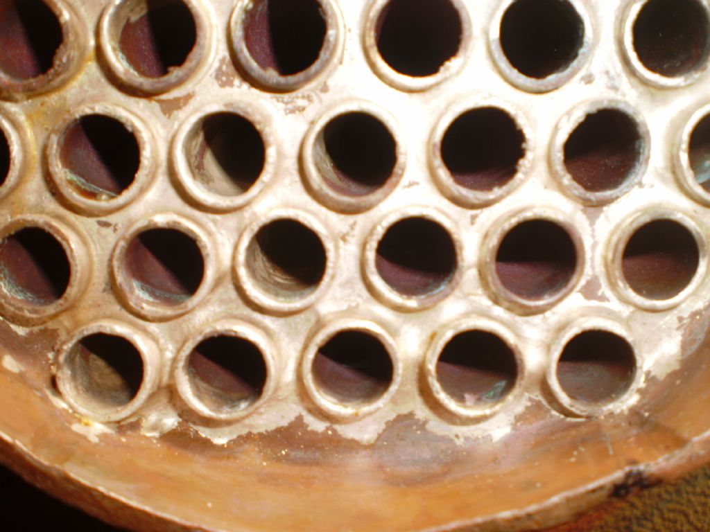

      Speedy Builder5
        @speedybuilder5
        Hi Roger, that's the problem of using millimeters !!! I used fractions and although it is close, the tubes do fit in using the measurements as given for the Firebox Tubeplate and dimension from 'Curleys' book. He states on page 31 (Smokebox Tubeplate) , that the centre line of the bottom tubes should be 5/8" from the outside of the TP flange. After that, the other dimensions are as sht 5. You may note from my photo that the outer bottom tube holes have 'grazed' the flange – It is close.
        Bob
        Smokebox Tubeplate

        Roger Froud
          @rogerfroud48738
          You've lost me there Bob, I convert everything to within a micron so it's the same dimension. It really is about time we finally changed to metric, I was a teenager when we went over to it, and I'm sure it puts a lot of young people off the hobby. Most of them don't know what an inch is, and why should they?
          I see where you've had to file away the flange on the bottom outside flues, just like my computer model shows. I don't see that as a big problem, it's just not ideal. I'll take a look at the dimension I've ended up with and compare that with the figure you've found. Quite why that's not on the drawing is a mystery. I notice that the Smokebox Tubeplate drawing is incorrect in as much as it doesn't show the forward facing flange in that view. It give the impression that there's more room than there is.
          Anyway, it can clearly all be made to fit one way or another, and if moving the tubes very slightly makes it easier to braze up then I'll probably do that. I'm not looking to change things unnecessarily, but I have the opportunity to do these things so I may as well if it helps. I see that some builders have added more stays to the backhead and I'll do that too.

            Hi Roger,
            You could leave out those two outer tubes on the bottom row if necessary. The Speedy boiler has plenty of gas area through the tubes compared to the grate area and you could afford to lose a bit without affecting the steaming of the boiler.

            Roger Froud
              @rogerfroud48738
              That's an interesting thought, I'll chew that one over John.

                Roger Froud
                  @rogerfroud48738
                  Thanks Bob. I presume the diameter of the smoke box needs to be slightly increased if it's going to look right.
                  I'm having an absolute nightmare trying to create a 3D computer model to verify the drawings. Whichever way I look at it, things simply don't add up. The drawing for the smokebox tubeplate states 4-3/4" diameter which is clearly wrong. I can see that he was probably thinking that the boiler at that point was 1/8" thick when in fact it's 3/32" or 2.5mm (13 gauge)
                  It also looks like he's callculated the heignt of the crown stays or the height of the firebox from the sectional view omitting the inner flange of the firebox tubeplate. Either way, it's never going to fit if it's made to the drawing unless I've made an error.
                  How far have you got? What did you have to change to make it all fit if at all?

                    Roger Froud
                      @rogerfroud48738
                      So how much tweaking did you have to do to make it all fit? It looks to me like the tubes can't be parallel to the bottom of the boiler but slope slightly upwards…. no bad thing. Several of the tubes in the firebox tubeplate also graze the edge of the flange if it's drawn precisely to the dimensions.
                      What diameter did you make the smokebox tubeplate? 4-3/4" isn't consistent with the 5" outside diameter at that end.

                        Roger Froud
                          @rogerfroud48738
                          Ok, I've just fitted two 5/16" tubes there, keeping the same clearance as the others to the inboard tube. This works really well from a clearance point of view and means a loss of around 3% in surface area, This is what I'm probably going to go with unless there's a compelling reason not to.

                          John Baguley
                            @johnbaguley78655
                            Hi Roger,
                            Some years ago I devised a spreadsheet for calculating boiler parameters e.g. tube area, grate area etc. I put the dimensions of a lot of boilers into it to see how they compared. I got the tube area for Speedy to be 19.1% of the grate area with 31 tubes, making the assumption that the area through the superheater tubes would be approximately the same as the fire tubes after taking into account the reduction in area caused by the superheater elements (The actual area through the superheater flues may be more than that if you actually work it out). Reducing the tube count by two to 29 gives me an area of 17.9% of the grate area, a reduction of only 1.2%? Maybe I've got something wrong.
                            I try and aim for a figure of about 15% for tube area versus grate area but in many boiler designs that is impossible to achieve.
                            Incidently, in the 'Words and Music' in English Mechanics LBSC says to make the boiler barrel from 10swg or 1/8". That would explain the 4-3/4" diameter for the front tubeplate.

                            Roger Froud
                              @rogerfroud48738
                              Hi John,
                              That certainly explains the difference in the difference in the smokebox tubeplate. It's tempting to follow suit and make it out of 1/8" copper, after all, the outer firebox wrapper is 1/8".
                              I think your calculations may be wrong on the reduction. I estimated that the equivalent are of the 5 large tubes to be 8.5 small ones from the ratio of their circumferences. That gives a reductions of 2 / 34.5 x 100 = 5.8% approx.
                              Maybe I'm missing something. Obviously your spreadsheet is more sophisticated because you must be using the surface area.
                              Anyway, fitting two 5/16% tubes is such a neat way to get round the mechanical difficulties that I think it's the way ahead. Everything clears nicely and it isn't a struggle any more.
