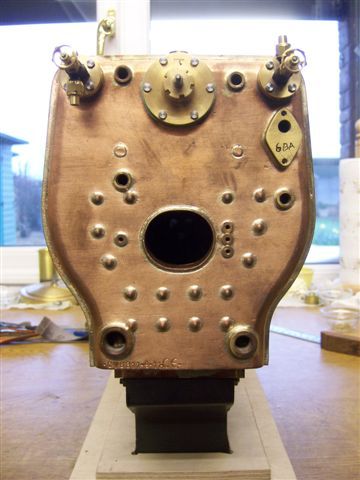

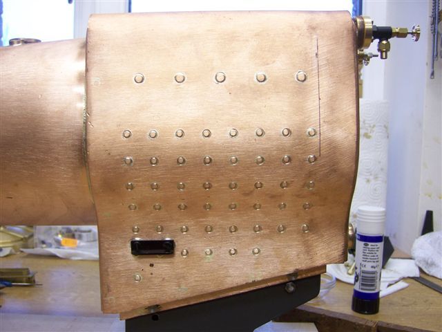

                                          Speedy Builder5
                                            @speedybuilder5
                                            You may be interested in the attached photos, I am sure the owner of them would not mind me publishing them here. The new stays were placed here by a boiler manufacturer.
                                            A really nice job !
                                            BobH
                                            #122409
                                            DMB
                                              @dmb
                                              Thats a nice touch – bush stamped with thread used – no guessing etc
                                              Edited By DMB on 16/06/2013 12:27:05
