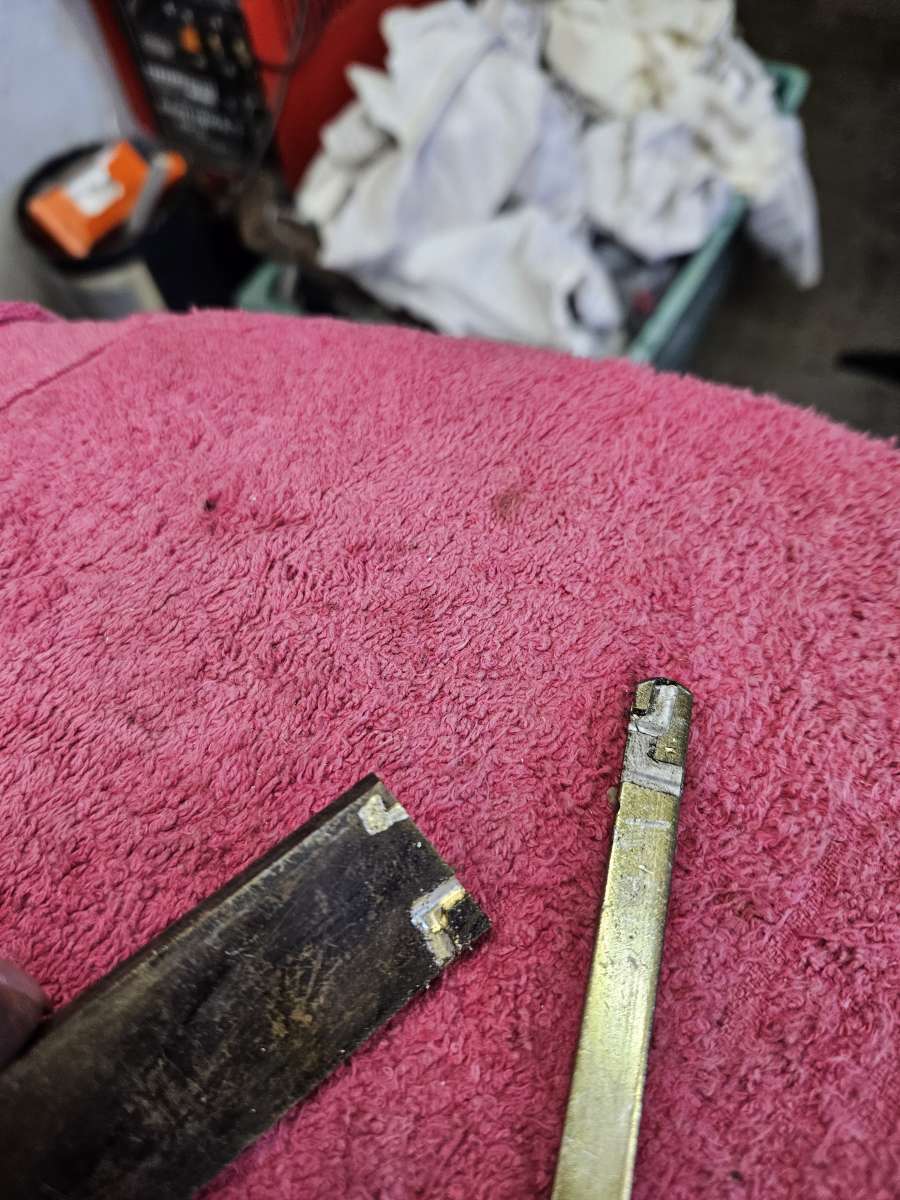

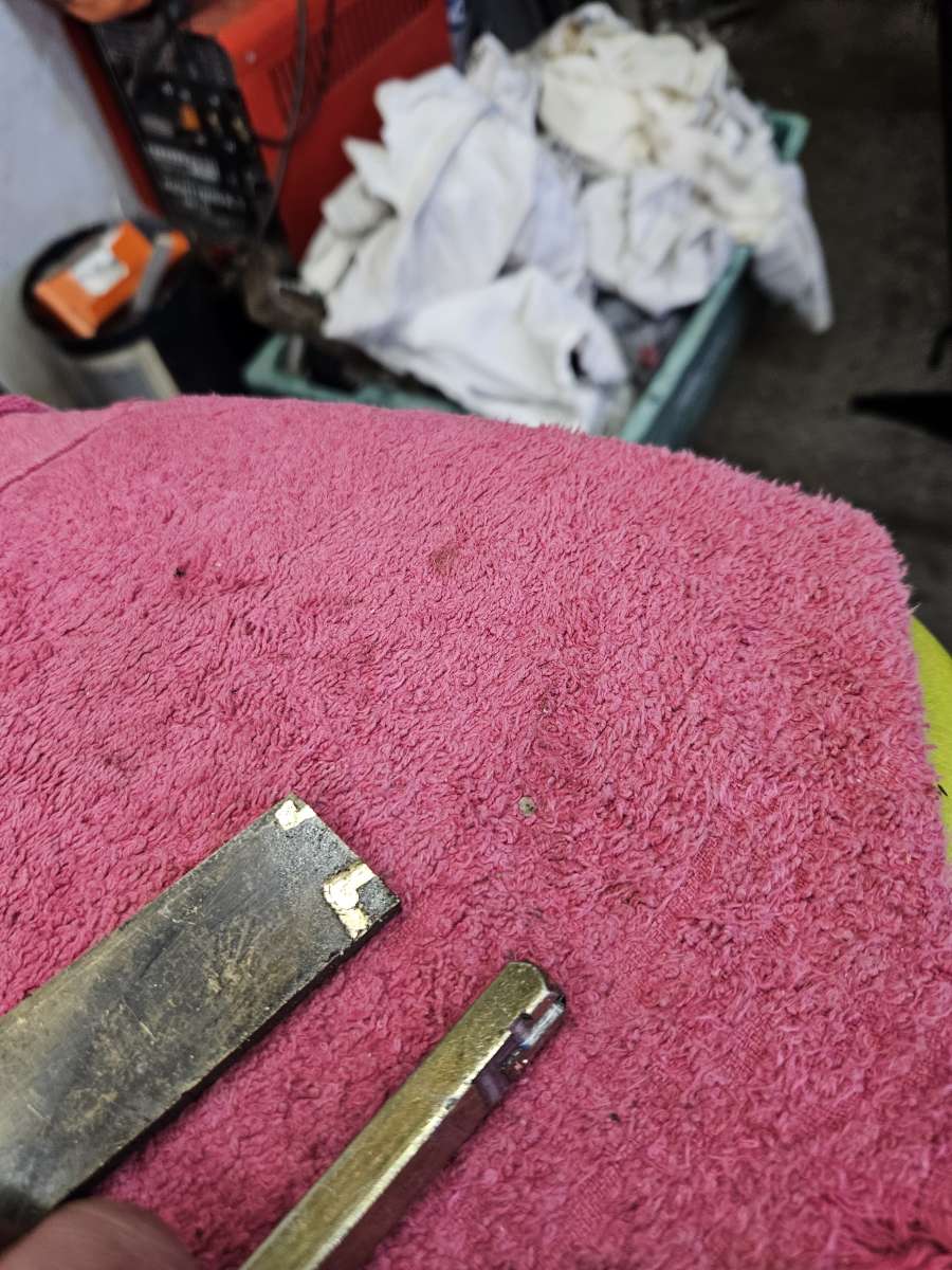

      Parting-off
      I have never had any real success with this, so I tried using the tool upside-down behind the workpiece. I managed to part off a length of 8mm (approx) aluminium and a length of 1/2″ (ish) brass with relative ease. The tool needs thinning a little more and was not as sharp as it could be.

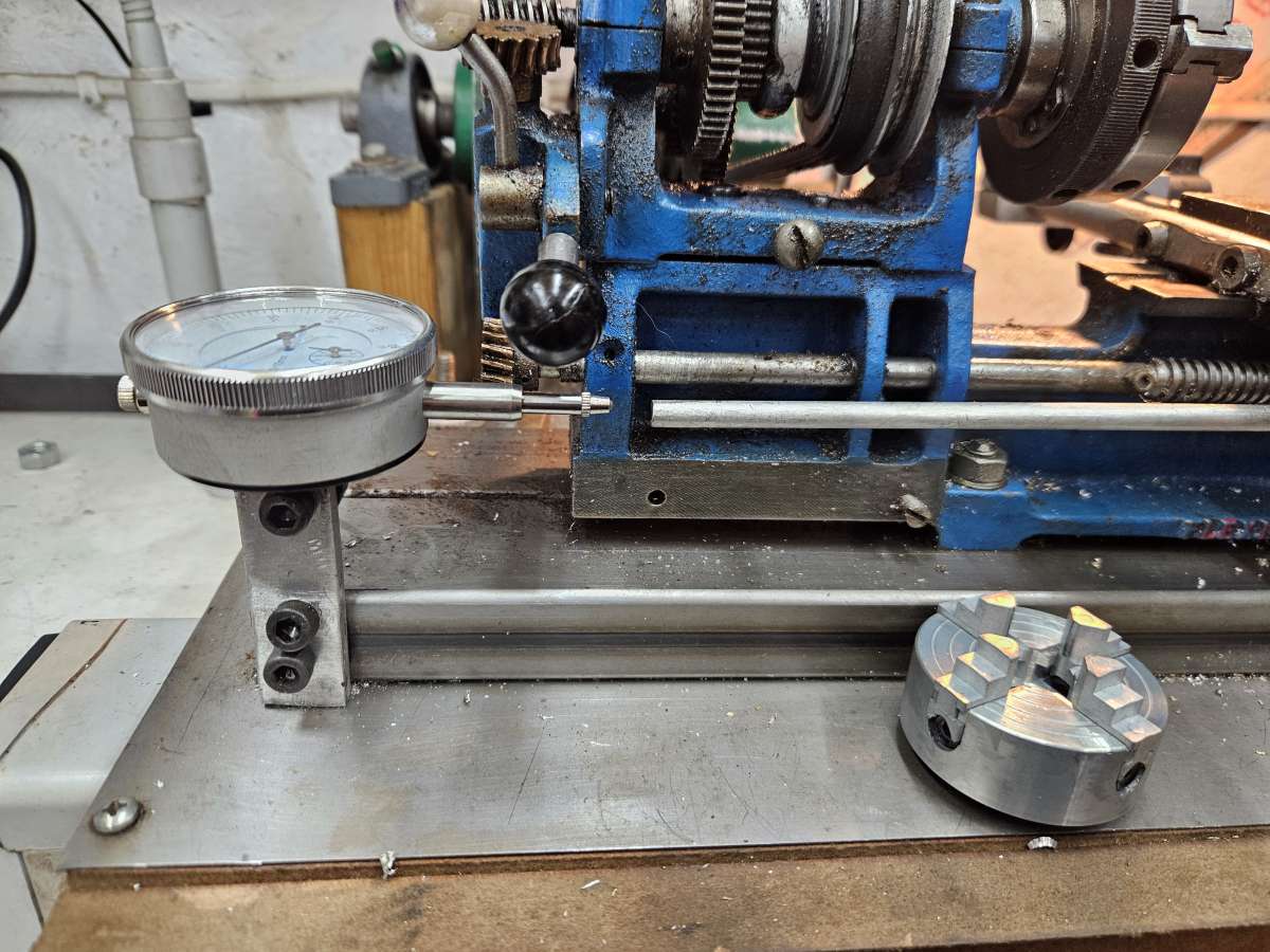

                        Ages ago, I attached a dial indicator so that I could accurately measure the depth of cut. Today, I finally got around to fitting on so that I could measure the last 1cm of the length of cut.

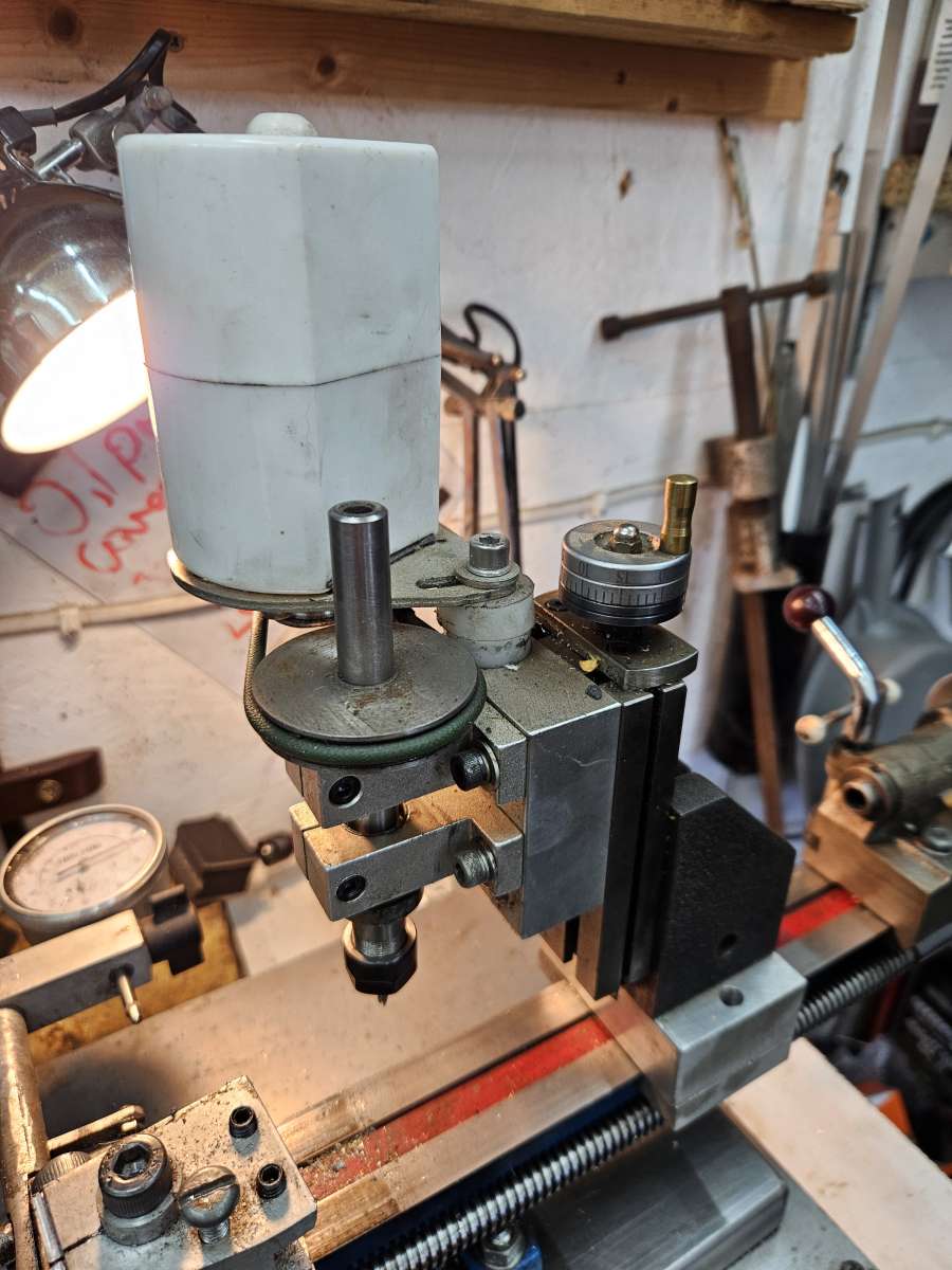

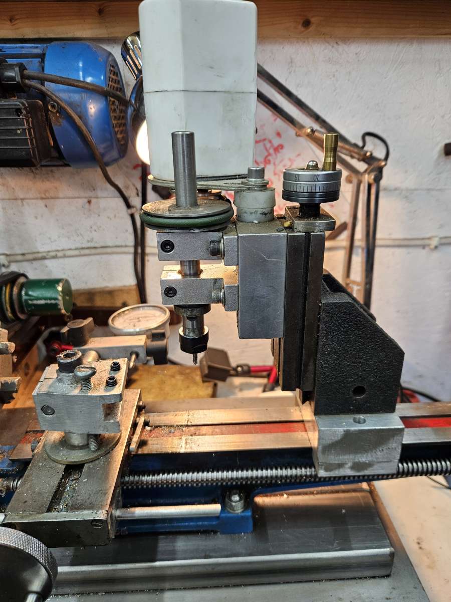

                        I also, finally, tested a milling spindle that I constructed. As anticipated, the motor’s power is a bit low, but it successfully milled some steel, brass and aluminium. It was slow going, but worked. The finish is a bit rough as support for the metal was marginal at best.

                                  Your two milling samples are of the worst quality metal you can get. Real work will be much better finished.
                                  Perhaps take a look at the leverage on the cross slide in your design, the motor will amplify any cutting vibration.
                                  #839104
                                  Nigel Graham 2
                                    @nigelgraham2
                                    Neat milling-spindle design.
                                    How did you hold your milling samples?
                                    In the tool-post, as the illustrations of the milling-spindle imply?
                                    If so I suggest making a milling-table that fits the cross-slide in place of the tool-holder, with either Tee-slots or a matrix of tapped holes, and provided with suitable clamps.
                                    It would be much more rigid, and give more headroom under the cutter – the corollary being deeper engagement of the spndle body and vertical-slide for lower-profile work, making that area more rigid.
                                    (The obvious disadvantage of using holes, offset to some extent by arranging some sort of covers, is they and their threads trapping swarf.)
                                    To secure the milling-table to the cross-slide, if I am right that the central channel is a broad Tee-slot, I’d use at least three generously-length T-nuts whose upstands fit the channel snugly, and take socket-head screws counterbored into the table. Ensure the screws cannot pass through the T-nuts and act on the base of the T-slot, as that would be a recipe for disaster by breaking the slot’s flanges.

                                      The steel was awful quality, although the brass is a bit better. They both happened to be to hand. As you say, all being well, the quality should be better with decent metal.
                                      Nigel:
                                      Yes: I did hold the metal in the tool post, simply for expediency of testing. It is also why I used the metal that I did: it fitted. The overhang on both pieces was extreme and I am surprised that it cut even half as well as it did.
                                      Thank you for the suggestions on ways to hold work in future. These are useful and I shall look into them. I shall also look out for a small vice.
