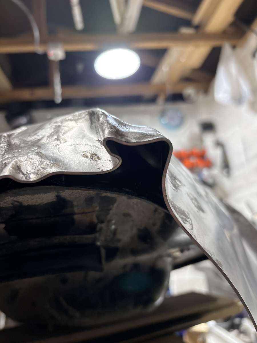

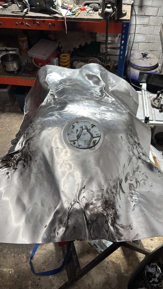

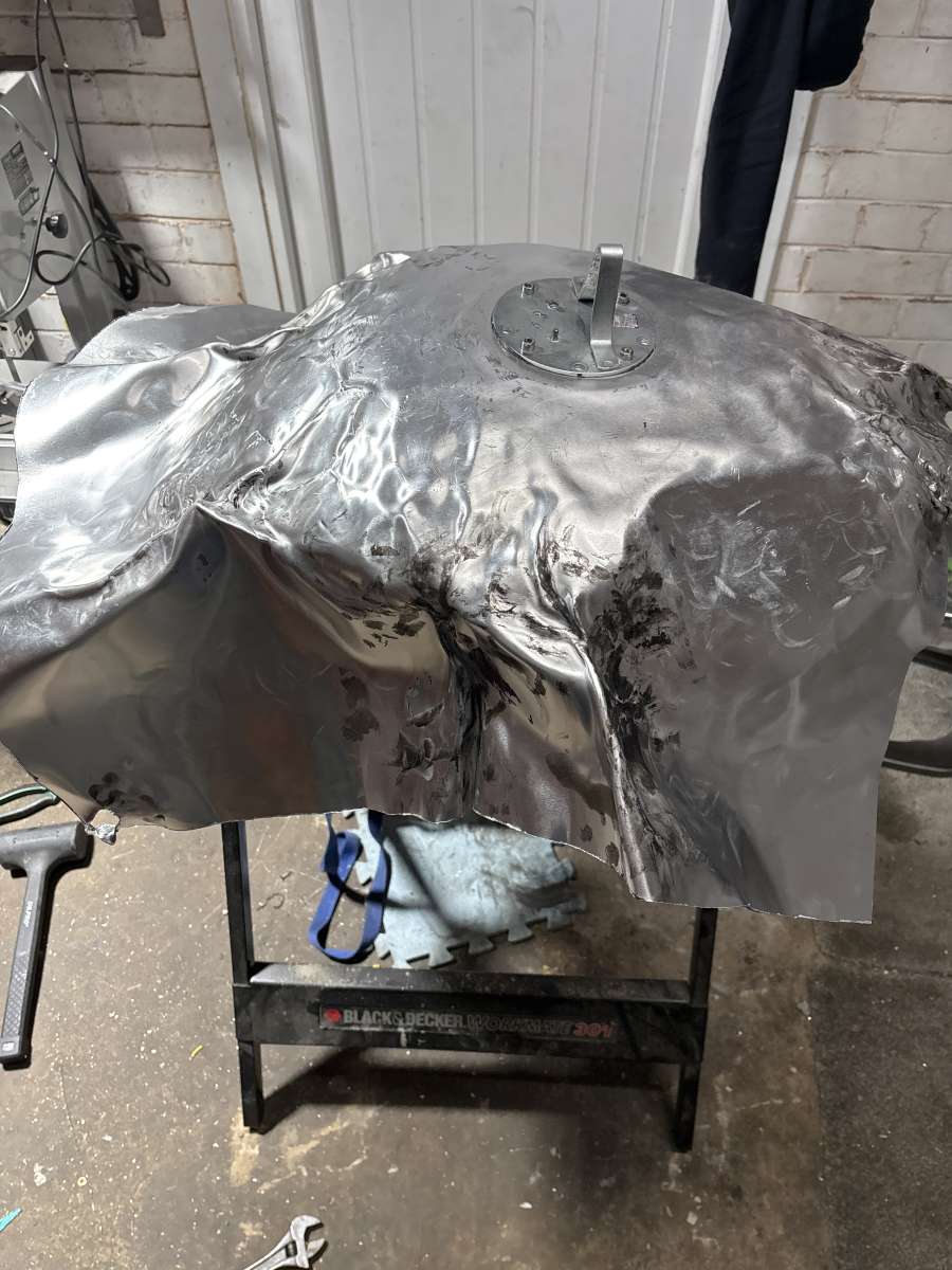

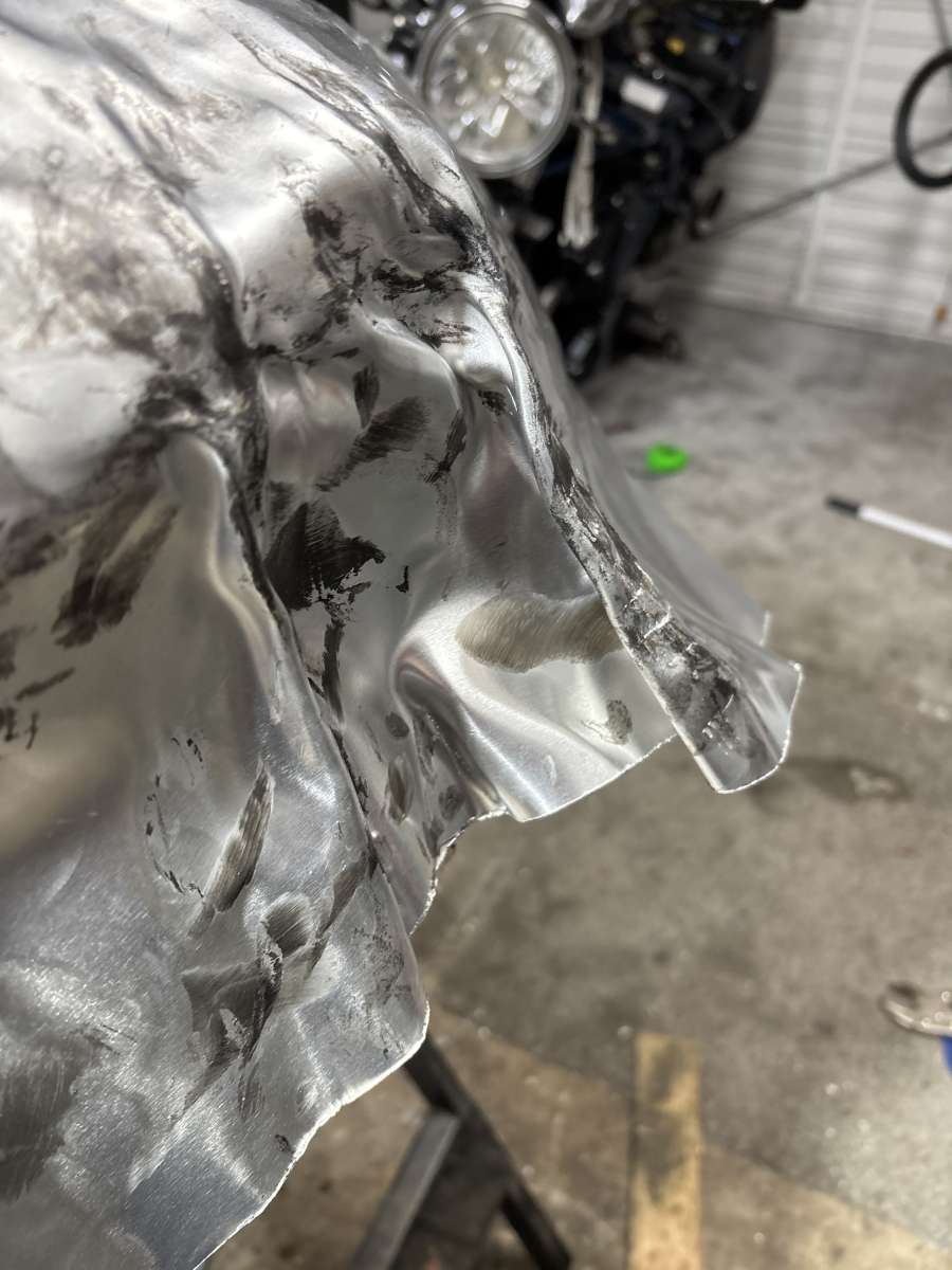

      I appreciate model engineer might not be quite the correct place for this post because this is nothing to do with model engineering, it’s a motorcycle tank but here goes.
      Does anyone have any experience with sheet metal shaping/panel beating? I am attempting to make a fuel tank using 1.5mm 1050 aluminium hammered around an old tank filled with concrete. This approach was suggested to me by a respected local fabricator. Basically I heat with a blow torch and hammer with dead drop hammers or a planishing hammer for more intricate areas.
      It started off ok however I’ve reached the point where I have large folds of metal I don’t know what to do with. I’ve read I should ‘tuck’ them but if I’m honest I don’t really know what this is. I have another sheet of aluminium I could use if I need to start again but the problem I now have is my hammering has actually dented the underlying tank. Anyway here’s where I’ve got:
      A8852500-7DA6-4D51-87B4-9BE558E06B40IMG_87FE7BC2-45D7-4F6E-9185-B6F848A611FEIMG_81B78DE4-8D44-4CEA-9A6F-B80B21A4806D
      IMG_97B6ED10-0D0A-431A-B2C2-2B598AFB2CD3
      The black areas are just rubber off the hammed. Any advice or comments welcome
      regards
      Dan

        First you don’t want to use the original as a former – you need to make a solid wood mould to hammer on or, more skilfully roll and hammer off the mould until nearly there. Some shapes are better hammered from the inside.
        The starting sheet needs to be only just larger than the final item, perhaps needing to be an odd shape. It will stretch anyway. The ‘extra’ you have is a problem to fold out of the way.
        Gradually as you form it before the excess gets out of control, you can either use a ‘shrinking tool’ in a press or very skilled workers can do it with a special hammer with a rough surface.
        If the extra gets significant it can be cut out and welded shut.

          Thanks for your reply. It did occur to me that I should trim the sheet but I had no idea how to calculate what the 2d shape should be on the flat sheet. Also how would a rough faced hammer work 🤔

            Hi Daniel, As above, a REAL panel beater would use special tools but for us meer mortals cutting out a section and then welding the 2 edges together is easier IF you can aluminium weld. Regular annealing may help ? For getting a development of the shape first start with a large sheet of paper or light card and fold it over the pattern tank cutting as needed. Good luck. Noel.

                A shrinking hammer has a cross hatch pattern on the face. When the metal is struck some goes into the hatch.
                You use you wrist to work the hammer not the whole arm
                Have you got the right grade of Ally plate?

                  There is a LOT more to it than beating a flat sheet around a former. Some of those folds you have will need more than shrinking. Probably cutting and welding. You might get away with a tucking tool, maybe.
                  A domed wooden or plastic mallet and a leather sand bag is pretty much essential for petrol tank work too.
                  And an English wheel is right handy for smoothing out the hammer bumps.
                  Rather than an original tank, many pros make a wooden buck then use mallet and sandbag, mallet and formers etc etc to shape the metal to fit the buck.
