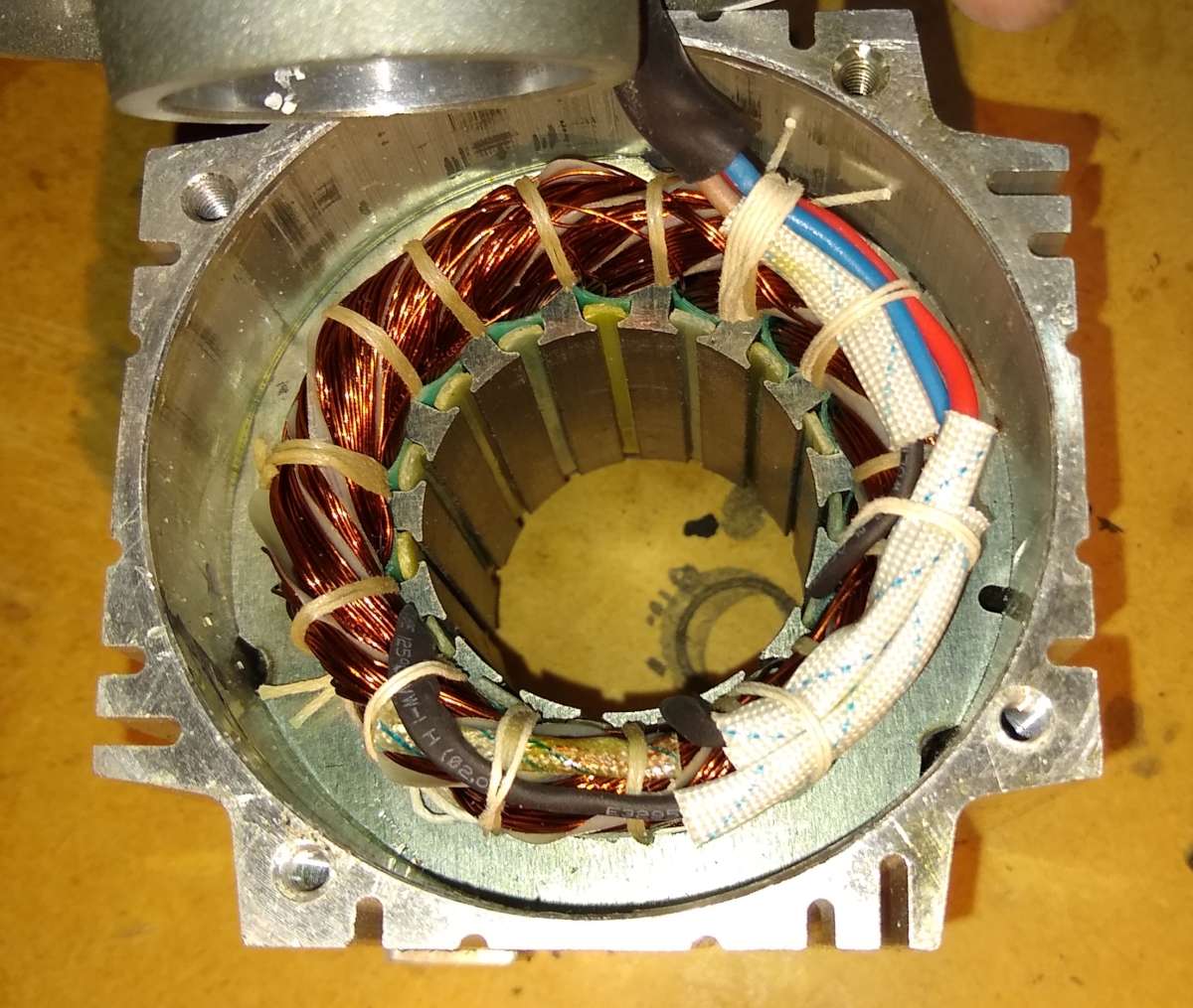

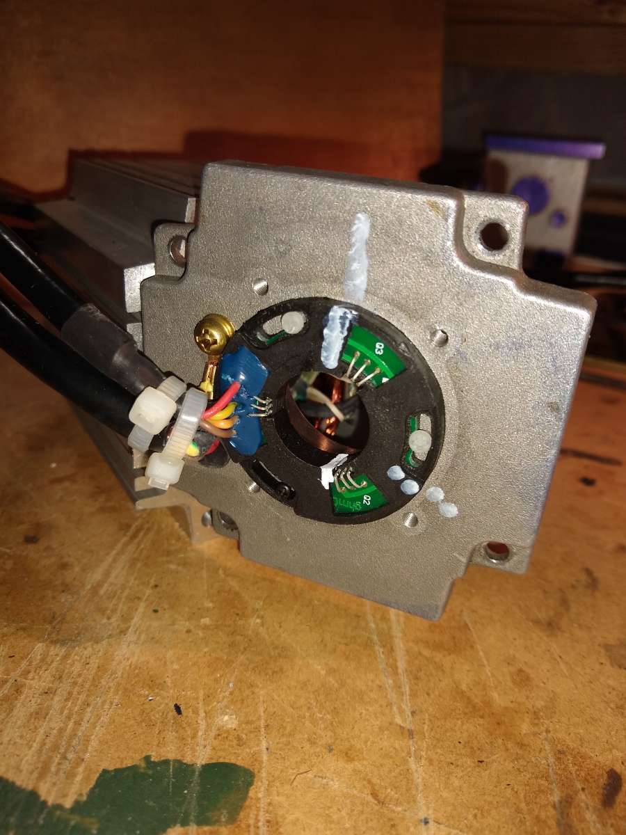

                  Below – The top of the motor showing a small circuit board with FETs and Hall sensors? I haven’t (yet) extracted this since it seems potted. It looks like the board can be slightly rotated to find the optimum position for the Hall sensors in relation to the windings?
                  1 motor 1

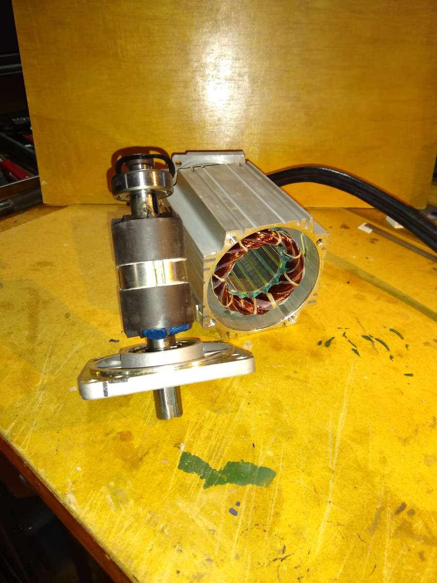

                  Below – The case + windings next to the rotating shaft. The shaft magnets are strong and took a decent (careful) tug to get the shaft out.
                  1a motor 1

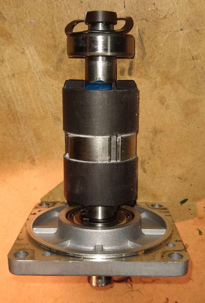

                  Below – The shaft assembly – magnets, bearings (they run smooth) etc. There appears to be some blue plastic material added, I guess for balancing.
                  1b motor 1

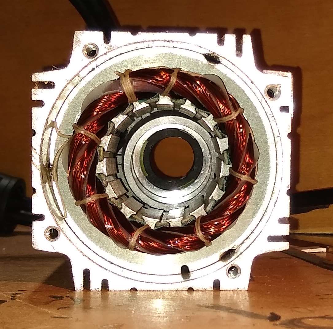

                  Below – A close-up view of where the cables are attached to the windings.
                  2 motor 1

                  Nothing seemed out of order anywhere in the motor, but I am no expert on these matters. I believe there may be 3x bimetallic sensors embedded in each motor winding to sense over-temperature conditions. Or perhaps the sensors are of the Thermistor or Silicon sensor type? I suspect the clicking I heard was a relay in the main control board being activated by a sensor in the motor.
                  The other thought was that perhaps one of the FETs or Hall sensors was failing.
