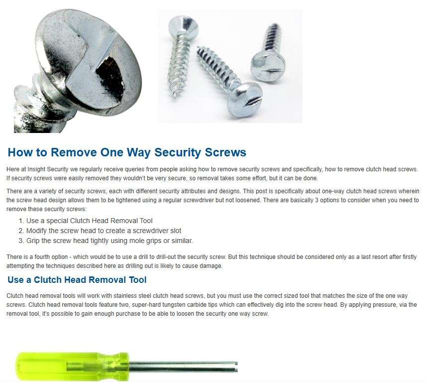

          On noel shelley Said:
          The type of screw shown is NOT intended to be removed and I doubt there is a removal tool that will work well. Some types are intended to be removed for repair BUT NOT by Joe public and special tools are available BUT NOT THIS TYPE ! Good luck and devious means. Noel.
          They do make removers for this type of screw, search “clutch head screw remover” Though they are silly money and probably easier to get a new lead.
          remover

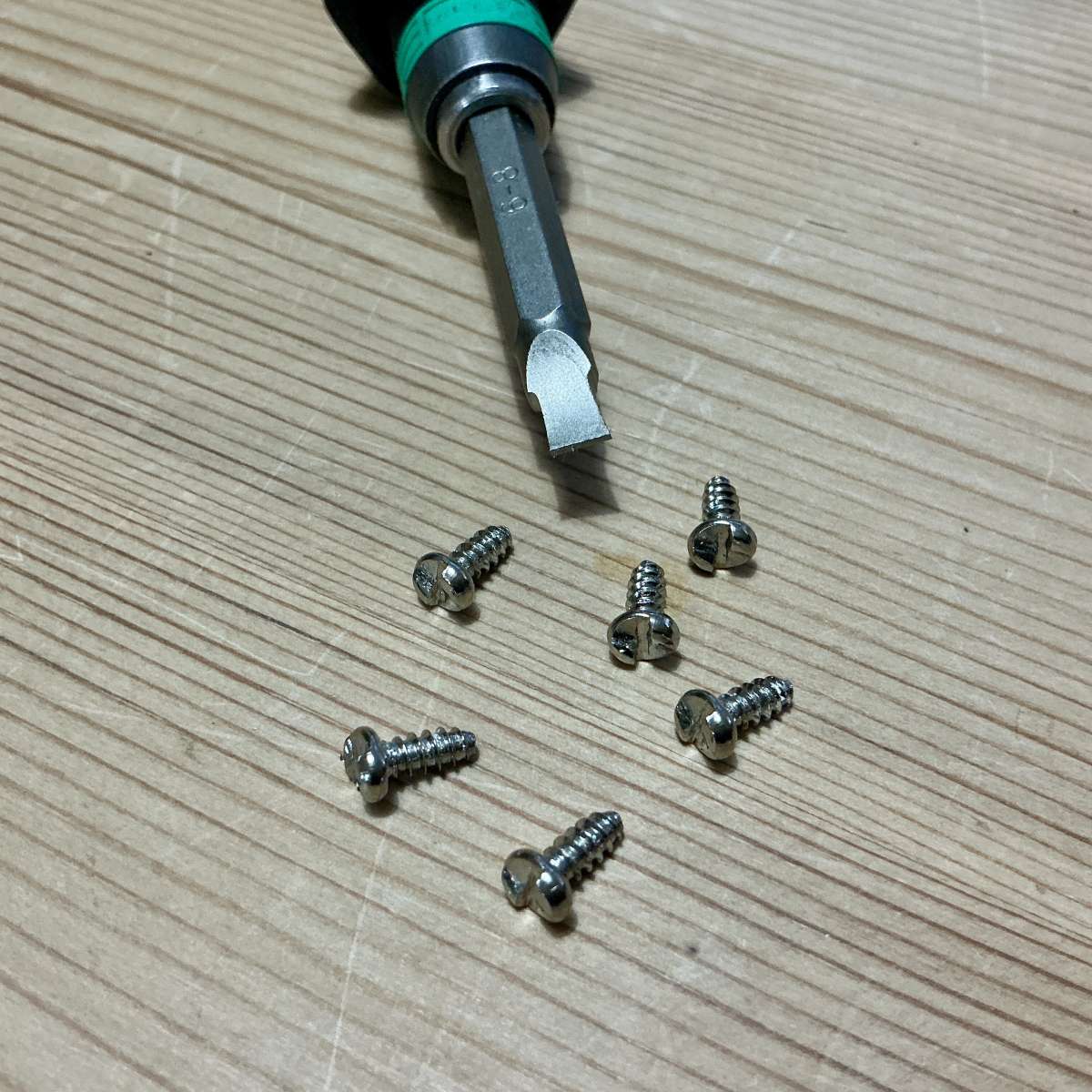

                        On Grindstone Cowboy Said:
                        Grind a screwdriver so the end has nice sharp edges, and apply a lot of downward pressure. Turn slowly. Better than even chance it’ll bite into the screw enough to loosen it.
                        Rob
                        Thanks again Rob, you’re a genius. I should have thought of this myself 😆 Job done. I splashed out on 25p worth of 1/4” drive slot bit and ground it to size.
                        Hopefully those screw extractors I ordered from Amazon will come in handy one day. 😂
                        IMG_6665
