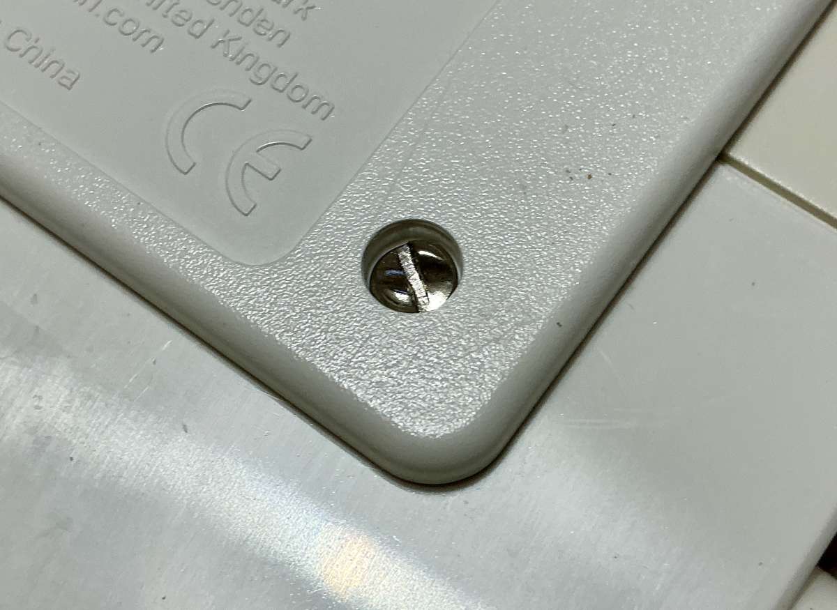

      Have any of you successfully removed screws like this without damaging the surrounding material? It’s a Belkin six way extension that I’d like to fit a slightly longer cable to.
      Hard to photograph, but they can be screwed in with a standard slotted screwdriver, but can’t be removed due to the shape of the head.

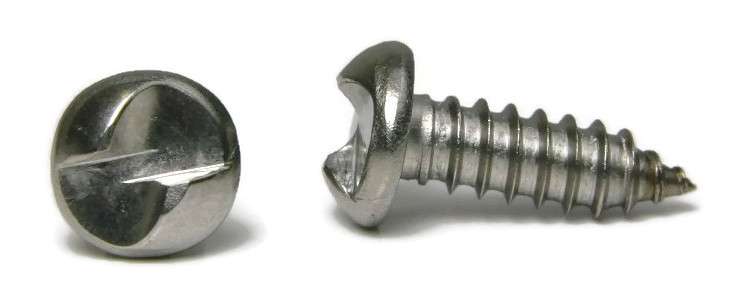

        This is the type.

        #827346
          You can sometimes drive them round with a sharp dot punch at the bottom of the ramped part

              I have had this problem, the solution is simple. Silver solder a U shaped piece of steel onto a standard screwdriver. I have plenty of old screwdrivers and this solves the problem.

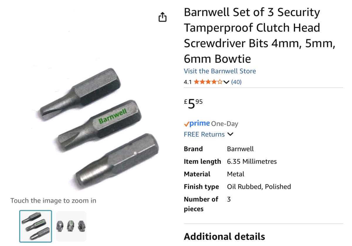

                        On Trevor Drabble 1 Said:
                        Also , try searching Clutch Head Removal Tool , and example of which is the CTA Tools 8752 4 piece set on Amazon
                        Would these do?
                        Edit: I realised I have some of these bits. Just tried them and no dice.

                                The one I linked earlier won’t work for me if it requires the collar. If you look at the image in my OP you can see the screws are recessed. The screw heads themselves are quite small, only about 5mm across.

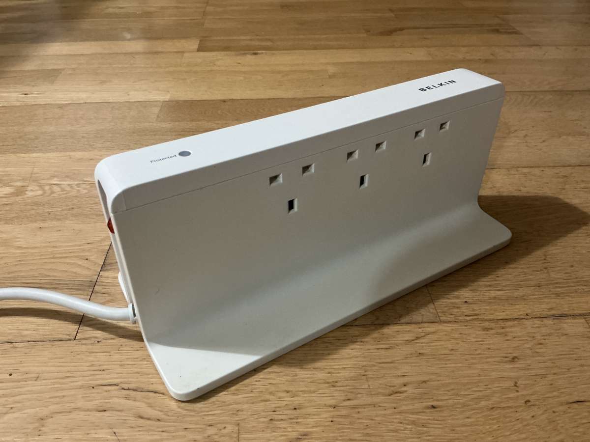

                                        This particular six way extension lead has been very useful, being able to accommodate plugs many others can’t. The form factor has also been a big plus for me. It hasn’t been made for some years and appears to be of good quality. Sadly the 2 metre lead is too short for its next tour of duty.

                                            Grind a screwdriver so the end has nice sharp edges, and apply a lot of downward pressure. Turn slowly. Better than even chance it’ll bite into the screw enough to loosen it.

                                                  This is a non-rewireable extension lead. By law in the UK they are designed to be non openable. Even if you get it open there is likey no way to connect a new cable in a manner the retains the safety and relibility of the original. It should not be re-wired
                                                  Why not fit an IEC 60320 C14 “kettle” / “PC” male connector to the existing lead and use a standard C13 power lead plugged into that?  There are also ready made C13/C14 leads that can be used as  extensions. Depending on the lead used this could reduce the maximum load to 5A but thai is not an issue for IT type equiment.
                                                    Rob
                                                    Probably the best suggestion so far, I think there’s some merit it this, thanks.
