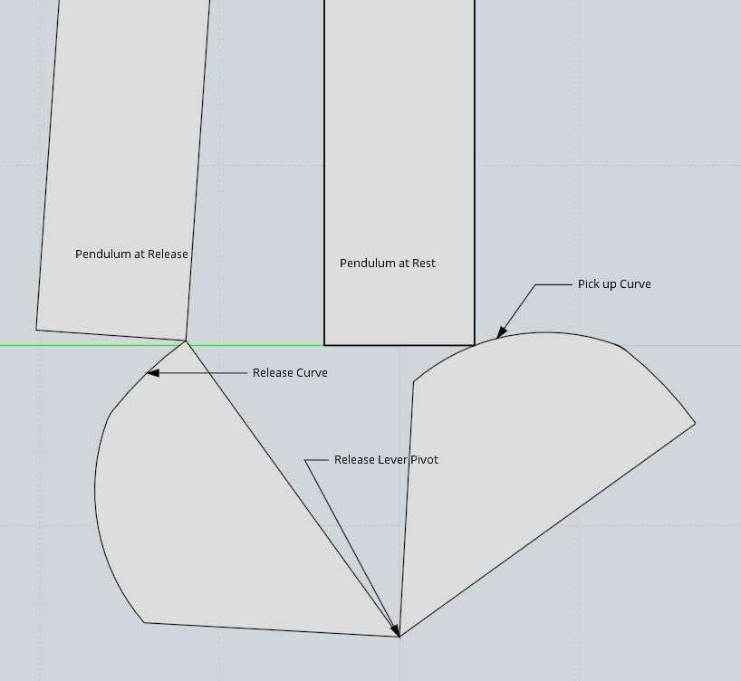

            Peter Cook 6
              @petercook6
              How precise do you want it? John H’s  suggestion is OK, but you would need to be careful that the release pin did not impart any velocity at all to the pendulum at the point of release.
              To that end I would suggest a slow release using a lever whose final (release) curve had a radius that matched the distance from the release lever pivot to the point of release of the pendulum, and with a gathering curve that picked up the pendulum from rest and moved it to the release point. Something like this.
              Release Lever
              That shape rotated slowly anticlockwise would pick up the pendulum, take it to the release point and then hold it there while the release curve slid under the contact point and imparted no further movement to the pendulum until release.
              If you manually reset everything each time so that the pendulum sat on the release curve in the release position, you could do away with the pick up curve and use a simple lever with its end radiused to the length of the release lever.

                  The thread idea is romantic, but a “no.”
                  The lever solution sounds simple enough. The lever arm and stop needs to be stiff and precisely perpendicular to the plane of the pendulum to limit out-of-plane forces, and the arm needs to move out of the way faster than the acceleration of gravity. The stop, being say a 1/4″ round shaft, should present only a small aerodynamic influence on the rod during run-down. It’s probably not difficult to automate, too.
                  The cam approach is a neat idea, especially since no separate stop is required. The sliding force involved bothers me a little, and I’d probably want an equivalent version that can work higher up the rod. I’ll think a little more about it.
