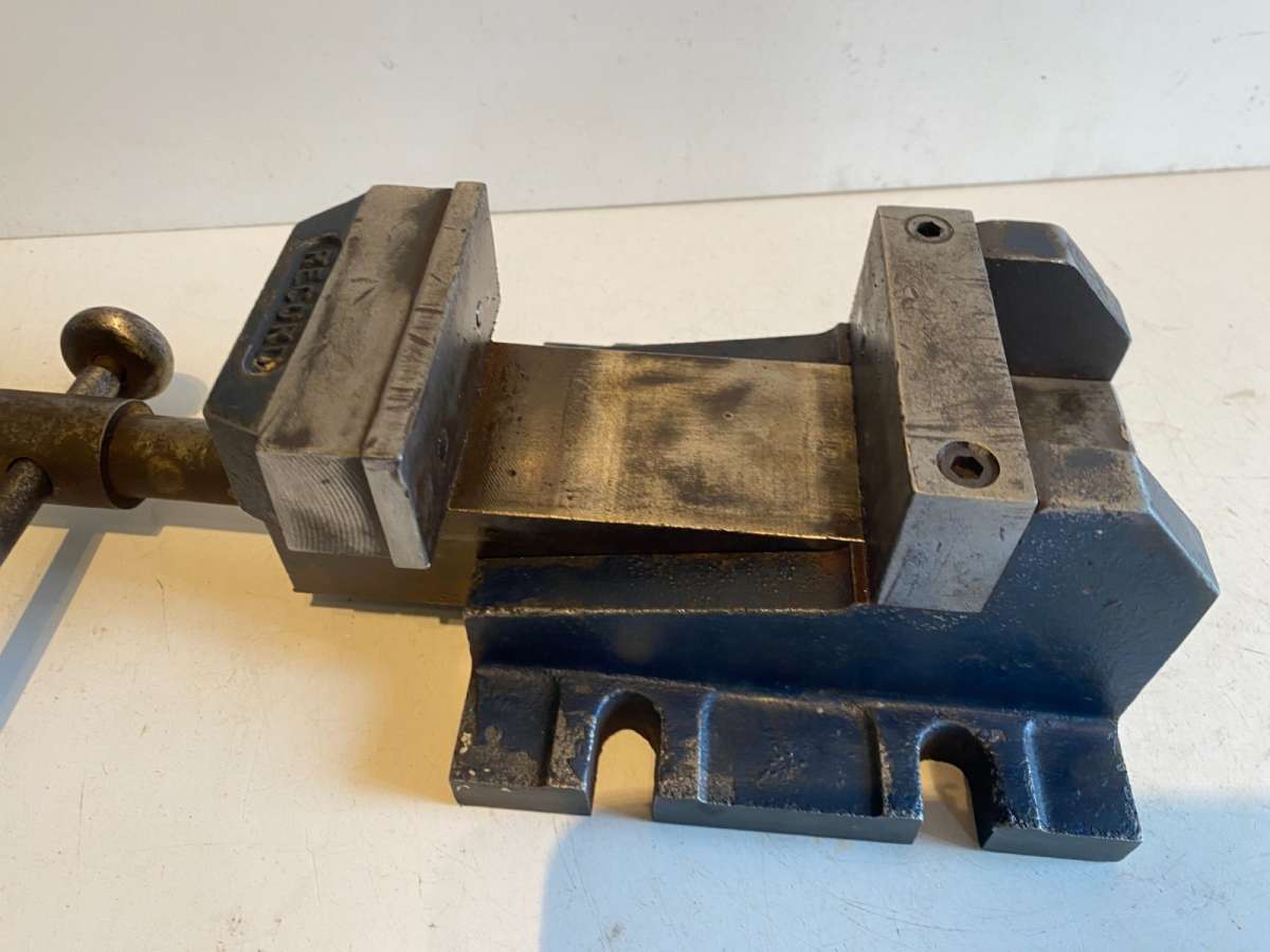

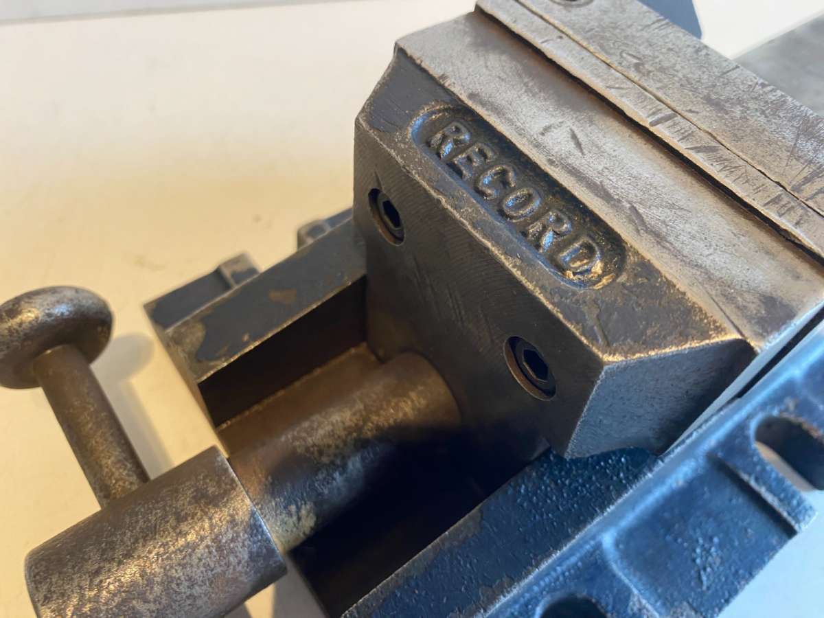

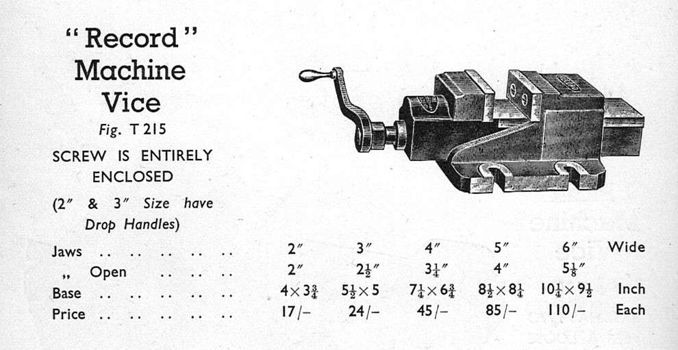

      Hi there
      I have just aquired a Record Machine vice. I thought it would be perfect for use on my CL500M as it has 3 Jaws and also 3″ opening. I currently use a Nippy which are great but has obvious limitations.
      I’ve never seen one of these before – does anyone know anything about it? Model No, etc?
      mv2s-l1600mv4 s-l1600
      Regards
      #820931
      peak4
        @peak4
        A Record 643 I think; this is from a 1963 catalogue, a 1937 cat. shows a similar earlier model, the 243 series
        https://archive.org/details/RecordCatalogueNo171963/page/n17/mode/2up
        image_2025-10-20_222514855
        Bill

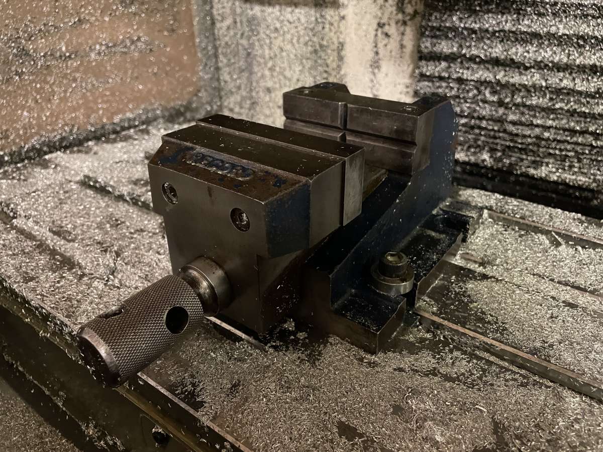

          Fatgadgi
            @fatgadgi
            Yes Danni, I have one which I use on the CNC mill all the time.  Excellent vice & very robust/accurate/repeatable.  Perhaps a little higher than some vices, but that’s not a problem for me.
            Mine doesn’t have a handle like yours – it’s just the knob with holes, so I tighten by hand then put a removable bar in the holes to clamp, which I prefer.
            I think yours has had a harder life than mine, but the jaws are easily changed. I sometimes use soft aluminium jaws on it for holding funny shapes.
            Anyway, enjoy it!
            cheers Will

              Nice design, would keep ingress of swarf to a minimum.

                        Fatgadgi
                          @fatgadgi
                          Hi Danni
                          Photo of vice below (sorry it on the mill table at the moment.
                          I guess my jaws are original – rear one is 25.2mm thick, and you can see, it has grooves in it.  Moving jaw is 18.9mm thick and is plain.  Both jaws are hard.
                          IMG_1309
