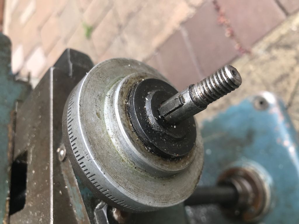

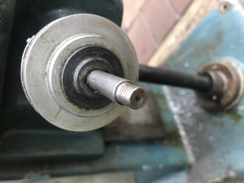

      Just bough a Raglan Miller. Its in a reasonable condition for its age.
      Does anyone have a manual showing the exploded assembly, I need to take off the dials to clean and adjust, I have taken off the handles and then presented with a black disk with no discerning way of removing it to get to the dial. See pics
      Any help very much appreciated!

          Hi Chris, on mine the micrometer dial slides off the shaft after the woodruff key for the handle is removed. The dial itself is a friction assembly with its own key.
          Hope I've remembered correctly and it's some help.

            I did give quite a pull, no movement , I noticed the woodruff slot goes through the the black disk as well.
            Maybe a little more brute force!
