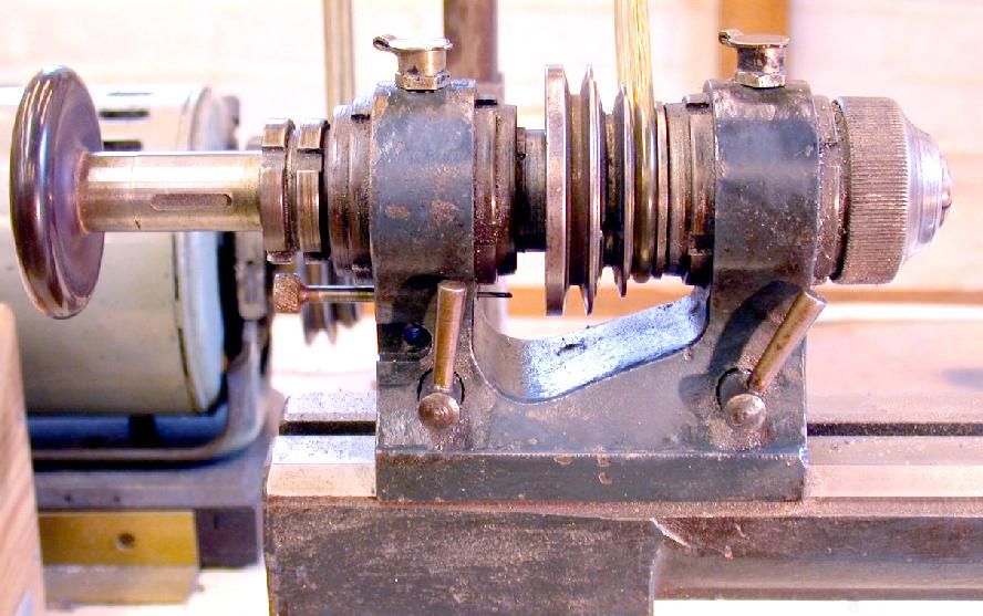

      I have a Pultra P type 8mm short bed lathe.
      It is missing the thrust washer/bearing between the pulley and the rear head stock bush adjusting nut.
      I would like to get it back into use.
      Any chance somebody has one that they would be willing to part with?
      Ken

          Can anybody give the dimensions of it please?

              Presumably, without the washer, the lathe is not usable?
              If f it is a runner, why not measure up, and then make one?
              Howard

                It is not a runner as is.
                The other problem one description tells me it was fitted with a ball bearing thrust another says a thrust washer.
                So I am a bit in the dark as to just what I am looking for.
                Ken
                #383812
                  Can you work out the inner and outer dimensions and approximate thickness?
                  #383835
                    This [credit lathes.co.uk] might help focus our thinking:
                    http://www.lathes.co.uk/pultra/page2.html

                      Having had measure of the gap the size of the washer would look to be:-
                      I.D. 0.686"
                      O.D. 1.318"
                      Thick. 0.160"
                      Ken

                        Could anybody turn one up for me?
                        As I have been told not to use the lathe.
                        #385973
                        Ken Weeks
                          @kenweeks58536
                          Well after a bit of thought and input from the forum, three fibre washers and my needle files I have made something that will allow me to use it.
