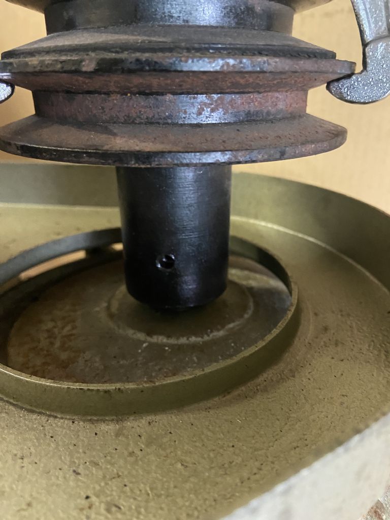

                          Thanks everybody for the advice. I am renovating the mill and would like to take this off to paint. I would also like to be able to remove this, so I can get a sling around the body to move it. I don't want to risk crushing the belt casing when lifting with my engine hoist.
                          Cheers Martin

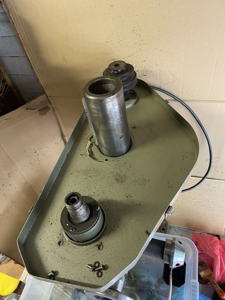

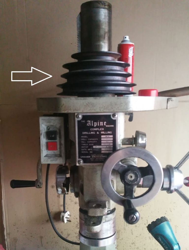

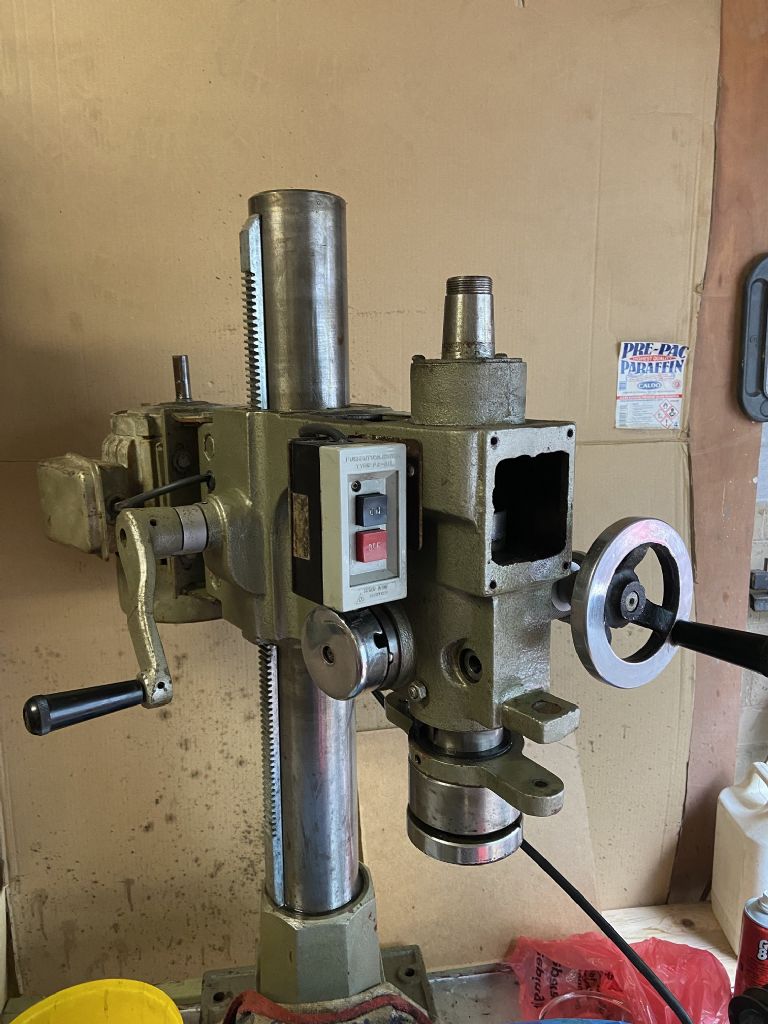

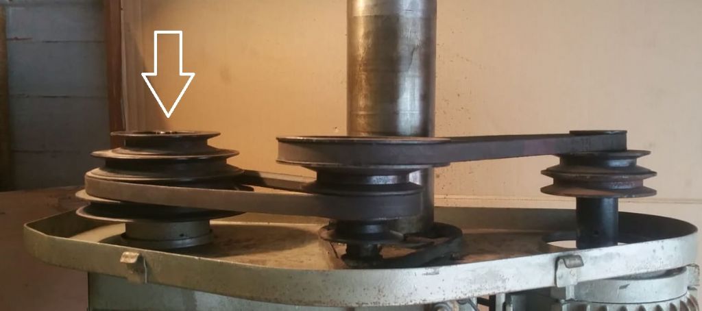

                            Here are some pictures of the pulley

                              If it is the common type of mill drill, the top front pulley has a large nut on the top. This nut has a left hand thread and the pulley is set on a taper. I took the pulley off the museum's drill mill and it was difficult. We put a puller on it and then applied heat to the pulley, and some time later there was a bang and the taper broke. It was a waste of time removing the pulley, as the bearings it ran in were perfectly sound. Leaving the pulley in place did not prevent the quill from being removed together with the spindle.

                                  The pictures show that the Alpine is different from the RF 25, having more speeds, and a different nut (C spanner type as opposed to hexagon ) so not a clone of each other.

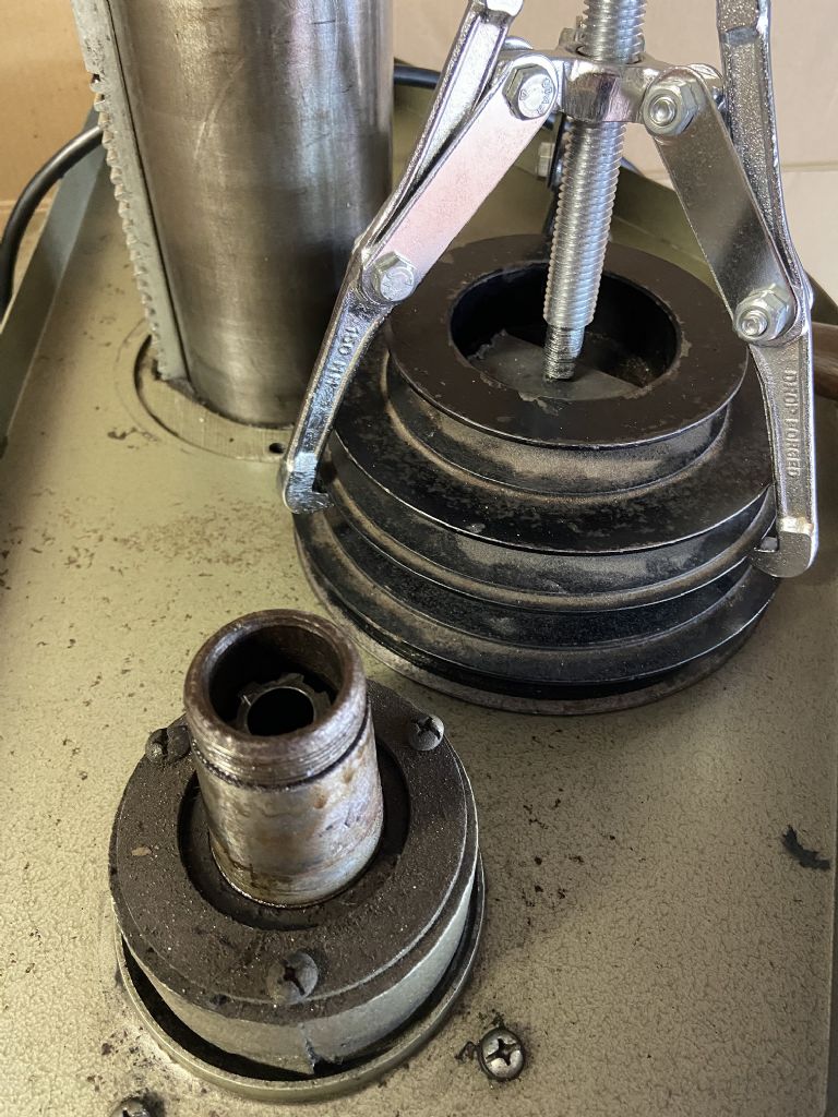

                                  If the pulley is steel, you can be more confident in using a pulley,possibly aided by a tap if it fails mto come off with the puller alone. Very often, the shock breaks mth taper more readily than a steady pull.

                                    Hi Martin, the only danger there is with a pulley puller is if you just use the legs of a puller that hook over the edge of the pulley, you could break the V belt groove or if it's steel distort the shape, if it's really stubbornly stuck on, believe me I seen people who have done it. If it doesn't come off with a little bit of heat, your best bet is to use a puller that is connected to a pair of bars bolted together that straddle the shaft, so as to pull on the centre portion of the pulley underneath, or at least as close as possible.

                                      When it comes to lifting, aren't there tapped holes in the top of the main casting that could be used as an attachment point?
                                      #483940
                                      Martin Ashton
                                        @martinashton58894
                                        Posted by ega on 04/07/2020 15:40:37:
                                        Unfortunately nothing that I can see. I did think that I could drill a couple of 1/2" holes at the top of the column, and pass some threaded bar through. But decided that the few times I need the move the drill-press, it would be a shame to alter its appearance.

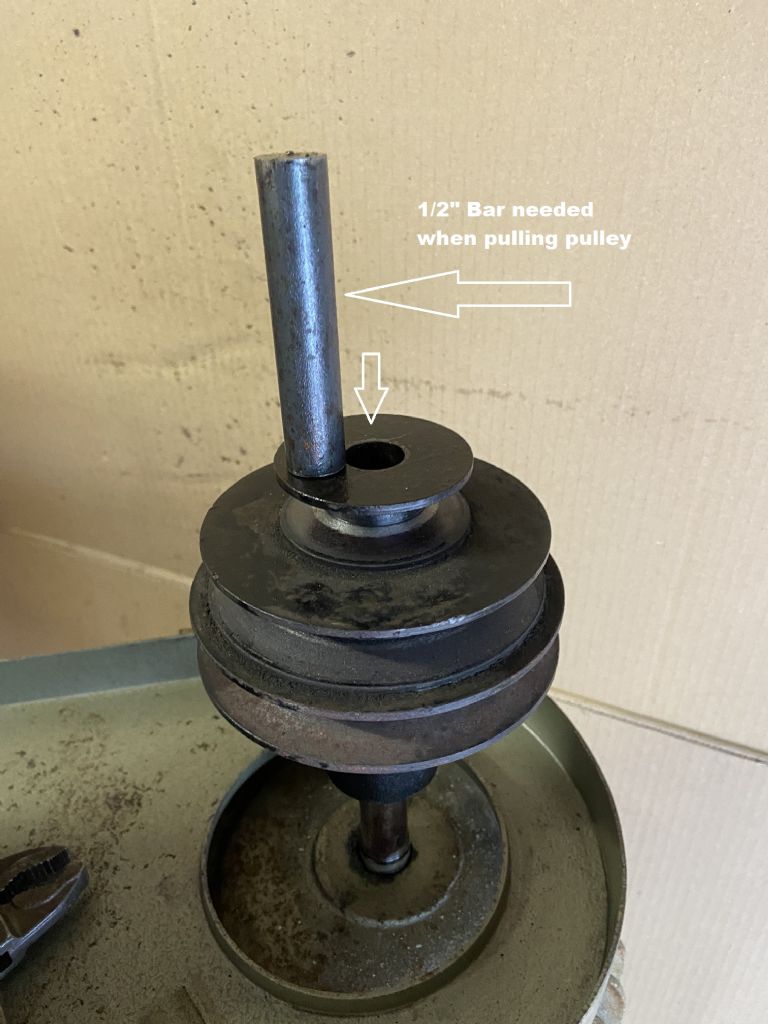

                                        #484754
                                        Martin Ashton
                                          @martinashton58894

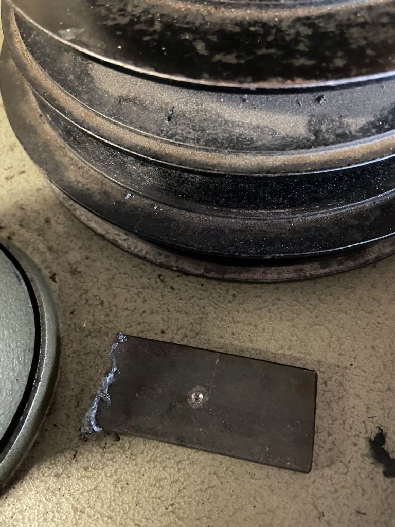

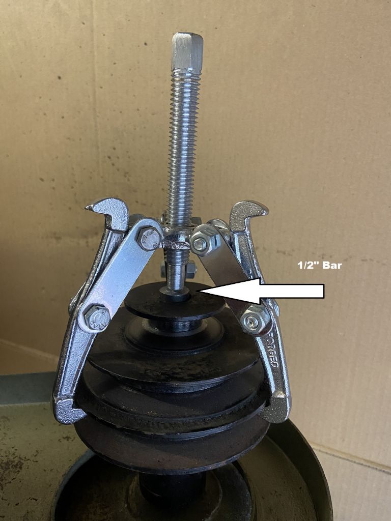

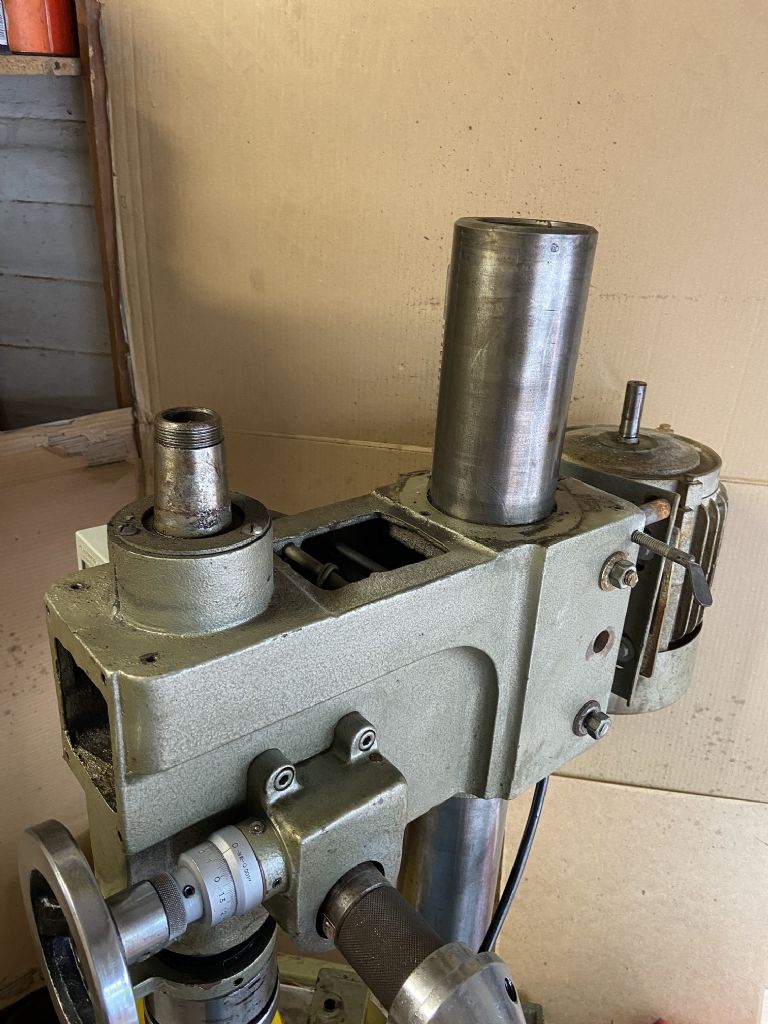

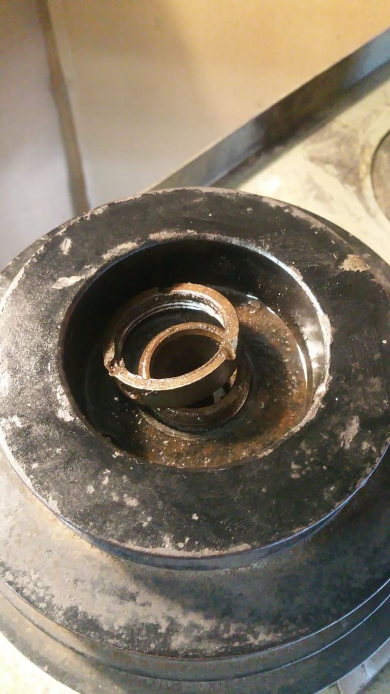

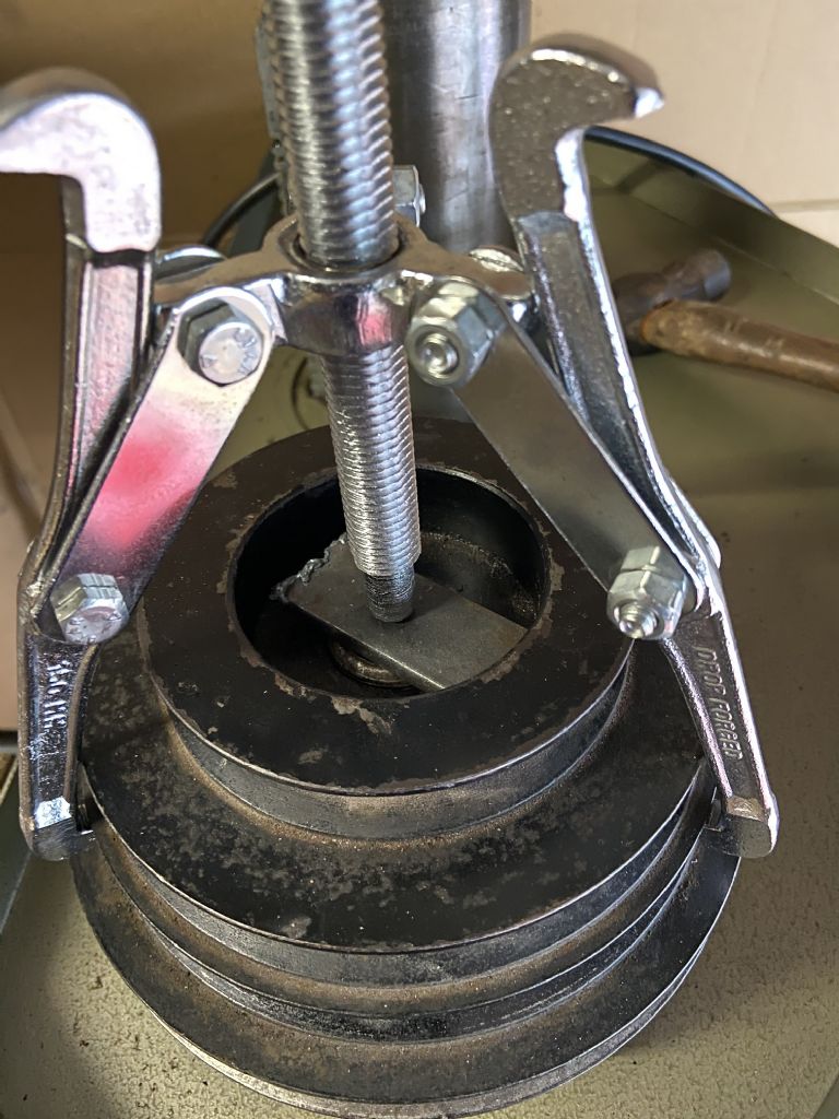

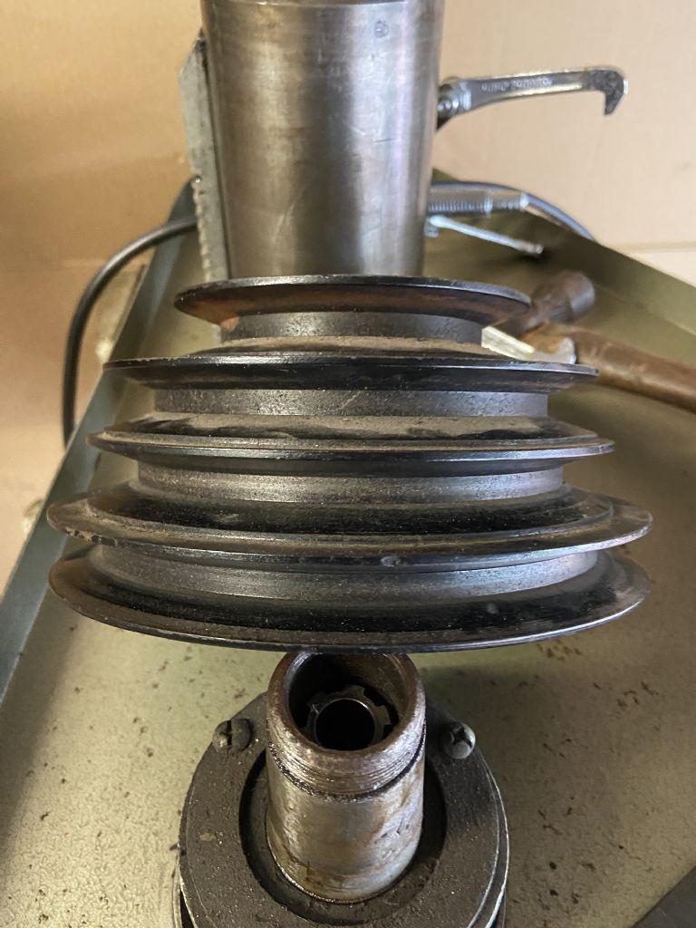

                                          Update on pulley removal
                                          Firstly a big thanks to everybody for the advice. I ordered the pullers off eBay, "cheap and cheerful" but they did the job. The pulleys are made of cast iron and relatively heavy duty for a small drill press. The main pulley was on a taper, luckily after tightening the puller and giving it a tap with a hammer I heard a small crack and the pulley was free. I now expected that the base part of the cover to lift off… wrong! The pulley attached to the motor was slightly larger than the hole in the casing and was held with a grub screw. The eBay pullers cost £11.50 and were a set of 3, a 3", 4" and 6". To get the pulley off the motor I used the 4" puller, with a bit of 2" x 1/2" bar, needed to go down the center of the pulley to give the puller ram something to press against the motors shaft. This was particularly tight, so I heated the pulley, which then released. I have added some pictures just for interest.
                                          Thanks again.

                                            Hi Martin, thanks for letting us know how you got on, successful job without tears by the looks of things. yes

                                              #484836
                                              Hopper
                                                @hopper
                                                Good job well done. Its the whack on the end of the puller bolt with a hammer that often makes the difference.
