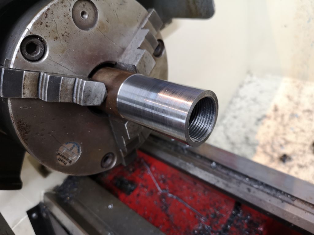

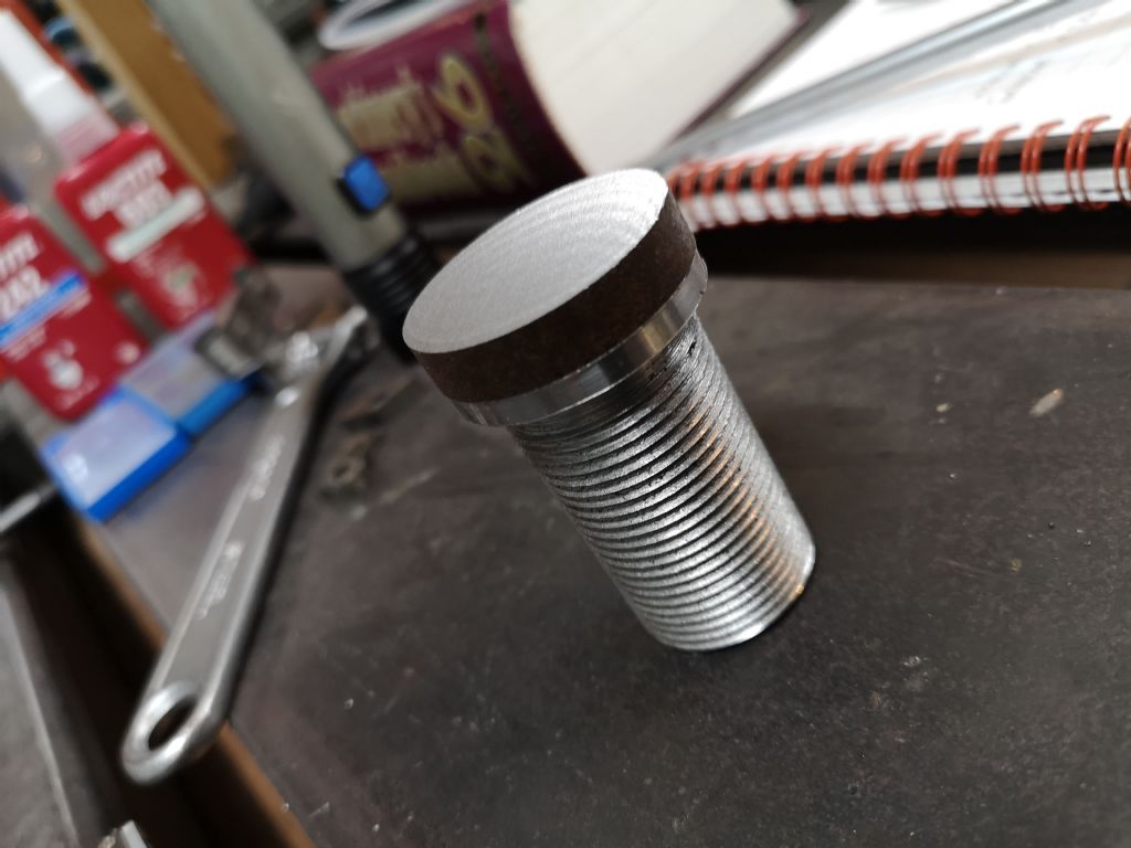

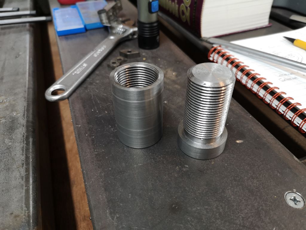

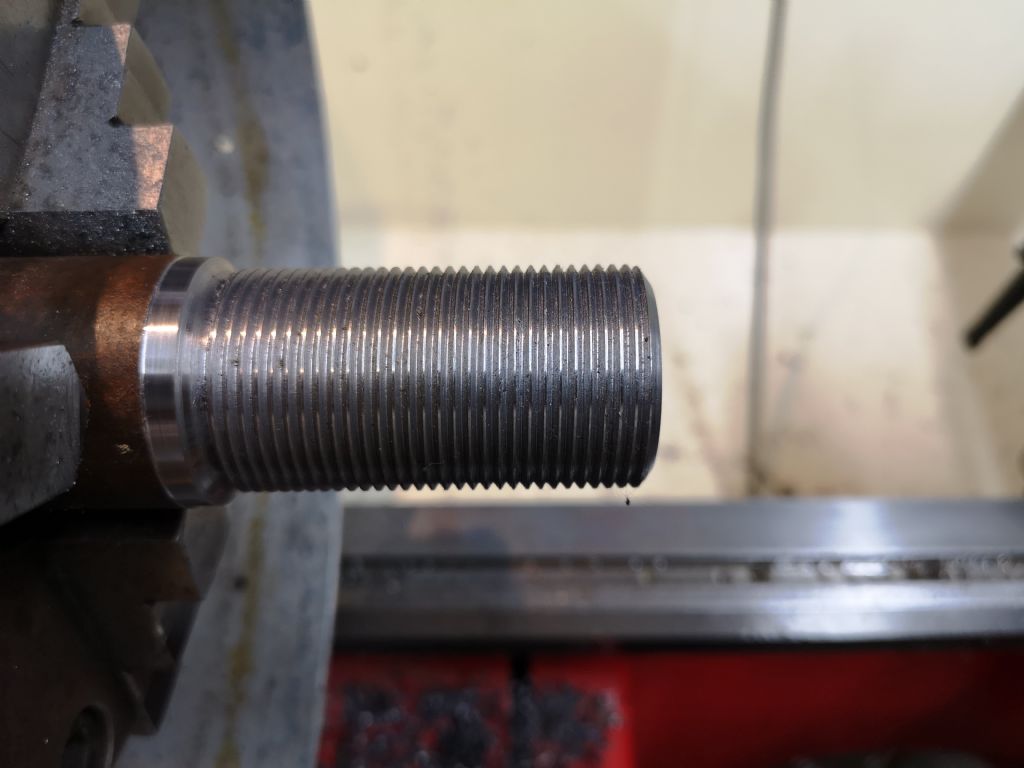

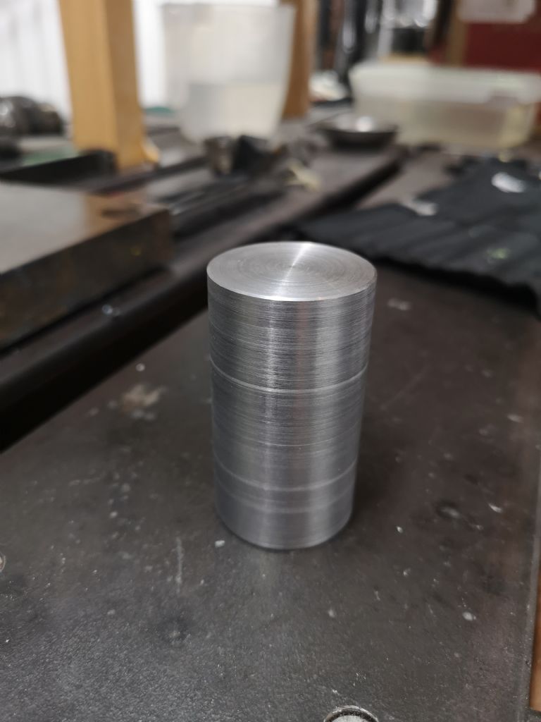

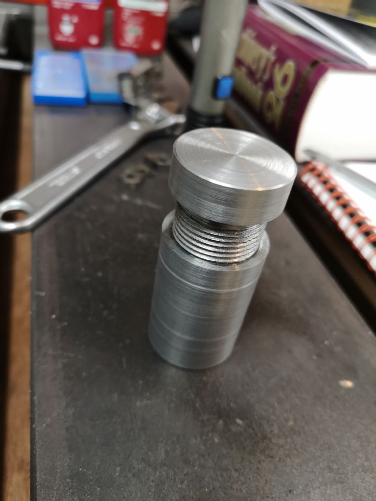

      First project I get to choose (after being forced to make a part for the screwcutting gearbox).
      Outside thread for the top (jacking) part (m30 x 2mm):
      Inside thread for the bottom part:
      Finished article:

            Hi Lee,
            I'll bet you didn't single point that internal thread smiley

            John Haine
              @johnhaine32865
              Cheating I know but this seems to me to be the best approach.
              #474879
                That's what I tend to do just grab a couple of nuts and a stud from the hold down set.

                  Posted by John Baron on 25/05/2020 19:15:08:
                  Hi Lee,
                  Well my tap & die set tops out at M24, so I guess I did. laugh

                    Posted by JasonB on 25/05/2020 19:28:33:
                    Lee with all your vibration problems you may want to add a locknutdevil
                    Cheeky! I'm trying to get to the bottom of those.
                    And yes, totally cheating (and would void the point of the project). smiley

                    John Baron
                      @johnbaron31275
                      Posted by Lee Jones 6 on 25/05/2020 19:35:50:
                      Hi Lee,
                      Good for you ! I hoped that you had. Its not an easy skill internal threading, particularly small or deep bores. Although I admit that I could have cheated and used a tap, the amount of effort required to turn a large tap of that size is enormous. I've only ever used that tap once, never again.

                        Lee,
                        Wow. You certainly don’t do things by halves! They are generally supports – not used for jacking up the leaning tower of Pisa! I’m surprised you didn’t put a hole through the top, for a tommy bar.🙂
                        Good work, mind. Easier to practise on a larger internal thread.

                        Lee Jones 6
                          @leejones6
                          A tommy bar, now there's an idea! Wait for v2. wink
