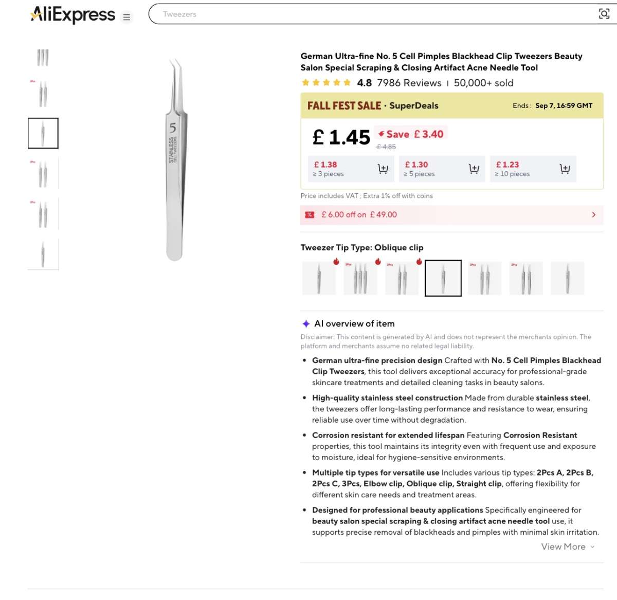

          < gulp >
          Admittedly not such a wide range of styles, but these are very nicely made
          IMG_2013
          Not sure what that proves, but I think I should grab some more whilst they are available.

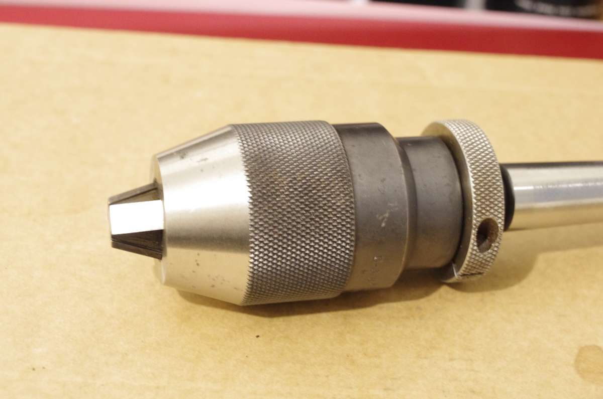

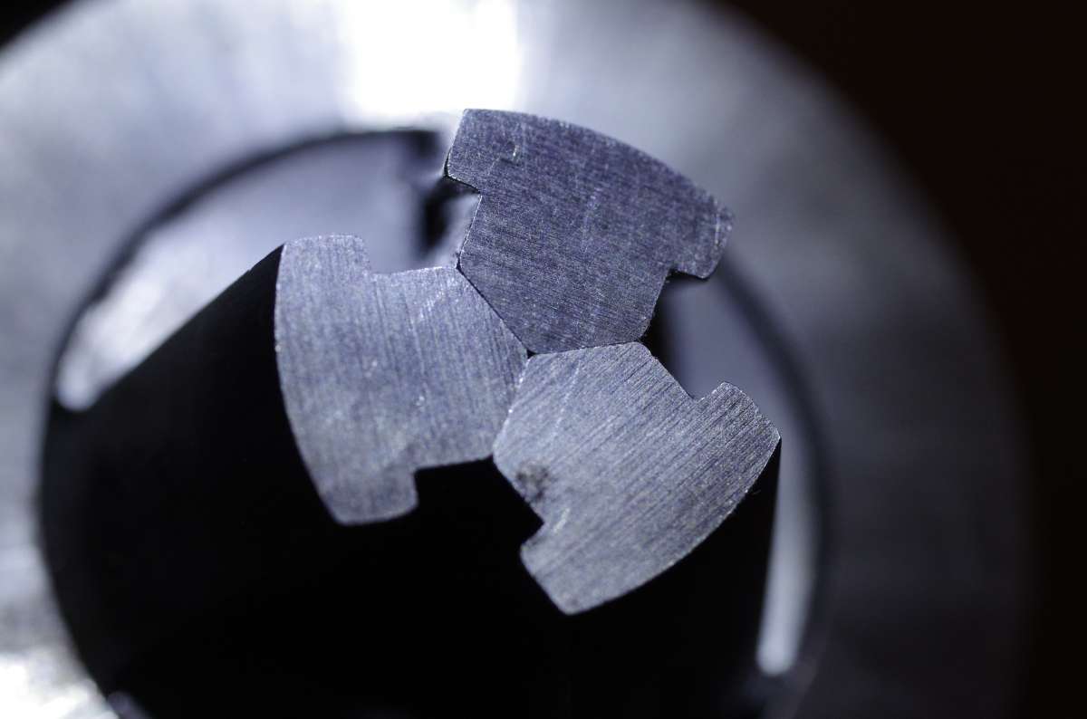

                                        I got hold of a NOS 10mm Albrecht out of a box of tools donated to the museum and fitted a MT2 arbor to it. None of us could get on with it, so it got sold and the proceeds bought a couple of keyed Jacobs, also NOS, a 1/4″ and a 1/2″ which get used regularly. Some people love them. I think it went for about £45
                                        _IGP2086_IGP2079

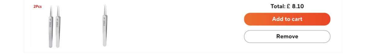

                                                    On Peter Cook 6 Said:
                                                    Not even close. Try tweezers at £220 + VAT!
                                                    For info, Peter
                                                    IMG_2034
                                                    They arrived today, and are certainly adequate for my needs
                                                    I ordered 3 of each of these “colours” … but would have got better value by ordering only the 2-packs
                                                    #864422
                                                    Peter Cook 6
                                                      @petercook6
                                                      Thanks for the update Michael, interesting price differentials! However I suspect none of them will be any better in my fingers at hanging on to those sub millimetre taper pins which escape with remarkable alacrity and disappear forever into the maw of the workshop gremlins.
                                                      That said I did spot one on the floor 3mm long and 0.4mm in diameter that had done a runner a couple of days earlier.
