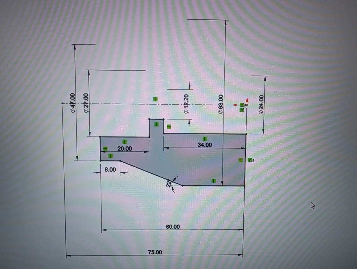

      I’ve been wanting the ability to face larger stock in my small milling machine. So I went about designing a Fly cutter.

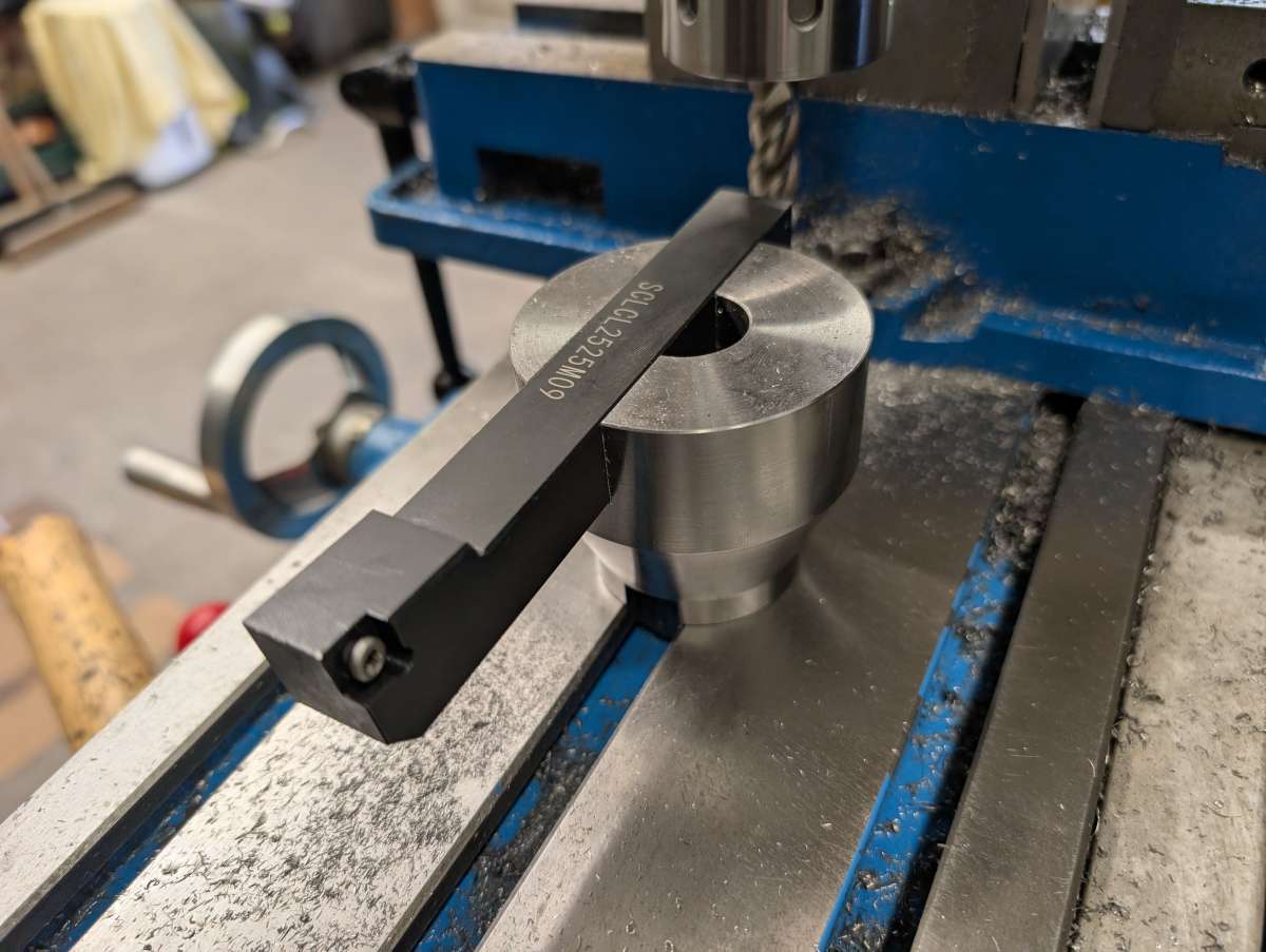

      I wanted it to use CCMT insert tooling, so I based my design to take an 18mm Lathe tool. My mill is relatively small so I wanted to ensure the body of the fly cutter had quite a lot of mass, and was relatively balanced. This meant I went for the longest CCMT Lathe Tool I could find, which was 25x25mm so would need machining down to 18x18mm
      PXL_20260404_093445590
      This was the plan, although a few dims may have changed slightly.

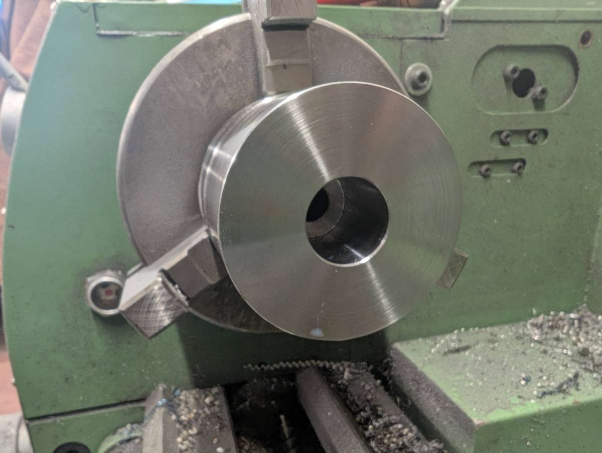

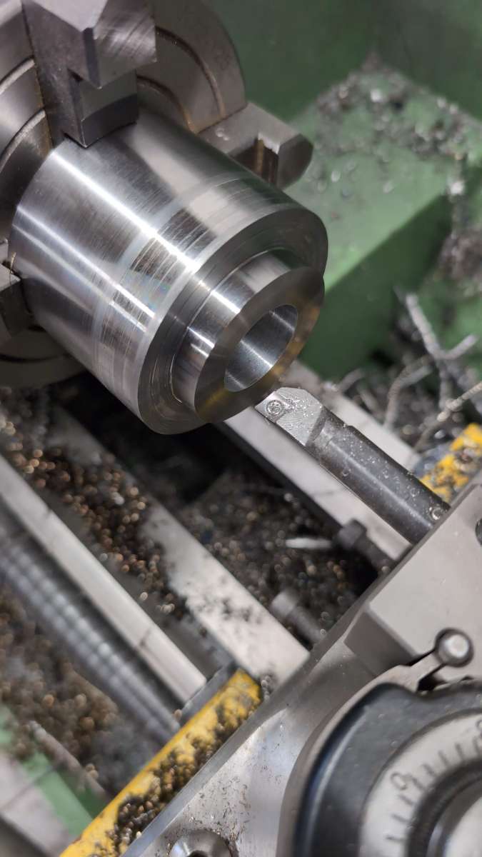

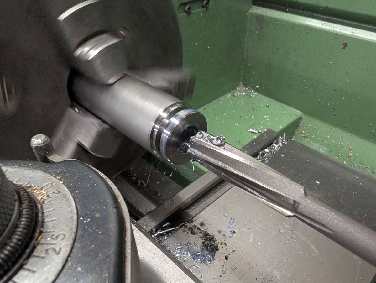

      Then began facing, cleaning up the outside of the material, then drilling and boring the screw hole and washer recess to size.

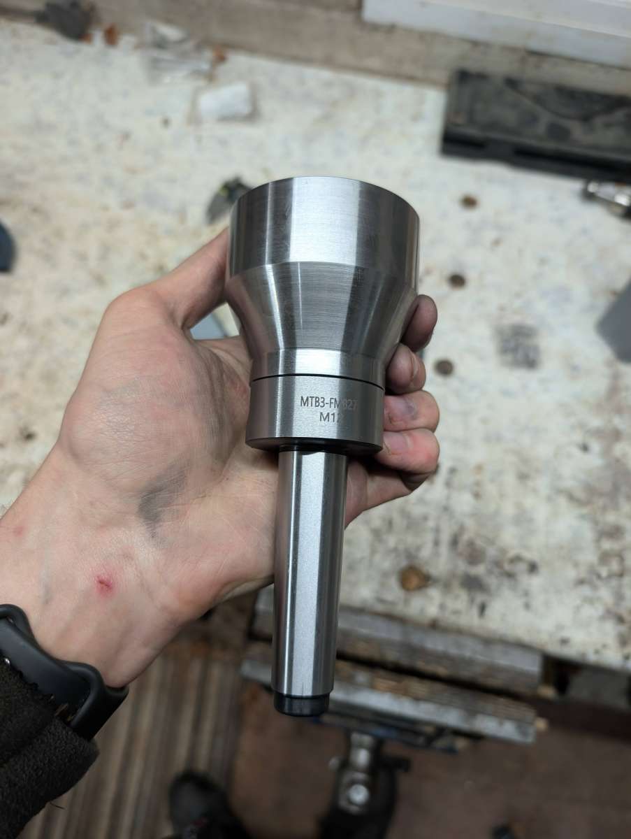

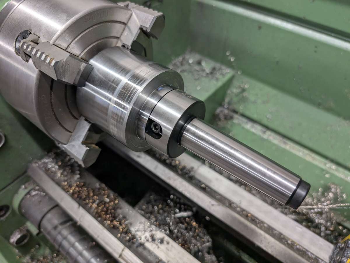

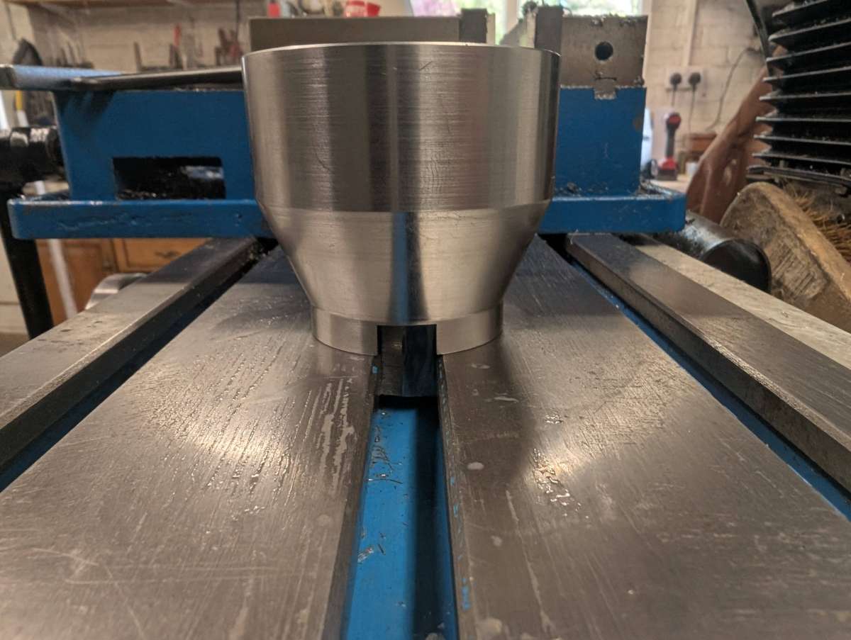

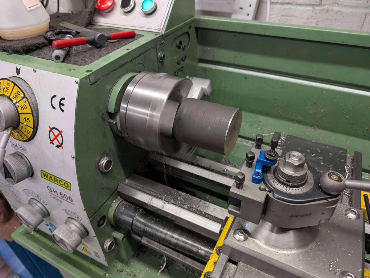

      Then I turned the part around and dialed it in the 4 Jaw to allow drilling and boring for the arbor to fit. I managed to get a nice slip flit which I was very pleased with.
      PXL_20260419_195837675PXL_20260419_200015001

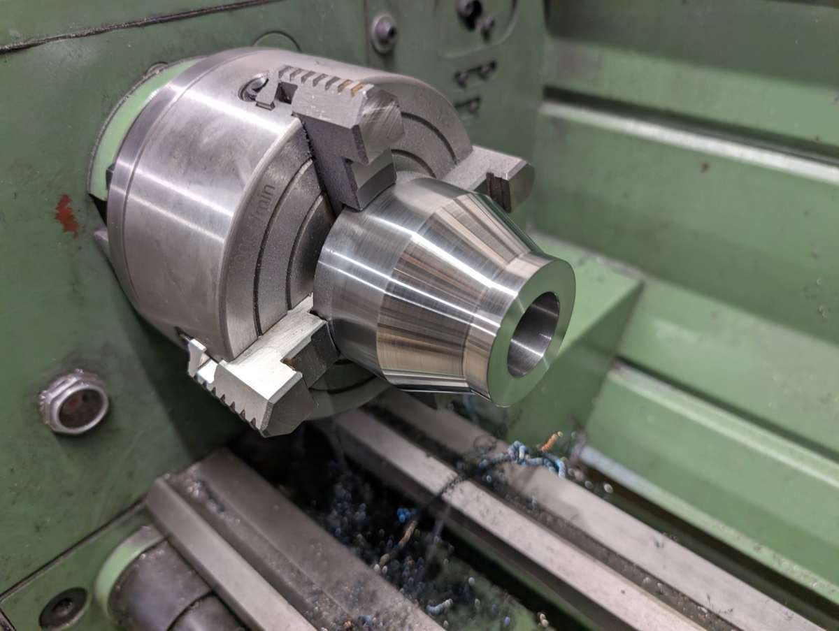

      From there I could turn the taper and the lathe work was finished.

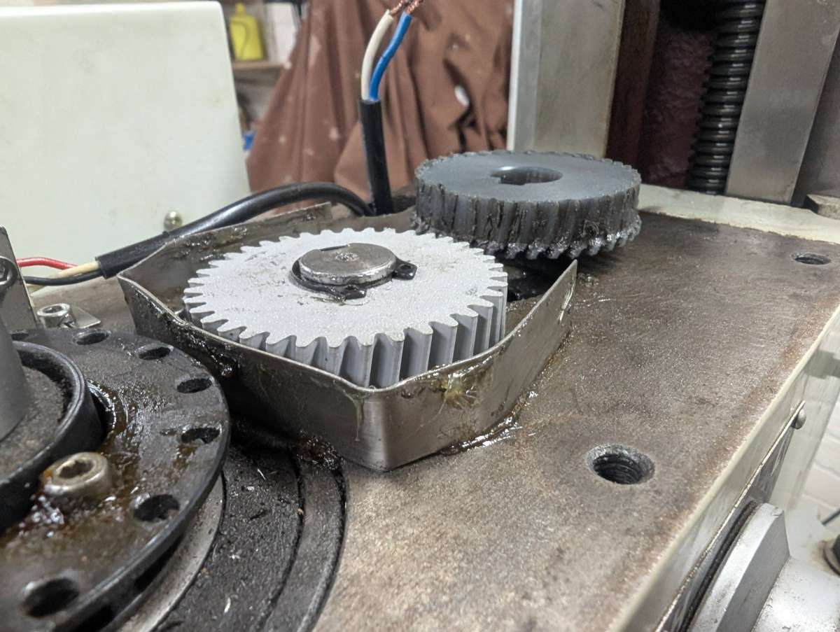

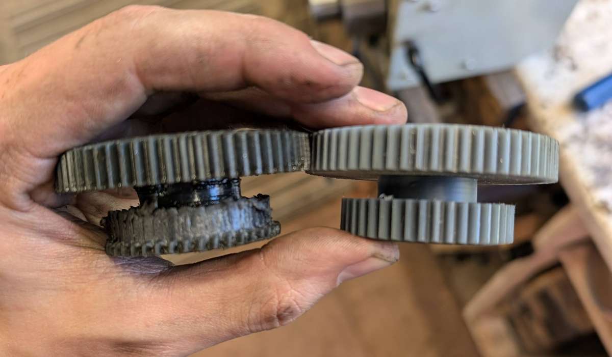

      At this point I had milled down the large lathe cutter to 18mm, but was held up by the mill gears eating themselves. So had to wait a while for replacements. I ordered two, one nylon and one steel for if the plastic dies again.
      PXL_20260501_150953474.MP
      Unfortunately when fitting the new gear I found that another was broken, so I designed and 3d printed a replacement gear from PETG-CF which has held up since. It will be replaced when the real gear arrived.PXL_20260501_224146377
      From there I finished off machining the lathe tool down to size and started machining the key slots for the arbor. This went surprisingly well after my previous milling and having gears break.PXL_20260502_124851174

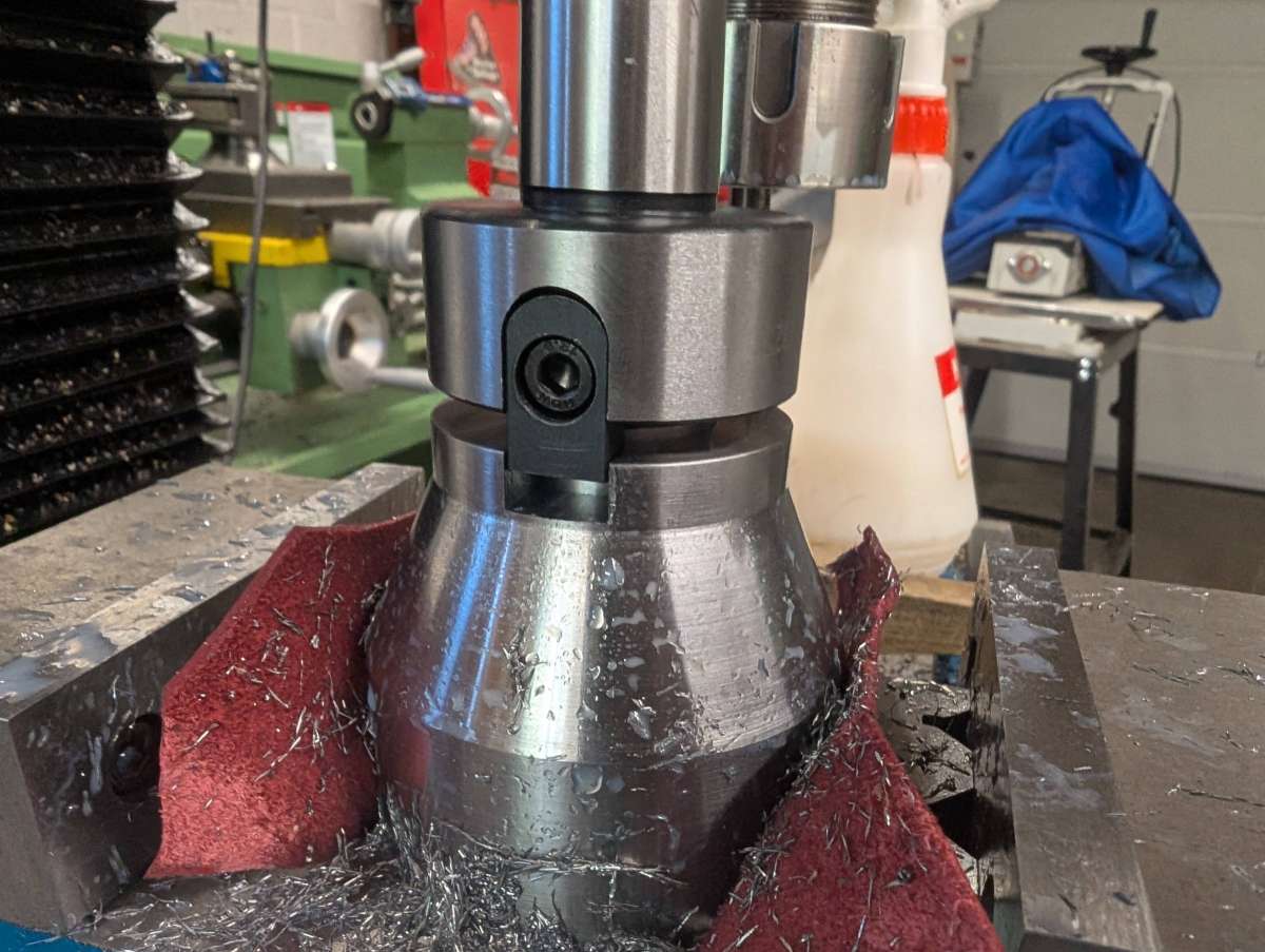

      From there I machined a t-nut to hold the fly cutter head down to the table so I could mill the tool slot, this also went surprisingly well!

        An interesting project but a small machine may well struggle to do the work of a big one ? Does the motor have the power to drive a large cutter ? Plastic gears will not like the shock loadings a flycutter will cause. Good luck. Noel.

          Tool slot cut in.
          PXL_20260502_160932347
          Then I drilled and counterbored some holes for m12 grub screws

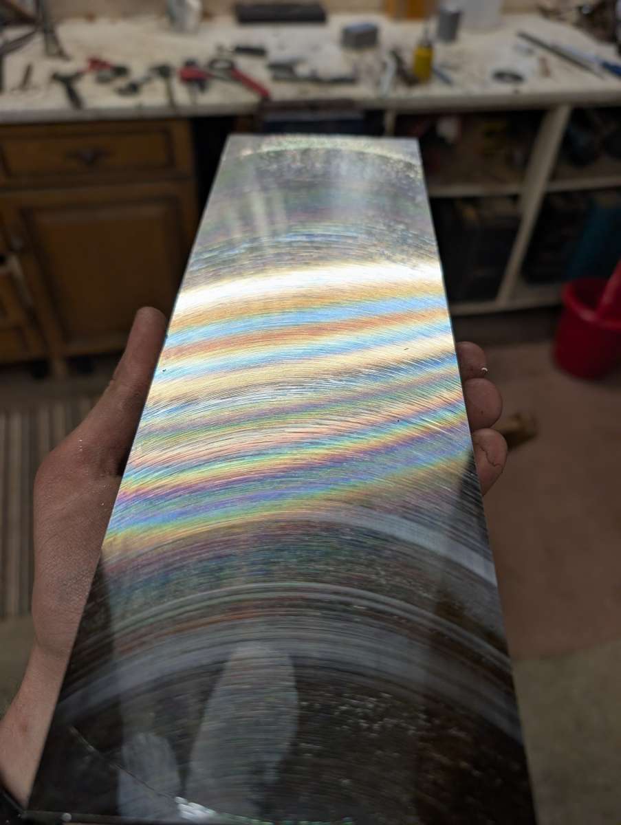

          From there I could assemble and test.

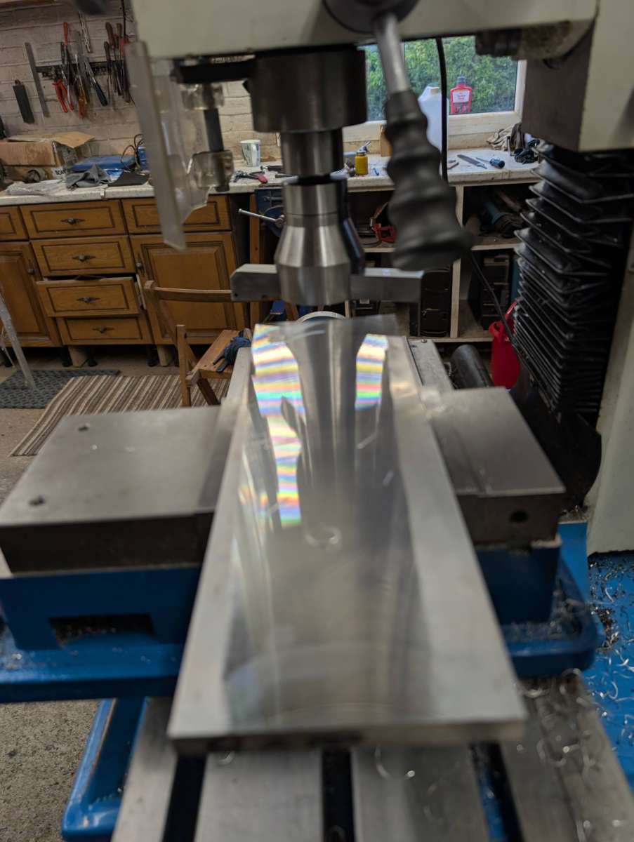

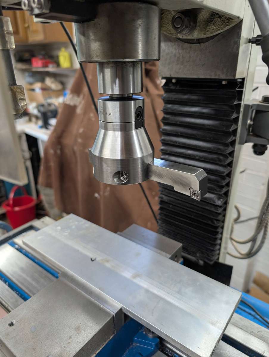

          I’m very happy with the result. Thanks to the tool holder being extra long, i can keep the tool balanced and still have the cutter at 150mm dia.
          Facing some 100mm wide aluminium was a breeze, leaving a very nice surface finish (where supported. I won’t be holding parts like this in practice, or will make some screw jacks).
          One problem I’ve been having, which is consistent with my face mill, is struggling to get the mill head to be perfectly in line with the bed. There isn’t a proper adjustment so it’s just me hitting it back and forth and taking cuts/measuring bed distance. It would be nice to make an attachment for the side of the head to allow a more controlled way to tilt the head.
          Anyway, very happy with the result, it will be suitable for my applications. Although it is quite large for the machine I am able to run it at whatever speed I want due to the mass and even stick out of the tool. It gives no signs of bogging the machine down, even with currently using a 3d printed gear in the head.

            Noel, it’s a 750 watt motor which I fitted last year since the original smaller one died.
            Seems to have plenty of power, but I’m not exactly hogging. 0.25mm cuts is as far as I’ve taken it so far.
            Especially using carbide inserts for an interrupted cut, i won’t be taking it any deeper.
            The new gear I’ve ordered is metal, and then the middle gear I already replaced is currently nylon, but I have a metal one spare so will put that in if i get any problems.

                I assume you are aware that if you want to get a flat surface with a large cutter the tramming needs to be absolutely spot on.
                Any error makes the surface that you are machining concave, and the bigger the cutting radius the bigger the problem.
                You do normally however get a better looking surface than if you had machined it with a small cutter!

                        sorry but the way the part is fixed to the mill does not bode well for a flat surface, being only supported in the middle

                          David- Yes, very aware of needing to get things trammed in properly. Hence wanting to sort a mechanism for adjusting the head more precisely. Too many projects for now. Thankfully my machining is never that precise anyway, but always nice to make things properly where possible.
