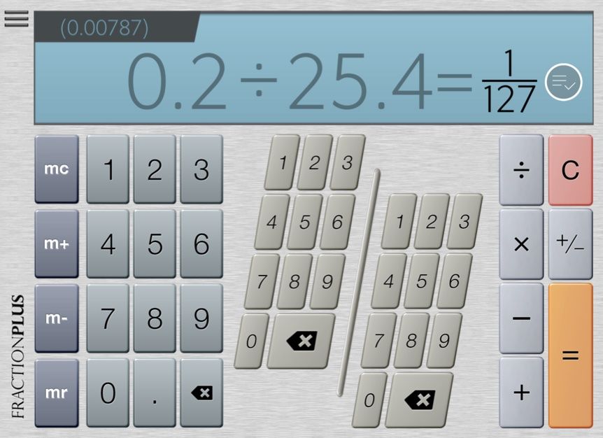

        Unsurprisingly, Dave …
        A scale divided into 127ths of an inch would be interchangeable with one having 0.2mm divisions
        angel MichaelG.

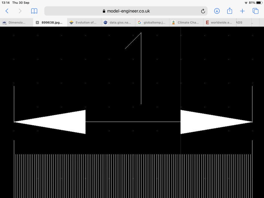

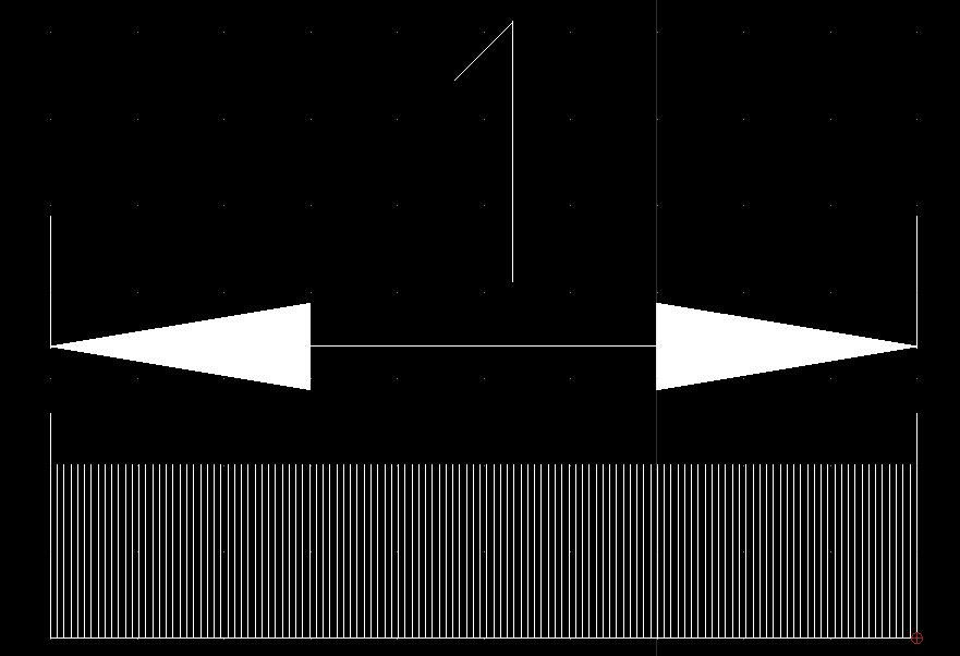

              Posted by SillyOldDuffer on 30/09/2021 10:41:05:
              And this is what the inch fraction ¹⁄₁₂₇ scale looks like, magnified!
              If the pictured scale looks uneven on your screen, its because ¹⁄₁₂₇" pushes display technology – jpeg photos and the your computer screen both struggle,
              Having tapped on your picture of the scale, to expand it … then done a screenshot … then converted that .png back to .jpg for the forum … I think my iPad handles that pretty well : I can even see the dots on your Grid.
              Click for a larger view ^^^
              Certainly good enough to see the nominal resolution of the scale, even if not to assess its accuracy/linearity.
              P.S. __ ‘sub-graduations’ could be added according to taste … there is no need for them to be integer divisions of 127 … they are simply an aid to counting.
              Edited By Michael Gilligan on 30/09/2021 13:38:21
              #564924
              Nick Wheeler
                @nickwheeler
                Michael, your 'clear' image is about 5" across on this device, and is therefore utterly useless as a defence of a scale that doesn't work in real life.
                And Imperial measurements have enough stupid divisions without some idiot enthusing about 1/127s !

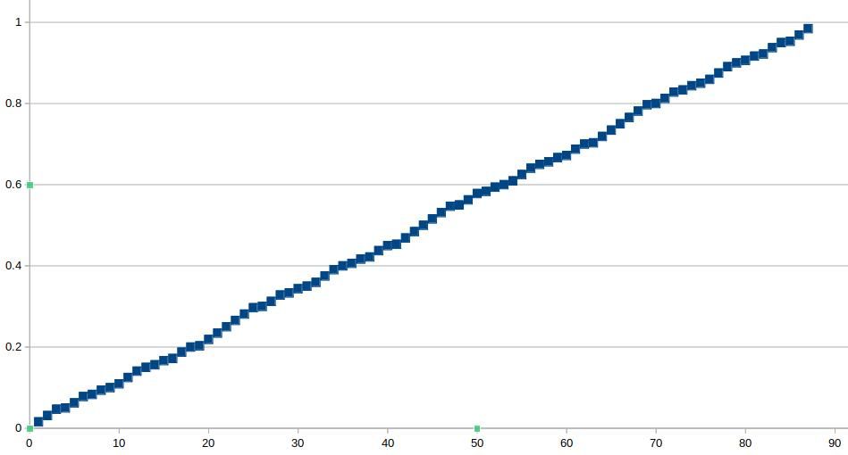

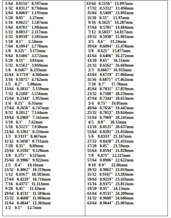

                                  Posted by Michael Gilligan on 01/10/2021 08:07:52:
                                  [ once more … with feeling ]
                                  Still with you Michael! My response is a rule graduated in 0.2mm increments isn't much practical use either – not without a microscope.
                                  This table shows what I don't like about fraction rules. It spans one inch assuming the user has rules graduated in eighths, tenths, twelfths, twentieths, and sixty-fourths.
                                  The table can be eyeballed to see 3/8" is smaller than 25/64" which is smaller than 2/5, which is smaller than 13/32". They all approximate 10mm and 25/64" is the closest. But, as a general way of measuring, it's fairly obvious from the decimal fractions that the usual common fractions don't step evenly: they jump.
                                  The graph has a sawtooth rather than a straight line:
                                  In practice, this means it's best to work with a limited range of common fractions when using rules. Although you could have several rules, making anything dimensionally complicated is clumsy compared with working throughout in decimal fraction such as thou. Thou and millimetres are smooth, for example it's easy to go to tenths or nanometres when more accuracy is needed. But not measured with a rule!

                                      #565072
                                      Nicholas Farr
                                        @nicholasfarr14254
                                        Hi Dave (SOD), I don't class myself as a mathematician, but I do like playing around with numbers even if they make no practical sense or even have any useful purpose**. Some fractions do have a usefulness in some instances though. I like the fact that 1/127 is equal to 0.02mm which can make some ridiculous improper fractions, some of which one can measure quite accurately with a rule for general use, with either metric or imperial. e.g. 7500 / 127. The 1/127 also has a *1/2- brother, which will follow it continuously e.g. 15 / 254 They are of course a bit quirky and maybe many will not spot these fraction measurements in mm.
                                        **Does make the old grey cells work a little though.
                                        * Thought I'd use a fraction here on purpose. devil
                                        Regards Nick.
