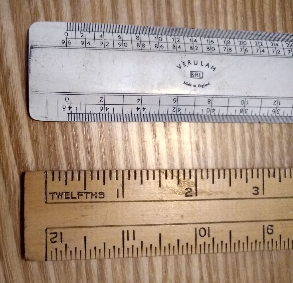

            Journeyman
              @journeyman
              Posted by Russell Eberhardt on 28/09/2021 19:04:55:
              It's known as a scale rule.
              Russell
              Not necessarily: the image below shows a scale rule with a 1/8inch scale at the top and 1/4inch scale at the bottom. For comparison the lower part of the image shows a rule (an old school ruler) showing Twelfths.

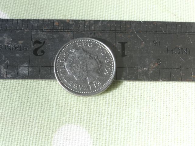

                                              Um, I plead 'not guilty'
                                              I was referring to the precision of a fractional rule in use, not the scale. One definition of precision: The ability of a measurement to be consistently reproduced. Rules aren't much cop for that.
                                              On the ⅛" scale, what's the diameter of this 5p coin? How precise is the measurement in the sense it could be reproduced?
                                              I'd claim no better than about ¹¹⁄₁₆", which is roughly 17.5mm. Official size is 18.0mm; what's that as an inch fraction?
