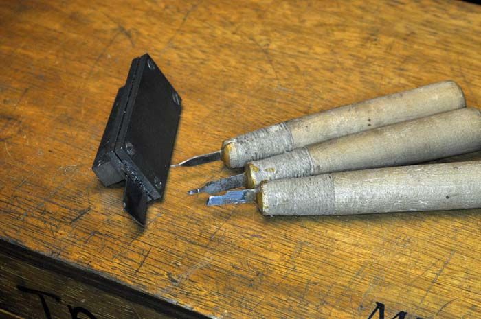

                                  Roderick Jenkins
                                    @roderickjenkins93242
                                    Some little chisels for carving the rose in a lute soundboard and a thin parting tool holder, I think this was a Len Mason design – also good for piston ring grooves.
                                    cheers,
                                    Rod
