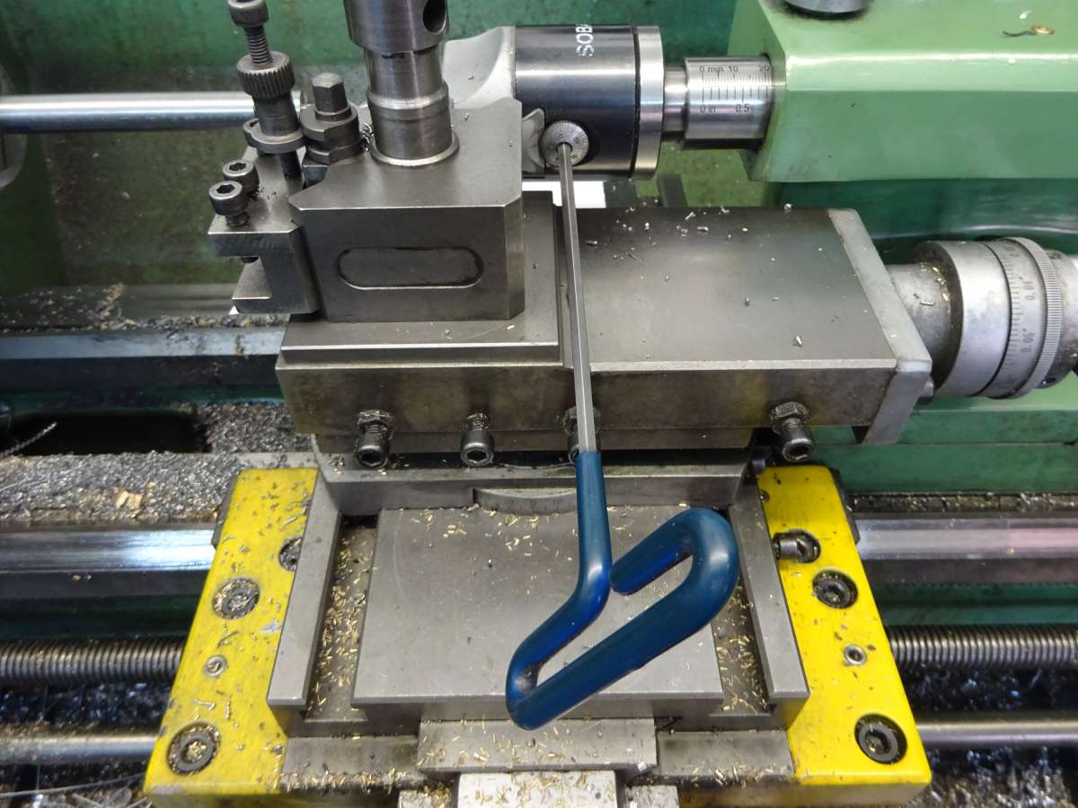

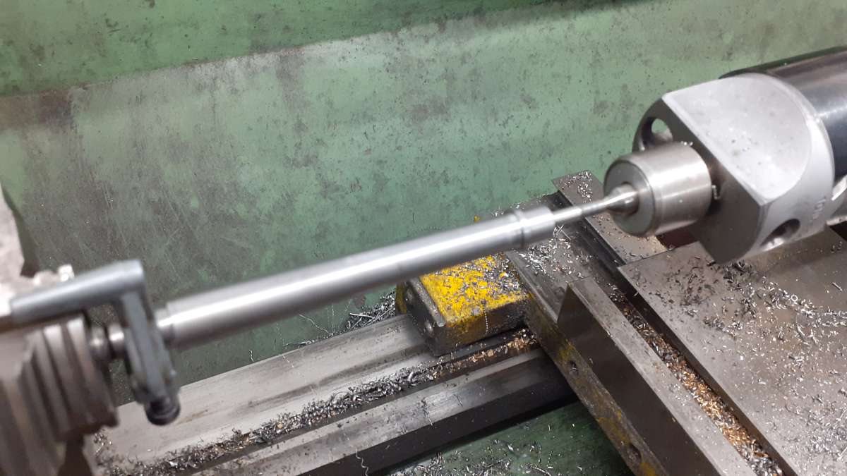

                  I use the boring head all the time these days rather than upset the tailstock alingnment. I have a small rotating ctr that fits mine but turning your own dead one would work.
                  The main advantage over the designs that I have seen or just moving the tailstock is that the screw on the boring head allows for easy adjustment of the taper. Boring head also tends to be smaller than the sliding offset tools I have seen so less likely to get in the way of the toolpost. Though the second link above gets over these issues

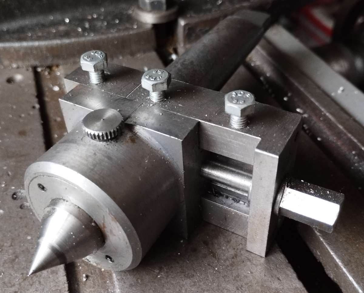

                        I made (in 1986) this adjustable  offset revolving centre when I needed to turn a number of tapered shafts.  Since then it only gets occasional use.  Recently used by a friend to machine a Brown and Sharpe taper.
                        For the occasional job a boring head is entirely adequate, I would not bother doing as I did, unless turning tapers became a regular job, as it was for me back then.

                            If anyone want the boring head dead level then all you need do is stuff a bit of 1/2″ or 12mm round bar in the cross hole and stick a digital angle block or your engineers level against that.

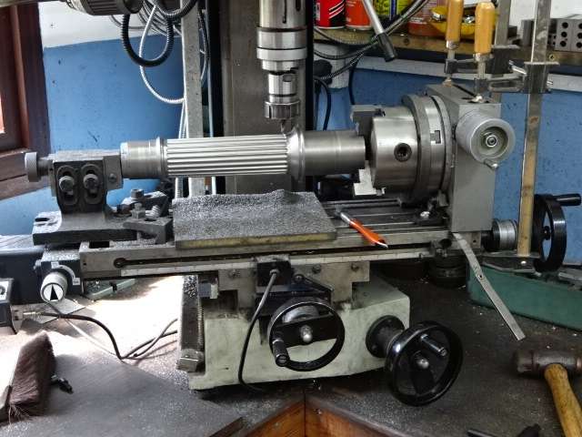

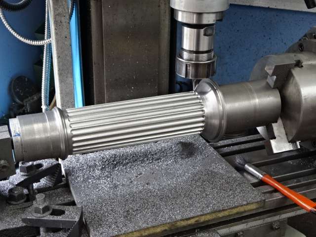

                            Editor Neil has an article in the current ME&W about fluting simple columns. If you have any questions just ask, as I have done some larger ones.

                              I have spotted the article in the ME&W but not read it yet. I was planning on making a spare column and setting it up on the mill table at about half the taper. I want the flats between the flutes to be roughly parallel so the flutes will taper slightly reducing in width towards the narrow end.
