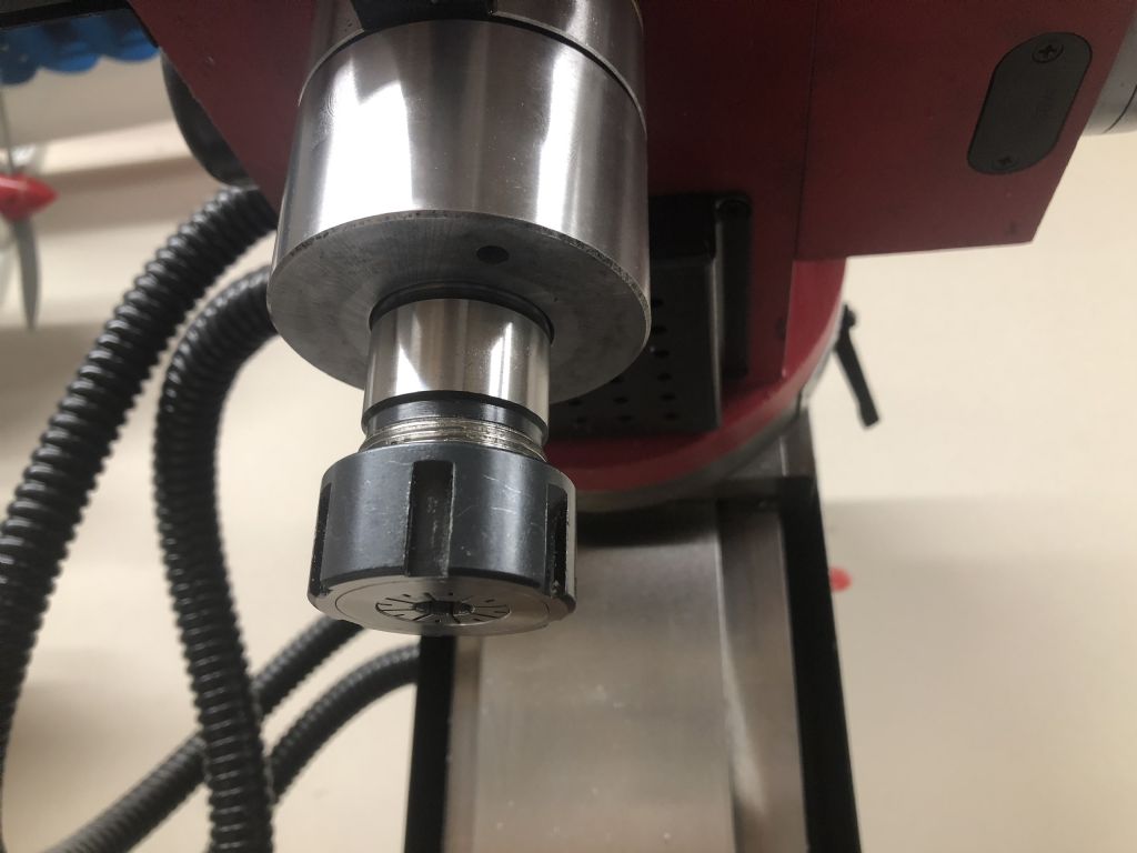

                                    Well probably been asked dozens of times but having no experience with a mill I need to ask it again. The correct use of the drawbar..? My mill spindle is R8, I understand how to fit the collet and tool but how tight does the drawbar have to be, I dont want to over do it. Plus removing the collet, do the drawbars always require a tap to release it.

                                      I’m glad you’re asking this, because I’ve got a R8 collet on it’s way for a project I’m working on. The only experience I have is with an ER25 collet Chuck. I find that the drawbar always needs a tap with a rubber mallet to release the Chuck.
                                      The problem with the Chuck is that it takes up 2” of room that I need to machine a long part, so I’m going to try a finger collet.
                                      I’ve had no problems with the ER collet Chuck, although, I always tighten it up pretty tight on the cutters and I don’t think I’m pushing it overly hard.

                                          ……… but how tight does the drawbar have to be, I dont want to over do it. Plus removing the collet, do the drawbars always require a tap to release it.
                                          I do mine up pretty tight; a good hard push on a ring spanner. Remember that power transmission is entirely through friction of the mating spindle and tooling tapers.
                                          I probably tighten more than most people for several reasons:
                                          On both my R8 taper mills I use the Tormach TTS system which uses a 3/4" collet and tool holders with a plain 3/4" shank. So the collet needs to grip the plain shank tightly to transmit power
                                          I often run my mills to the limit of the available motor power and I don't want to ruin work/tools/mill by having tools pull out or slip in the spindle
                                          On the CNC mill the tool holders need to be pulled tight to the spindle nose for consistent tool lengths
                                          I'm a master exponent of BF & BI
                                          In theory the R8 taper is self releasing. In practise I find that a tap or two on the tool is needed, although by no means always. The TTS toolholders often just slip out, indicating that the collet has relinquished its grip.
                                          Andrew

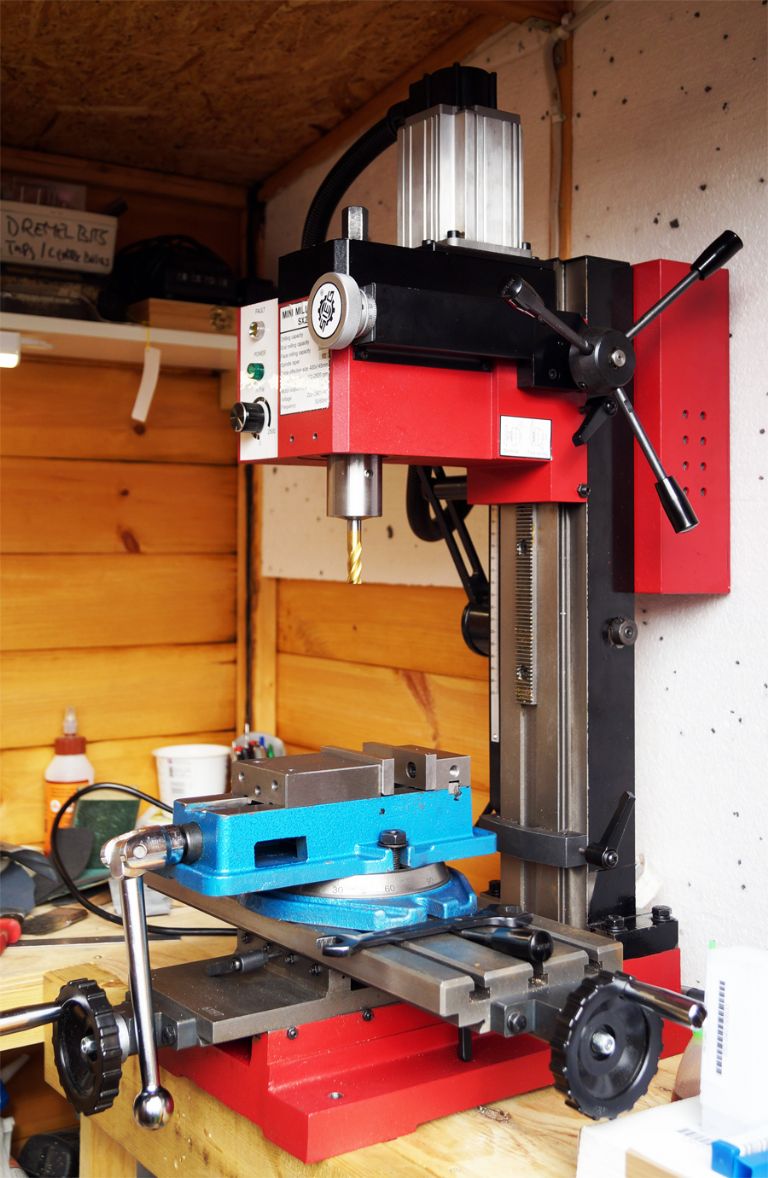

                                                    After a long time waiting I am now the proud owner of a mill, its installed in the shop and ready to go, well almost.
                                                    I broke the machine down into two parts removing the column from the base and that made it manageable, well just.
                                                    The seller didnt exaggerate when he said it was in good condition and little used, you can see that by just looking at it. Impressed with how quiet the brushless motor and belt drive is, seems very smooth.
                                                    With the base/table assy free of the column I took the opportunity to adjust the X and Y gibs, I spent quite a bit of time doing it and they are as good as I can get them, its left the X hand wheel a little stiffer than it was but its ok. There is about 5 thou of backlash in both the hand wheels which is better than I expected. The backlash on the spindle fine feed dial is about half a turn but apparently there is a quick fix which improves it.
                                                    With the machine back together I set up the dial gauge in a collet and trammed the table. Checking 5 inches either side of the spindle in X there was a 4 thou difference, 4 thou over 10 inches I didnt think that bad. However in Y there is an 11 thou difference from the table front to the rear over 5 inches. The column is leaning forward or I wonder is it..? I havnt checked the head gib, could it be possible that the error is there, what do you guys think..? If it is the column to base I will set too and adjust it.
                                                    The vice arrived from ARC, it looks good, thanks Jason for pointing me to it. Also a couple of end mills and collets arrived so at least I can make a start and get in a bit of practice.
                                                    Thanks guys for all the help and advice you have given me, it really is appreciated.
