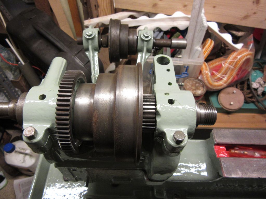

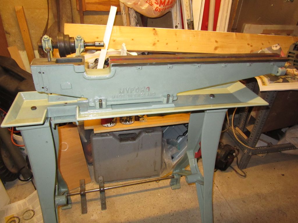

      Hi, I am trying to restore an old Myford lathe I dismantled 15 to 20 years ago. I believe it is an ML2 or ML4. Unfortunately I did not take any photos at the time of dismantling! Luckily, not typical of me, I stored all the bits safely and now after cleaning, repairing and painting I am trying to rebuild the machine. Even after studying old pictures of the machine I cannot locate and secure the counter-shaft with the three flat belt speed change pulleys and the pulley that links to the motor.
      The obvious spot does not seem right to me. There are two 3/8in holes in the tray but only a square hole in the bracket. There are two further 1/4in BSW holes in the bracket that don’t seem to line-up with anything on the tray or headstock. Have I in fact lost a packing piece that fits between the ribs on the underside of the tray and does a bolt go through the rectangular hole to hold the bracket in place?Hi, I am trying to restore an old Myford lathe I dismantled 15 to 20 years ago. I believe it is an ML2 or ML4. Unfortunately I did not take any photos at the time of dismantling! Luckily, not typical of me, I stored all the bits safely and now after cleaning, repairing and painting I am trying to rebuild the machine. Even after studying old pictures of the machine I cannot locate and secure the counter-shaft with the three flat belt speed change pulleys and the pulley that links to the motor.
      The obvious spot does not seem right to me. There are two 3/8in holes in the tray but only a square hole in the bracket. There are two further 1/4in BSW holes, A and B, in the bracket that don’t seem to line-up with anything on the tray or headstock. Have I in fact lost a packing piece that fits between the ribs on the underside of the tray and does a bolt go through the rectangular hole to hold the bracket in place? I had hoped to attach some pictures to this post. Can someone explain how this bracket is secured?

              Hi, I have solved the countershaft location and fixing problem. It does go where I thought it should but I think I was looking for something more sophisticated in the fixing and adjustment line!

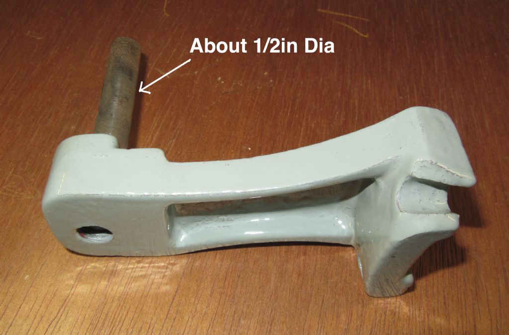

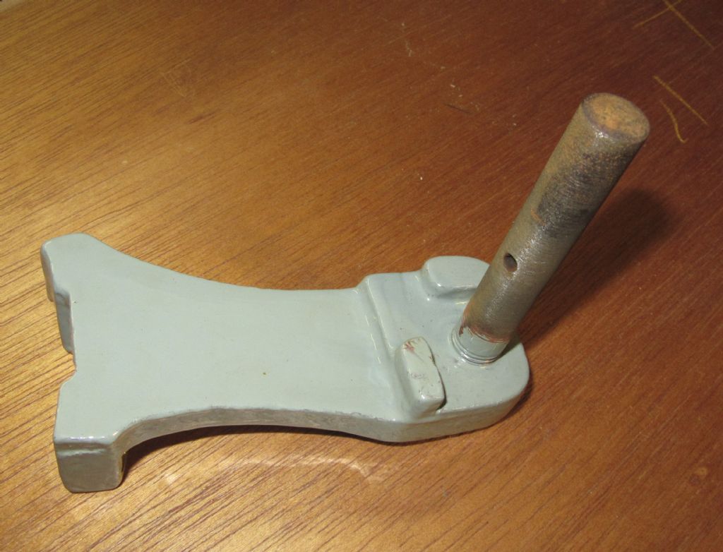

              I think the lathe is an ML3 but I am not sure as there are no markings on the bed. I would like to see some pictures of the dovetail mating parts of the tailstock to the bed that probably fix to the offside of the tailstock and are similar to those on the nearside of the tailstock. I reckon I am in for some copious filing and hacksawing but I’d like to see what the manufactures parts looked like before I start grafting. I appreciate that the tailstock lock is on that side and is probably simply a made up nut fitted with a lever that fits on the protruding stud shown in the picture. If anyone has a model similar to the pictures of mine I really would appreciate a view of your tailstock clamping and slide-way parts and perhaps a suggestion as to the model type. I will read the instructions on creating an album and upload some pictures

                In your "what goes here" tailstock photo is a clamping piece – rather similar in shape to the toolpost clamp – and, of course, a threaded piece with a lever attached to tighten and lock the tailstock to the bed. Sorry I can't give further details as I no longer have that machine.

                  saddle.jpgimg_0009.jpgimg_0004.jpgHi, thanks for input it all helps to conjure up a picture of what I have to make.saddle.jpg

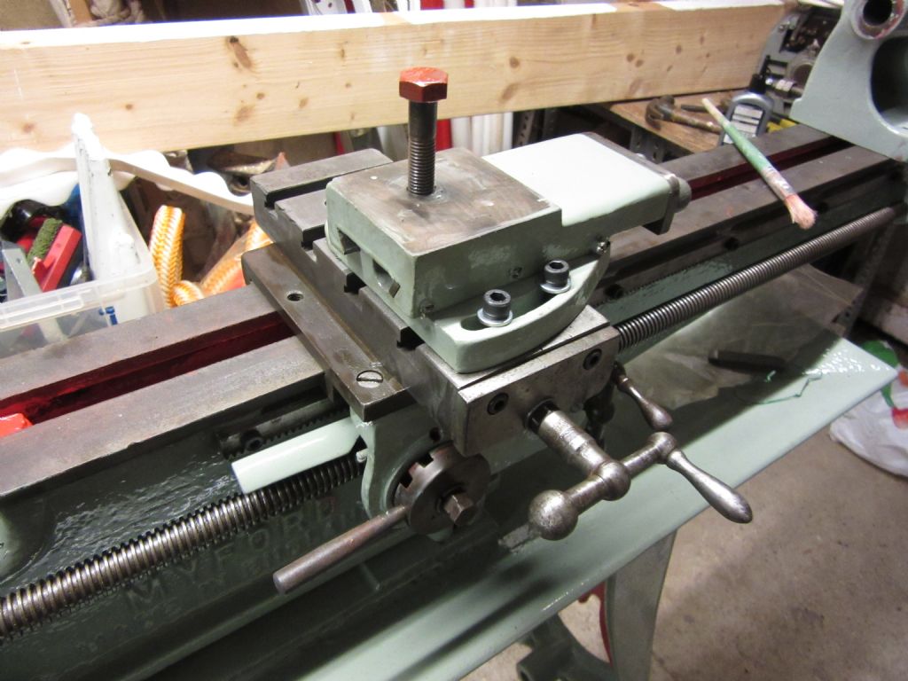

                    Thanks again Norman, I have just been painting the tool post clamp when I thought I've already painted a piece this and wondered what the devil it was for. Then your words came back to me and there it was hanging up in front of me! Another problem solved. Only the motor to mount now and make up a 'serpentine' flat belt for the countershaft. I have the original leather drive belt.

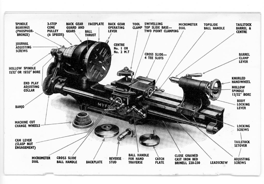

                      Norman was quite right in describing the rear shear fitting for the tailstock, it was from memory a divided fork shaped component in cast iron with the roughly 1 inch wide lugs roughly shaped to fit the shape of the bed dovetail. A pretty crude thing really but all it had to do was clamp the tailstock down on the bed .
                      I have attached a picture from the handbook of the whole lathe
