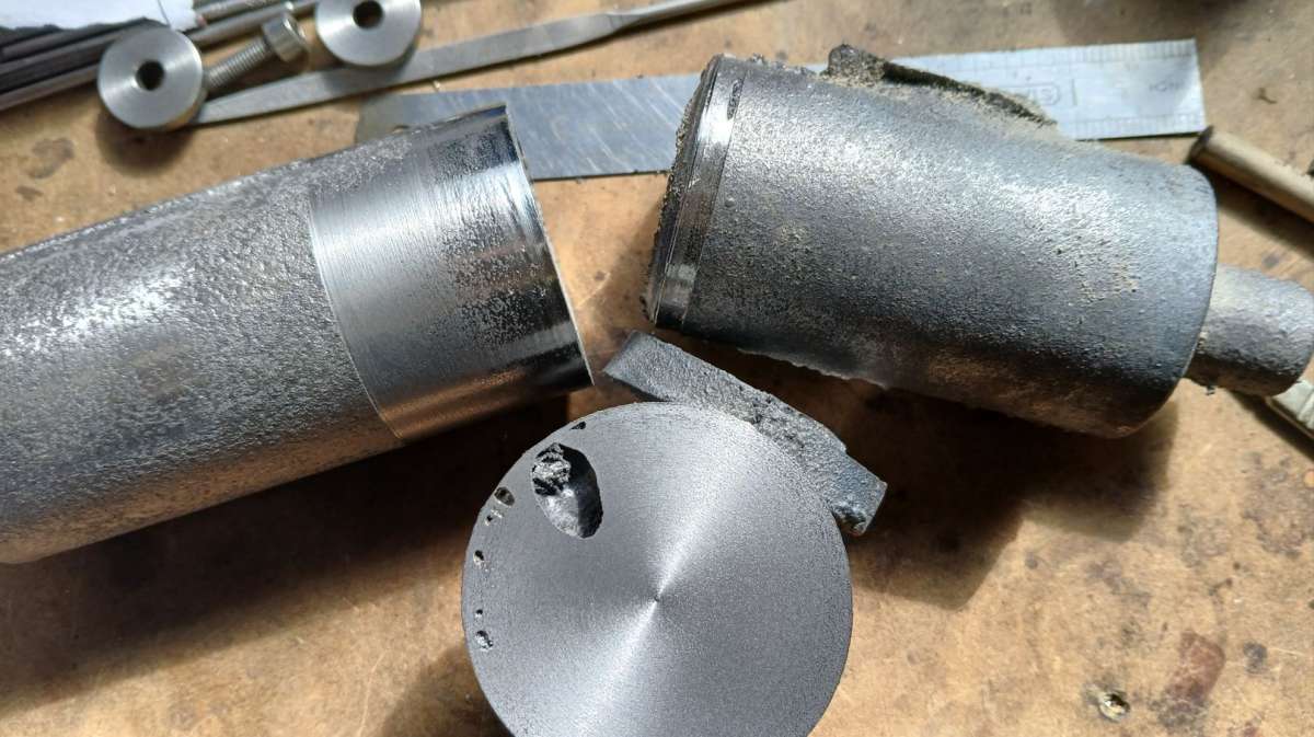

      While putting the finishing touches to the latest engine and waiting for paint etc to dry I possibly foolishly in hindsight dug out a casting set to pass the time.
      First I chucked up the cylinder liner approx 100mm long x 50mm diameter and proceeded to destroy 3 inserts. Both ends were so hard the carbide was just getting worn in seconds. Put it away thinking maybe I would heat treat it and have another go.
      Next was the piston casting, decided to skim the skirt so I could hold it firmly to then machine the chucking spigot. Another insert bit the dust with the same problem of chill. Now starting to think about buying a foot of 50mm cast iron bar as heating may not work and even if it did the resulting iron was not going to be the nicest to machine for a parallel cylinder and close fitting piston.
      Swapped over to the 4-jaw and thought I would have a go at the cylinder head. About 2mm of draft angle machined away reasonably well so I took a measurement and deduced that 4.5mm thickness still needed to come off the 58mm diameter flange. Started to hear an interrupted cut but pressed on even though I could see something getting bigger on the revolving machined surface. When I turned the lathe off this is what I found. The large hole goes almost to the ctr and is right where one of the three head bolts goes so little chance of getting a good head seal. As this is a hot tube engine with a lamp burning right under the head JBWeld is not going to be an option. I could CNC it from a 50mm long slice of 70mm cast iron bar but have started to loose interest with still other yet untouched castings to come.
      Also if I did heat treat the other two castings what are my chances of finding holes in them if I do get under the skin?
      Castings, don’t you just love them☹☹☹
      cast crap

        Not that I wish you any ill feelings, but it is good to see that such an accomplished engineer as yourself experiences these difficulties now and again.  I hope the chunk of cast iron bar you purchase has a better integrity.

            When I had some wheel castings with really hard spots the only thing that worked was brazed carbide with a big nose radius. Tips just crumbled quick time. I should have sent the castings back, but impatience ruled

                With a final wall thickness of 2mm the cylinder liner would likely distort under the force needed to drive even brazed carbide through the hard areas. Not so bad on something like a hefty flywheel rim but unlikely to end happily on the liner.

                      Apart from the time taken to set up a casting, the chances of defects is always present. This has happened to me more than once and is one of the reasons I machine from the solid, or fabricate. Not to mention the variability of the material.

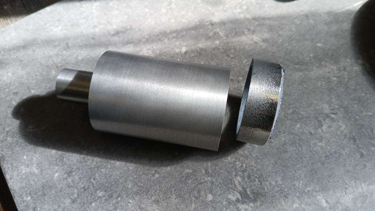

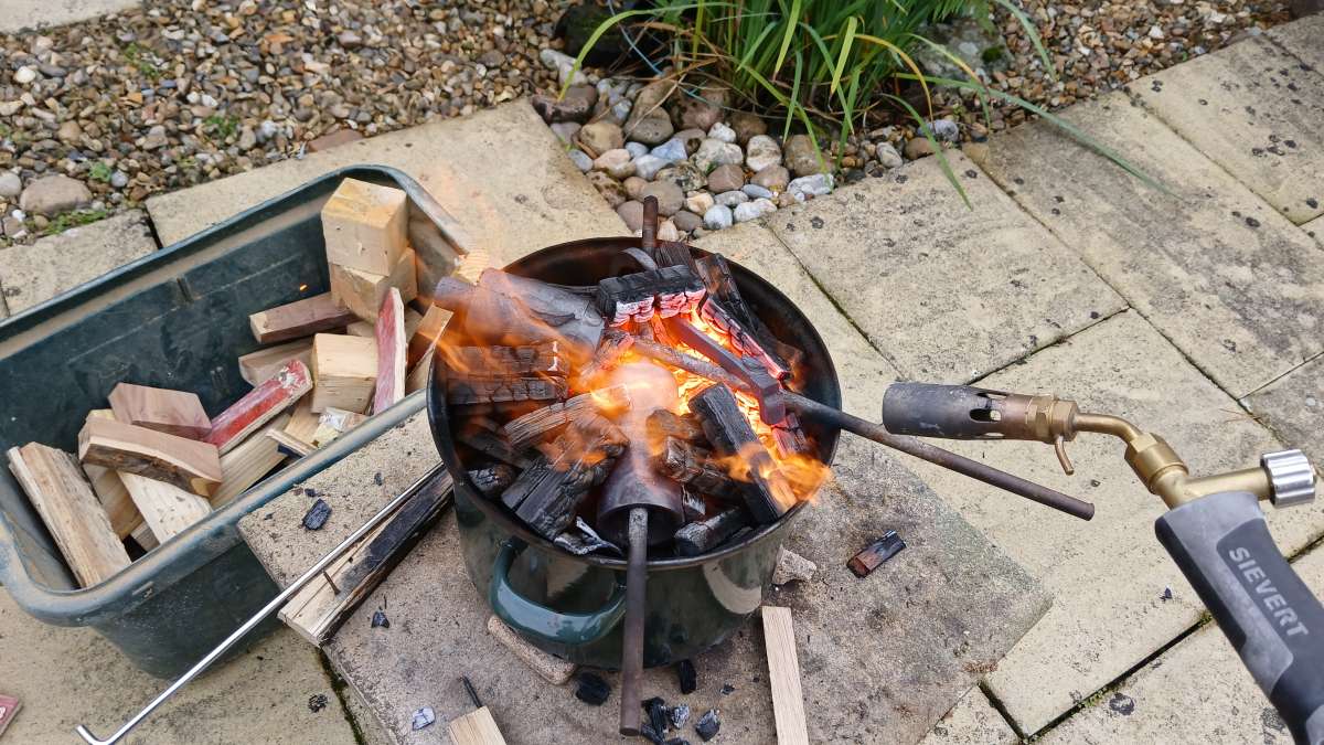

                          I did give the hard piston and cylinder liners a cook and blast with the Propane but It did not make much difference, the smaller end of the eccentric rod did soften up nicely.
                          20250914_094306
                          I don’t have any drawings for this engine, just the castings but felt the piston was too long so managed to cure that by cutting off the hard area which is easily seen as the bright shiny metal
                          20250919_140703
                          Jury is still out on the cylinder head, I’ve filled it with JB Weld and will do a bit more machining but as it is quite close to the blowlamp that heats the hot tube I’m a bit worried about heat. The cylinder liner I will do from 50mm cast iron bar though if anyone knows of a source of short lengths of honed hydraulic tube 44-45mm bore would also conside that as a liner.

                            The alchemists of old tried to turn lead into gold and whilst the form the carbon takes can be adjusted by heat and cooling, the heat has to be over an extended period of soak. 1000 – 1100 C.  I doubt that the barbecue was hot enough or for long enough. I can let you have 12″ of 2″ piston rod to bore out. Noel
