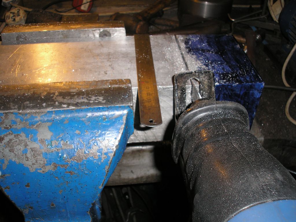

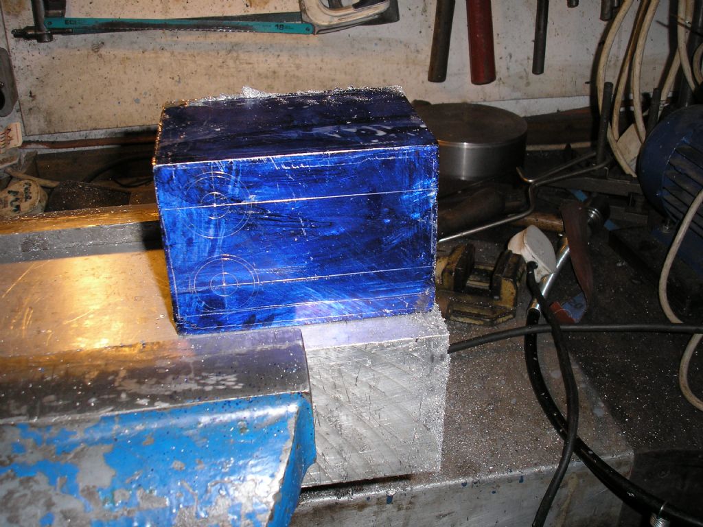

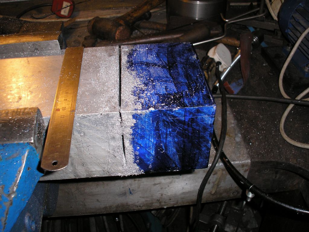

                                    As many of us have limited access to the recommended machines for certain jobs we have to do things the hard way or improvise.
                                    I purchased years ago from an auto jumble a block 3” x 4.25” x 12” of 6082 Ally and decided could use it for my full size flash steam water and fuel pump bodies two are required.
                                    Thinking it’s going to be a hand hacksaw job I remembered a cheap Aldi electric hand reciprocating saw bought from my local store.
                                    With a metal blade have cut up a 1/4” angle trailer in the past so dug it out and put a coarse long wood blade in it (no carbide teeth on it) with a bit of lube done the Ally cutting.
                                    Have found many of the budget tools from Aldi are OK for occasional use and a lot cheaper than professional ones.
                                    I did this today in about 15 to 20 minutes.
                                    Ally block cuttingAlly block cut.Ally block.
