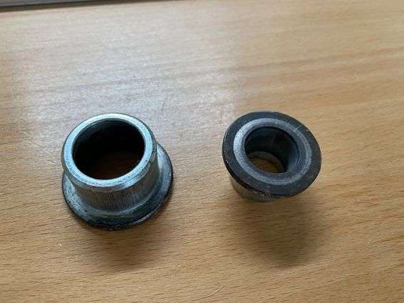

      Good morning gentlemen,
      I’m looking for advice on materials for a tapered ball joint bush. I have a 1970 metric Boxford lathe and use predominantly carbide insert tooling. The original bushes look to be of hardened steel as they don’t scratch easily, they are not particularly large (OD 27mm) so If I have to heat treat them I plan to use a propane touch and hearth and anneal in an oven, but would it be possible to produce these parts with a harder steel in the first place?
      Any advice much appreciated
      Chris

        Silver steel might do it.
        What is the application? High load?

          Lower ball joint on a steering knuckle/upright. Some of these cars came with cast steel uprights but later models were fitted with aluminium with steel bushes, the bushes have a habit of sticking to the taper and getting thrown away with the ball joint, hence the need to remake them as they are not or were ever a part sold separately.

            EN8 hardens ok, bot you could make your job easier if you used something like En 9 or 32 and then case harden.

              Is this a bush for a track rod end ball joint on a vehicle.
              Actually regardless of the purpose, I’m not sure it needs to be hardened. There is no movement once the taper is mated and if the outer diameter of this bush is a running fit of some sort how will it be held whilst the nut is tightened.
              I’ve made quite a few flanged bushes with a taper bore that are press fitted into a parallel hole, and used whatever steel was to hand.

                I remember doing case hardening in metal work at school, made an adjustable wrench which I still have, we used Kasenit (which has just aged me :0) ) which I don’t think you can get any more, probably got something to do with the cyanide! Forgive my ignorance here but why would case hardening be any easier than just heating the part up and quenching followed by annealing?

                  I did wonder if these parts really needed to be harden but as the original parts are I thought I’d better replicate that. Yes they are a press fit into the aluminium knuckle, one is for the tie rod and one is for the lower control arm. The engineers at Alfa thought for some reason or other that they should be hardened.

                    If you use EN32b steel and case harden they will likely to be strong and wear resistant. You can use CBM nottingham heat treatment for the case hardening. they are very helpfull and will post if far away or collect more localy.

                        I’m still not convinced that a bush that accepts a (relatively permanently fitted) tapered spigot of a suspension ball joint. that is a press fit into an aluminium casting or forging needs to be hardened.
                        The ball itself and its integral tapered stem will be manufactured from some pretty tough steel and probably heat treated but certainly not brittle although its taper stem will at least feel quite hard.
                        Making a bush with a matching taper bore and then hardening is adding complexity for no useful purpose. A softer steel will allow for minute inaccuracies as the surface will deform/conform and ensure better mating of thetaper surfaces.
                        In use the taper stem is drawn into the bush and suspension part by a nut and is then in place probably for years. There is no movement between ant of these parts and no need whatsoever to harden the bush.
                        The original part that the OP’s thought was hardened might have been made by a sintering process purely for manufacturing expediency so subjectively would ‘feel’ quite hard.
                        Why does this suspension part (that carries the bush) need a new bush fitting?

                          I have just re-read the OP’s second post in this topic in which he explains how the original bushes can get lost and as they are not service parts, not available as spares. (in which case where did the bush picture come from?)
                          The new bush may need its external diameter sizing to suit the actual suspension casting bore ID rather than a straight copy of the original.
                          I still maintain that this bush does no need to be hardened.

                            Why the 3rd degree? I pressed them out so I could get accurate measurements to re-create a second pair. Alfa recommend replacing the whole steering knuckle if they do come out and even go so far as producing a tool to remove the ball joint taper without disturbing them.
                            However your argument makes a good point and I’m inclined to agree with you as there is no movement in any direction.

                                Since the bush is going into an Aluminium alloy component, do NOT use brass or bronze, which contain copper.
                                With dissimilar metals, even steel, in the presence of an electrolyte, (road salt for instance) there will be electrolytic action.  It will be far less with Aluminium alloy/Steel than with anything containing copper.
                                The Aluminium will be corroded away, in preference to the copper containing part.
                                You can’t chance that with a suspension component!

                                  EN19T or EN24T chrome moly steels are harder and stronger than mild steel and machinable. They could be used without any subsequent heat treating. The bush could be a just sliding fit and installedwith Loctite 601 or 638 which would ensure that wated did not finditsway into the joint. Aircraft bushes would have a fillet of sealer around the joint interfaces to further seal against corrosion.

                                          I’m beginning to think  that perhaps the only reason that this part might be hardened is to prevent any damage to the mating surface when the parts are assembled/disassembled?

                                            Yes, so a splitter can be used without risk of chewing the face of the ‘fixed’ half up.

                                              Also would prevent mating face from damage when trying to manoeuvre the lower control arm ball joint taper into the bush when working under a car, delicacies are the first casualties along with the skin on your knuckles in this environment! Doesn’t take much damage to stop a taper fit from working correctly
