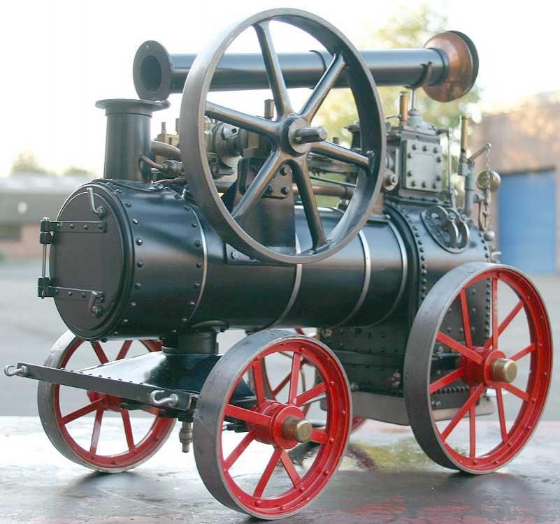

      This model of a Marshall portable engine in 1 1/2 inch scale to the W.J.Hughes design was published in "Model Engineer". Does anyone know which issue ?

          I have a feeling that this was Hughes' last engine and he did not get to complete the articles, if you search Marshall here it starts in 1973 and then looks to be continued by someone named Kibbey.
          Reeves say much the same and I see they have a saving if all castings bought as one
          Edited By JasonB on 01/11/2020 07:34:24

            Kibbey, who completed the build series in ME, was chief draughtsman at Rolls-Royce ,Derby, in the '70s.

              Here is a snippet of my own personal Magazine index.
              Listed in Title, Issue, Page, Mag, Author, Volume, Date.
              I plan on building this engine at some point if I live long enough. I have all the castings and materials stashed and a photocopy of the ME articles is somewhere buried in the loft.
              Phil
              MARSHALL PORTABLE ENGINE 1½" SCALE 3541 701 M.E. HUGHES W.J. 142 16/07/1976
              MARSHALL PORTABLE ENGINE 1½" SCALE 3543 805 M.E. HUGHES W.J. 142 20/08/1976
              MARSHALL PORTABLE ENGINE 1½" SCALE 3545 898 M.E. HUGHES W.J. 142 17/09/1976
              MARSHALL PORTABLE ENGINE 1½" SCALE 3547 1014 M.E. HUGHES W.J. 142 15/10/1976
              MARSHALL PORTABLE ENGINE 1½" SCALE 3550 1196 M.E. HUGHES W.J. 142 03/12/1976
              MARSHALL PORTABLE ENGINE 1½" SCALE 3552 10 M.E. HUGHES W.J. 143 07/01/1977
              MARSHALL PORTABLE ENGINE 1½" SCALE 3553 80 M.E. HUGHES W.J. 143 21/07/1977
              MARSHALL PORTABLE ENGINE 1½" SCALE 3559 465 M.E. HUGHES W.J. 143 15/04/1977
              MARSHALL PORTABLE ENGINE 1½" SCALE 3577 75 M.E. KIBBEY R.L. 144 20/01/1978
              MARSHALL PORTABLE ENGINE 1½" SCALE 3579 212 M.E. KIBBEY R.L. 144 17/02/1978

                MARSHALL PORTABLE ENGINE 1½" SCALE 3582 376 M.E. KIBBEY R.L. 144 07/04/1978
                MARSHALL PORTABLE ENGINE 1½" SCALE 3584 508 M.E. KIBBEY R.L. 144 05/05/1978
                MARSHALL PORTABLE ENGINE 1½" SCALE 3586 624 M.E. KIBBEY R.L. 144 02/06/1978
                MARSHALL PORTABLE ENGINE 1½" SCALE 3588 749 M.E. KIBBEY R.L. 144 07/07/1978
                MARSHALL PORTABLE ENGINE 1½" SCALE 3590 873 M.E. KIBBEY R.L. 144 04/08/1978
                MARSHALL PORTABLE ENGINE 1½" SCALE 3592 1016 M.E. KIBBEY R.L. 144 01/09/1978
                MARSHALL PORTABLE ENGINE 1½" SCALE 3594 1130 M.E. KIBBEY R.L. 144 06/10/1978
                MARSHALL PORTABLE ENGINE 1½" SCALE 3596 1260 M.E. KIBBEY R.L. 144 03/11/1978
                MARSHALL PORTABLE ENGINE 1½" SCALE 3598 1413 M.E. KIBBEY R.L. 144 01/12/1978
                MARSHALL PORTABLE ENGINE 1½" SCALE 3600 12 M.E. KIBBEY R.L. 145 05/01/1979
                MARSHALL PORTABLE ENGINE 1½" SCALE 3601 106 M.E. KIBBEY R.L. 145 19/01/1979
                MARSHALL PORTABLE ENGINE 1½" SCALE 3602 143 M.E. KIBBEY R.L. 145 02/02/1979
                MARSHALL PORTABLE ENGINE 1½" SCALE 3604 272 M.E. KIBBEY R.L. 145 02/03/1979
                MARSHALL PORTABLE ENGINE 1½" SCALE 3606 372 M.E. KIBBEY R.L. 145 06/04/1979
                MARSHALL PORTABLE ENGINE 1½" SCALE 3610 640 M.E. KIBBEY R.L. 145 01/06/1979
                MARSHALL PORTABLE ENGINE 1½" SCALE 3611 702 M.E. KIBBEY R.L. 145 15/06/1979
                MARSHALL PORTABLE ENGINE 1½" SCALE 3614 912 M.E. KIBBEY R.L. 145 03/08/1979
                MARSHALL PORTABLE ENGINE 1½" SCALE 3615 958 M.E. KIBBEY R.L. 145 17/08/1979

                  Thanks Phil,
                  The problem is the ME archive only goes back tp Issue 4153. Will have to try elsewhere.
