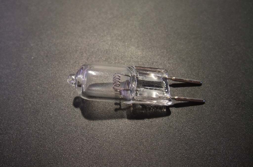

                    I think this is a G4 bulb?
                    I was thinking that I may buy a 12V 35W G4 bulb which will draw 3A, and use a transformer like this – **LINK**
                    Edited By petro1head on 17/05/2014 19:03:46

                            Just bought some of these **LINK**
                            to replace the G 4 bulbs in some of my machine lights. Not sure if they are G4's but identical to the one shown above.
                            Problem I have is some of my low volt lights are 12v and some 24v.
                            I know this won't directly help petro1head as his transformer is shot but a simple wall wart type one will run these with no problems.
                            These will run off AC or DC and 12 to 24 volts, changes 4 so far and all but one have been OK, that one is flickering bad and as I wanted to use the machine I just plugged the halogen bulb back in and will look at it later, judging by the brightness I'm guessing it banging out far more than 24v.
                            It's probably a 220v input transformer and on 240 it's running high.
                            They put a nice light out, fit in as a direct replacement and best of all you don't burn yourself on them.

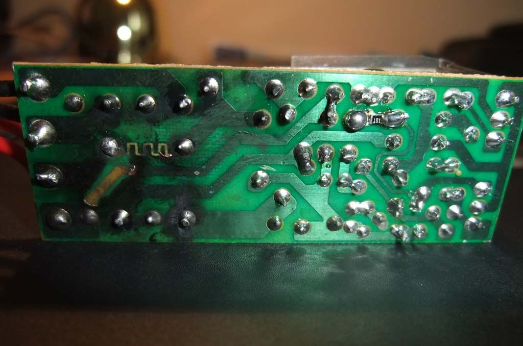

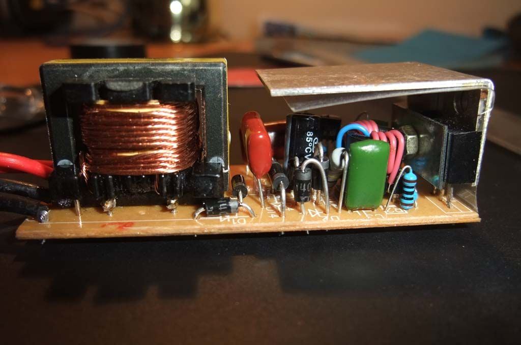

                                #152825
                                Les Jones 1
                                  @lesjones1
                                  Hi petro1head,
                                  From the picture of the old "transformer" it is an electronic one. This is basically a switched mode power supply with no rectifier on the output. The output will be a high frequency square wave. It is not normally cost effective to repair these. I agree with John's comment about burning yourself if you fit 35 watt halogen bulbs in this type of light. (I fitted a 35 watt in place of a 20 watt and found this.)  I changed over to using LED type MR16 bulbs some time ago and would recommend it. The pins on MR16 and G4 bulbs are the same so there is no need to change the holder. One thing I have found is that some (Not all) LED lamps designed for 12 volts do not give the full output when fed from 12 volts DC. I think this is probably the case with the ones in the link John has given. (If you want a detailed explanation of why this is then can explain it.) If you go down this route then I suggest using about a 15 volt power supply.

                                    Martin W
                                      @martinw
                                      Hi
                                      I agree with Les this looks like a switched mode power supply. However if you look at the trackside picture of the printed wiring board there is a light coloured castellated pattern half way up and on the left hand side. I believe that this is a printed fuse, or perhaps I should say 'was' a printed fuse. If this is on the output side then I suspect that the bulb failed and shorted the output which blew this fuse. If on the input side then most probably it is a component failure. Looking at the general arrangement I suspect this fuse is on the input side of the board but it is not clear.
                                      Assuming that the problem was a failing bulb, and no other damaged occurred, then the board can be easily repaired by soldering in a wire ended fuse of appropriate value across the gap left by the blown track. There even appear to be component solder pads conveniently available. Needless to say that you will need to ensure that any replacement can't short out on to the case or any other metal bits.
                                      Below the fuse is another track that is exposed whether this was caused by the fault or is a production artefact is unclear but may be worth looking at.
                                      While the above doesn't solve your immediate problem it may prove to be a cheaper way to repair the unit.
                                      Good luck and have fun
                                      Martin
