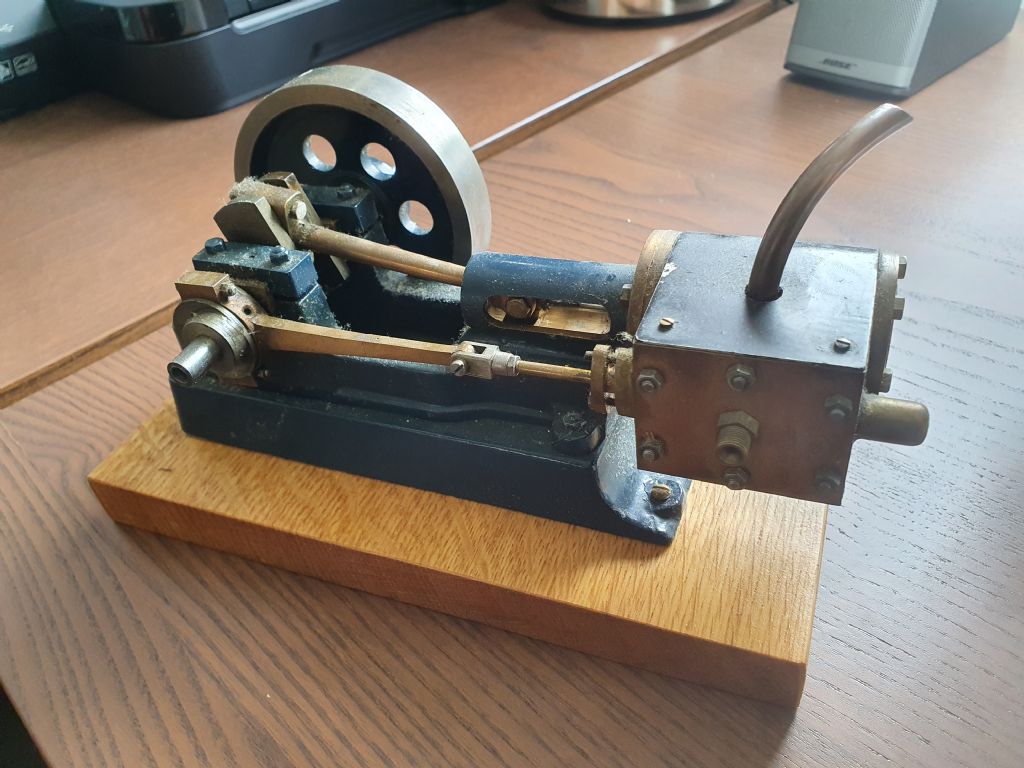

        I have inherited several small engineering models from my late farther-in-law. I'm guessing that he inherited them too, so they are probably in the region of 40 to 50 years old. It looks like they run on compressed air and the input valve/fitting looks something smaller than a car tyre input valve. What do I look for in terms of a small air compressor and what is the specification/type/name of the thread on the input valve? It doesn't;t need to be massive, I'm happy to run them one at a time just to see them in action.

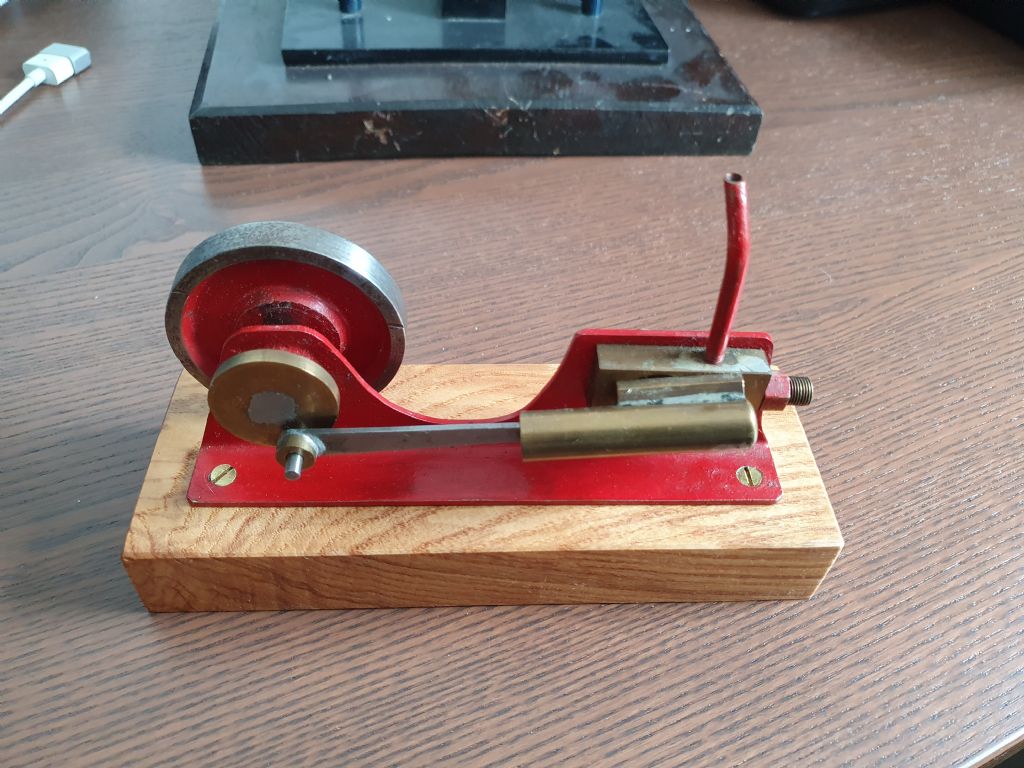

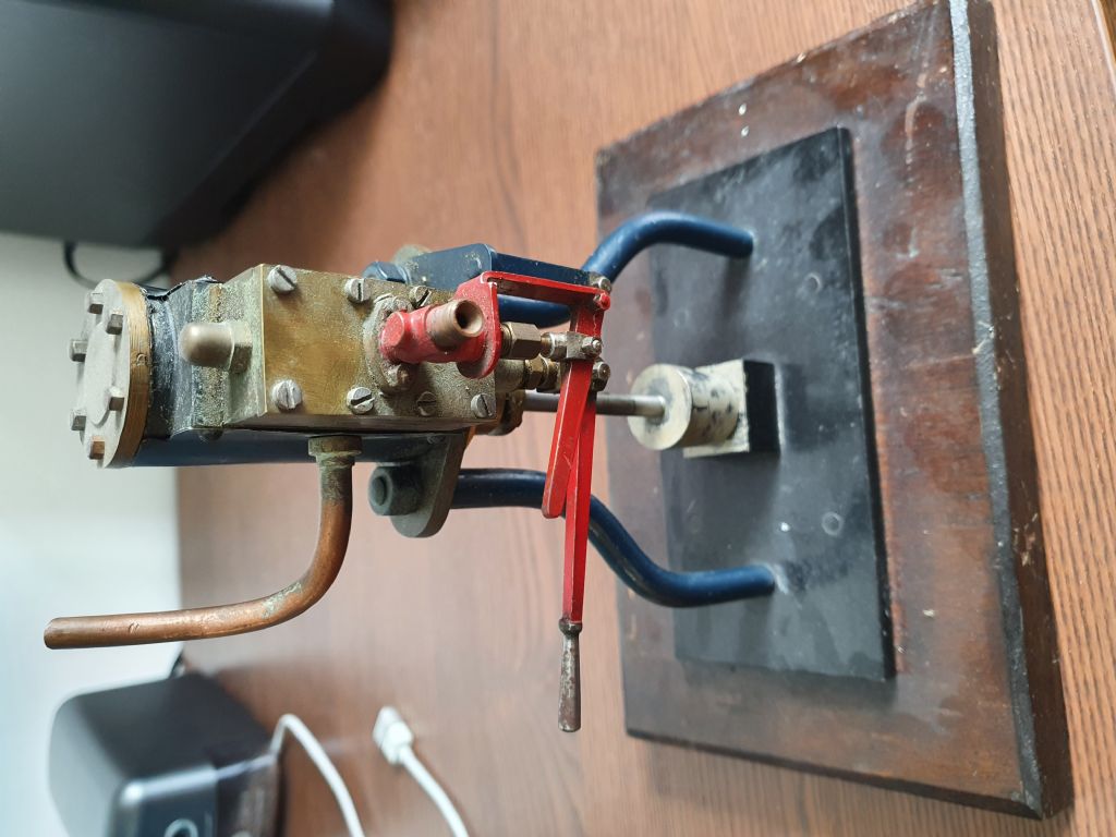

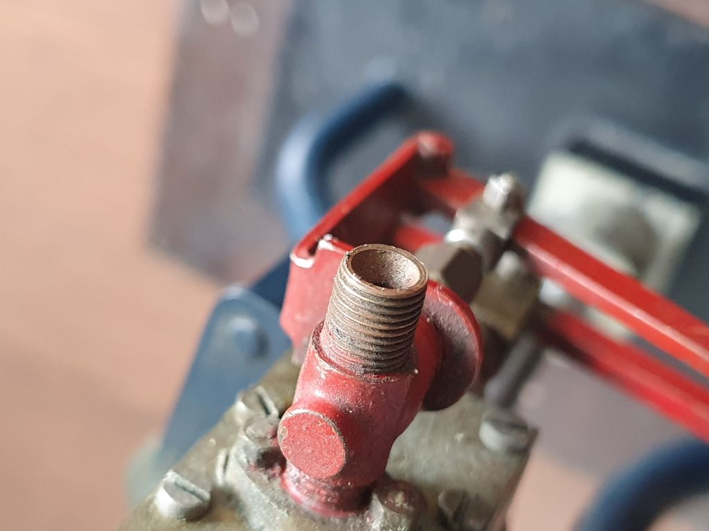

                  Hi, thanks for the information and questions so far, clearly more complex than I first thought. I have added 4 photos here. Three of the models and one close up of the air input. I have checked the other 10 models that I have and the input is exactly the same on all of them. The diameter of the tread is about 6.4mm, which is a quarter of an inch. There are about 7 or 8 threads in 0.2 of an inch so thats 30 to 40 per inch if that helps. Any advice on what to buy to connect them to a small air compressor would be much appreciated.

                    Those connectors look to me like Model Engineer (ME) threads, a common thread for steam/air connections in the model engineering world. 1/4" is a common size but beware, they come in 32 and 40 threads per inch.

                        Jim, Thanks for your help. They look about the same. I'll have to attempt a more accurate thread count to get it accurate. Looking at a different model I'm getting 10 threads per quarter of an inch, so that would indicate a pitch of 40 tpi. also it does look like a fine thread. I'm based in Macclesfield, Cheshire.

                          1/4 x 40 sounds like a ME thread.
                          So you will need a nut and a nipple (Which you can then solder onto a short piece of pipe ). For low pressures, soft solder may be adequate, although silver solder would be better..
                          You should quote the size of pipe that you are planning to use, after having checked to see what nipples are available
                          If you don't want to, or cannot make suitable fittings. they may well be available from suppliers of such things.
