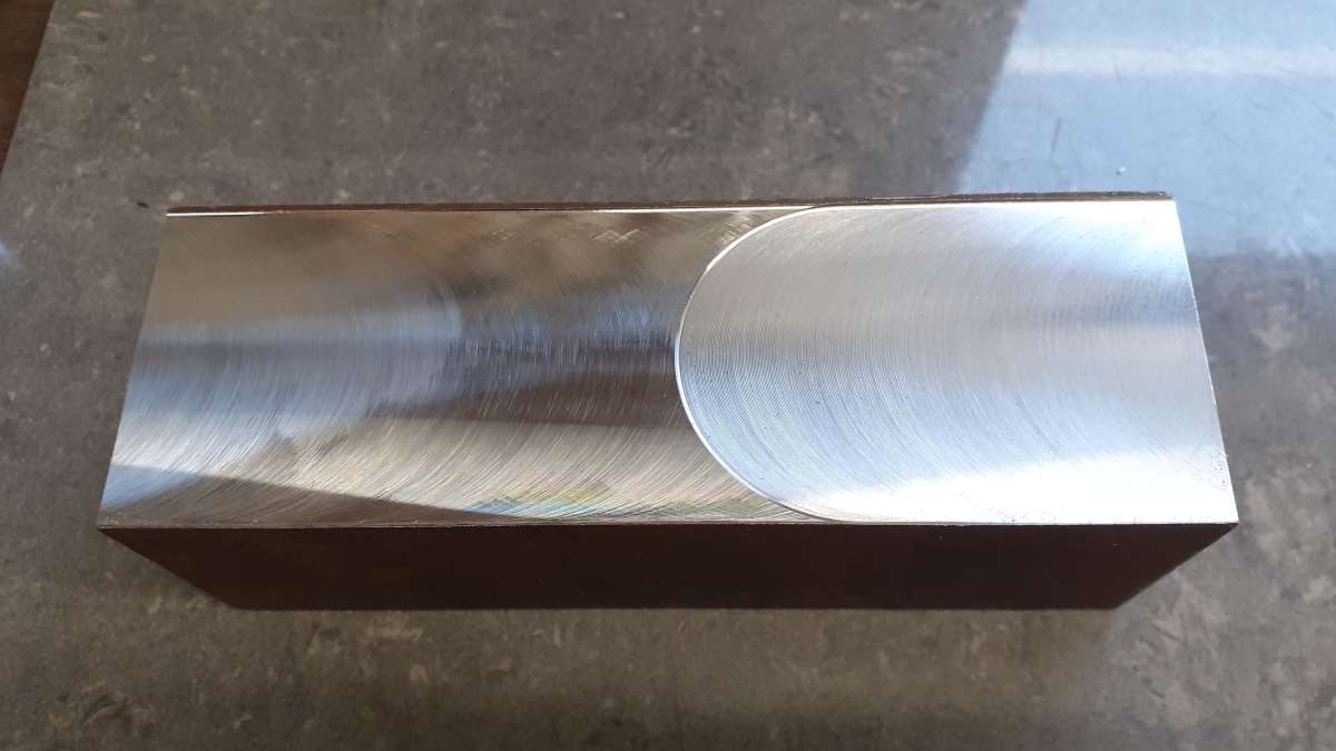

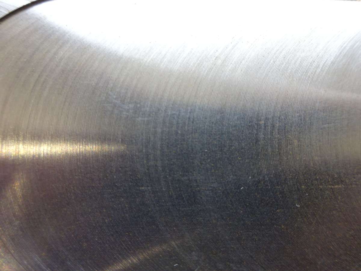

                  #827723
                    On duncan webster 1 Said:
                    Jason’s feeds and speeds seemed very conservative to me,
                    Would any of the shaper owners care to give the sort of feeds, DOC, stroke rate and direction they would use for my example piece of steel 4″ x 2″ with 1/8″ to come off. I did use a stroke rate of around 2/3rd of a few shapers I looked at but my feed may have been a bit fine.
                    Unless Duncan thought my milling feeds were conservative, They were as I was using a feed crate for moulded cutters, If using the ones for non ferrous then I could feed at 450mm/min not 200mm/min. 18 IPM not 8IPM. Which gives this sort of finish
                    Photo 12
                    It’s the one on the right of a 50mm wide block of EN3
                    Photo 10
                    #827726
                    Andrew Crow
                      @andrewcrow91475
                      On my rather old 10 inch shaper I would probably take two cuts, the first at 0.100 and 0.005 feed rate and a second cut of 0.025 with the same feed rate.
                      So about 8 minutes actual cutting time plus a bit for winding back and resetting tool depth.
                      I wouldn’t expect to get anywhere near the surface finish or speed that you can get with a modern milling machine and carbide insert tools. I only have a light vertical mill so removing large amounts of waste material takes time anyway.
                      But, for me time isn’t critical (even though at my age I’m running out of it pretty quickly) when I’m blocking up particularly on castings I just regard it as being a cheaper option on tooling and probably quicker for me in some cases.
                      I also find it rather therapeutic watching a shaper cutting of big curls of steel.
