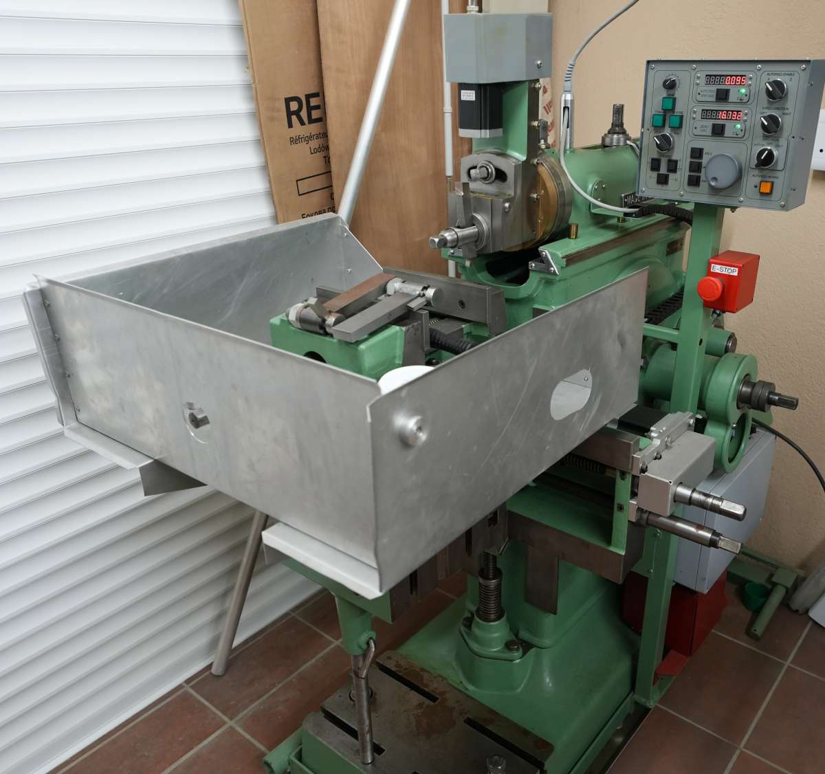

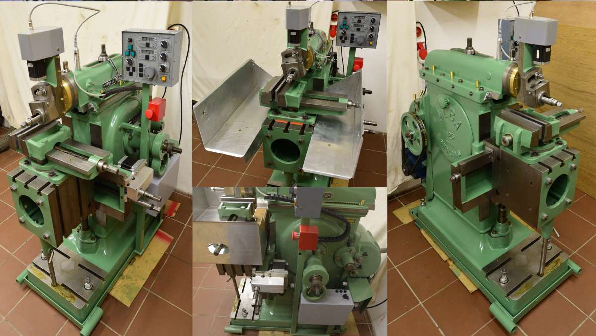

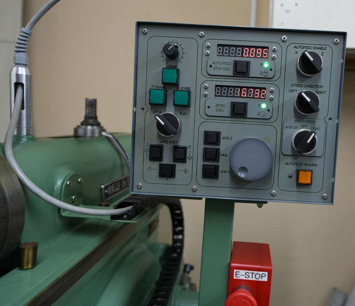

                              I have three small bench top mills (Emco FP-2’s) and I still use this shaper a lot!
                              ShaperCrop
                              Shaper1
                              ShaperControl

                                  I’m interested about this working unattended being an advantage.
                                  To me the only reason why you can do that is a shaper is fairly slow.
                                  lets take a 50mm x 100mm  (2″ x 4″) block of steel that needs 3mm (1/8) taking off the top. Not sure if a medium shaper could do it in one pass or two and would a 0.05mm (0.002″)stepover be about right for a good finish? ( only used one at school) say 1 second per stroke and that is 30mins per pass. EDIT you would probably do a 100mm long cut so 15mins
                                  I could do that on a lightweight hobby mill in 3 mins with a insert face mill and probably less setup time than the shaper. Also no need to then transfer it to the mill for final finish cut as someone mentioned earlier. And it’s all set up if I want to start putting holes etc in it.
                                  Maybe that is why people ask how I get so many models made. Though that other 27mins would give you time to dust off the quorn castings😉

                                    Joseph
                                    I’m totally envious of your shaper control system. It really exploits the shapers ability to run unattended to the nth degree.
                                    SoD gives a very valid list of objections to using a shaper due to its perceived lack of versatility. However nearly everything on his can’t do on a shaper list can be managed almost as well on a pillar drill with decent co-ordinate table. Even more so if given good DRO and power down feed.
                                    Oversimplifying things a mill is essentially a drill with built in workpiece X and Y movement capability. So driving a mill to produce flat surfaces, slots et al is a fairly simple mind-set expansion from using an ordinary drill. With much less verbal encouragement when trying to set holes at precise spacing.
                                    With a shaper you have to mentally and procedurally separate producing the flat and linear features from the round ones. Which is different way of working.
                                    I’d say that these days in the home shop its DRO systems that really exploit the mills advantage as making quite complex jobs procedurally simple for folk who haven’t been professionally trained.
                                    A shaper equipped in the manner shown by Joe is, in principle, capable of unattended working to specified sizes in a manner similar to a conversationally programmed CNC lathe. Hard to object to having to transfer to another machine for adding teh round holes when the shaper is doing the flat stuff unattended effectively doubling your workshop productivity by running two machines at time. Given the inevitably limited hobby hours that a normal lifestyle permits  some attention to productivity is needed, even though its “just a hobby”, if you are ever to get anything done.
