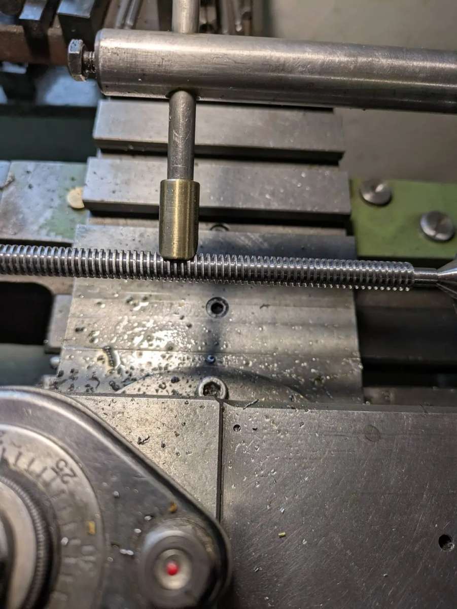

                A temporary travelling steady can be lashed up in various ways, ranging from a block of hardwood or brass or ally  with a hole drilled in it and either clamped to the cross slide or in the toolpost, through to more deluxe fabricated efforts.
                I saw one recently that was a simple piece of brass slid along a round steel bar mounted on the headstock. It pressed on the rear of the job in the middle of the long thin section and stayed in place, so not travelling.

                    This steady is mounted on steel bar attached to the tailstock for screwcutting 10mm Acme.
                    img_1_1782906590391
