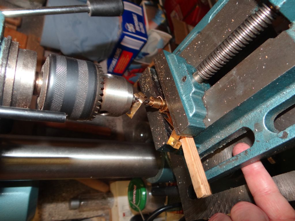

                Posted by La Cathedrale on 24/02/2021 08:53:03:
                Thank you Nigel
                You DO hold a vice by hand in a drill press though, don't you?
                Not without having it at least loosely bolted down I dont. Even a 1/8" drill bit will fling an unsecured vice across the workshop if its not bolted down and the bit catches.
                Usually it will stop when it hits the the freshly painted petrol tank of your Brough Superior or the windscreen of the Minister of War's car.
                So bolt the vice down but leave it lose enough to slide around into final position by hand is much safer.
                But no idea about using those drill pads. Either clamp or at least use a piece of material long enough to rest against the bed or carriage with a bit of wood for protection.
                You can also bolt the small myford vice to the faceplate to hold small jobs for drilling. Fair bit of counter weight needed though.

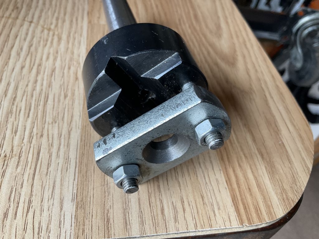

                                  While I personally don't own a drill pad and if I did would use clamps as suggested in this thread, a quick internet image search does in fact show several instances of work being held against the pad by hand.
                                  #529833
                                  Colin Heseltine
                                    @colinheseltine48622
                                    I have used a small V pad on the Cowells lathe for drilling cross-holes in pins. I used a very small machinist clamp to hold the item being drilled. The holes was only .75mm dia.
                                    Colin
                                    #529842
                                    Malc
                                      @malc
                                      Have had mine some time now and one of the first things I did was to make a “Holding strap” to keep work in place. Will try to post a picture.706c1085-b0a3-4622-8929-f6a62d31b241.jpeg

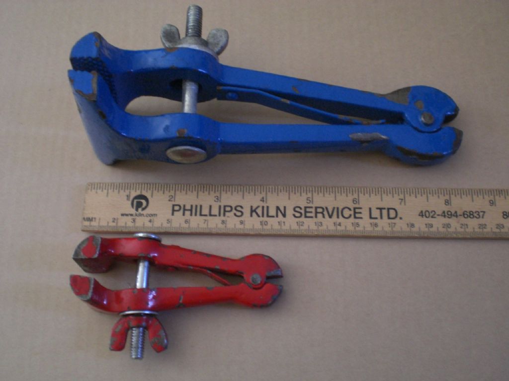

                                        I seem to have caused some confusion and consternation above.
                                        I said hand vice, not machine vice.
                                        Totally different tools.
                                        The hand-vice is a small tool whose jaws are the "feet" on connected legs, and is held in the hand. Some versions have an extended shank for better grip, or for holding in a drilled block of wood gripped in turn in the bench-vice. Obviously the hand-vice should be used only for holding small items against very low forces.
                                        The machine-vice is the one designed to be, and indeed should be, clamped to the machine table. It is the machine-vice that is mentioned by Hopper and illustrated by Dave.
                                        The book I cited (Blandford's Metal Turning) refers to drill pads but says nothing at all about clamping the work to them. If anything the author implies holding the work itself by hand!
                                        Neither Ian Bradley (The Amateur's Workshop) nor L.H. Sparey (The Amateur's Lathe) mention drill-pads at all. Not even in the plethora of accessories they encourage you to make.

                                          #530211
                                            Hand Vice = a variation upon this theme: **LINK**
                                            https://collection.sciencemuseumgroup.org.uk/objects/co431035/watchmakers-hand-vice-vice
                                            Sometime, as Nigel mentions, have a handle

                                              That now looks very similar to the "MT2 Tailstock Vee Adaptor" that I mentioned earlier from ARC. Wouldn't be without it.

                                                Hi, a hand vice is what I've known that which MichaelG has linked too. I have three of these, two of the red one and just the one of the blue one. Had one of the red ones in my tool assortment when I was working. I've used them mostly for filing small parts to size, which are a bit too fiddly to hold in one's figures, but are useful for holding small bits for drilling small holes in also and can be handy for bending a smal piece of sheet metal with a hammer for that odd bodge job, especially when doing site work.
                                                They always remind me of the leg vice in a Blacksmith's workshop.
                                                Regards Nick.
