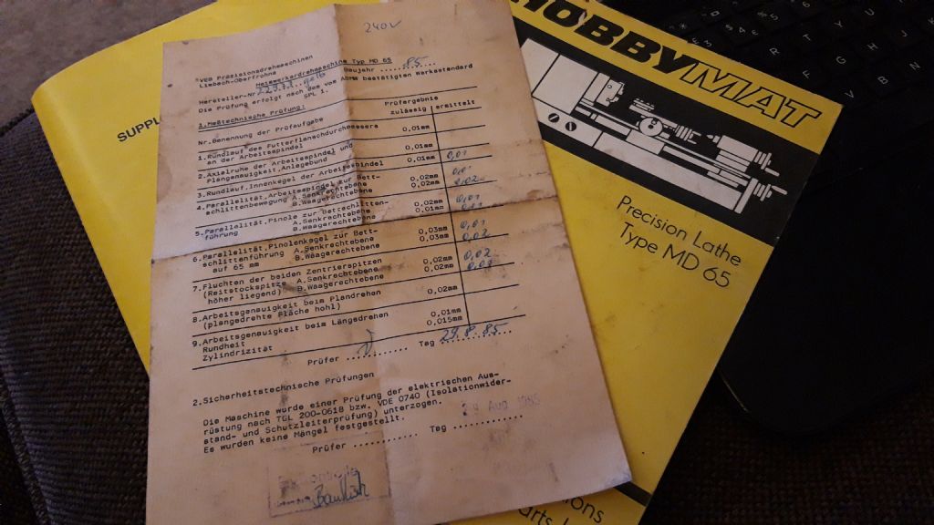

                  I have real Prazisionsdrehmaschinen MD65, but it's in the shed under wraps, so I checked the manual and there is no mention of tailstock adjustment.
                  My machine came with an inspection report, and from factory it is a very accurate machine, see photo. Your clone, wherever it came from, may not be as accurate from factory and the tailstock misalignment could be as it came from the factory.
                  Ian
