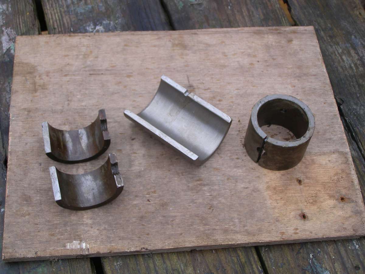

      Task: making two split sleeves, rather like big-bearing liners, to grip a 2.5″ dia overarm in its split clamps in the cast-iron body of a small horizontal mill whose original arm seems to have been 3″ dia.
      The clamping is by springing the casting itself – cheap and simple but a dangerous weak point.
      There were two sleeves in there, rather crude steel rings probably salvaged from something else, with a single saw-cut so trying to squeeze those down with the casting risked breaking the latter.
      Hours of careful turning and boring made two “come-in-handy” steel billets into a couple of short tubes, which I proved to size by assembling them and the over-arm to the mill without clamping.
      Then sawing them in half lengthwise, using the milling-machine.
      One pair fits all right, possibly very slightly looser than it ought be.
      The other pair closed up slightly, so is far too tight by distortion. The warning sign was that when making the first longitudinal saw-cut it kept gripping the slitting-saw, and at the end closed the cut.
      I have not met this problem previously on anything, so, any suggestions, please how I might recover them? If that’s even possible of course.
      Would annealing them help? Provided the oxidation and subsequent cleaning does not reduce their diameters so bringing us back to a different version of square one, and introducing a potential alignment error.
      I can revert to the makeshift sleeves that came free with the mill – cutting them completely in half so they close without unduly straining the machine. I didn’t want that though because they are a bit of a bodge.
      I ought add I may have been caught out by the steel for the one that is giving me grief. I have no idea what alloys either billets were. It cut very nicely but might be something rather exotic.

        If you can reach the inside, mill two (?or three) shallow axial slots disposed evenly within the curve and put a line of centre-punch dots down each one.
        In extremis you could drill lines of divots and punch those.
        A LITTLE GOES A LONG WAY so start gently with ‘a few’, and gauge the fit as you go, you can always add intermediate hits and ‘go around again’ if it doesn’t spread enough.

            You could try putting in two more equally spaced slots but only partially through,  it may help in being able to open up the bore.

              To reduce oxidation if heating you could pint with a garden lime slurry paint. Might be difficult to heat evenly and hot enough.
              I’d go with Andy’s slots.
              You could drill a few holes across the closed up slit and hammer in taper pins to open it out and remove when in place.

                        I adopted, I think, if I understand them correctly, Diogenes’ and Andrew’s suggestion of slots along the remaining original sleeve. Using the slitting-saw, and rotating the sleeve by eye from position to position in a T-slot as “Vee-block”, I cut very thin slots almost through the wall.
                        Oh, and the “Haunted Workshop” ghosts then added their bit by hiding one half of the split, faulty sleeve!
                        So eventually I finished with a reasonably satisfactory compromise. One of the new two-part sleeves in the front eye, the original sleeve for the rear eye, with thin axial grooves to make it flexible.

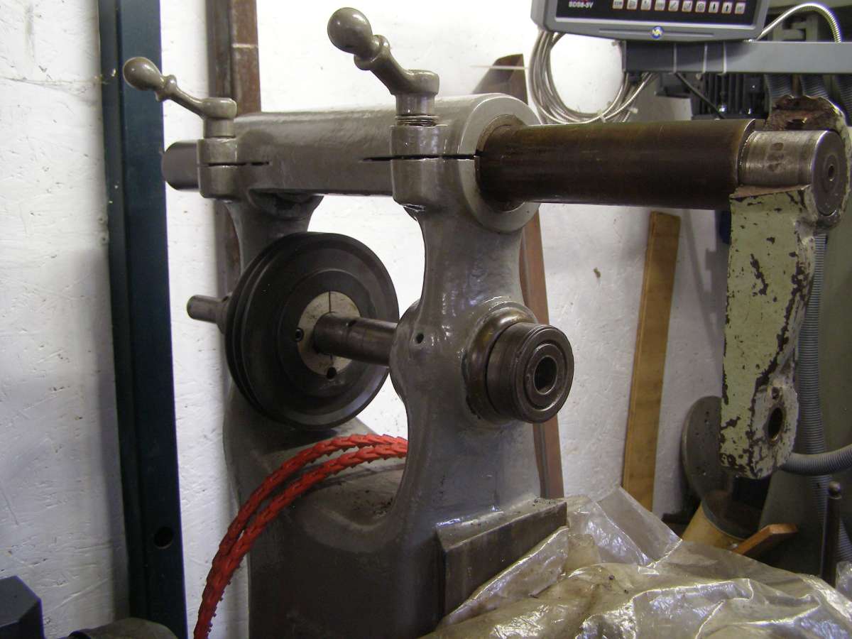

                        The Denbigh H4 Horizontal Mill, for line-shaft drive, with its non-original, 2″ diameter over-arm and the makeshift sleeves that came with it; and the (broken!) even more makeshift, drop-bracket on an eccentric spigot to allow its alignment with the spindle.
                        Note the two link-belts. Many owners of similar machines put the modern drive motor and pulleys out to one side, so as to use continuous belts. This works well but is very ungainly and steals a sizeable volume of workshop.
                        I want the drive above this machine, neater and more compact in a very cramped shed. That DRO unit in the background is on a Myford VMC mill, and side-mounting the Denbigh’s drive to the right could obstruct easy access to the Myford, but to the left, to an adjacent bench-drill! Yet going too high above could obstruct the travelling-hoist’s journeys.

                        Denbigh Oct 2025 A

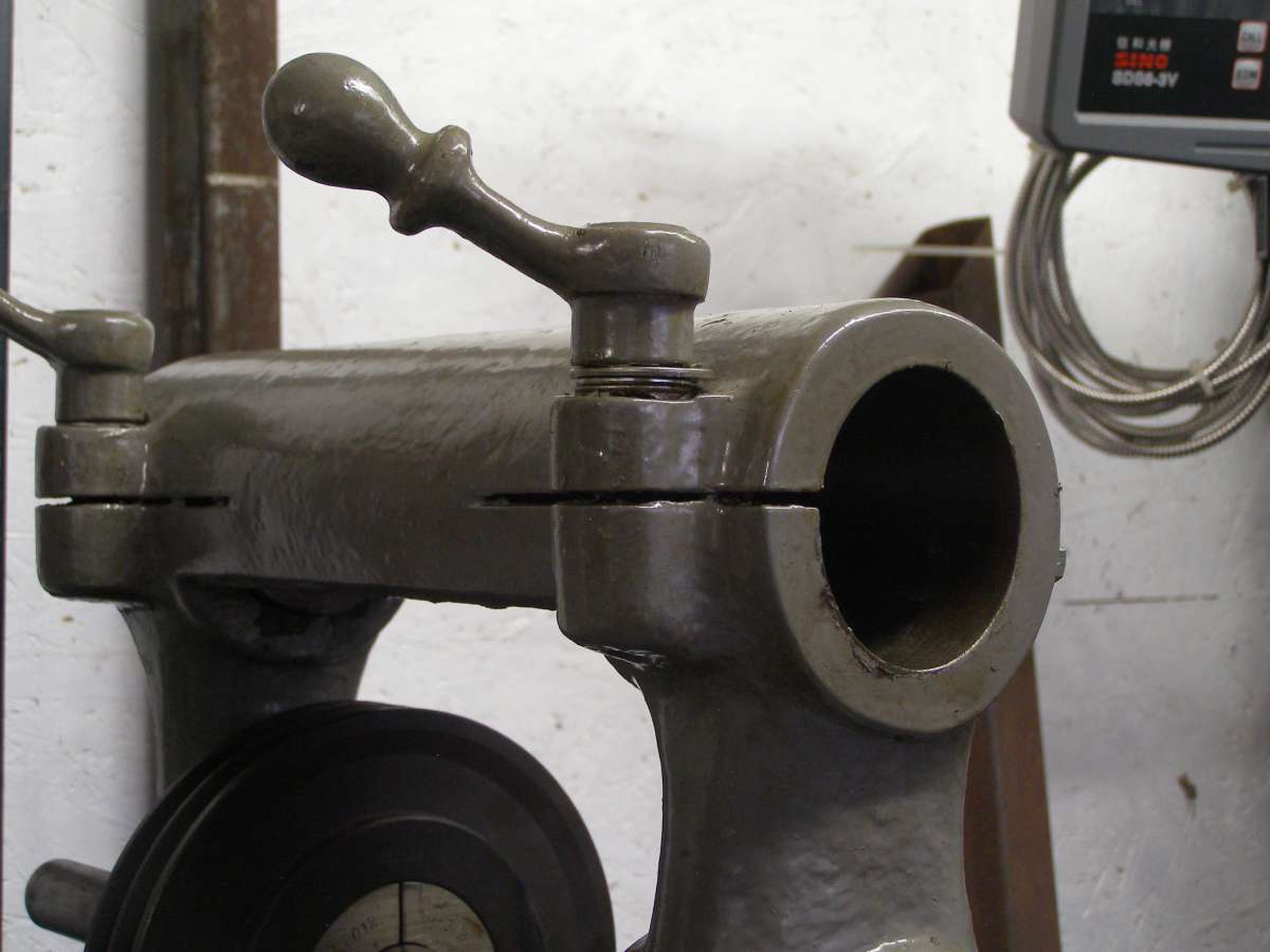

                        And without the fittings. The 2.5″ dia apertures as machined by the Staffordshire company. The “Cyclop’s Eye” in my Haunted Workshop piece. It was making the new sleeves for this, that had created the eerie sounds. This picture shows why I am very wary of either an excessively tight fit, or of having to pull the clamps-nuts down too tightly. That little bulge just visible beyond the eye is a puzzle. It is a protrusion holding only a vertical blind hole about 5/16″ dia, and perhaps originally was to hold a lamp.
                        Denbigh Oct 2025 B
                        The sleeves:
                        Left: one of the previous owner’s efforts, fully halved by me.
                        Centre: one half of my replacements showing the half-hole that engages the locating-screw. It was one of these sleeves that had “Shrunk” (curled inwards).
                        Right: the other sleeve as it came with the machine, with one saw-cut right through; and now with five sawn slots along the outer wall, opposite the through-slot.
                        Denbigh Oct 2025 C
