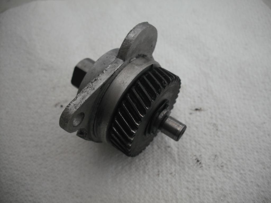

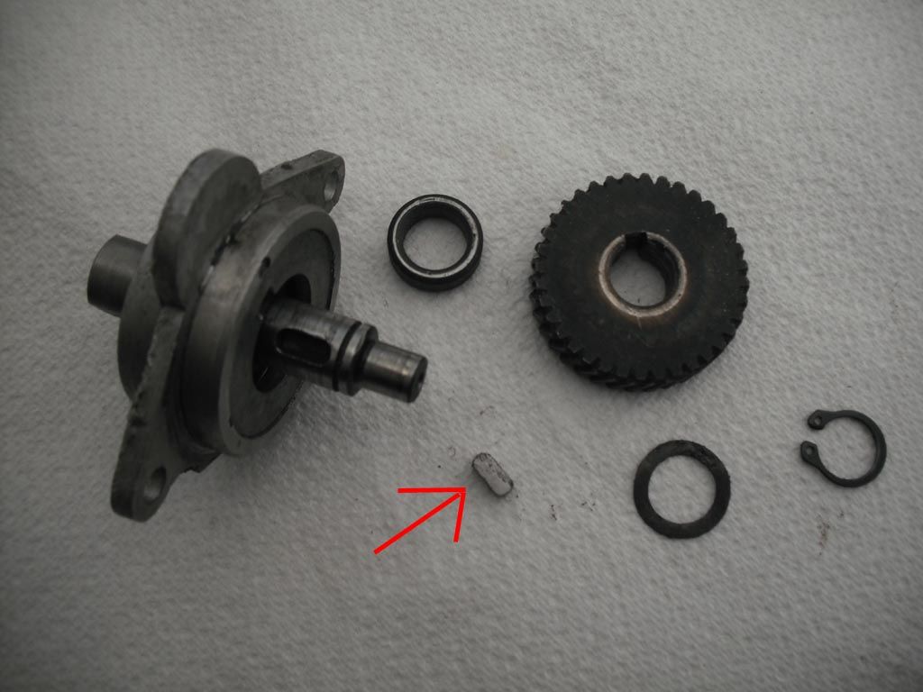

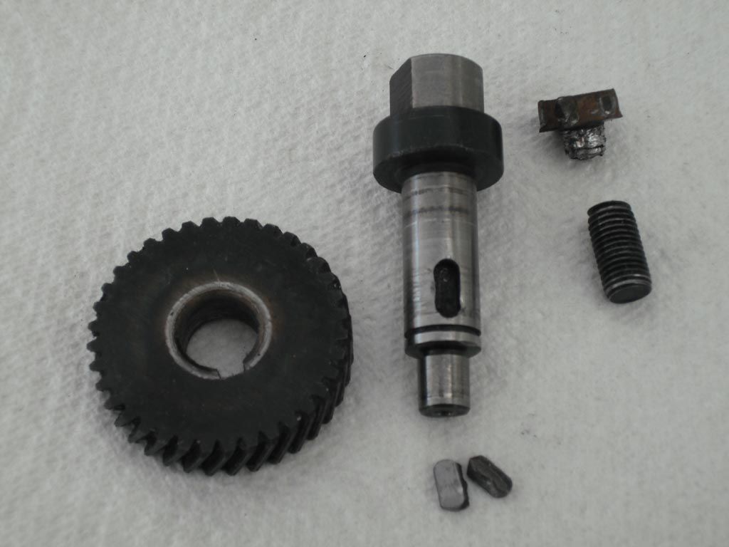

      I was using my mitre saw yesterday when the blade stopped revolving. Dismantling the front end,I found that the key on the drive shaft gear had sheared. The best I can measure, the key had the following dimensions:
      width-4mm (checked with blank end of 4mm drill)
      Length 7.5mm, Depth about 4.5mm. The question is, is this a standard size which I can order? Also managed to shear the head off the bolt which holds the saw blade. This a 20mm long, fine 8mm with a pitch of 1mm and a Left Hand thread. Can these be purchased on-line? I'm not sure I could make one myself as my lathe has an imperial lead screw and I don't have a suitable gear to do metric threads. The saw is a B&Q special which I bought about 15 years ago, so I have more chance of winning the lottery, than obtaining spare parts for it.
      Thanks in advance for any advice.

                                  If you think the key is not necessary, you obviously haven't looked at the picture I posted. The saw blade fits on one end of the shaft with clamping plates and the LH bolt. The shaft goes through a bearing in a housing (not shown), with the gear wheel on the other end, which is in turn driven by the (smaller) gear on the end of the motor shaft.
                                  The original fault was I had lost the drive to the saw blade. The gear was just spinning on the shaft because THE KEY HAD SHEARED. Photo shows the key in 2 pieces.

                                        Made a new key. I'm glad I bought some new files from Arc Euro a few weeks ago.
                                        All re-assembled with new circlip.
                                        The saw is now all put back together. I'm just waiting for a new bolt which is ordered. I just hope it's the correct thread.
