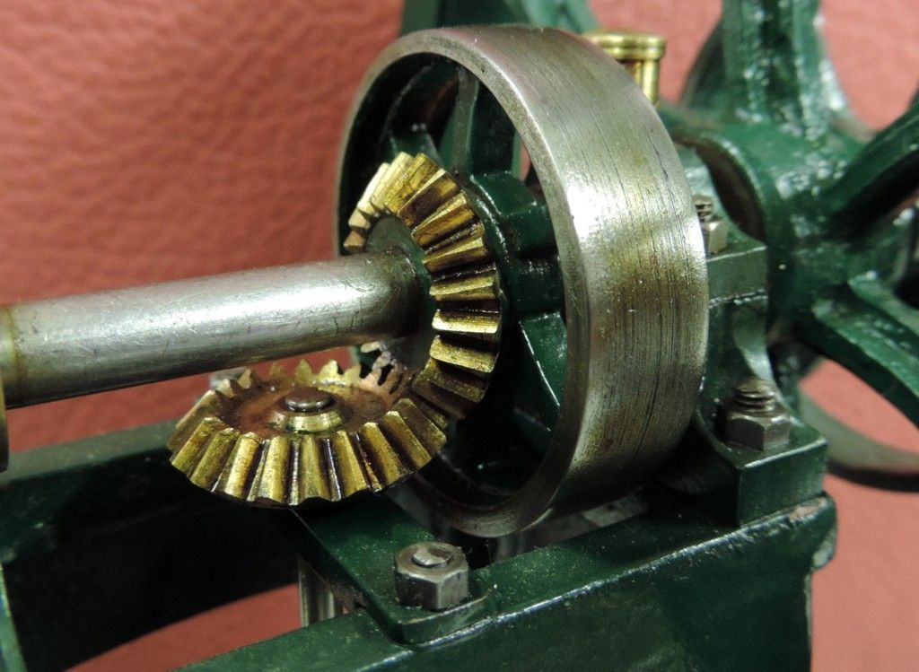

              I find making bevel gears the most rewarding of all the parts of this hobby, for some reason.
              It's worth getting Ivan Law's Workshop Practice series book 'Gear and Gear Cutting'.
              The bevel gears below were made using his techniques for making cutters and actually doing the cutting, so aside from my time they cost pence each. Note there is a minor error tin the book that only effects pairs of gears not at 90-degrees to each other.

                The problem as I see it is you can not correctly machine bevel gears on a mill or shaper, OK you can sort of make them and they may function. The problem stems from the tooth pitch which changes from outside to inside, hence when you look at the pictures above you start off with a flat on the top of the tooth and end up with a point as you get to the centre.
