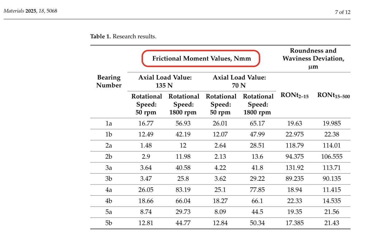

                  On John MC Said:
                  An interesting read.  Not sure it helps my answer my question as it doesn’t give an indication of the increase in friction, seals vs no seals.[…]
                  The increase is from zero
                  Table 1 shows a spread of values … because the physical seals differ
                  IMG_1577
                  … there is no simple answer to yo question, John.

                      One thing that is simple; choose the correct seal (sealed bearing or separate seal) and lubrication for the job and there will not a problem.
                      I’m not sure about the zero, might be an extrapolation?   Perhaps a baseline could be set, a bearing without seals.  Not relevant to the experiment but would be interesting.
                      looking at fig 5 in the report.  Frictional moments are plotted on the x axis of the graphs.  Frictional moment for an unsealed bearing is around 1.7 – 2.0.  This suggest a big increase in friction.  Multiplying b****r all by 10 is still b****r all!

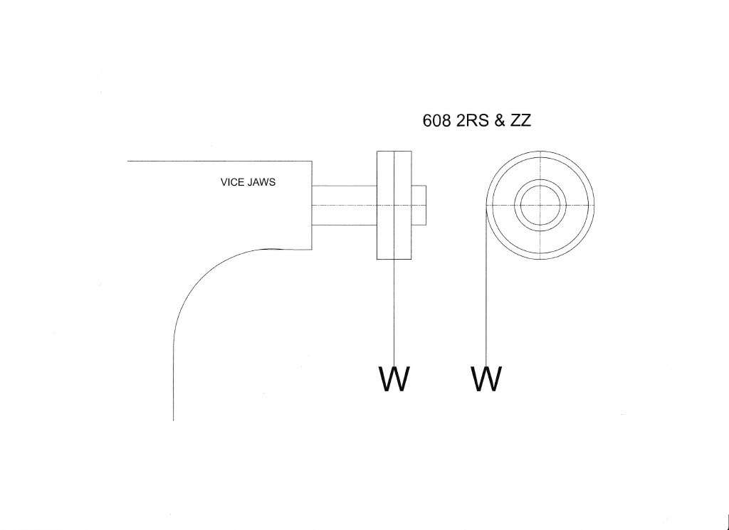

                          While I can understand the sentiment it has given rise to a little experiment.
                          Searching through my stash of bearings the only bearings which I have in 2RS, (Rubber Sealed) and ZZ (Shielded) are in 608 size, 8 I/D, 22 O/D by 7mm wide.
                          I set the bearings up in the manner shown below, both bearings were fitted to an 8 mm tapered ground mandrel. The sort used to hold components between centres.
                          Bearing Comparison
                          Both bearings came from the same drawer and were the same temperature. Fishing line was wound around the bearings such that the line did not overlap. The end of the fishing line was secured to the outer track with instant glue to avoid any slippage.
                          Gram weights were added to the hanger at W and the results were as follows. The 608 ZZ took 3 g to rotate the bearing, while the 608 2RS took 14 g to rotate the bearing. Almost a factor of 5 difference.
                          I would have preferred to have had several sizes of bearing to make a more detailed comparison but this simple experiment has shown there is a significant difference in this particular size of bearing between the two forms of sealing.

                                              How silly it was of me to assume we were not talking about New bearings!
                                              In the bottom of the bin for the “Any Old Iron Man” were the two bearings which I replaced.
                                              To set the scene the bearings are part of a regulator motor assembly which regulates the 3 phase voltages supplying the Linear Accelerators used for Radiotherapy Treatments. This particular unit had been in use for over 10 years and was due for replacement. The motor assembly was thus saved from the scrap pile and found a new home, as well as a new life.
                                              Thus both bearings have done exactly the same duty and under the same conditions being on opposite ends of the shaft concerned.
                                              Using the same set up as depicted above, W for the ZZ bearing was now 1.15 g, and W for the 2RS was 6 g. Clearly there is still a factor of 5, or there abouts at play.
                                              Both bearings are 0.25 g lighter, so they have either lost some grease over the 10 years, or the new bearings have more grease in them.
                                              I had better point out that the Gram weights have not been checked by the NPL for quite some time, but as the same weights have been used throughout I don’t think it will matter.

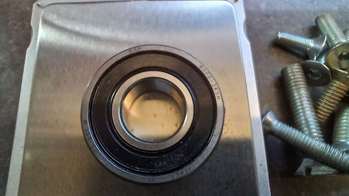

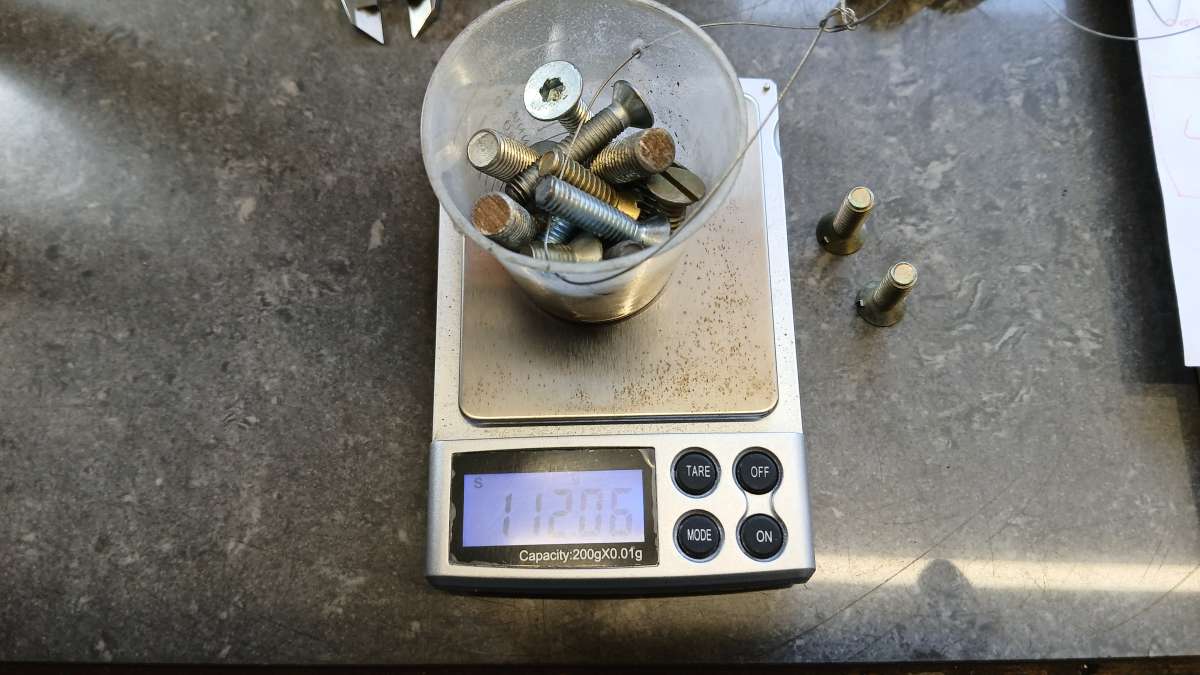

                                                  I got some time this morning and did a similar test to Gray’s using the SKF 6202 2RSH bearing.
                                                  20260422_104234
                                                  Not having any 1g weights I made do with filling the suspended container with some screws and weighed the load.
                                                  First with the seals in place as you can see in the video it starts with no rotation then as I put another screw it it moves very slowly. Adding one and then two more sees the speed increase. I weighted the container and screws less the last two put in at 112.06g
                                                  20260422_103744
                                                  Next I popped out the two seals and ran the test again, did not need any screws as the container alone was just enough to get things moving. Weight of just the container was 4.21g
                                                  So some what more friction than Gray measured as that is a factor of 26.6 times more!
                                                  I won’t bother cleaning out the grease as it may just be the cord that gets the bearing moving.
                                                  And NO the washer was not touching the seal.
