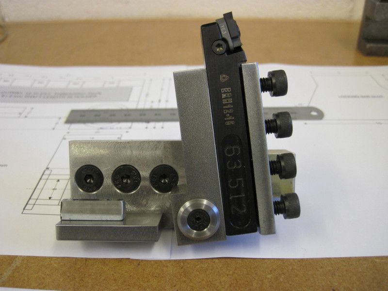

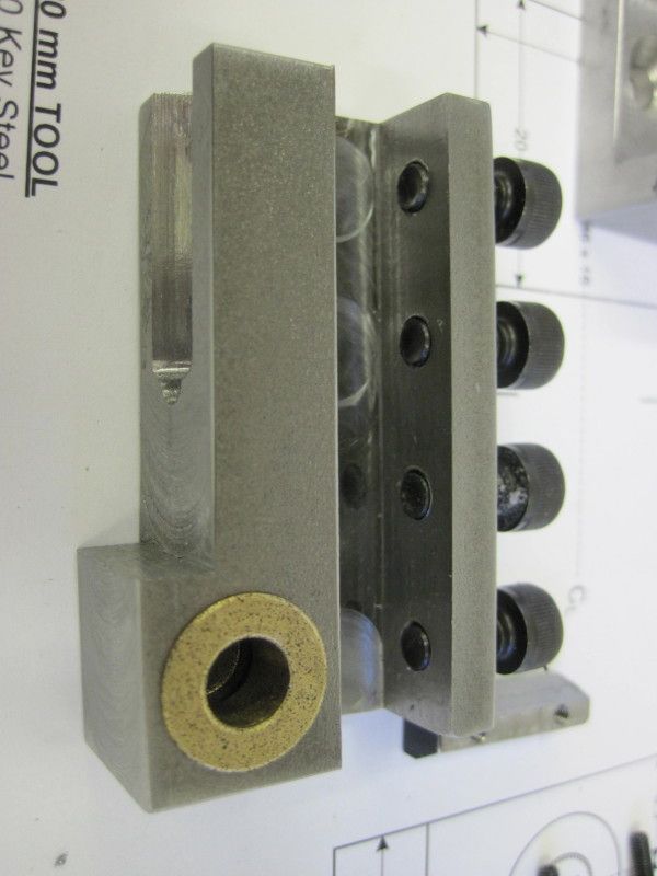

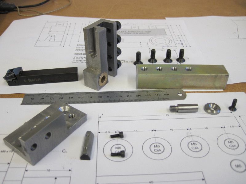

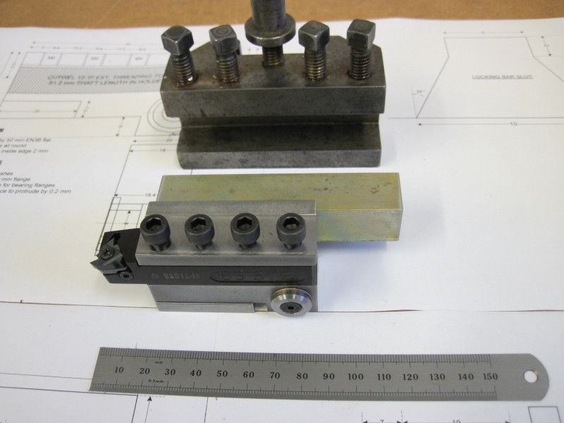

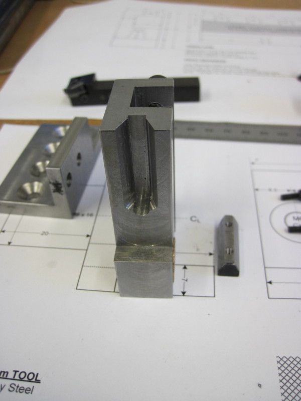

              Hi All,
              Just finished my version of the flip up holder. It is pretty much as per Bogs / John S / Uncle Tom Cobleys design. My only tweaks were to make it so that it ticked the boxes for:
              Uses insert tooling
              Uses an existing 12 mm shank tool
              Fits the S2 size QCTP on my Colchester which uses 20 mm square tooling.
              The only modification I made to the original design was to make the locking bar thingy and its locating slot tapered with a 25 degree taper each side. This ‘SHOULD’ mean that you get more positive location when the tool is pushed down onto the taper during cutting. I don’t know if this is critical but it’s nice that there is zero side to side play when the tool is pushed down.
              I alos used some Oilite flanged bushes for the pivot bearing – mainly because I had some kicking around. Probably overkill but they do look nice!
              I haven’t tried it in anger yet. In fact, I have never cut a thread on a lathe so it will be interesting to say the least!
              Regards, Hugh

                Funny how close some thinking is. I have some Oilite flanged bushes which I also considered except that my version is a little too small to include them so I dropped the idea and custom turned a pivot/screw. In all other respects (except the tapered seating – good idea) mine looks remarkably like yours. I’ll post photos when it’s done.

                  Hugh,
                  If you look at my original article, where John S came up with the idea of the block at the front to take the side loads, John suggested what you have made, and I personally thought that having the taper might not be the right way to go.
                  If you are using the non offset method for cutting, ie straight in, then no problems, as there would be equal pressures on either side of the taper. But if cutting using the offset method, either left or right hand, then the cutting forces are coming from one side or the other, and so the taper would tend to ride up the tapered block, so raising the cutting point off centre.
                  That was the theory behind it, and why a straight sided block was used. I never attempted what you have done, so never had the chance to test out the theory.
                  Maybe I was wrong to go the way I did, but if I was you, I would keep an eye out as the tool beds itself in and the pivot gets a little wear on it. That theory just might turn into reality.
                  A very well made tool BTW.

                  Hugh Gilhespie
                    @hughgilhespie56163
                    Hi John and Chris T,
                    Thanks for the comments. My thinking on using a tapered seat was that if I used a square seating bar then it would need some clearance in the slot to prevent binding. As the locking bar is about half way between the pivot point and the cutting tip, any side to side movement at the locking point would be doubled at the tip, so with a 1 thou bar clearance, the insert tip could move by about 2 thou.
                    As I said, I have never actually cut a screw thread in a lathe so I don’t exactly have a wealth of practical experience to fall back on and I don’t know whether a potential 2 thou wobble matters or not. I must confess that I hadn’t considered using the offset method for cutting, all my thinking was based on going in straight which, as John says, means equal sideways loads and minimises the chance of the tool riding up on the taper. All I can do is try a few experiments both ways and see if there is a problem.
                    I chose the angle of 25 degrees to be big enough so that there is no possibility of the tapers binding together.
                    For info, the lock bar itself and the 20 mm tool shank are key steel – sort of EN9 – and I intend to heat treat these bits to harden them. I am also going to turn off the final couple of threads on the M6 cap screws used to hold the tool shank.
                    Regards, Hugh
