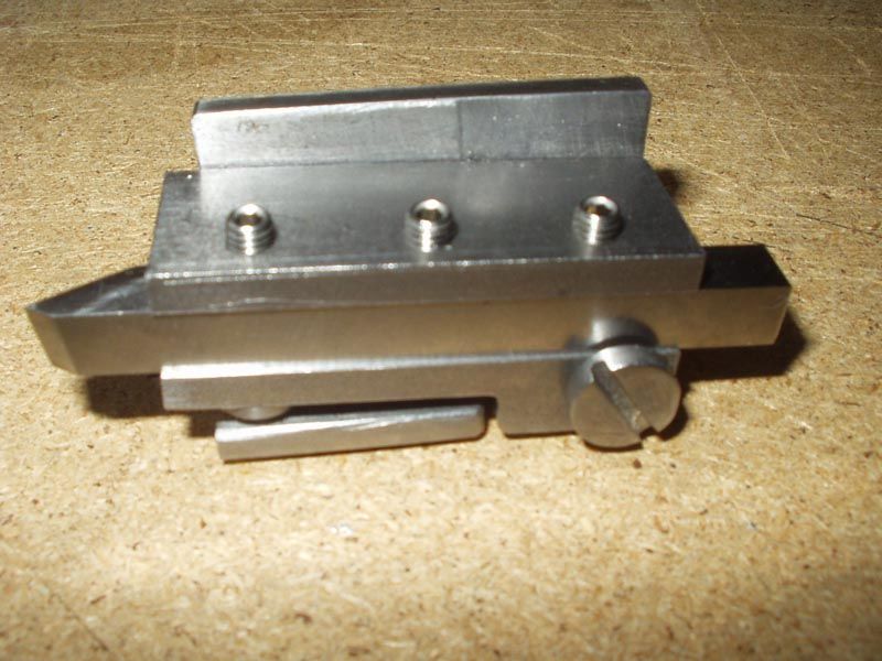

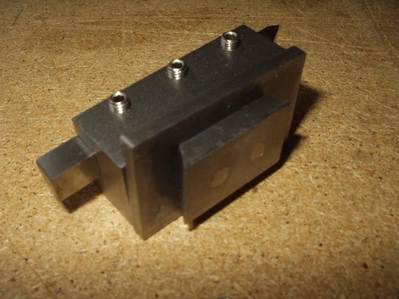

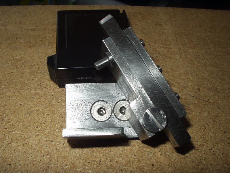

      I had a go at making this gadget.
      I’ve been reading about them over on the Madmodder site and thought they looked interesting .
      I altered the fixing bar to an angled end one so it fits into my qctp to avoid excess overhang.
      in the last pic you will see my mistake, I only had 4mm angle ,not 5mm, but I still milled 5mm off the base of the toolholder so I made the locating stud with a collar to adjust it.
      It really works a treat too. It’s quite fascinating to watch it glide back to the start.
