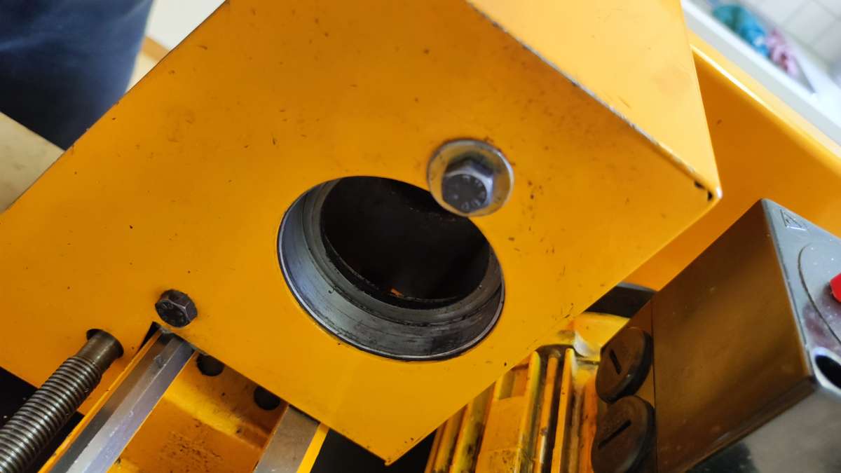

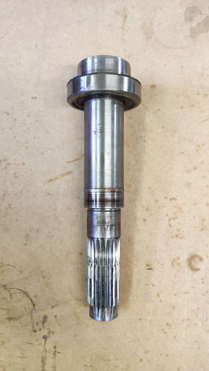

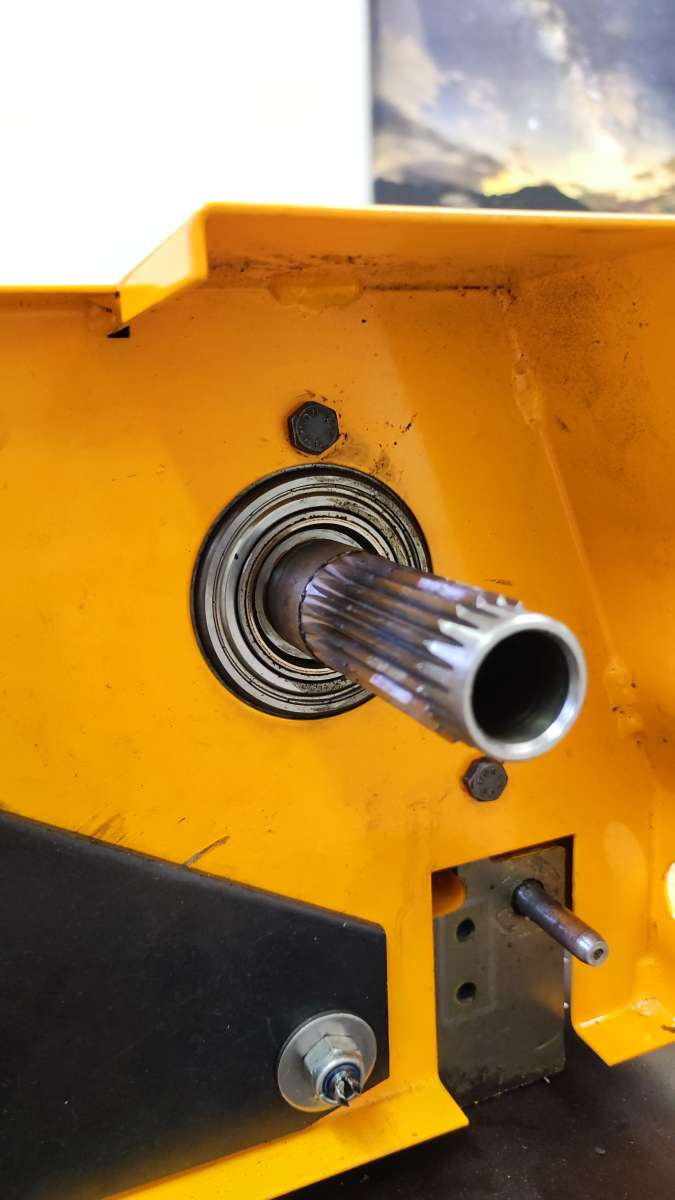

                                            I just wanted to follow up on this as I have replaced the spindle bearings, and this has entirely solved the issue I had with noise. As I didn’t find many resources about this particular topic online, I thought I’d quickly document it here in case it helps someone in the future.
                                            Disclaimer: I am not a machinist, nor do I have experience with lathes or the Emco Compact 5. The following is all based on my personal knowledge and assumptions. I have good knowledge of mechanics in general and am an engineer, but again, have never done this particular operation before. English is not my mother tongue so pardon some of the approximate terms.

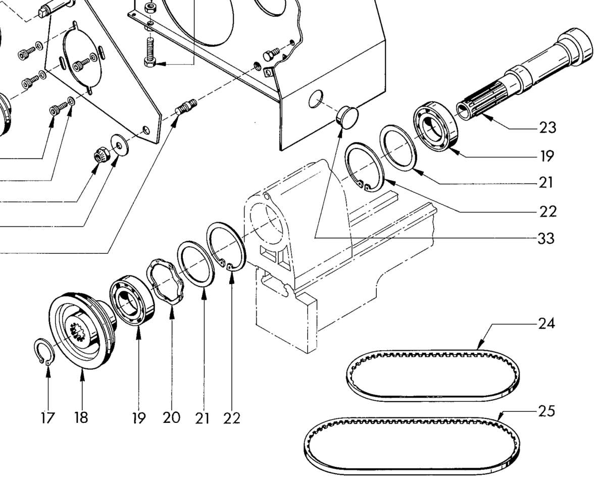

                                            General Overview
                                            Screenshot 2026-02-23 at 20.50.12
                                            • The bearings are press-fitted onto the spindle and into the housing.
                                            • The play-free assembly is given by the spring-loaded washer (20) that adds tension along the axis of the spindle, and is held together solely by the circlip (17).
                                            • To allow the spring loaded washer to function, the wheel-side bearing is less snug than the chuck-side bearing, allowing some (very minimal) sliding of the spindle along its axis.
                                            Disassembling
                                            First remove the bed and engine.

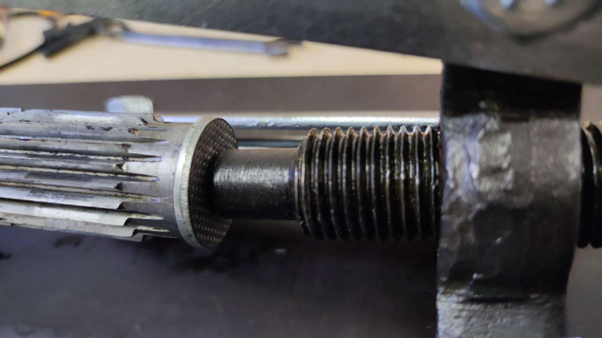

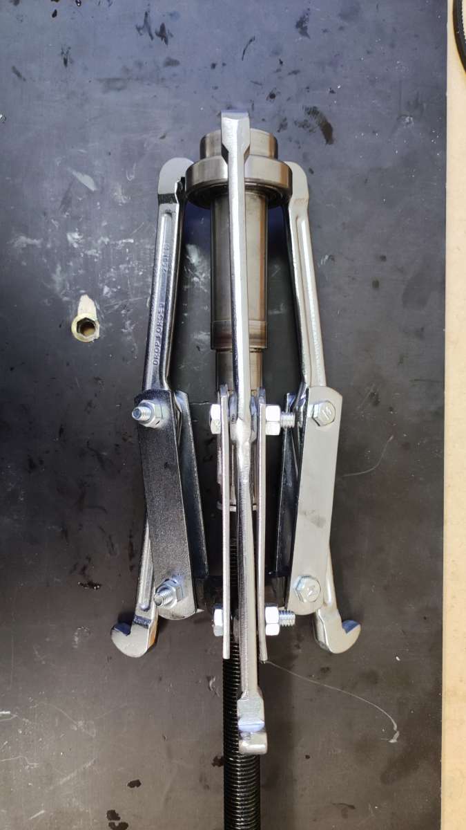

                                            1. Remove the circlip (17) from the spindle, being careful not to damage the teeth of the spindle.
                                            2. Use an extractor to remove the wheel, being careful to nicely position the claws in order not to damage or bend the wheel. I used a washer positioned at the end of the spindle to position the main screw of the extractor (forgot to take a picture).
                                            3. Now a very light tap with a mallet (from the wheel side) should set the spindle free (with the chuck side bearing stuck on it).
                                            4. Remove the retention discs (21), then the inner circlips (22).
                                            5. Now you can extract the bearing from the spindle using the same technique with the washer. This fit is much more snug, so be careful to align everything carefully in order not to damage or bend the spindle.

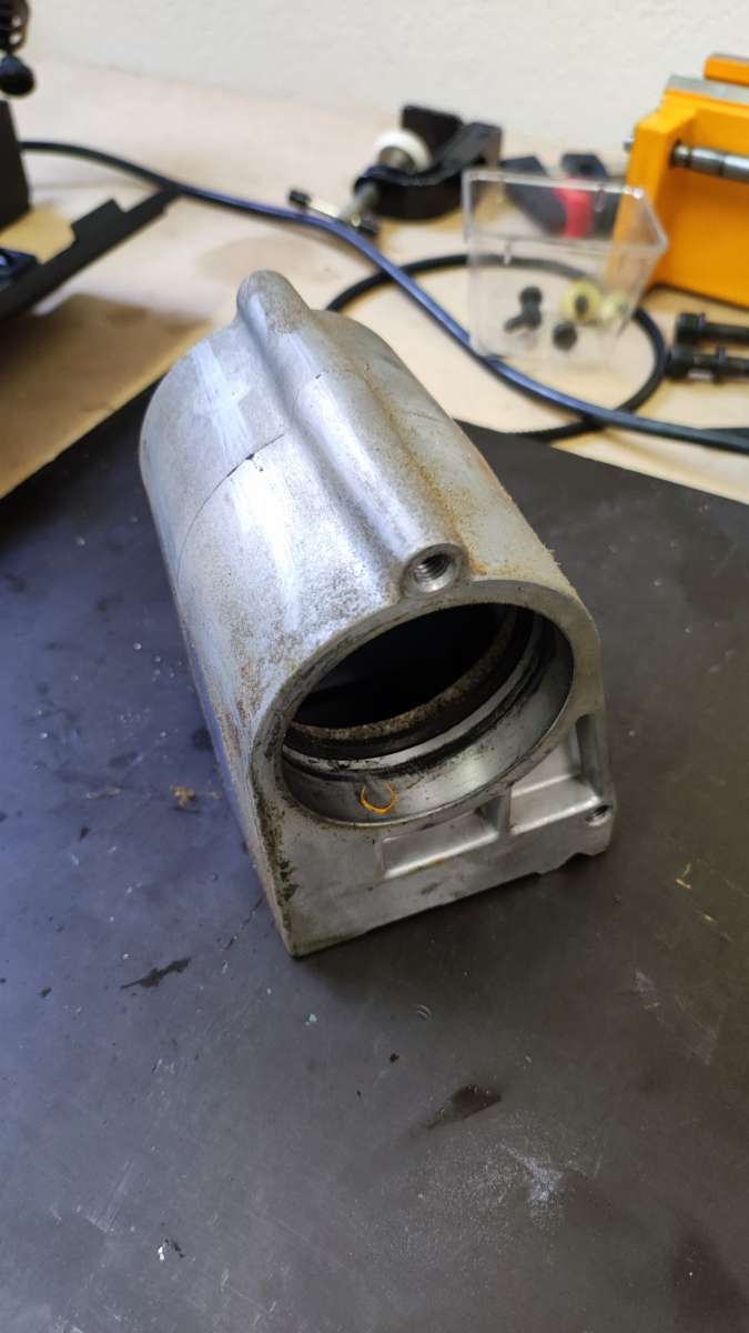

                                            6. Optional: you can now remove the cast aluminium part holding the bearings from the housing by undoing four hex screws.
                                            I used the opportunity to thoroughly clean everything.
                                            IMG_20260219_144632IMG_20260219_170603IMG_20260219_144859IMG_20260219_144843
                                            IMG_20260219_150802IMG_20260219_155206IMG_20260219_155215
                                            Used a washer so that the extractor can press right against the middle axis of the spindle.

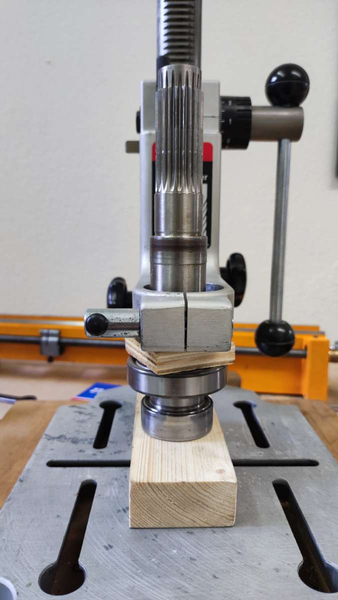

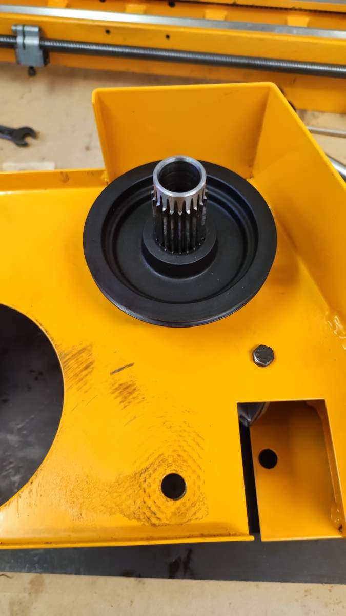

                                            Reassembling
                                            You have to replace the cast aluminium part inside the housing. At this point I don’t recommend tightening the hex screws (for the housing) back immediately, as you might want to align holes (and the bottom part touching the bed) later on.

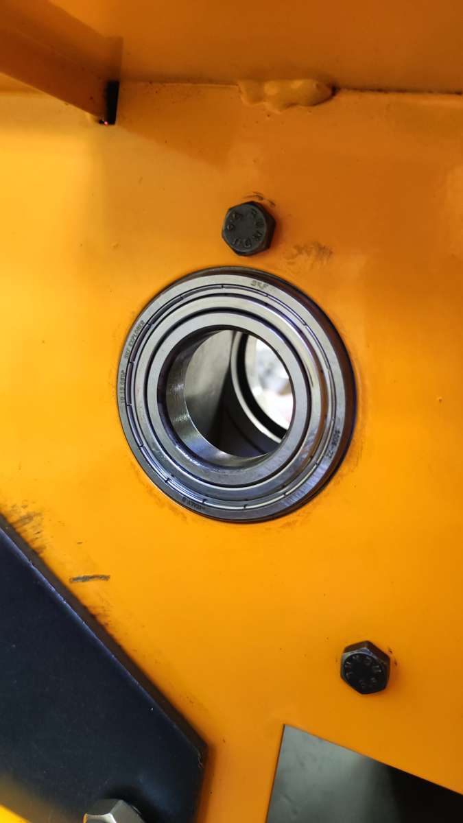

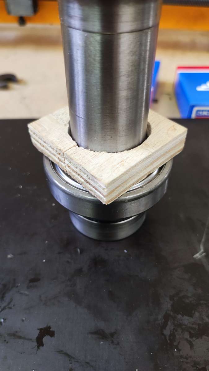

                                            1. The trickiest part is to press the bearing back onto the spindle. I don’t have the proper equipment but generally wanted to avoid hammering, and tried to apply the pressure as evenly as possible, even though ideally it should be on the inner ring. To do that I cut myself out a rough wooden jig, then used my drill-press to slowly press the bearing down, rotating the whole assembly by a few degrees at every press to make sure everything is even.
                                            2. Replace the inner circlips (22) and retention rings.
                                            3. Feed back the spindle and bearing from the chuck side. You’ll have to give it some light taps in order to press-fit the bearing back. Make sure everything is properly aligned and not to damage the aluminium. You can temporarily place the bearing on the other side to ensure better alignment.
                                            4. Place the spring loaded washer and bearing on the other side. In my case a few taps using my wood jig helped, I almost didn’t need a mallet.
                                            5. Place the wheel on top. Here I found it easier to rotate the whole assembly so that I could press the wheel down with my hands against the table top. I chose to do this because I didn’t want to risk using a mallet or similar and bending the wheel.
                                            6. As soon as you can see the groove, replace the circlip (17).
                                            IMG_20260219_165313
                                            The bearing on the wheel side, sticking out slightly due to the spring-loaded washer.
                                            IMG_20260219_163818
                                            My setup using a wooden jig and my drill press. Not the best, but better than hammering.

                                            • I used two extractors: one 110 mm and one 250 mm.
                                            • I didn’t use any form of lubricant. I just ensure everything was very clean, and applied a very light coat of grease on the spindle to protect it from corrosion. Bearings stayed in the solution they came in. Other parts got a final WD40 and wipe just for cleanliness.
                                            • About the method: I guess you could also place the chuck-side bearing in the aluminium housing first, then insert the spindle. I didn’t want to do that as the fit is very tight, so 1. I was worried to damage the aluminium and 2. I wanted to make sure the bearing was properly seated on the spindle, which is hard to see when it’s already mounted.
