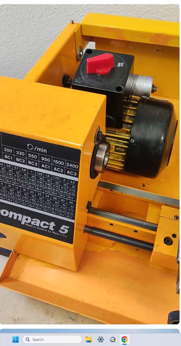

      A few posts back I did query the Black Ring on the front bearing of the Spindle.Compact 5 Black Ring
      I had assumed this was a felt ring which was being retained by the Washer under the Hex Bolt head.
      Was this an attempt by the previous owner to lubricate the bearings?
      I did even wonder if the front shield of the bearing had been removed to allow oil to be injected into the bearing?
          Regards
          Gray,
          I can’t tell for sure, but I would rather say it was an attempt to “protect” the bearing from any swarf or sawdust flying around. He also had some foam in some weird places, and as the lathe was very dirty (probably from sitting in a carpenter’s workshop), I assume that’s it. The front shield of the bearing was not removed.
          Now that I changed the bearings (see my post above) I have also removed this felt ring as I feel it’s totally unnecessary if not counterproductive.

            Graham Meek
              @grahammeek88282
              The presence of sawdust explains what has happened to the bearing. Usually some preventative measures can lead to more rapid wear.
