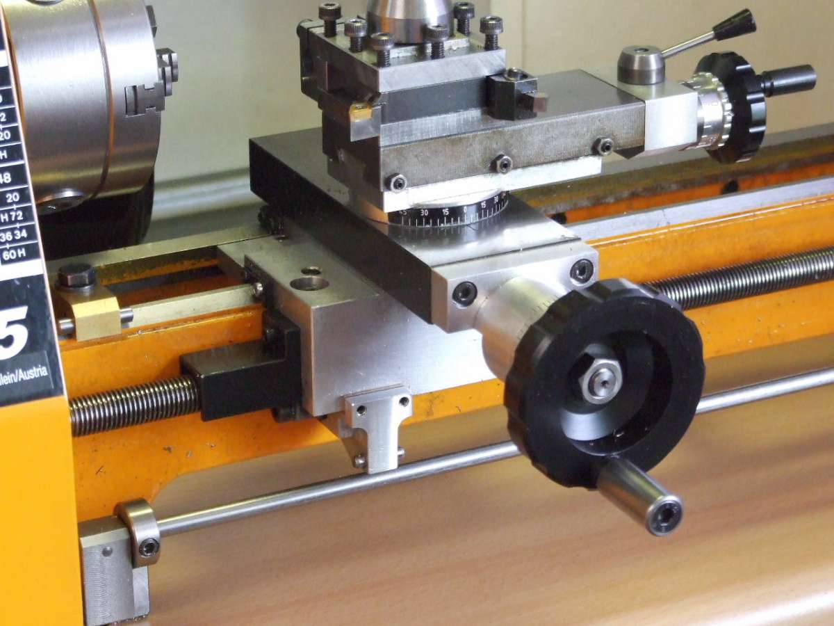

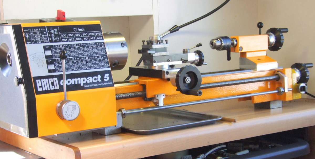

            #838484
            Graham Meek
              @grahammeek88282
              Hi Pete,
              You seem to have done quite a bit of work on your C5.
              My lathe is mounted on a piece of Kitchen Counter material. Which forms the top of an integral bench. This is about 38 mm thick and being Man made it is very stable for the weight of the lathe. Some M8 Screwcert Inserts in the counter top provide for levelling the lathe. The levelling screws bear on the two riser blocks I added. This stops me hitting my knuckles on the counter top. Studs from the riser blocks which pass through the counter top anchor the lathe to the bench.
              Levelling Pads
              The leadscrew nut on my lathe has a backlash adjustment as standard. This I have yet to adjust and I have had the lathe over 20 years. In the 4 years since I let my larger Emco machines go, it has done a lot of work. The improved screw cutting facility that the screw cutting clutch gives leads to more frequent usage than on most C5’s I would expect.
              C5 New Carriage
              While I replaced the Carriage on my C5 it was not that badly worn and is in fact enjoying a new life in NZ. I have no qualms with the use of Aluminium for the sliding elements of the machine. Provided good housekeeping and lubrication is carried out this will last for many years. The use of these unorthodox materials is what helped to make these machines more affordable.
              Regards

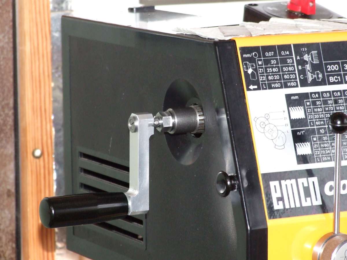

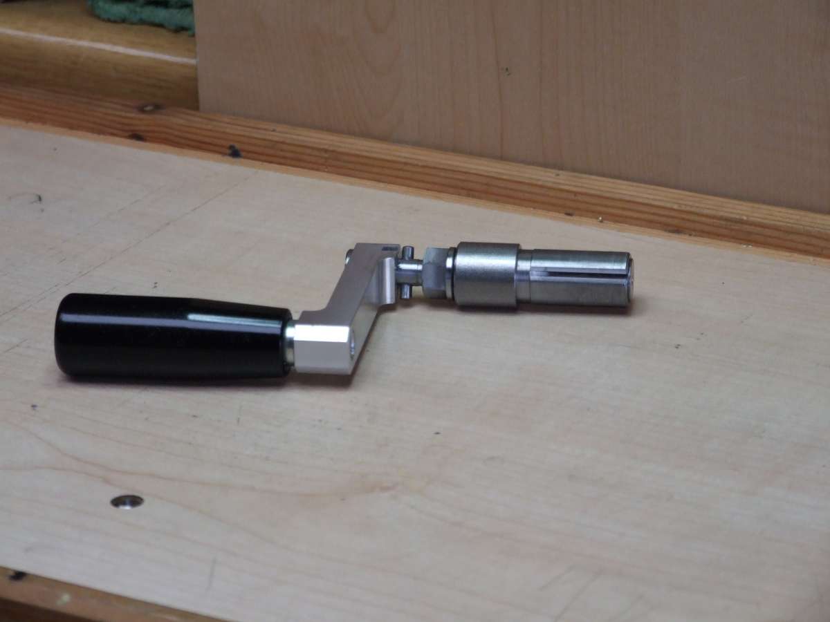

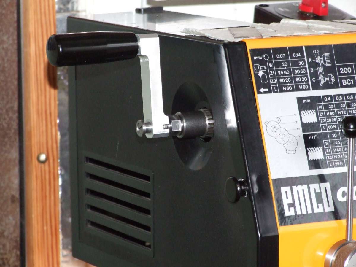

                        Jason very kindly loaded some PDF’s with the drawings for the Mandrel Handle that I made. Here are a few photographs of the item.
                        DSCF2804
                        DSCF2808DSCF2807
                        Regards
                        Gray,

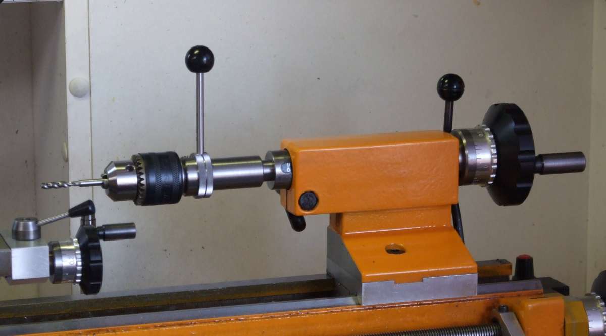

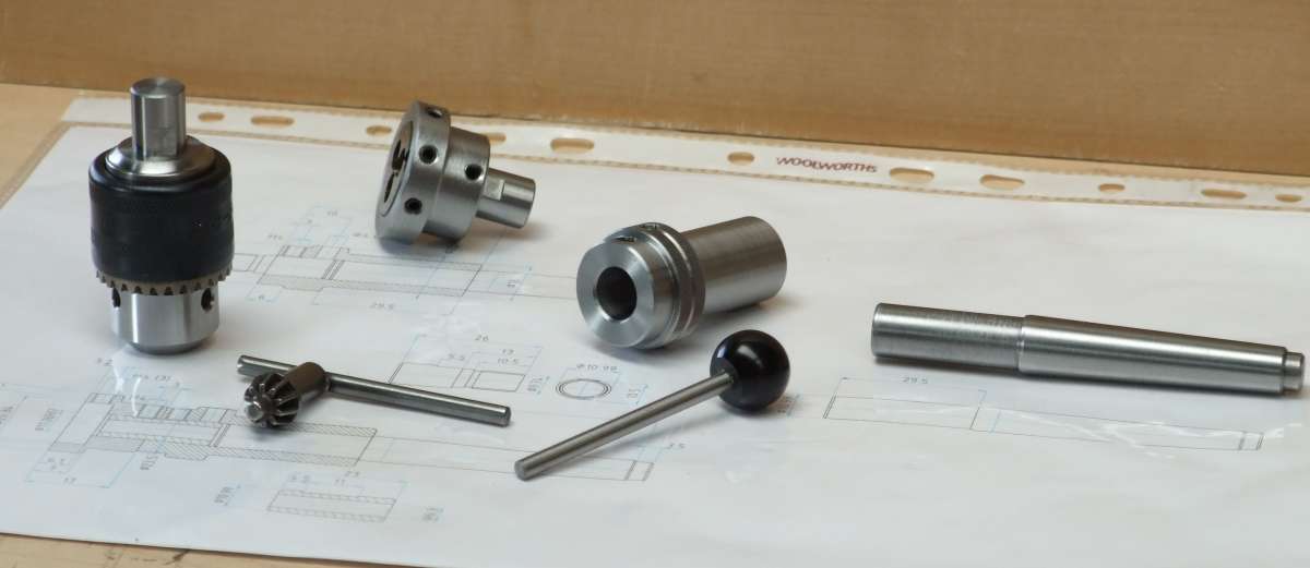

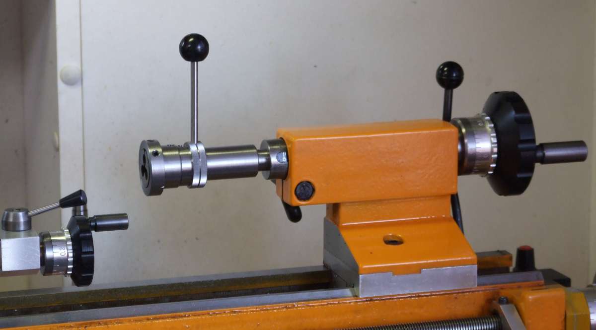

                          For some weeks I have been making a Tailstock Die and Tap holder. I claim no originality for the design as this is scale copy of George H Thomas’s design due to the C5 being No 1 Morse taper in the tailstock. This is something that has been on the to-do list for about 4 years now.
                          DSCF2811
                          DSCF2812
                          Rather than make individual tap holders as GHT did and due to the vast amount of taps I have with varying shank sizes. I have opted to use a 0-6 mm capacity chuck. This has a 3/8″ x 24 UNF thread with a short location diameter, similar to the Myford spindle nose design. A short arbor was screwcut to accept this chuck, a small flat behind the chuck gives a positive locking face for the M4 Allen grub screw. A similar flat is provided on the die holder.
                          DSCF2828
                          This last photograph shows the component parts. The arbor is a modified commercial stub arbor which has had the diameter turned down to suit The Tang was cut off and replaced with an ejection button. This reduces the amount of overhang due to the tailstock barrel being wound out to accommodate the length of the Tang.
                          As I have come to expect with GHT’s designs it worked straight out of the box. The thread for the Plastic Ball handle was threaded using the die holder and the Mandrel Handle. The detachable handle is a boon when doing smaller taps and dies. It greatly assists with the quick removal of the tap and die when the threading operation is complete.
                          Regards
                          Gray,

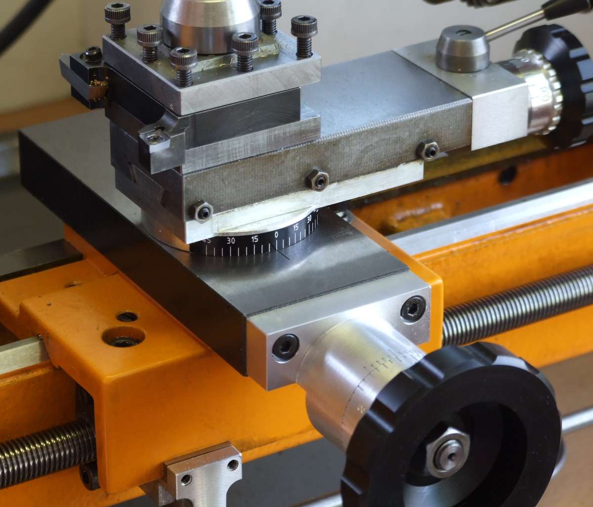

                          #843710
                          Graham Meek
                            @grahammeek88282

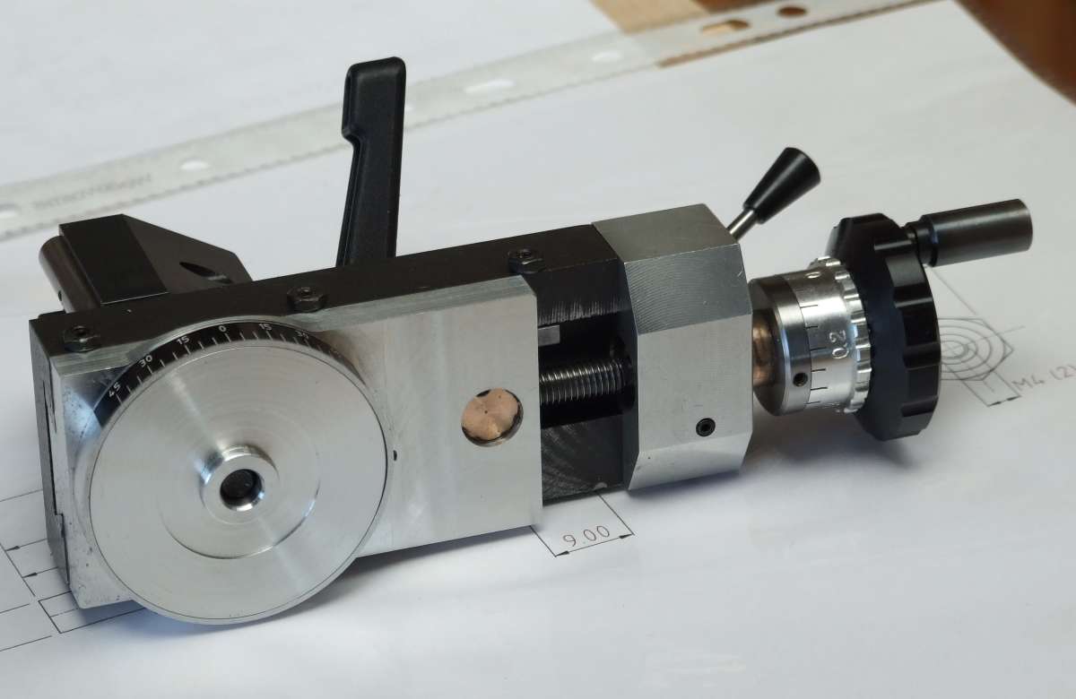

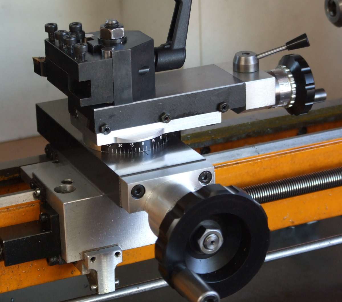

                            For sometime I have been threatening to put a replaceable Phos Bronze feedscrew nut in the C5 Topslide. The chance to purchase a new Topslide part, (the cast iron part) gave me the impetus to get on with the modification.
                            While I was designing the new aluminium base it was decided to make a separate ring to carry the degree scale and lock this with an Allen grubscrew when the scale was in the right place. Trying to stick the new scale in the right place is a pastime I can well do without.
                            C5 Topslide Base
                            This photograph shows the Phos Bronze nut fitted and the separate scale ring. The locking Allen grubscrew for this can just be seen at the three o’clock position.
                            New C5 Topslide Base
                            This view shows the completed slide fitted to the lathe. I have also added a buttress above the Zero mark on the scale. In the original Die cast versions of the slide this was moulded as part of a sphere. On the latest Emco “machined from the solid” parts this has been reduced to a step leaving a little over 1 mm above the scale. The down side of this is it traps debris. This can be seen in the photograph below.
                            Latest Emco C5 Topslide base.
                            Regards
                            Gray,

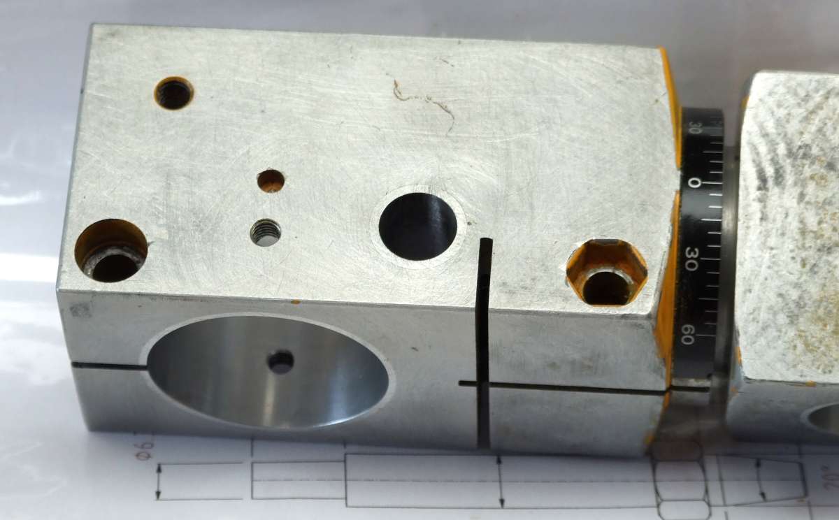

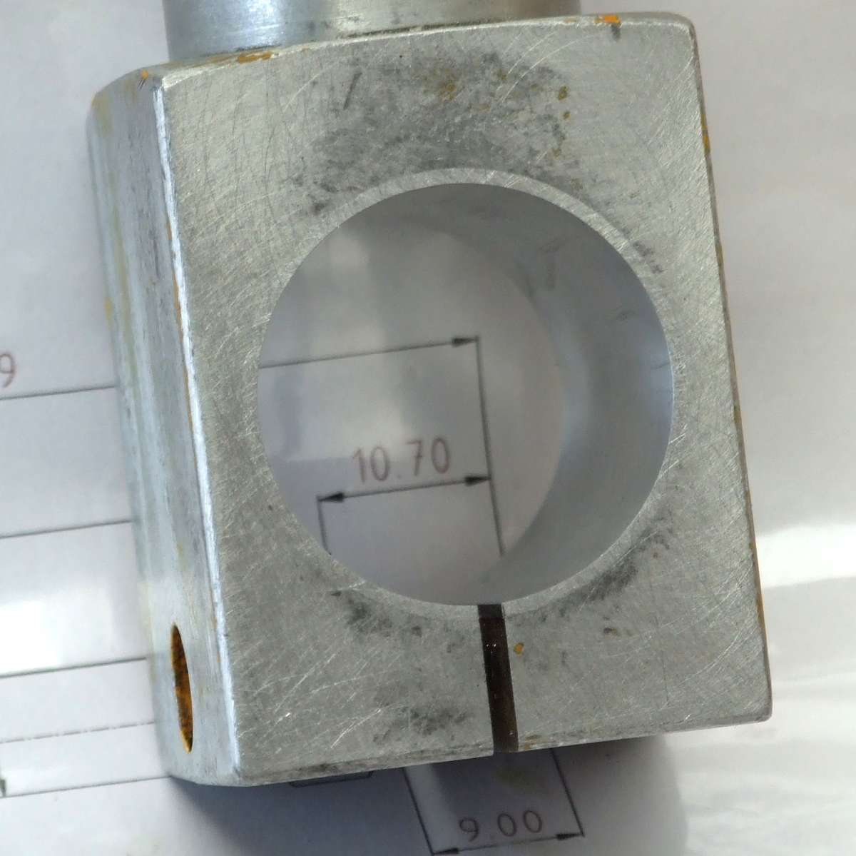

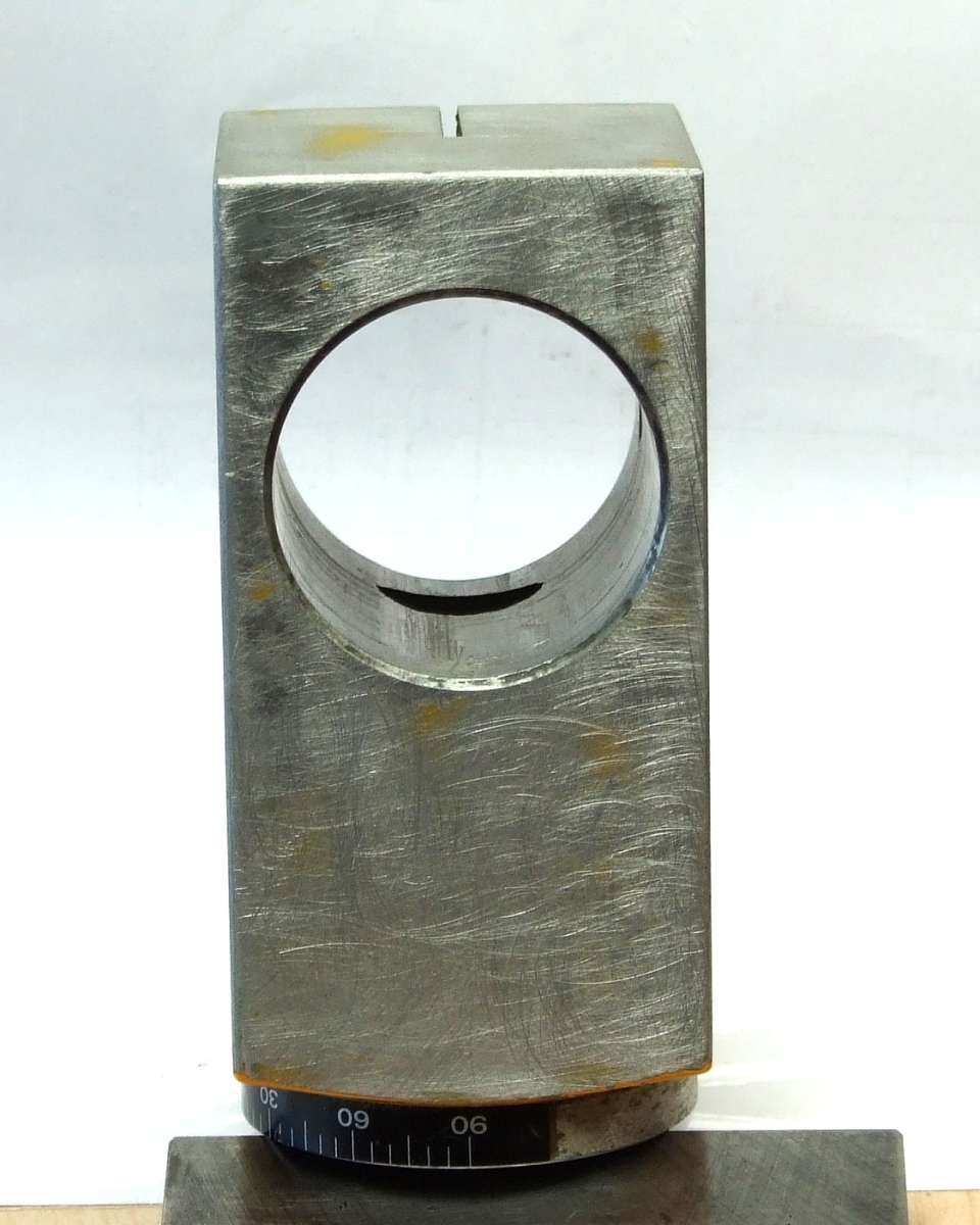

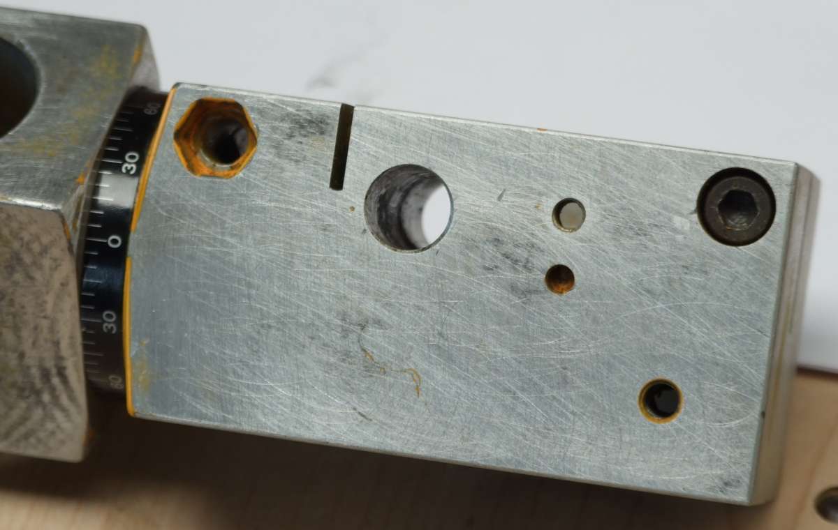

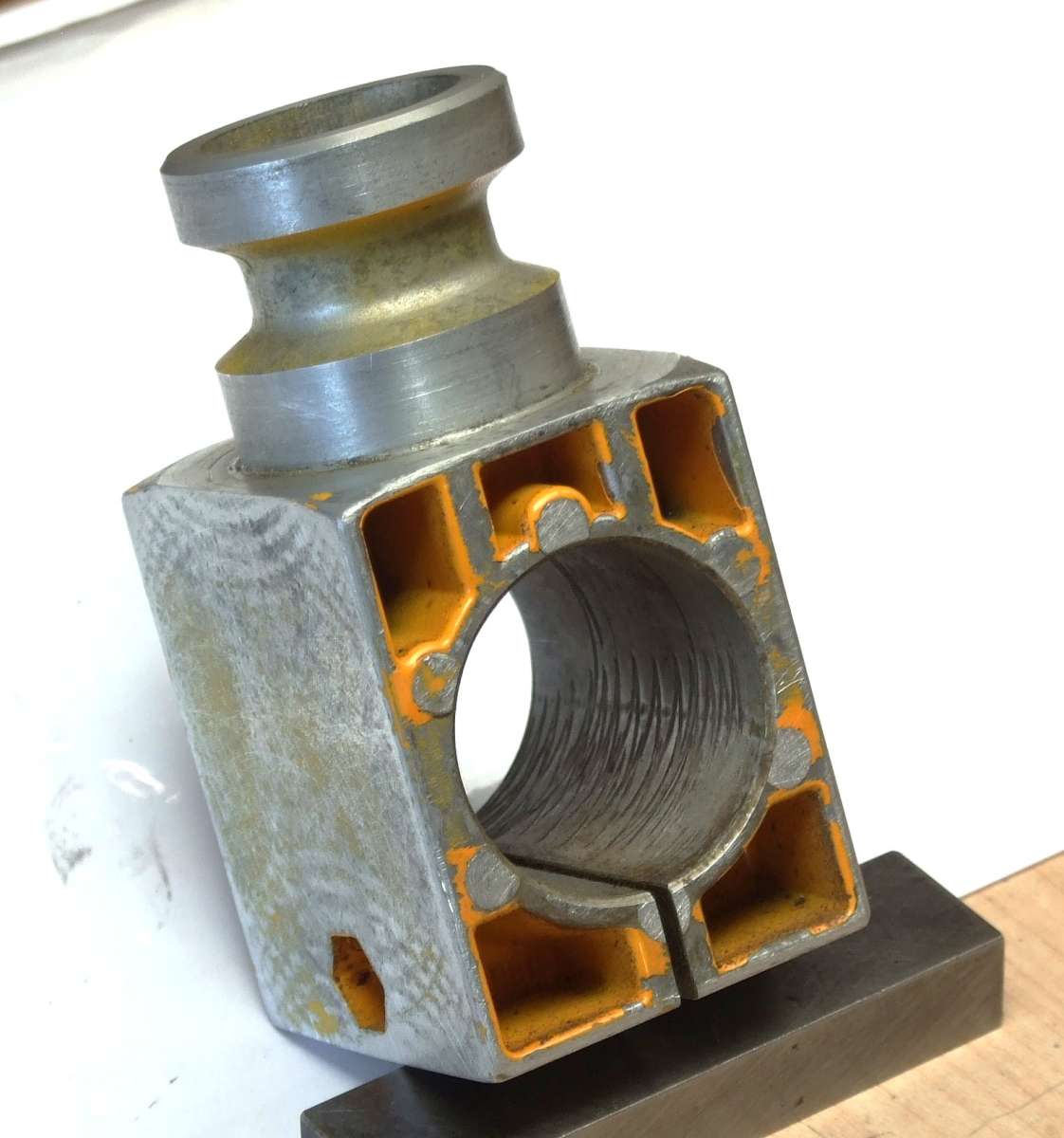

                                Almost 12 months ago I purchased a C5 Milling and Drilling Attachment second-hand. The photos accompanying the item for sale showed an item which was cosmetically in need of some TLC. The asking price was not much more than the cost of a new motor for the attachment.
                                Although I unpacked the item to see if there was any damage caused in transit. It was not until a couple of months ago that I decided to dis-assemble the unit with a view to improving the cosmetics.
                                The dis-assembly proved to be a bit of a conundrum. The slider which goes up and down the column showed some horrific damage to the bore.
                                Damage to Column Bore
                                Yet the Column had no mark on it anywhere.
                                It was a similar story with regards to the Quill bore.
                                Scoring in Quill Bore
                                Yet the Quill assembly showed no signs of damage what so ever. Although the photo shows what is scratches it needed 0.6 mm to be removed from the bore before the damage was gone.
                                The Pinion Lever bore was a similar story.
                                Quill Pinion Lever Bore damage
                                The step in this bore needed 0.5 mm to be removed before the bore cleaned up. Incidentally the Pinion Lever was from a Unimat SL. The original was probably too far gone.

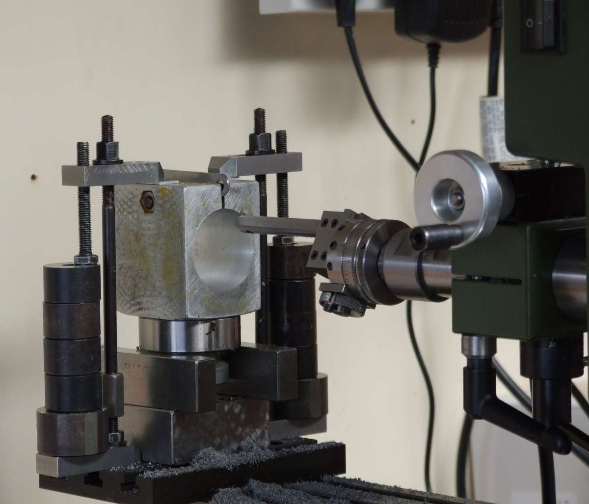

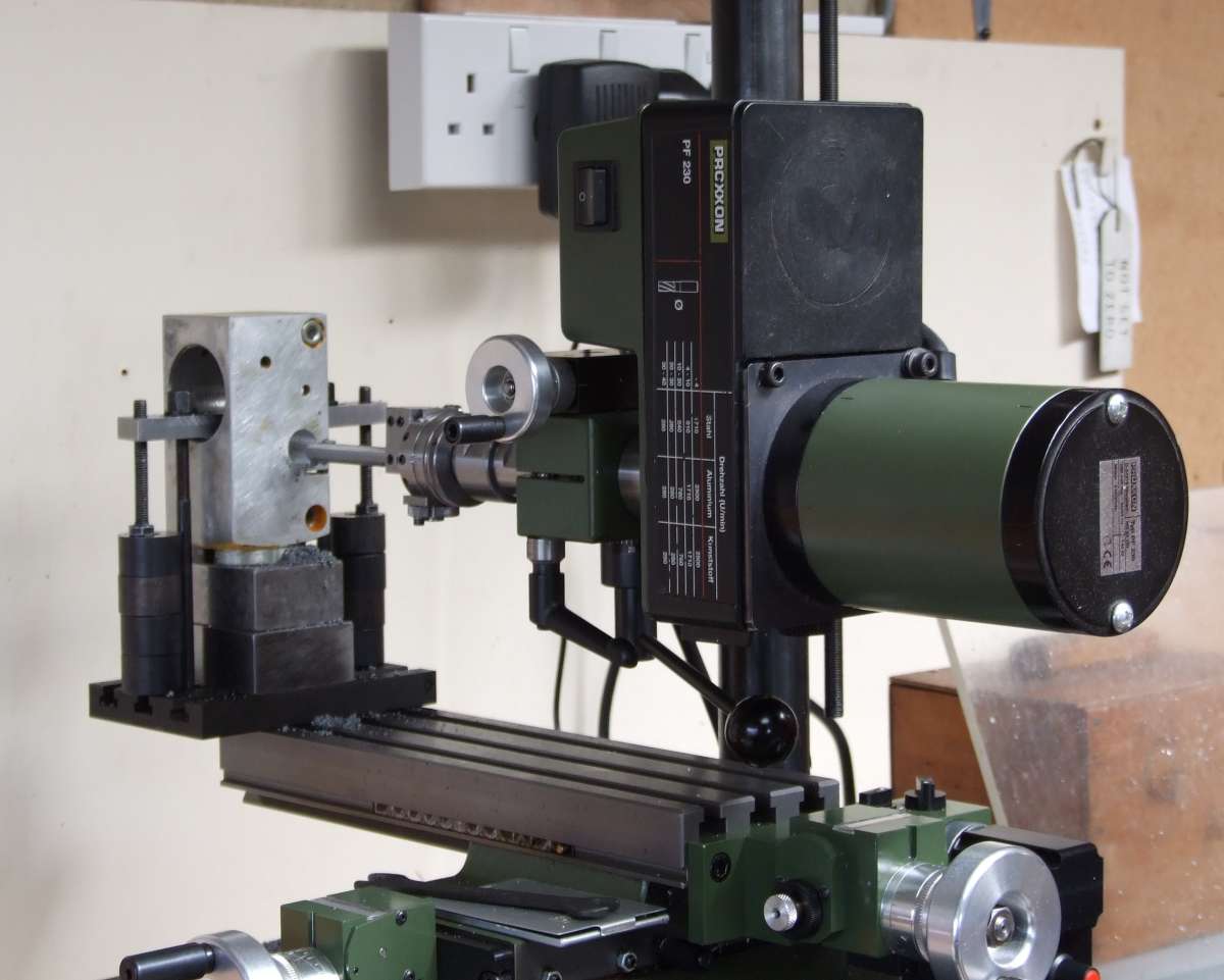

                                While spares are still available for this machine I decided to see if I could do a salvage scheme. Finding a piece of Duralamin Tube which would take care of the bores seemed that fate was giving me a nudge to get on with it.
                                Thus the Proxxon was converted to a Horizontal Borer and a start made on reclaiming the Pinion bore.
                                Reboring the Pinion location to 15 mm
                                The sleeve for this bore was made and fitted before work started on the Quill Bore. As the Liner for the Quill bore bore would lock the Pinion sleeve permanently. Note the Unimat 3 Milling table adding much needed length to the Proxxon table.
                                Reboring the Column Location
                                Above shows the Slider being machined, I did not take a photograph of the Quill bore being machined for some reason.
                                The work went surprisingly well and I was amazed that chatter from such a long boring bar was not a problem. Cutter wear from the nature of the material used in the Die-casting was more of a problem. I could only manage about 3 passes before the HSS bit needed sharpening.
                                As I cannot insert anymore images at this post I will post the results later.

                                #845624
                                Graham Meek
                                  @grahammeek88282
                                  For those needing details on how to configure a mill in the Horizontal mode I have written a few notes up here, with photographs.
                                  Adaptation of the Proxxon Milling machine
                                  Below are the results of my labours.
                                  With Liner fitted.
                                  The above shows the Slider with its new bore, the liner material can easily be seen in this pre-paint view.
                                  Quill and Pinion Lever liner fitted.
                                  This shows two for the price of one with the new Quill and Pinoin bores.
                                  Over the next few days I hope to complete the parts with a new coat of Daffodil Yellow paint. We shall have to see if I have achieved some “invisible mending”.
                                  Regards
                                  Gray,
