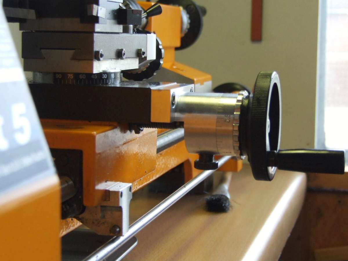

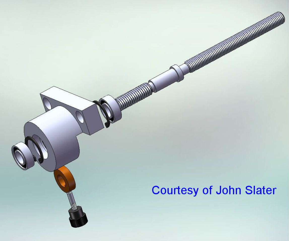

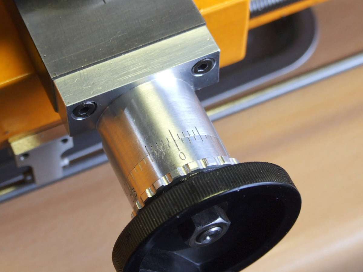

                  #707866
                  Graham Meek
                    @grahammeek88282
                    It has been a while since I posted anything new on this thread having just completed a revised Cross-slide feedscrew bracket for the C5. I thought I would brave the new forum and see how it goes.
                    feed screw assy
                    I have incorporated a locking mechanism to make adjusting the dial easier. The new slightly longer bracket now has a Vernier scale to allow 0.01 mm sub-divisions of the 0.05 mm main dial graduations.
                    Vernier Scale on revised Bracket
                    The new screw cut feedscrew has made the feed much smoother in operation and the lock is more than capable of holding the feedscrew during alterations to the dial.
                    Side View showing Thumbscrew Lock
                    The Vernier scale was cut using the 40:1 dividing attachment I made for the standard C5 Dividing attachment. The Vernier needed a new 50 hole indexing plate. As the scale needs 62.5 divisions in total, which is not easy, but doubling this we get 125 divisions. Which is 16 holes on a 50 circle. Thus by setting the sector arms to cover 32 holes on the 50 circle we get our 62.5 divisions.
                    Test cuts have shown that it works and I am more than pleased with the addition, despite the cold workshop.
                    Regards
                    Gray

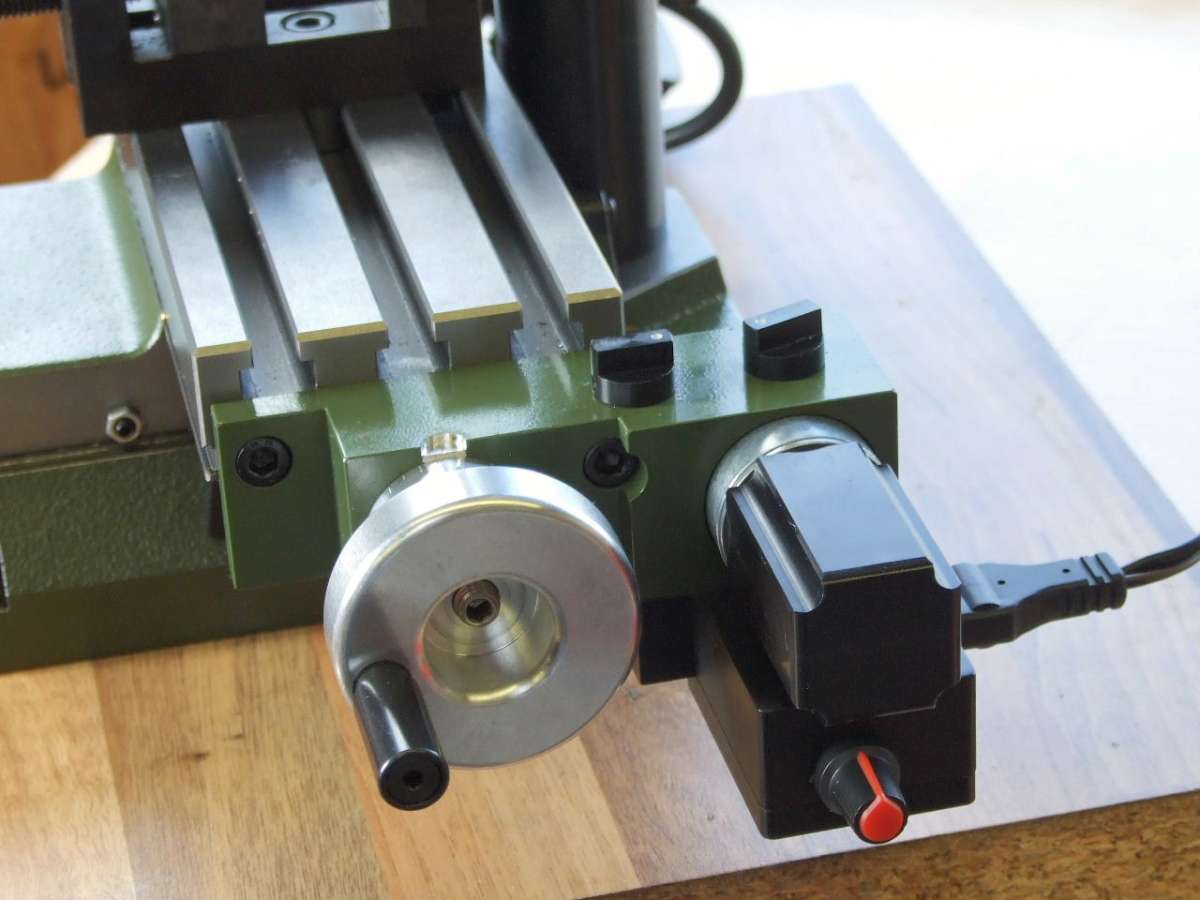

                            I have been toying with fitting a modified feed unit similar to the one I recently designed for the Proxxon Mill. At the handwheel end of the C5 thereby giving infinite electronic fine feed selection.
                            FF 230 Table Feed attachment
                            The leadscrew on the C5 and the feedscrew on the Proxxon mill are both M12 x 1.5P so I know the sort of range of feeds I will be able to get.
                            Completing this design and the other items is a priority at the moment. However I don’t think the publishing companies share our enthusiasm for the attachments to warrant a book.
                            Regards

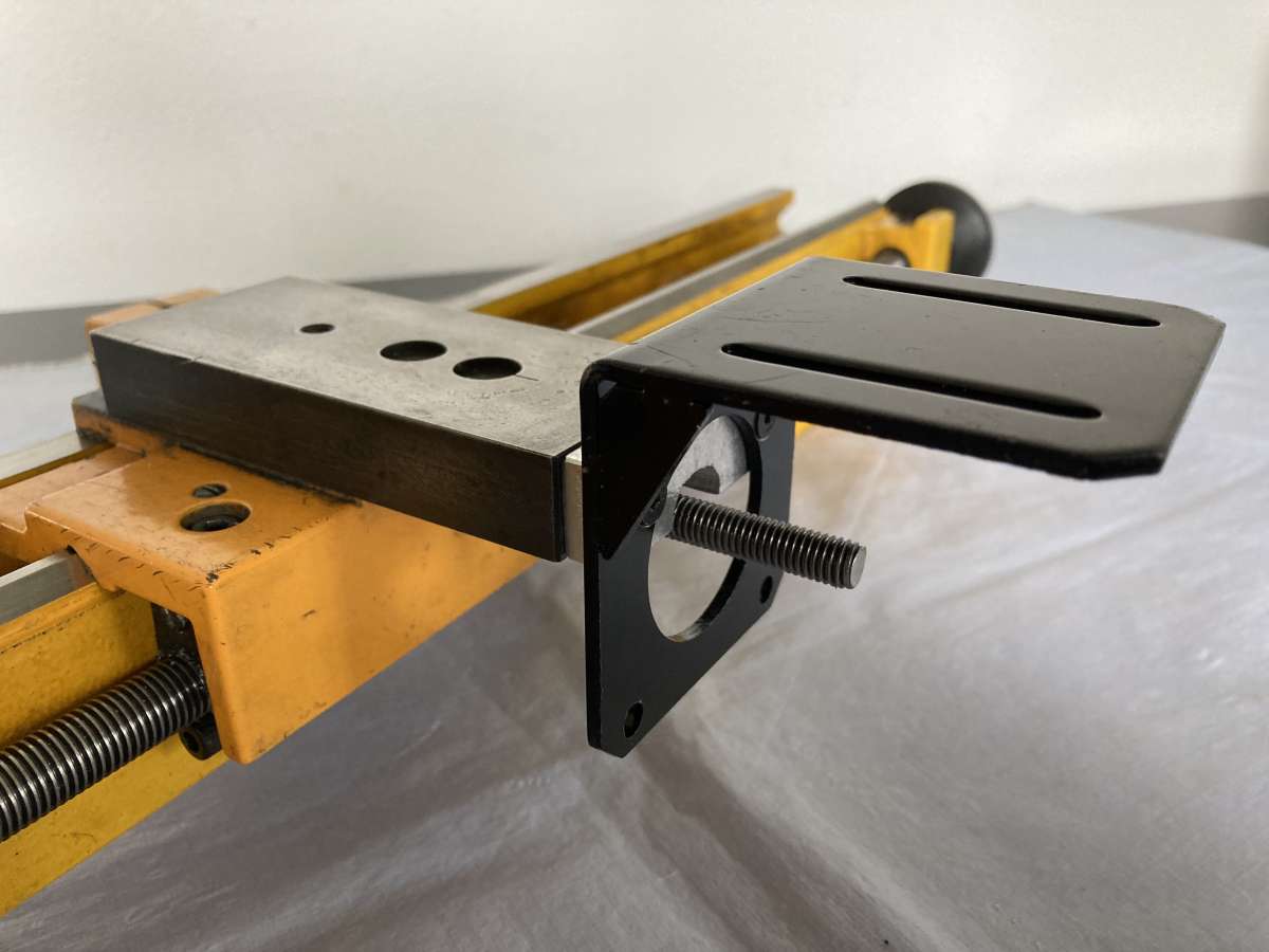

                            #708771
                            Jouke van der Veen
                              @joukevanderveen72935
                              Thank you Graham,

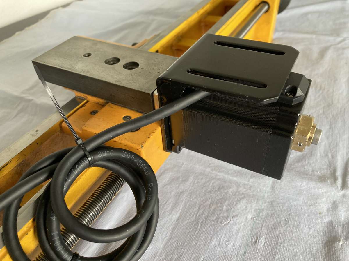

                              I am struggling with a motorfeed on the crossslide of the C5 bed to be used as a mill crosstable. It is good to hear that you work on the leadscrew feed.
                              The idea is to fixate the crossslide screw in the (old design, without a halfnut for backlash correction) saddle and to attach a motor with a hollow axis direct to the front of the crossslide. The motor then moves along the fixated screw by means of a adjustable halfnut) in the rotating hollow axis.
                              I realize that putting all things in line will be critical. And the motor I have already is an nema23 and is rather heavy on the end of the screw when the crossslide is in the frontend position. All details have not yet been settled. Perhaps I have a picture somewhere. I did some pre-assembling.
                              #708885

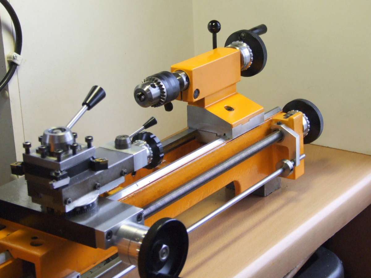

                                Pete
                                  @pete41194
                                  Very interesting and as usual well thought out, designed and machined modifications to your C5 Gray. I did notice your still using the OEM cap screws to lock the quill and tail stock to the bed. I bought a pair of ratcheting lever handles with the same male thread pitch Emco used. Less than 5 minutes to replace both and extremely nice to not have to hunt for the correct sized wrench ever again. The convenience far outweighs there minor cost. In the UK I seem to remember there called Bristol handles? In my opinion, Emco should have provided the same on all the C5’s.
                                  When I bought mine I always got a fairly serious taper on longitudinally turned work. Adding what Emco called there “leveling elements” to my C5 made it into as you’ve found a very accurate lathe. I’ve had mine adjusted to less than .0002″ taper in almost 12″ of 2″ diameter stainless steel bar if the cutting depths and feed rates are reduced to what the C5 is actually capable of.
                                  #709050
                                  Graham Meek
                                    @grahammeek88282
                                    Hi Pete,
                                    The above picture does not show enough of the tailstock to show my set-up.
                                    My C5 Lever Clamping Tailstock
                                    The tailstock utilises the existing M6 capscrew to clamp the tailstock to the bed via the lever situated by the dial. Once the capscrew is adjusted it requires no further attention. If you look closely under the drill chuck you can see my tailstock barrel clamping lever. This is supplied by Elesa and is a parallel handle version, GN 302.1 which is not as long as the more common Kipp type levers.
                                    The only file I have will not load on this forum. I also use the same lever to lock the Bed as it is shallow enough to miss the topslide.
                                    Regards
                                    Gray,

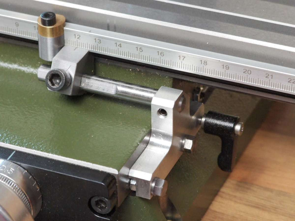

                                    #709076
                                    Graham Meek
                                      @grahammeek88282
                                      The style of lever can be seen in this M4 version that I have installed on the Proxxon Milling machine.
                                      X-Axis Attachment
                                      Regards
                                      Gray,

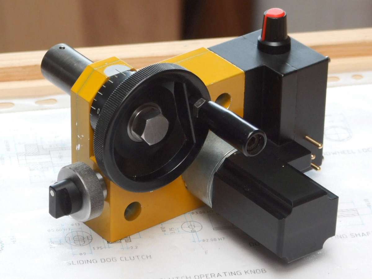

                                          A while back I said I was toying with fitting the Proxxon mill feed unit I designed on the C5. Well today I finally managed to get the bits together and give it a try.
                                          C5 Electric Power Feed
                                          This is the only photograph I had time to take today. I hope to take some more tomorrow with it actually on the lathe. Initial test have lived up to expectations and the fine feed is about half of what the standard Emco fine feed was using their feed attachment.
                                          Regards
                                          Gray,

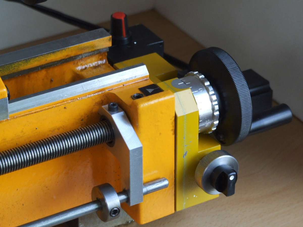

                                            #732354
                                            Graham Meek
                                              @grahammeek88282
                                              Thanks Colin for your kind comments.
                                              As promised here is a photograph of the feed unit fitted.
                                              Emco C5 Electic feed fitted JPG
                                              The large knurled knob controls the Dog clutch to engage the motor. The black Knob with the white dot controls the direction. While the black knob to the rear is the On-Off and variable feed control.
                                              I have only had chance to do some quick tests cutting 16mm diameter Brass and EN1A Pb at 550 rpm. The lathe will quite easily cope with deep cuts, but I am not sure I have the reaction time for the faster feed rates with shallower cuts.
                                              All in all I am pleased with my efforts.
                                              Regards
                                              Gray,

                                                Graham Meek
                                                  @grahammeek88282
                                                  Thanks Harry,
                                                  This mod has the advantage of being able to leave a screw cutting train set up on the quadrant. This is handy if I have several parts that require screwcutting and the parts don’t lend themselves to being re-chucked or mounted between centres.
                                                  It would also be handy for someone who has the C5 but no feed attachment.

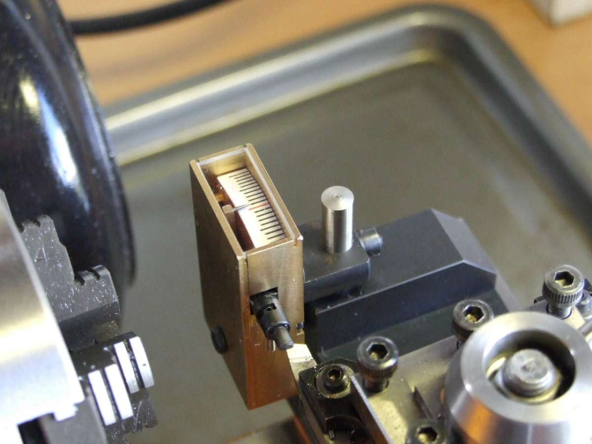

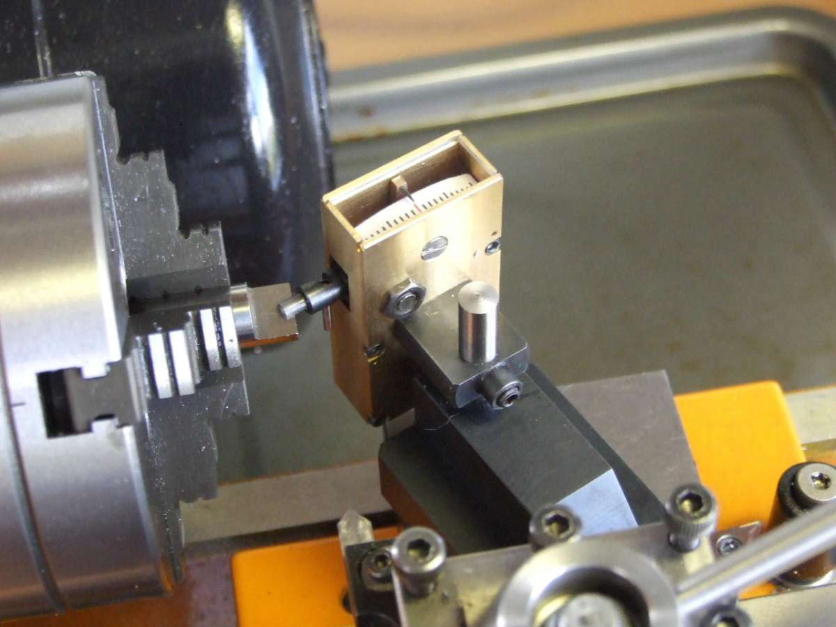

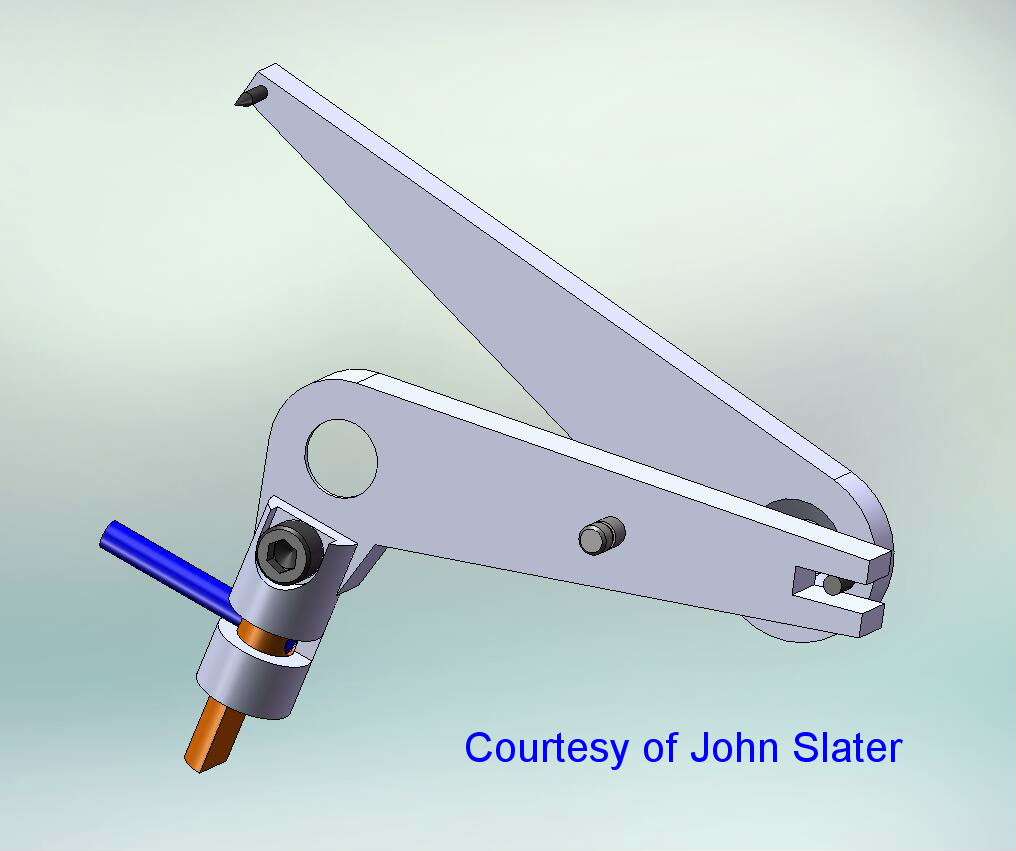

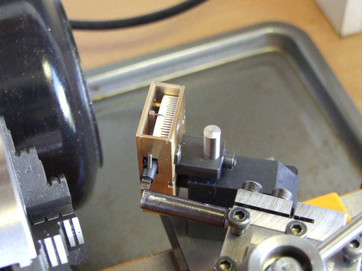

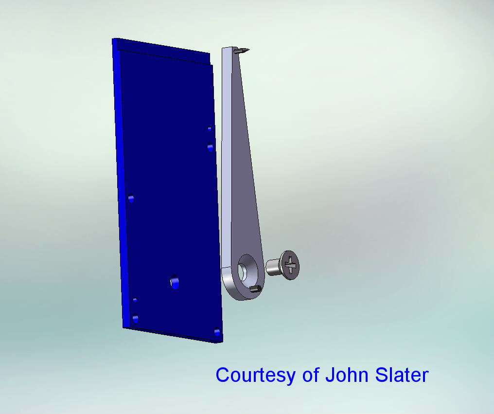

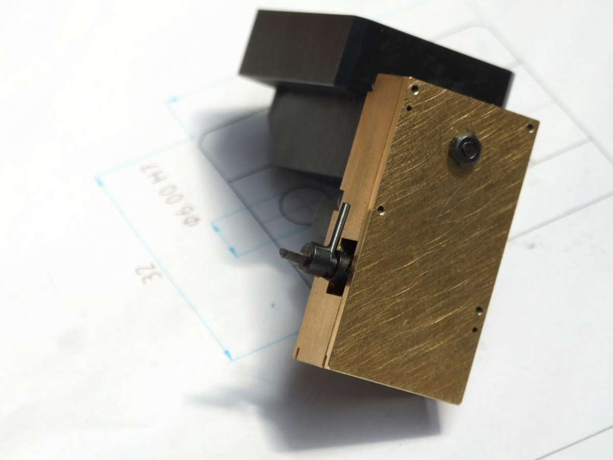

                                                  #736423
                                                  Graham Meek
                                                    @grahammeek88282
                                                    The latest item to be made for the Compact 5 could quite easily be adapted for any type of lathe. It does warrant a listing under “Tool Height Setting Gauge” but to be honest I have forgotten how to start a new thread on this new forum.
                                                    Since George H Thomas designed his Tool centre height gauge this has served me well for the past 40 years. Since going to a smaller lathe its use has been a bit of a trial. The size of the C5 cross slide is one issue the other being my failing vision.
                                                    Something which made my life easier and which was in keeping with the C5 was needed. Talking it over with John Slater back in January / February started a flurry of activity on the drawing board. Along with a multitude of Patents from John on Lever Operated Indicators.
                                                    Things were really simplified when John suggested using conical bearings for the pivots. These come in the shape of Carbide Insert retaining screws and I have to thank Ketan and Ian at Arc Euro Trade for their help here.
                                                    The design here was up to issue 10 before any machining had started. However it does live up to my expectations and has already made setting tools easier. One of the earlier designs had a more vertical scale which was viewed through a magnifying lens, (piece of Perspex rod). However a wooden mock-up of this version made it too big for the C5 cross slide.
                                                    The Gauge is shown being used to set the “Half Pin” horizontal before actually setting the Gauge to Zero on this pin.
                                                    Setting Turning Tool
                                                    This second image shows a turning tool being set. The pointer is on Zero, but the camera says otherwise, (parallax).
                                                    Upside Down Boring Bar Setting
                                                    By turning the Gauge Probe through 180 degrees and Moving the Direction lever. Inverted or upside down boring bars can be set without any alteration to the original setting of the Gauge.
                                                    Probe Detail
                                                    This view shows the Probe details.
                                                    Direction Lever
                                                    While this image shows the Direction Lever.
                                                    The graduations on the scale represent 0.05 mm per division and the scale is a simple print out.
                                                    More later,
                                                    Regards
                                                    Gray,

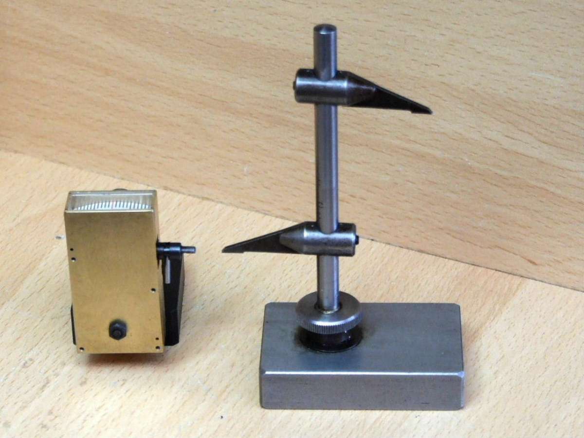

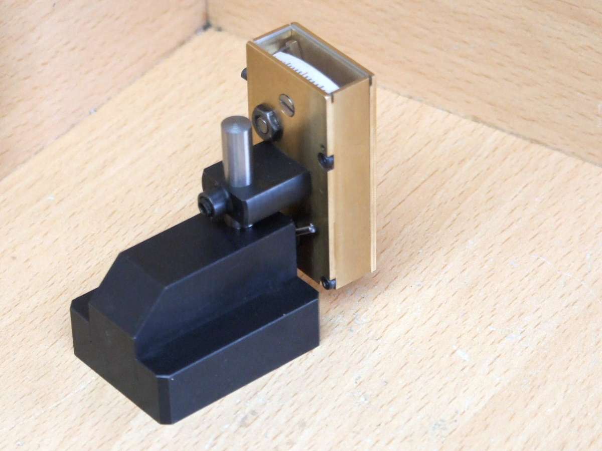

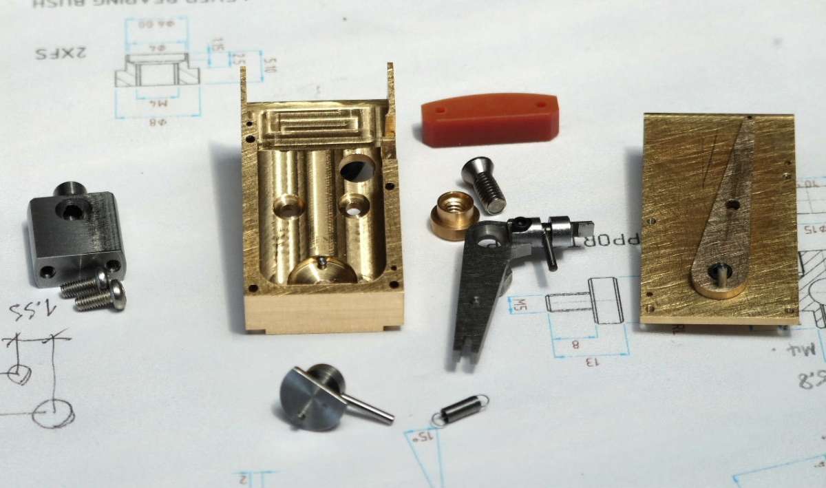

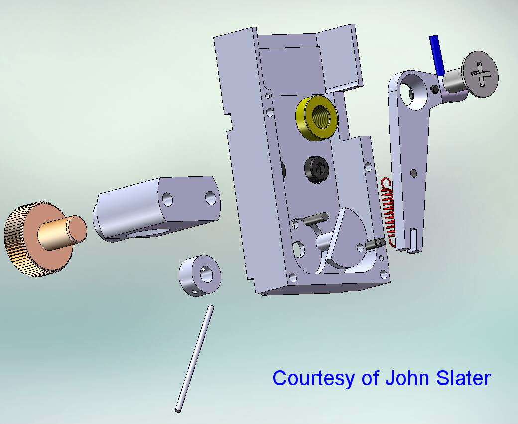

                                                    #736535
                                                    Graham Meek
                                                      @grahammeek88282
                                                      Further to the post yesterday.
                                                      This shows the internal workings of the Main lever.
                                                      Tool Height SEtting Gauge Main Lever
                                                      Below this shows the Pointer lever and attachment to the Cover Plate
                                                      Cover with Pointer
                                                      This view shows the Lever interaction
                                                      How Levers Interact
                                                      These are the parts before assembly less the base.
                                                      Parts of Tool Height Gauge
                                                      A comparison with GHT’s.
                                                      For comparison
                                                      That is about all on this little extra. There are two more items for me to make before I consider the C5 complete.
                                                      Regards
                                                      Gray,
