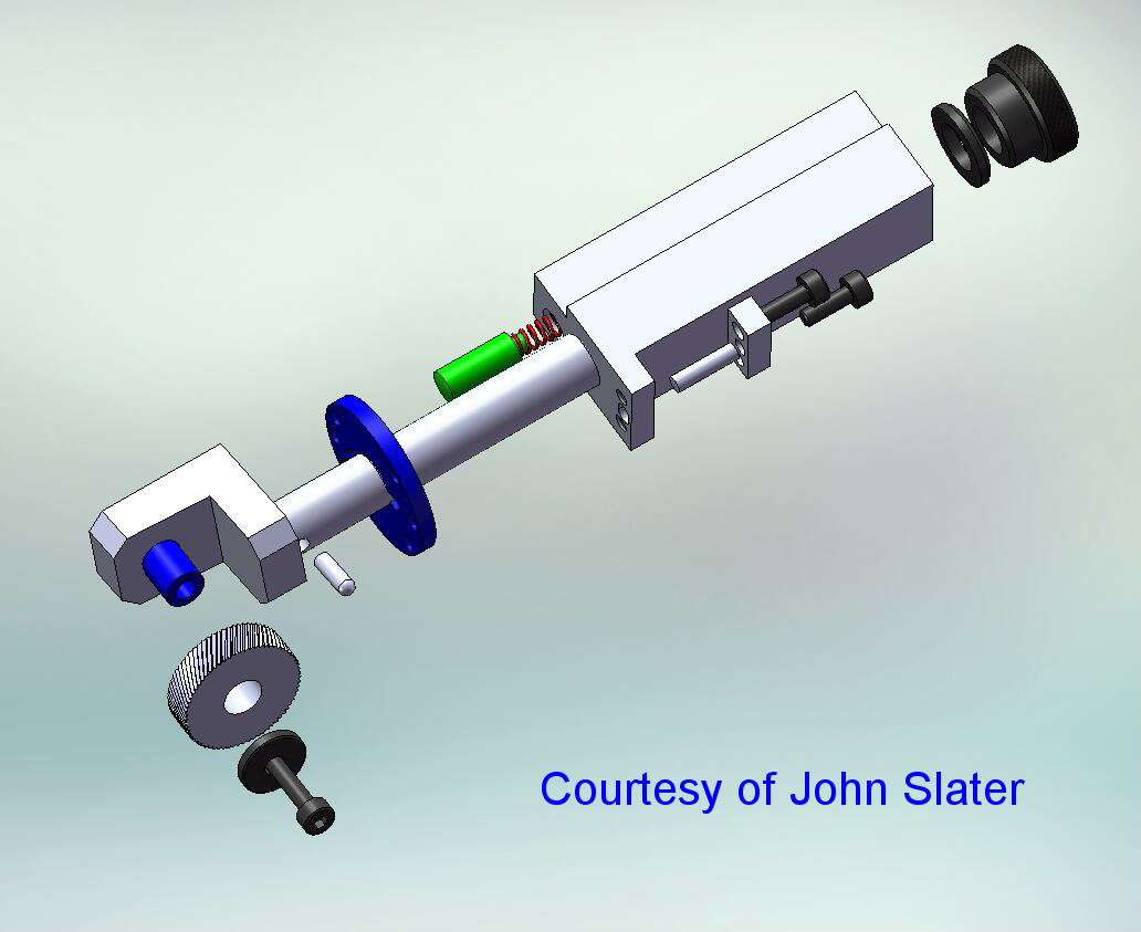

          John has just completed the 3D view of my diminutive Cut Knurling tool.
          c5 cut knurl 3D
          This shows the construction details very well, especially the fine adjustment, (the small block held by two cap screws), to correct the helical spiral some knurls produce because they are not at the correct angle. Note also the spring loaded plunger to keep the index plate in place when turning the head from one position to another.
          Regards
          Gray,

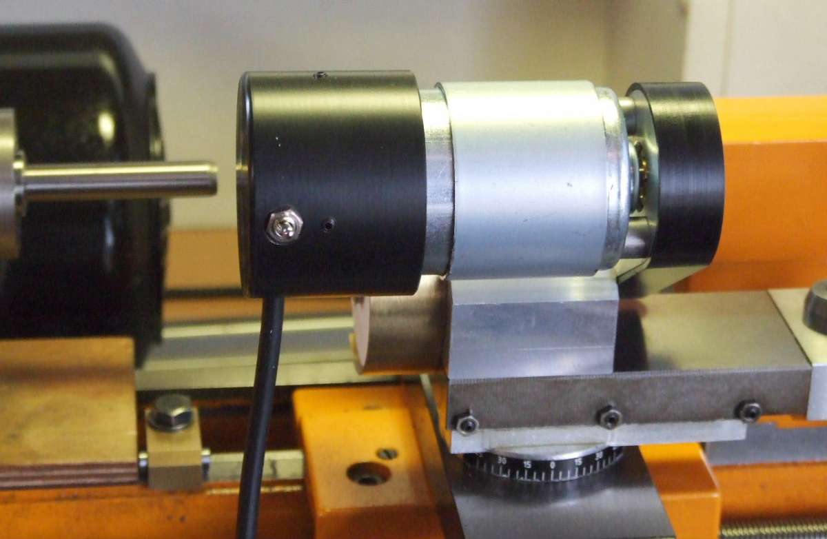

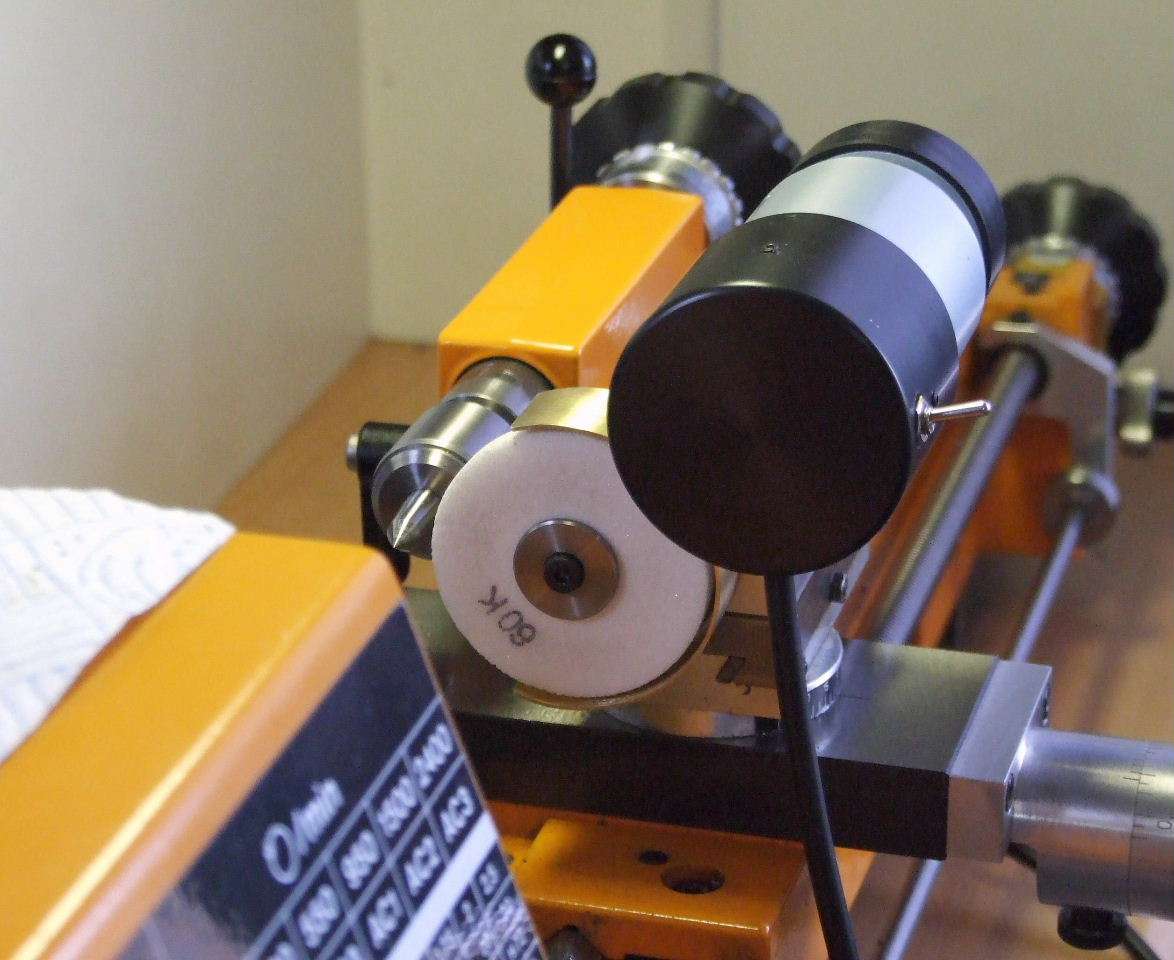

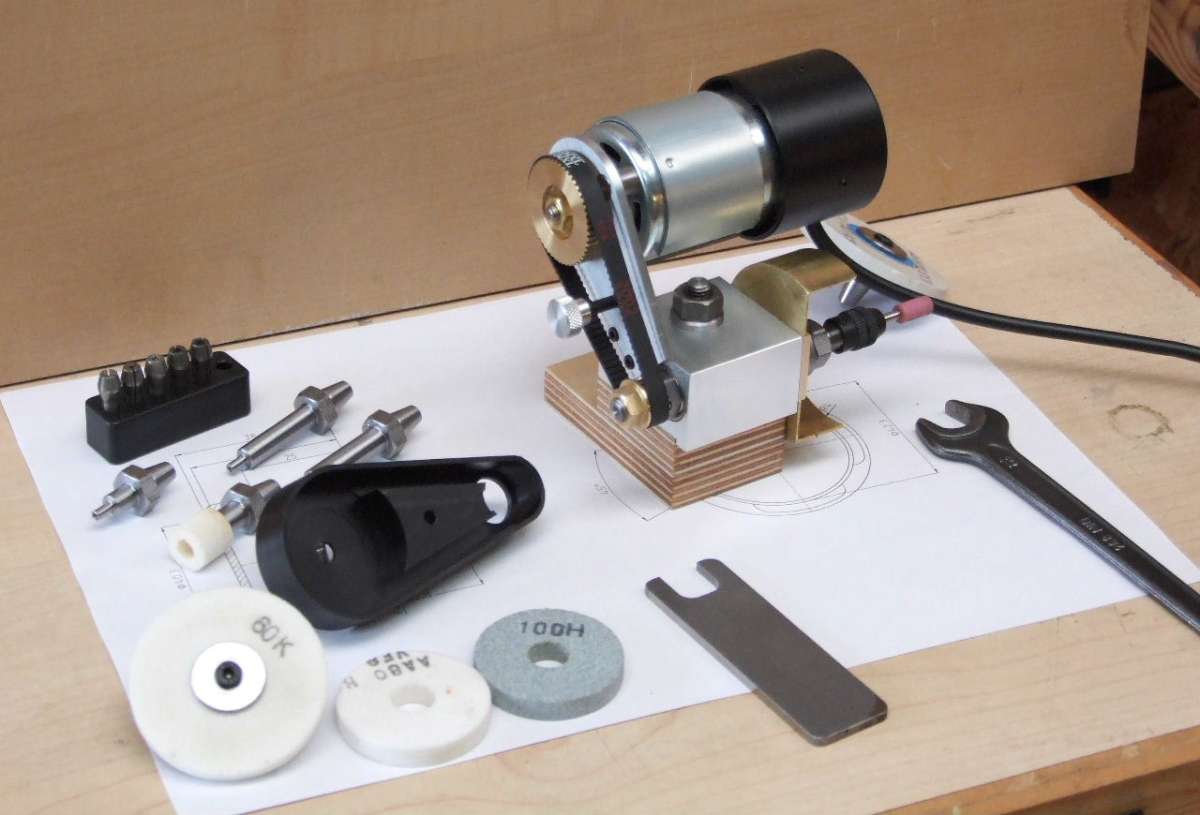

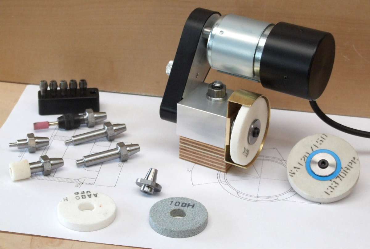

                Just a few photographs to show the latest additions to the C5.
                C5 Toolpost Grinder
                This next view shows the drive cover removed and the Proxxon Collet chuck adaptor fitted.
                Cover removed showing drive and Proxxon Collet chuck fitted
                The two spanners are required to change the various Arbors. The Hexagon can just be made out behind the timing belt. The tapers ensure complete repeatability as regards concentricity and run-out once a wheel has been dressed.
                The next photograph shows the unit fitted to the lathe.
                C5 Toolpost Grinder Fitted
                It is not the best picture as the workshop space means I cannot get a better shot.
                Plenty of room between Tailstock and Grinder.
                There is plenty of room between the tailstock body and the grinder body as can be seen above.
                The next item is thanks to John Slater who provided the No2 Morse Taper blank. Those of you who have tried using a No 2 Morse Taper Collet in the C5 will know the collet disappears into the Mandrel socket by some considerable margin. This is not handy if the work to be machined is only just protruding beyond the collet. This attachment overcomes this problem.
                Morse No 2 Collet Adaptor
                There are a couple of other items I intend to add later.
                Regards
                Gray,

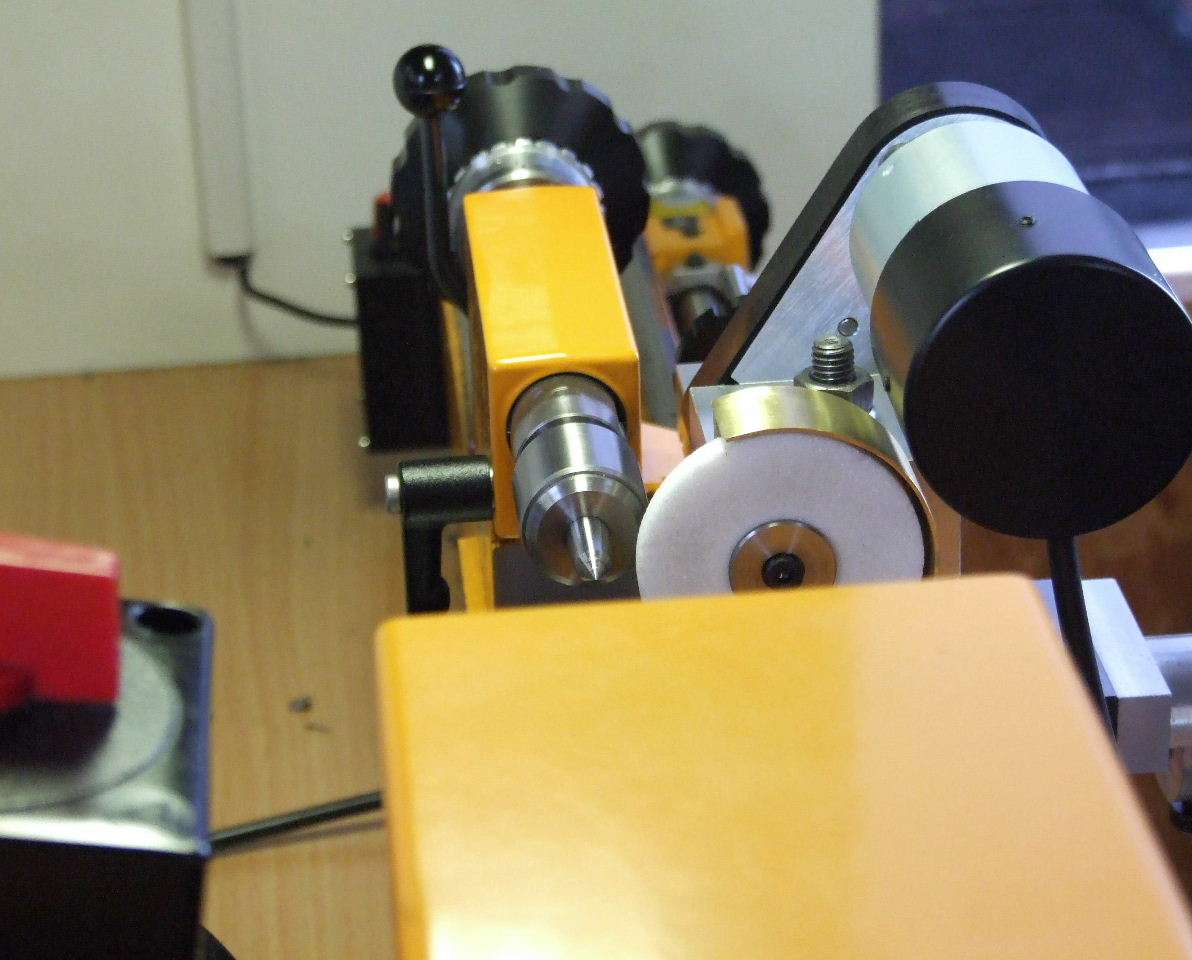

                    As promised there are a few more photos to share,
                    A view from behindJPG
                    This is the view from the operators position.

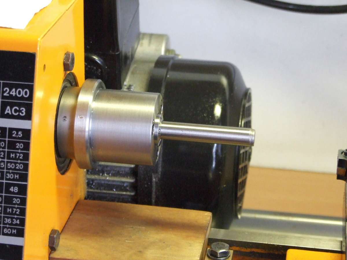

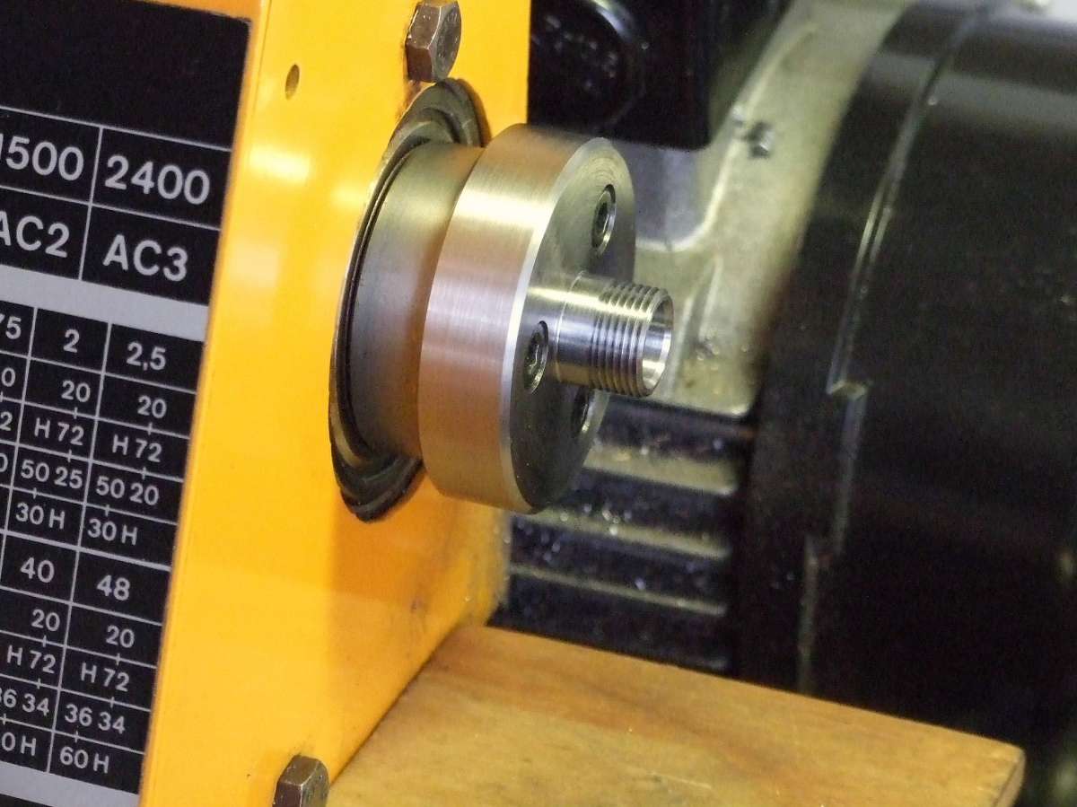

                    The next item has been waiting to be made for some while. It is taken from an article on U3 & C5 Accessories, by Graham Nickson.
                    C5 to U3 Spindle Nose AdaptorJPG
                    I have made it slightly thicker than the the original drawing as I wanted to use standard cap screws to attach the adaptor, instead of the countersunk screws shown on the drawing. I should point out that this article contains a Drawing Error. The Pitch Circle Diameter (PCD) for the attachment screws is shown at 30 mm. This should be 29 mm PCD. It may well be the information supplied by Graham was correct but it may have been regarded as the wrong dimension by the magazine, alas we shall never know.
                    This next item was originally intended to fit the U3.
                    Soba 70mm Chuck adapetd to fit C5
                    When I first tried to fit this 70 mm Soba chuck to the U3 it fouled the headstock casting. The recess for the mounting face was too deep. A small skim off the offending face soon rectified this. When I stood back I felt the chuck looked hideous. Upon further investigation the scroll inner diameter would allow the 29 mm PCD of the C5 mounting screws to pass through. With the aid of a location plate to register on the 40 mm C5 Mandrel diameter and some M5 Allen grubscrews for radial adjustment I now have a chuck with “Griptru” characteristics. Which is very helpful in its new role on the Dividing attachment.
                    Regards

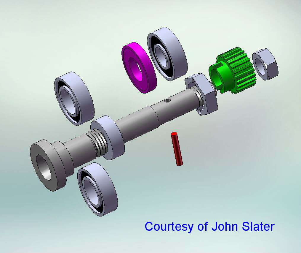

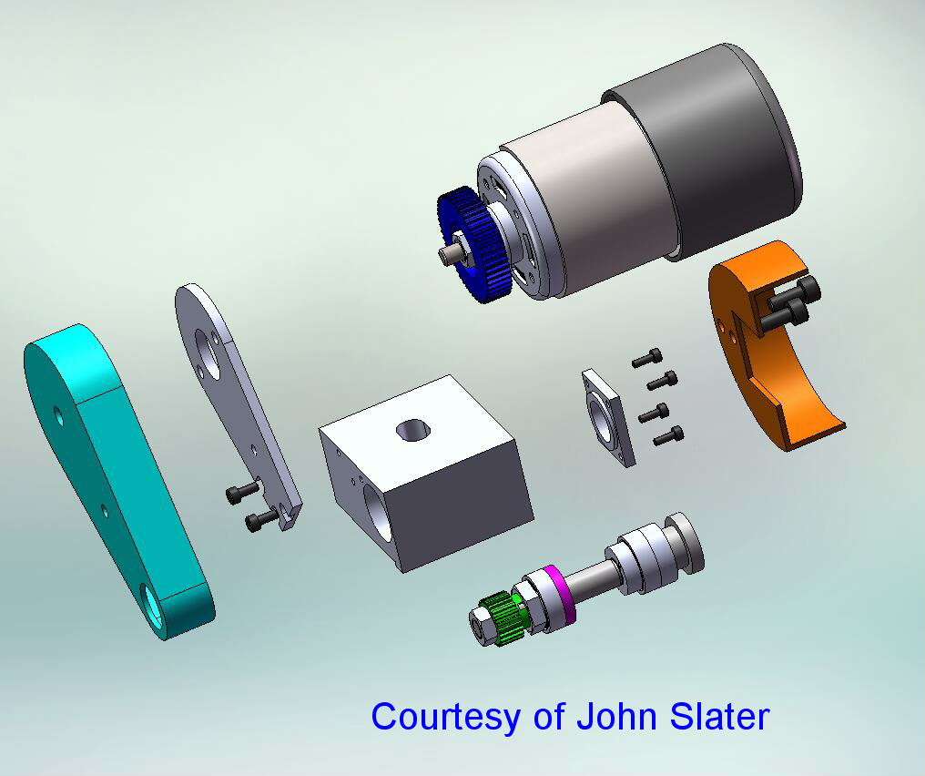

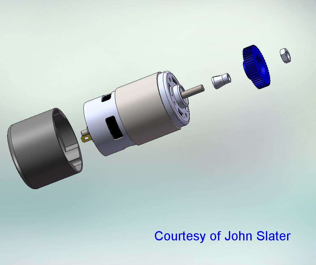

                      John Slater has been busy making some more 3D images of the Tool-post Grinder. This gives an idea of what is going on inside the unit.
                      Main Body
                      Main Spindle details
                      Motor Details
                      They say a good picture saves a thousand words.
                      Regards
                      Gray,

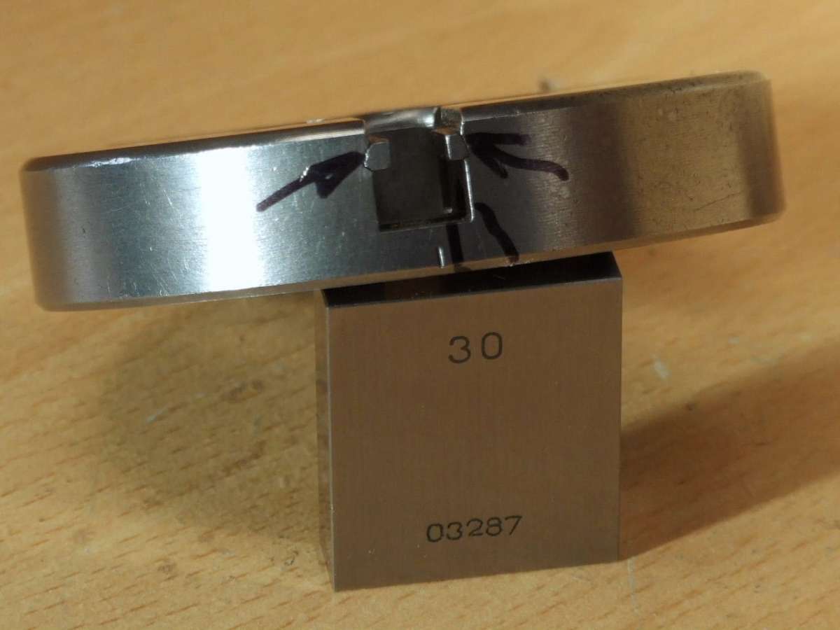

                      #786484
                      Graham Meek
                        @grahammeek88282

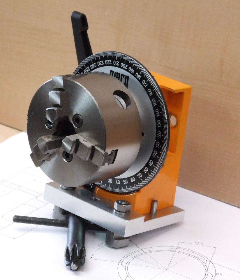

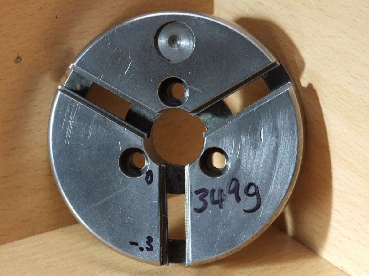

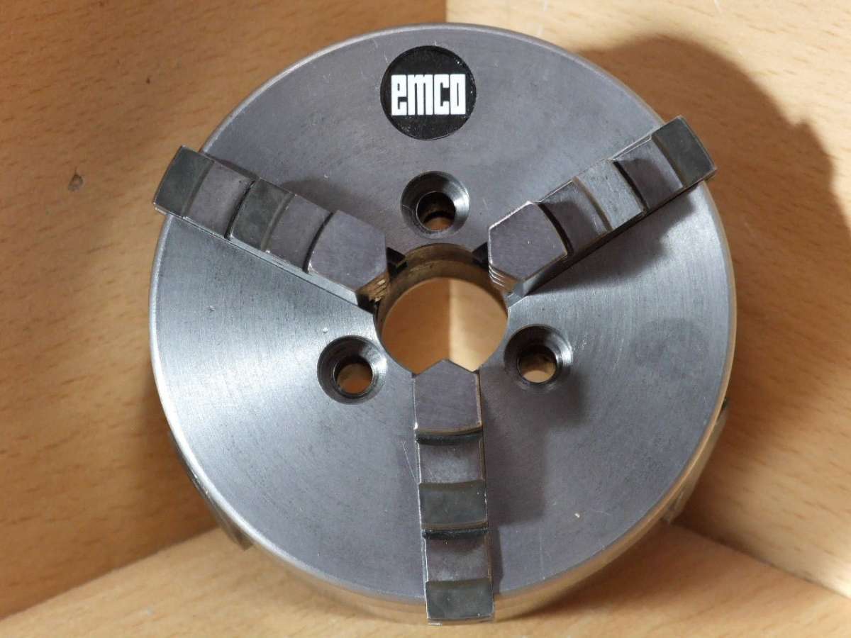

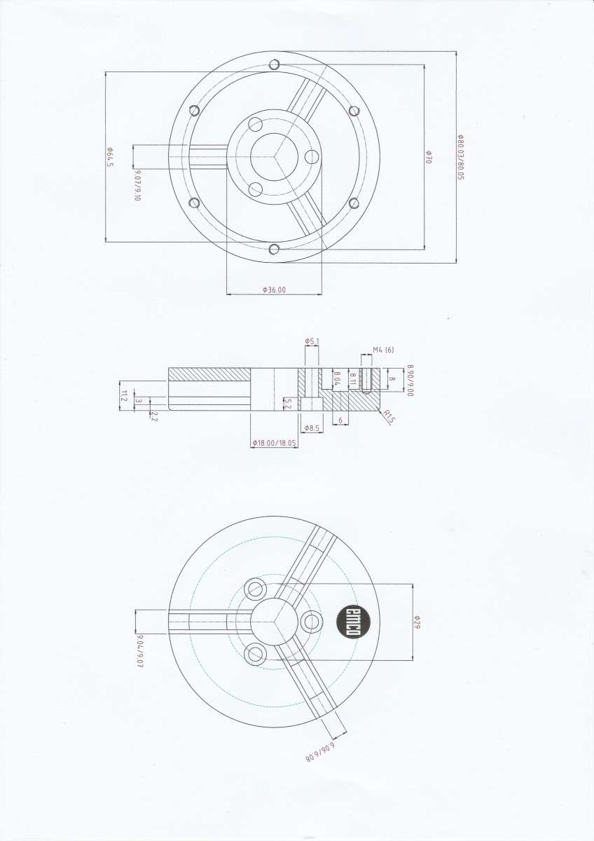

                        It is now twenty years since I purchased the Compact 5. In those twenty years I have been trying to acquire the 80 mm 3 Jaw High Precision chuck with the two sets of jaws, (V3U 176). For most of the time over the intervening years when these chucks appear on Ebay they are short of the set of reversed jaws.
                        When one did finally appear complete it was in the USA and the Vendor would not ship to the UK. However my Son-in-law has friends in the USA with his job with Microsoft and we eventually took delivery of the chuck about 2 weeks ago.
                        The elation of finally getting the chuck was dampened somewhat when the chuck revealed a 5 mm TIR, yes that is Five millimetres. Sending the chuck back via the protracted route was not really an option so the only thing was to sort it out.
                        Damaged Part
                        This first photograph shows it had received a hard life given the physical damage. What is not so apparent is why there is 0 to -0.3 deviation on the tenons in No1 Jaw location.
                        Areas of damage on No1 Jaw tenon
                        This second photograph starts to show the bigger picture. The two tenons are cracked and between the two felt tip lines can be made out a hairline crack which runs through the part.
                        Areas of damage on No2 Jaw Tenon
                        It was nearly as bad on No 2 Jaw location and again another hair line crack through the part.
                        The Finished 3 Jaw chuck
                        After 16 hours of work a new part had been made using the C5 and the Proxxon Mill. It may be of interest that the 90 mm cast iron blank that I started with lost almost two thirds of its original 993g in to swarf tray.
                        Emco 80 mm 3 Jaw Chuck face
                        A drawing was made from the existing part and cross checked with the 4 Jaw self centring chuck (V3U 178) that I have. One problem was going to be checking the 36.00 mm diameter which is recessed in the chuck body. The size of this diameter is critical as via the scroll bore this locates the two haves of the chuck. To check this accurately really required a Disc Micrometer. However buying one just to check one dimension was never going to be an option. Talking it over with John Slater we came up with a solution.
                        Unfortunately for now the photograph for that will have to wait.
                        Regards
                        Gray,

                          #786652
                          Graham Meek
                            @grahammeek88282
                            Hi Colin,

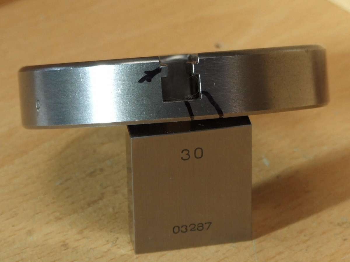

                            You are right about it being an emotional and physical trial. On the penultimate operation, producing the square slot beneath the new tenon. I had started cutting and nearly scrapped the part as I realised I had not locked the Quill. The quill fine down feed handle had started to counter rotate due to the vibration as it entered the void where the scroll sits. The cutter had started to rise. Putting a slight down feed on the handwheel and gently winding the X axis out of the cut I managed to do no further damage. Resetting the cutter and continuing the cut I could see a faint witness of the cutter in the underside of the tenon.
                            After completing the other two jaw locations I raised the cutter by 0.05 mm and passed back through the first location and luckily it cleaned up. Repeating this operation on the remaining other two locations completed this clean-up. All that remained was to off-set the cutter to establish the correct width on each location.

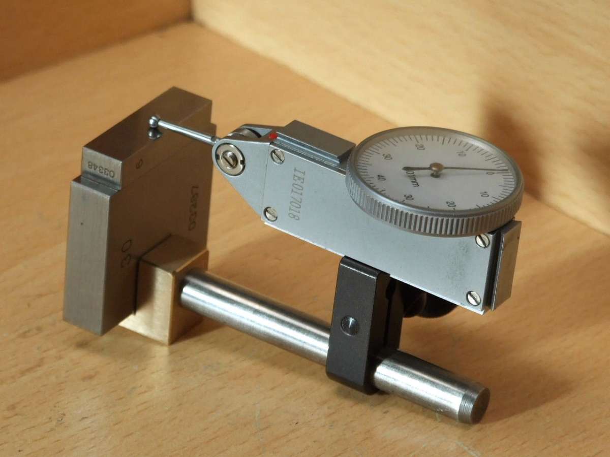

                            The final operation was to establish the thickness of the tenon and the correct width for the jaw location. I can assure you that after this I was feeling extremely tired from the concentration.
                            Back to the plot,
                            Checking Gauge for 366 mm dia
                            This attachment was kept as simple as possible. the only thing that required making was the L-shaped Brass block. It was envisaged during the discussions with John that the clock could be swung across the diameter while urging the Brass block against the diameter. In use it performed exactly as we had envisaged and made a very difficult task easy.
                            Machining the scroll recess was I thought going to be the hardest part. In the end I used a 40 degree included angle Vee tool, at 90 degrees tot he face. Similar to the standard Emco finishing tool. Plunging in 1.5 mm and moving in and out to just shy of the required finished diameters this tool removed the metal like a knife through butter. There was no hint of chatter either when I eventually had to form the 9 mm by 6 mm wide recess with a square ended trepanning tool about 2.5 mm wide. Once this was done It was possible to finish the rest of the recess with my insert boring bars.
                            To finish the 36 mm diameter the boring bar was used upside down and the lathe run in reverse. This whole operation was over in about 2 hours.
                            When it comes to reassembly the new front piece can be assembled in three positions. At each trail assembly the accuracy improved until at the last position, (it would have to be the last), I managed to achieve the best run-out results.
                            The worst TIR that I have is 0.04 mm, given the abuse that this chuck has received I consider that good, but I can improve upon it. There is a very slight Bell Mouth of Jaws 2 & 3 which I was expecting. As this is of the order of 0.01 to 0.005 mm respectively it does not affect the chuck. As proved yesterday while parting off the aluminium backing piece for the new Logo. Again this will be attended to once the internal grinding wheels have arrived.
                            This project has shown me one thing, and that is the Compact 5 can punch well above its diminutive size. Despite having what some consider to be an inferior bearing arrangement this machine performed faultlessly and above all accurately. I would certainly like to shake the designers hand.
                            I am tempted to grind the face and outside diameter of the chuck body with the toolpost grinder, but to do this will require an additional mounting block to bring the grinder closer to the operator than it does on the Emco topslide.
                            Regards
                            Gray,

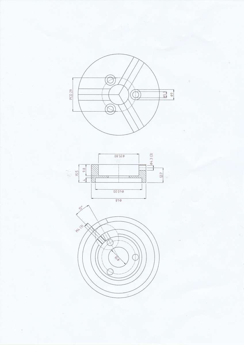

                              I have had a few requests for the details of the Soba 3 Jaw chuck Adaptor, so I thought it would be good to show the details here.
                              Soba-Emco C5 Adaptor
                              The spigot on the end of the Chuck Key will need shortening as the M5 attachment capscrews pass through the original Chuck key spigot location holes. It pays to reduce the length gradually, if this is over done the key will grate with the gear on the scroll.
                              Regards

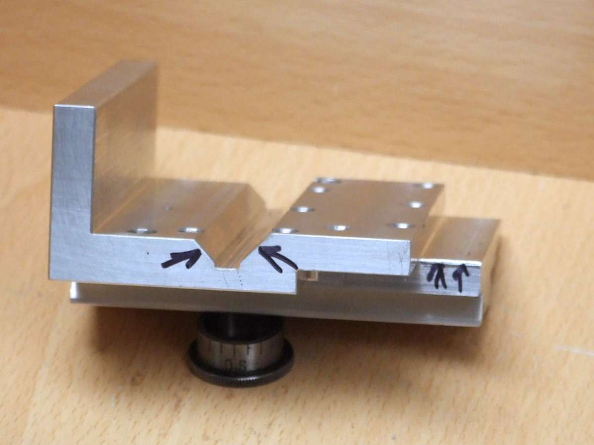

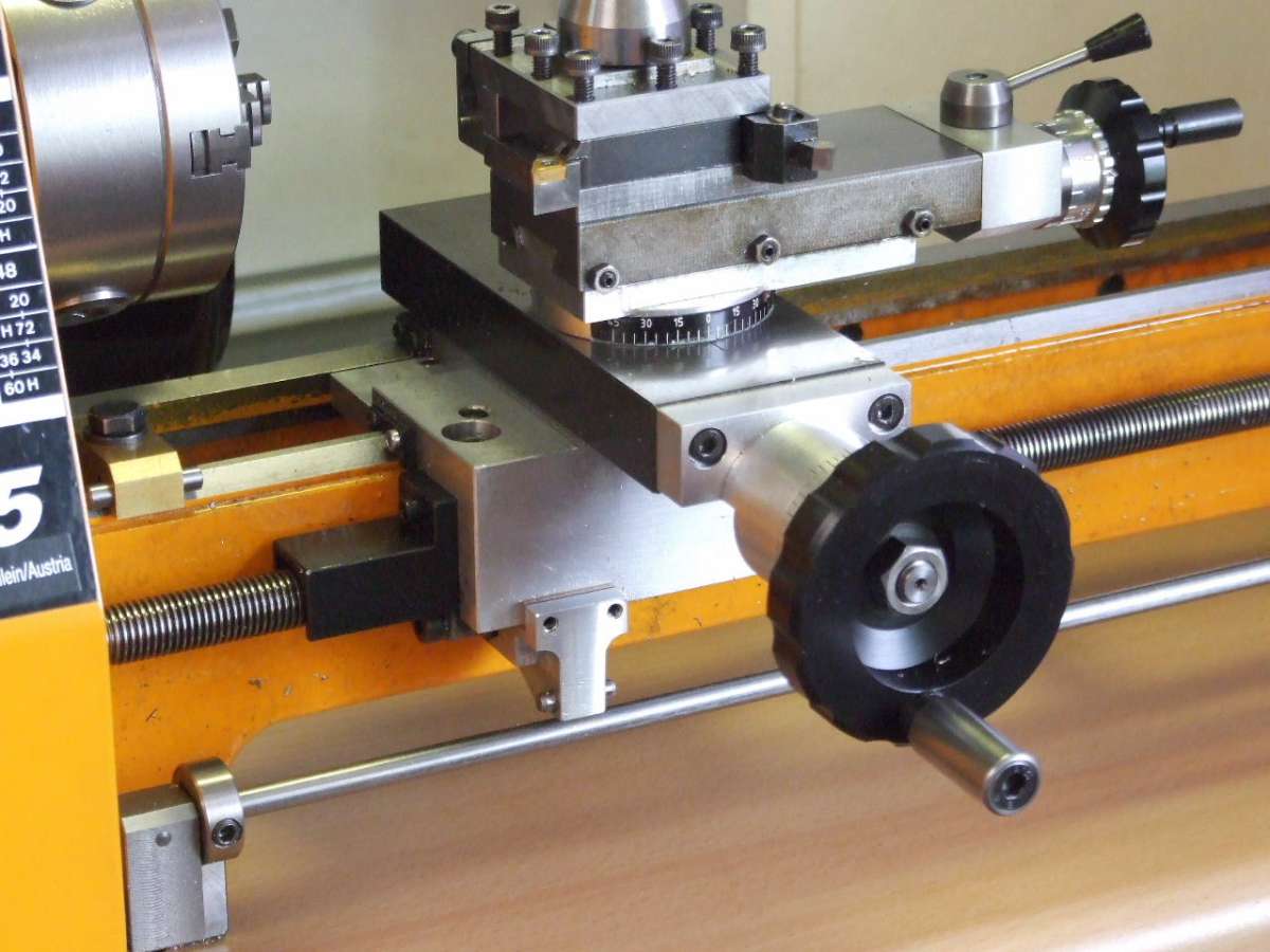

                              #802342
                              Graham Meek
                                @grahammeek88282

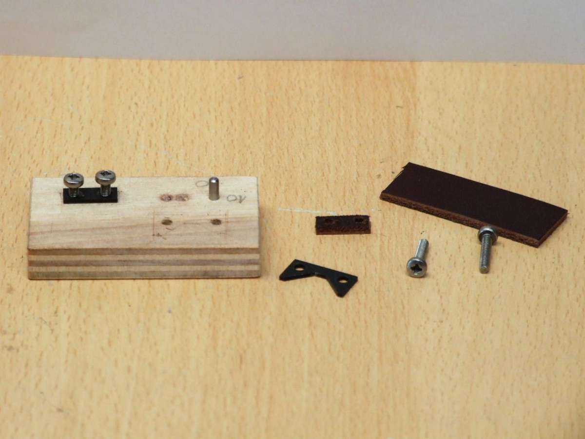

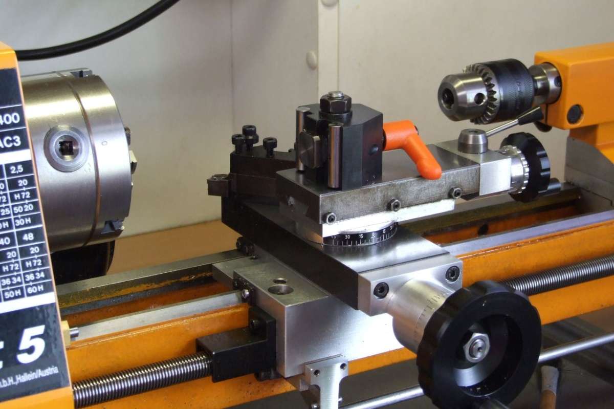

                                I recently experienced the Carriage on the C5 go extremely loose. Upon investigation the plastic retaining plates had split around the retaining holes. This may have been due to old age or a reaction with the cutting oil I use. I shall never know.
                                Upon measuring the amount of wear present on the slideways in the existing carriage it was decided to fit a new carriage that was lurking in the drawer along with some Tufnol retaining plates.
                                C5 New Carriage
                                One disadvantage with this move was the chamfers that were present on the end of each machined slideway. A square edge is to be preferred as a chamfer is just asking for debris to become trapped.
                                Chamfers in the wrong place
                                Thus it was decided to fit some leather wipers and wiper plates. At he same time I decided to add a leadscrew cover as the new carriage is narrower than the original die casting. Thus the leadscrew nut is more exposed. The new cover still retains the original felt wiper.
                                Wiper Making Tool
                                This is the simple fixture made to cut the leather wipers out. The holes in the leather are first cut using a special cutter in the drill chuck and the embryo wiper is held beneath a spare wiper plate and the excess trimmed off using a chisel blade craft knife.
                                Regards
                                Gray,
                                #802380
                                Colin Creed
                                  @colincreed93792
                                  Hi Graham,
                                  It’s always a real treat for me when you make your posts, Thank you.
                                  A few years ago I’d made myself some “way wipers” to suit my Proxxon PD 250/E Lathe.
                                  At the time I couldn’t get any felt of a suitable thickness & density, so I opted to use leather scrounged from an old belt.
                                  They’ve appeared to work fine but being I’m just a hobbyist, I’d often wondered if leather was the “best” choice..?
                                  So now seeing how you’ve approached the same problem & used leather to solve it, gives me confidence that my choice was right.
                                  regards Colin
                                  #802446
                                  Graham Meek
                                    @grahammeek88282
                                    Hi Colin,
                                    Thanks for the kind words and if I can help others through my scribblings then I am happy.
                                    Most of the Dean, Smith & Grace lathes I have worked on in my career have had Leather Wipers fitted. While Hard felt was my first choice for the C5 it proved to be too fragile to make the smaller wiper. Thus I went for leather as an alternative. It works just as well and absorbs quite a bit of oil, which keeps the Ways lubricated.
                                    Generally,
                                    One thing with this new carriage or “Sled” as it is listed on the web-site. Is it has about 50-60% more bearing area than the original die cast part. Given I have had the lathe about 20 years and the wear on the original carriage is only 0.1mm when measured against the new part. I think that is pretty good for a die cast part. More importantly the wear was uniform so with very little work I can refurbish this part and have a usable spare if I should need it.
                                    Regards
                                    Gray,

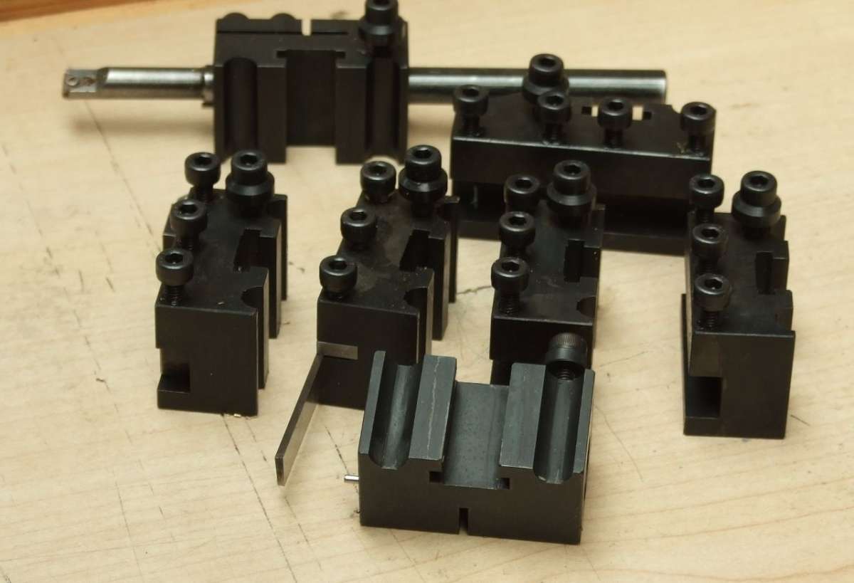

                                    #814652
                                    Graham Meek
                                      @grahammeek88282

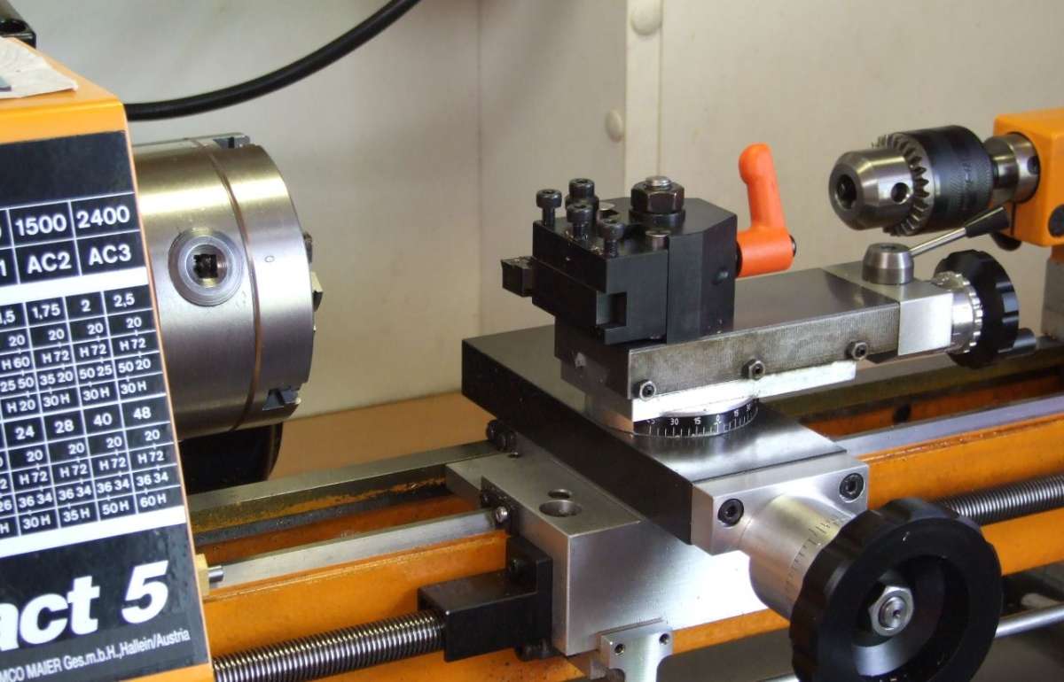

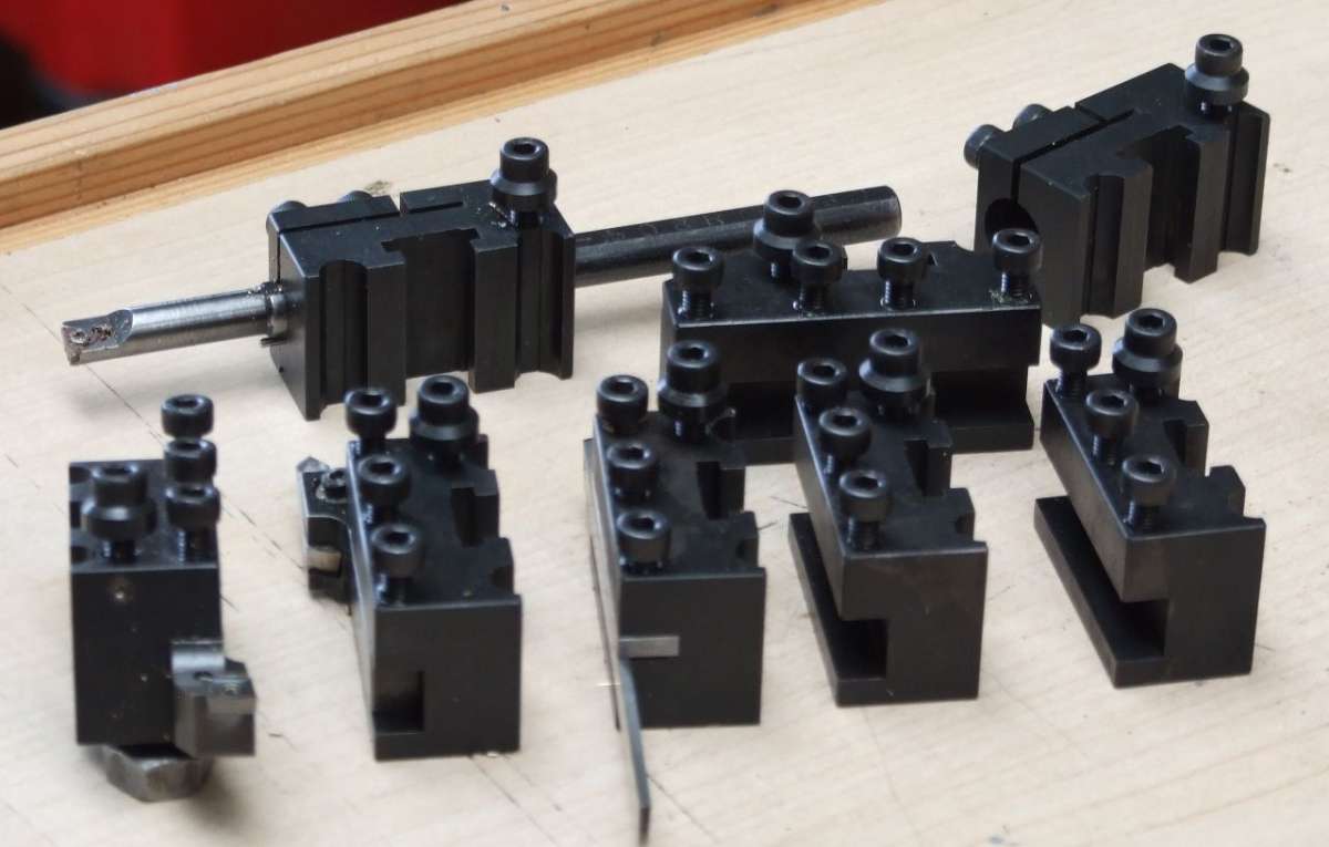

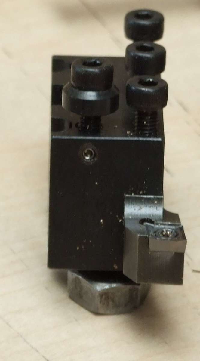

                                      On another thread on the Forum concerning a 3 Tool Turret I promised to load some photographs of the QC tooling I had just made for the Compact 5.
                                      QC Toolpost with Holder
                                      The design is an amalgamation of Harold Hall’s, J A Radford and with a little input from me.
                                      QC Toolpost
                                      The two locating cylinders are 7mm diameter Silver Steel and the Toolpost stands 30mm high.
                                      Range of Toolhoders
                                      All machining was carried out on the Proxxon Mill mentioned elsewhere on the Forum. I was particularly taken that this little mill maintained the centre distances for the location holes so well. Considering the tool holders were drilled, bored and reamed “back to back” with a 0.2mm thick cardboard as filling in the sandwich.
                                      I was even more surprised that the relationship of the holes with regard to the Tee-slot was also maintained. This is borne out by Orange adjustable handle locking up in the same position no matter what tool holder is inserted. (The jury is still out on the Orange handle, I might change that for something completely different).
                                      Flats at bottom of Groove
                                      A 3mm wide by 0.3mm deep flat in the bottom of the semi-circular recess means the faces of the location slots act more like Vee location faces. I certainly cannot fault the repeatability. While I was making the holders I remembered the extension tool holders supplied for the Dickson tooling system. Thus one of the standard tool holders is extended by 12mm. This view also shows how the parting blade is retained.
                                      Showing Adj Clamp Screw.
                                      The height adjustment was to be a turned and knurled affair working on an M4 stud. After making one adjuster I was not happy with this set-up. I decided to go back to Harold’s design and instead of locking the adjuster each time as in Harold’s design. I decided to use a Nylon snug under the M2.5 grub screw. This works in exactly the same way as a, Symonds, or self-locking nut. Once the adjustment is made it stays put until the next time. Plus I only have to pick up one Allen key for all adjustments.
                                      Regards
                                      Gray,

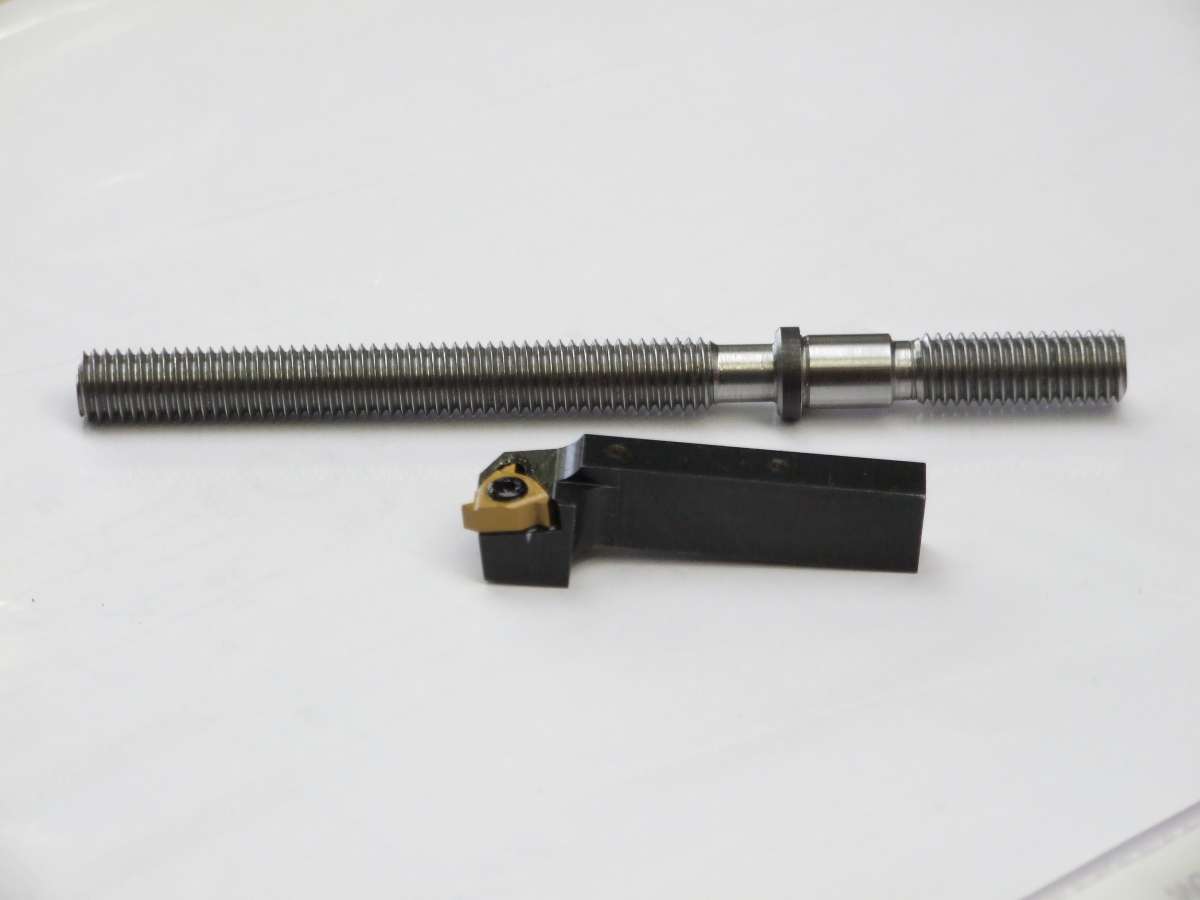

                                          #838026
                                          Graham Meek
                                            @grahammeek88282

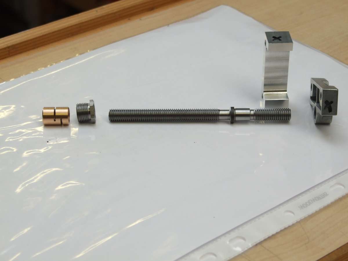

                                            It has been a while since I was in the workshop last. Just before my spell indoors I was able to finish the Screw cutting Insert tool holder.
                                            This last week I have had a chance to put it to use making an new C5 Cross slide feedscrew for a friends lathe.
                                            C5 Screw cutting Tool
                                            The material is an Alloy tool steel, I am sorry I cannot remember the designation. I have only ever known this material as “Arne”. The C5 took it all in its stride and I was impressed with the finish.
                                            Regards
                                            Gray,

                                                #838262
                                                Jamie Wood
                                                  @jamiewood67138
                                                  Hi Gray,
                                                  Lovely work as usual. Did you use a full profile insert for the threading?
                                                  I also must find time for this. A metric leadscrew is needed to convert an imperial C5 carriage/crosslide I got on ebay, along with the backlash nut. I considered buying one from Emcoshop.at but at almost €100 before shipping and customs, I thought that was enough motivation to try and produce one myself.
                                                  I haven’t done any threadcutting on the lathe before so I think some practise is needed first.
                                                  Jamie
                                                  #838292
                                                  Graham Meek
                                                    @grahammeek88282
                                                    Hi Jamie,
                                                    Thanks for the compliments.
                                                    The insert is not a full form type, it covers a wide variety of pitches. The same insert cut the 1mm pitch on the Hex adjuster screw below.
                                                    Conversion Parts
                                                    As regards the parts,
                                                    These were made in the past few days, ready for a new Carriage which will be arriving shortly. Once I have verified the drawings are right I intend to put them on this Post for future reference. (with a bit of help from Jason). They were made in response to another post,
                                                    Emco Compact 5
                                                    Regards
                                                    Gray,
