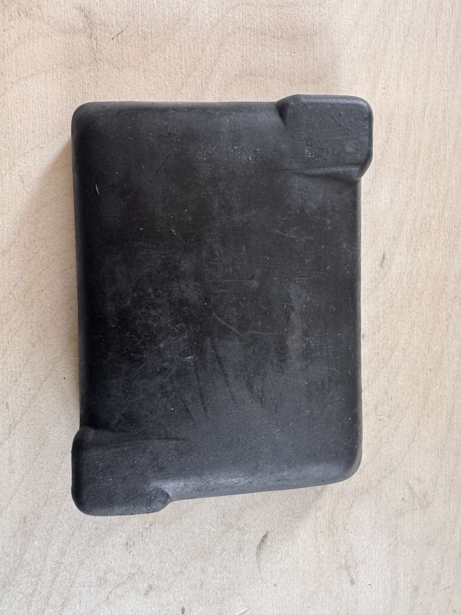

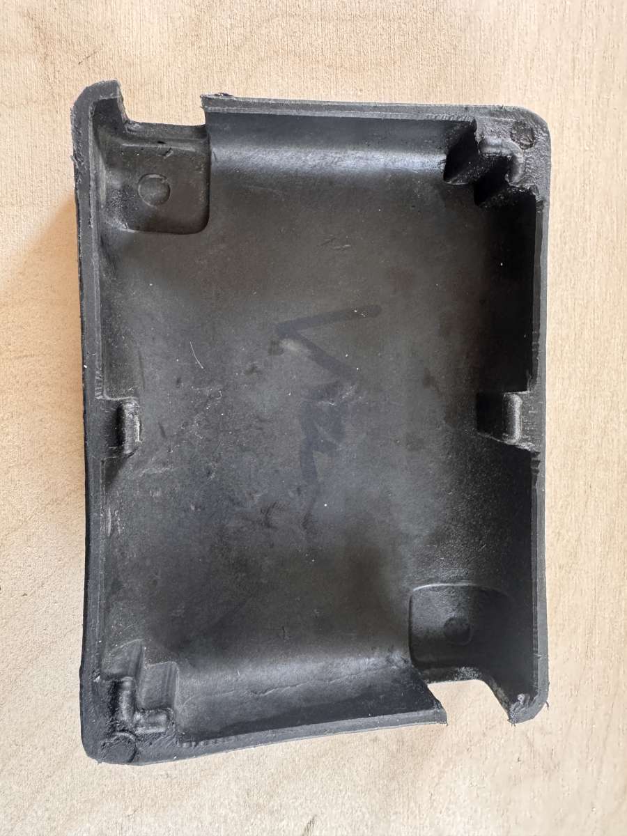

      I need a file to make a battery box cover for a motorcycle
      can anyone oblige (its a paying job)
      what do you need from me? an accurate dimensioned photo? or a drawing?IMG_0837IMG_0836

        Hi Ian,  I assume that you need a 3D file in a format for 3D printing?  It’s the sort of thing I do fairly frequently and as long as there is no screaming urgency I’d be happy to help out.
        In terms of what’s required. a full set of orthogonal photo views of the cover preferably taken from around 5ft away to reduce parallax errors.  Dimensioned sketches, major dimensions but also some detail, for example the depths of those recesses, presumably over the battery posts.

            Ian,  this is likely to be an iterative process with several printed protypes required before a satisfactory item is produced.  Best would be to let the designer have the old cover but, clearly, there is a risk in that if postal services are involved but other wise as detailed a sketch as can be managed, including various radii for the corners etc. Details of the base to which the cover is attached would also be useful to get the various clips correct.

              i have sent various photos and diagrams to alan above
              i was going to print it in abs
              the original is a sort of very hard rubber however my friend who needs it dropped something on his and it smashed into lots of bits

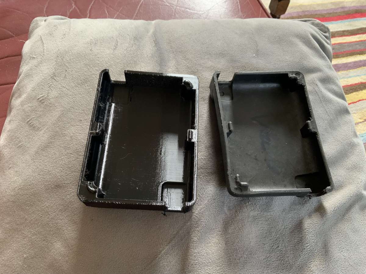

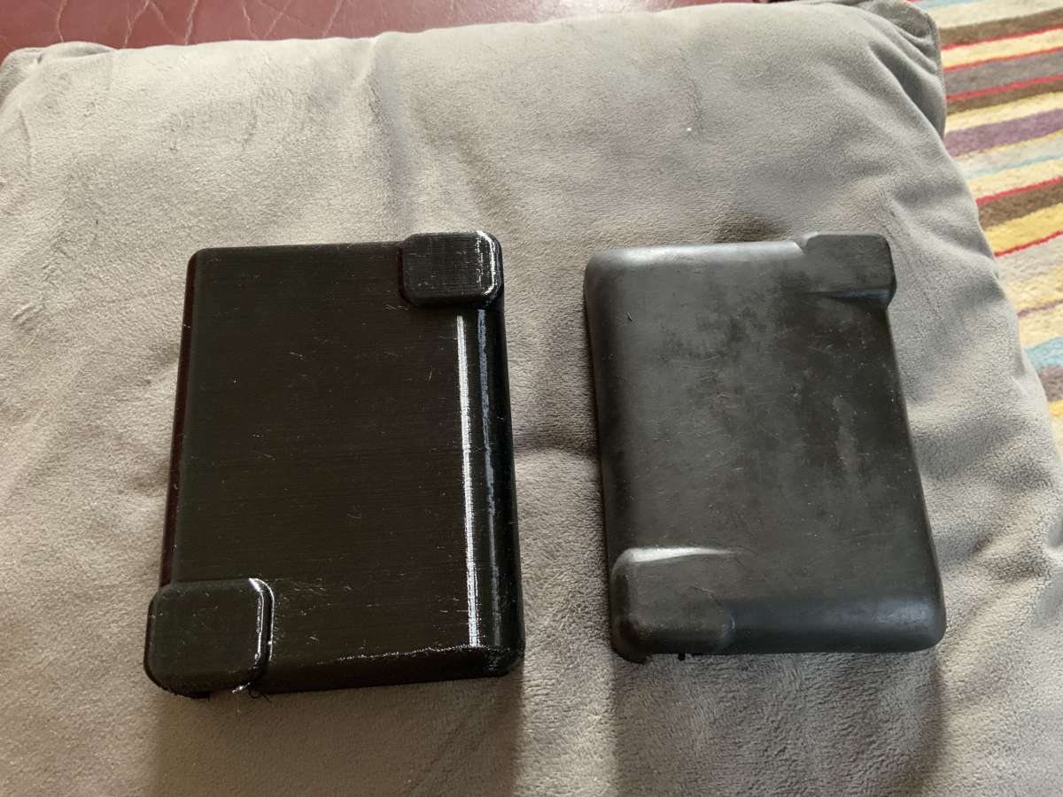

                        Here is the final print off the file that Alan kindly made me
                        it still needs a gentle sanding and matt varnishing perhaps
                        IMG_4618IMG_4619

                          Good Result!
