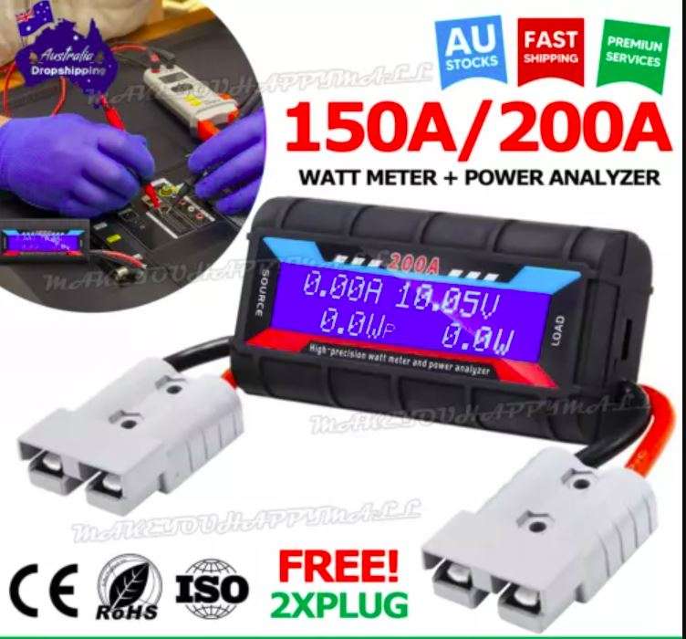

                                    I use one of these power meters to monitor volts, amps and watts on my solar system that I take camping. Use it on the input and output of the solar controller to see its efficiency. They are inexpensive and available on ebay, Amazon, etc.
                                    pOWER METER
