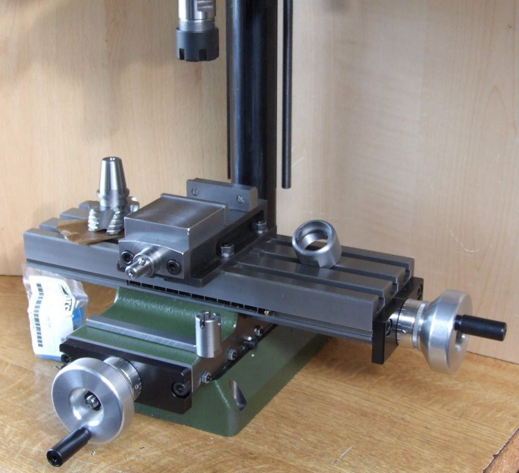

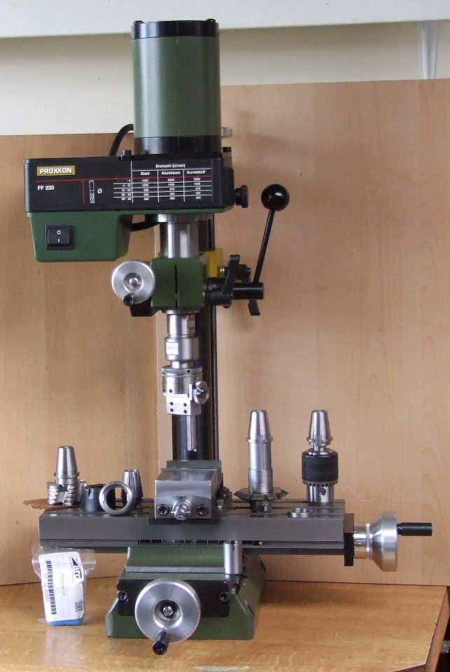

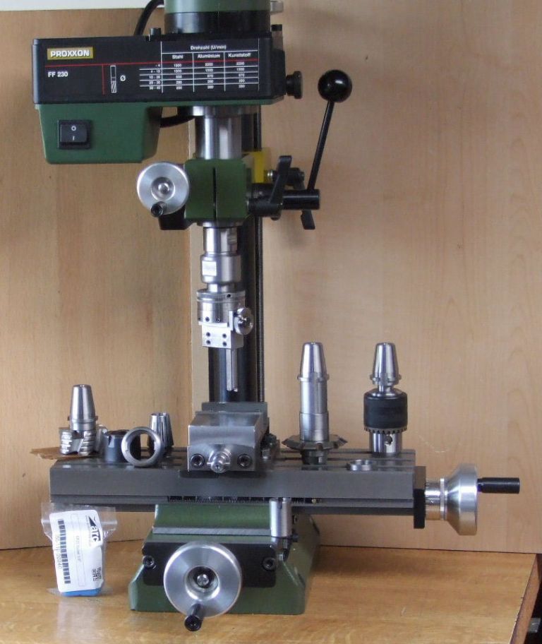

        Having already posted the above spindle modification I thought it might be as well to start a new thread as there are now quite a number of additions to the milling machine.
        The above photograph shows the dedicated tooling to suit the ER 20 Spindle Nose. A new Spindle Nut which has a bayonet fitting allows the various tooling to be removed and added in an instant. Some of the early CNC's used this type of fitting but with ISO 30 & 40 tapers.
        The Spindle nut is so designed as to self eject the taper when removal is needed.
        The Bayonet design can be made out in the spare Spindle nut on the table in the above view.

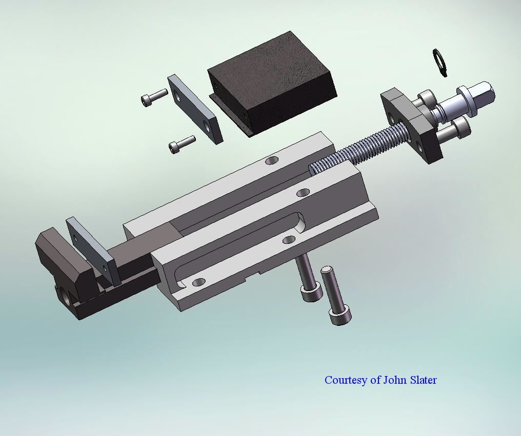

        I have also made a new vice for the machine, which is based on a Thiel design. John Slater was kind enough to do a 3D view of the design.
        There is a variable table feed under construction and I will be showing this at a later date.
        Regards
        Gray.

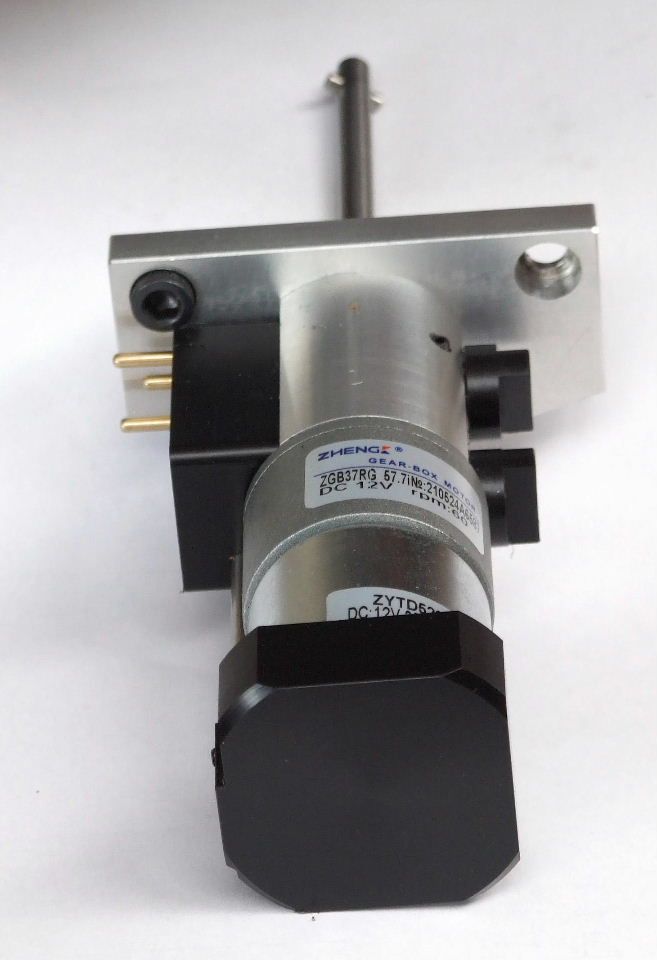

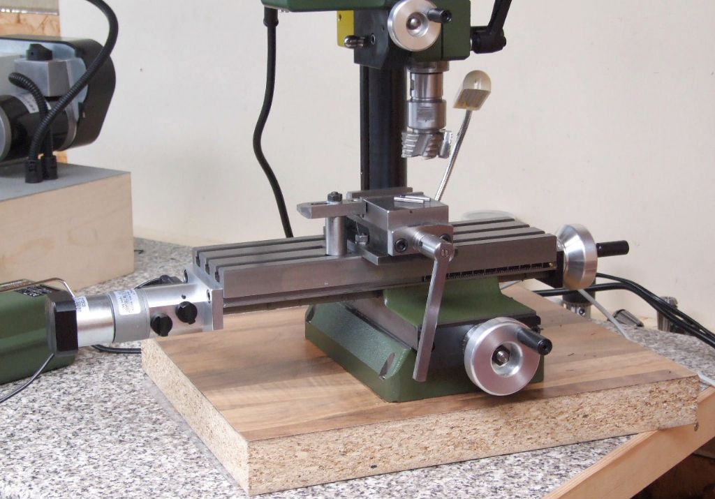

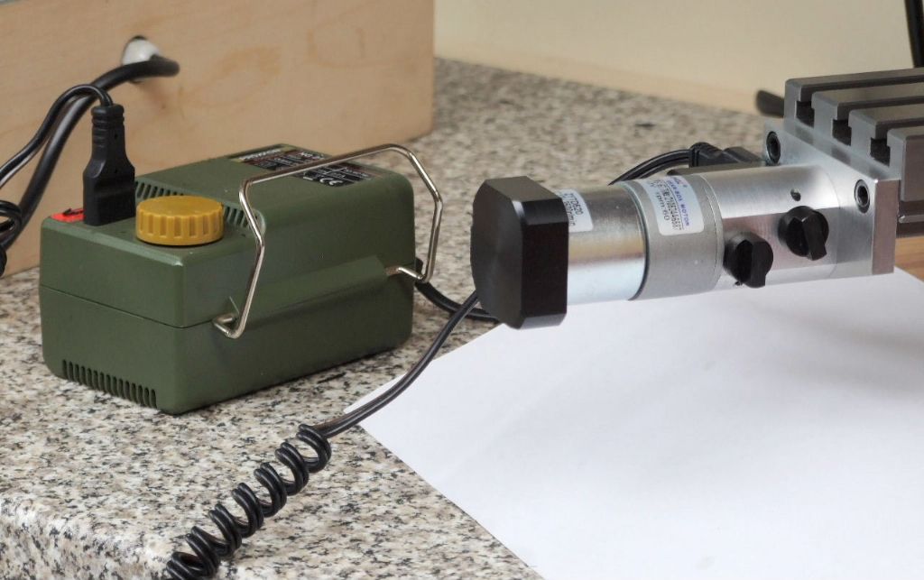

              Well the FB2 and the Maximat Super 11 have now gone and the Screwcutting Clutch for the Compact 5 is now up and running. Along with a dedicated Retracting Topslide.
              Work has now transferred to getting the Proxxon Mill to where I would like it to be.
              The work on the Powered table feed is now complete as shown above. This has been used by jury rigging the wiring to produce the Delrin Connector block, come Micro-switch housing, as well as the End Cap for the motor. The finish produced by this small machine has impressed me.
              Please ignore my makeshift base for the milling machine. Work is in hand to make a base similar to my Unimat 3 base in the background.
              The Switch nearest the milling table engages the drive via a Dog Clutch. The Dog Clutch slides directly on the "D" shaped drive spindle on the reduction motor. As well as the drive shaft for the table feedscrew. Making the D-shaped hole was simplified thanks to an idea given to me by John Slater. More on that at a later date hopefully.
              The second switch controls the direction of travel via a pair of micro-switches. Power currently comes form my Proxxon Micro-Mot power supply. This has a variable output and gives quite a good range of feeds with the 60 RPM motor. I may at a later date make a dedicated 12v power supply and control this via a PWM.
              The Feed Unit was designed originally for John's X1 milling machine, another of our joint ventures. Thus it would be possible to adapt this design to fit most of the smaller milling machines. It would only require a different Endplate
              One possibility I am mulling over at the moment is a variable power feed for the Compact 5 Leadscrew using largely the same design.
              Regards
              Gray,

                Hi Gray,
                The feed unit looks great, I don't think I've seen one made for such a small machine before.
                It's definitely inspiration for me to build a proper one for my Compact 5 mill table. Upto now I've been driving it with a small battery screwdriver.
                In the last photo does the cross pin slide into a slot on the end of the leadscrew to drive it?
                Thanks,
                Jamie

                  You don't need a clutch between stepper motor and lead screw, just wind the motor round by hand when manual feeding. The controller needs to be de-energised of course

                          As regards Stepper motors this is a bit too complicated for me, and I do recall on some machines fitted with stepper motors I have used, that Cogging is an issue especially when trying to make small adjustments.
                          My method is dead simple, this gives me no such problems and the only cost is the 12v 60 RPM gearbox motor, the power supply I already had.

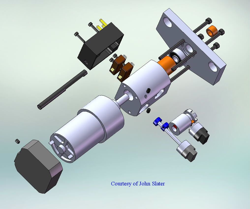

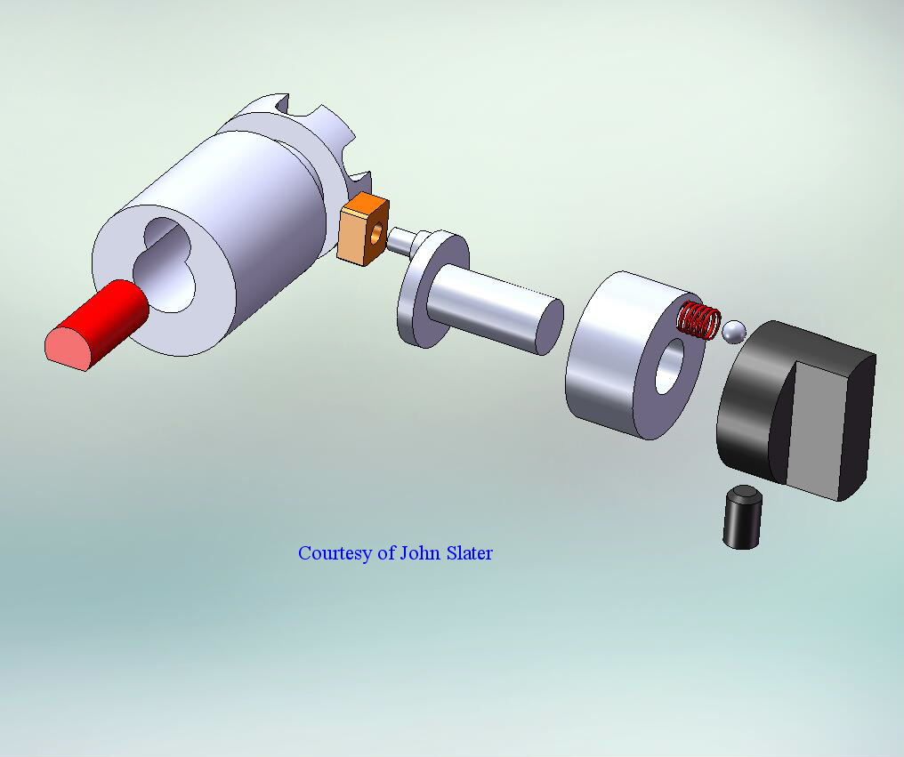

                                  John Slater has once again worked his magic on my drawings and made things hopefully a lot clearer as regards what is going on, on the inside.proxxon table feed unit assy.jpg
                                  Two simple eccentric cams work the two micro switches to give left and right feed directions.
                                  The Dog clutch is a little more complicated but both sets of Selector Knobs have a spring loaded ball to ensure the knobs stay engaged, or disengaged, during any vibration that might arise due to intermittent cutting action.
                                  Regards
                                  Gray,

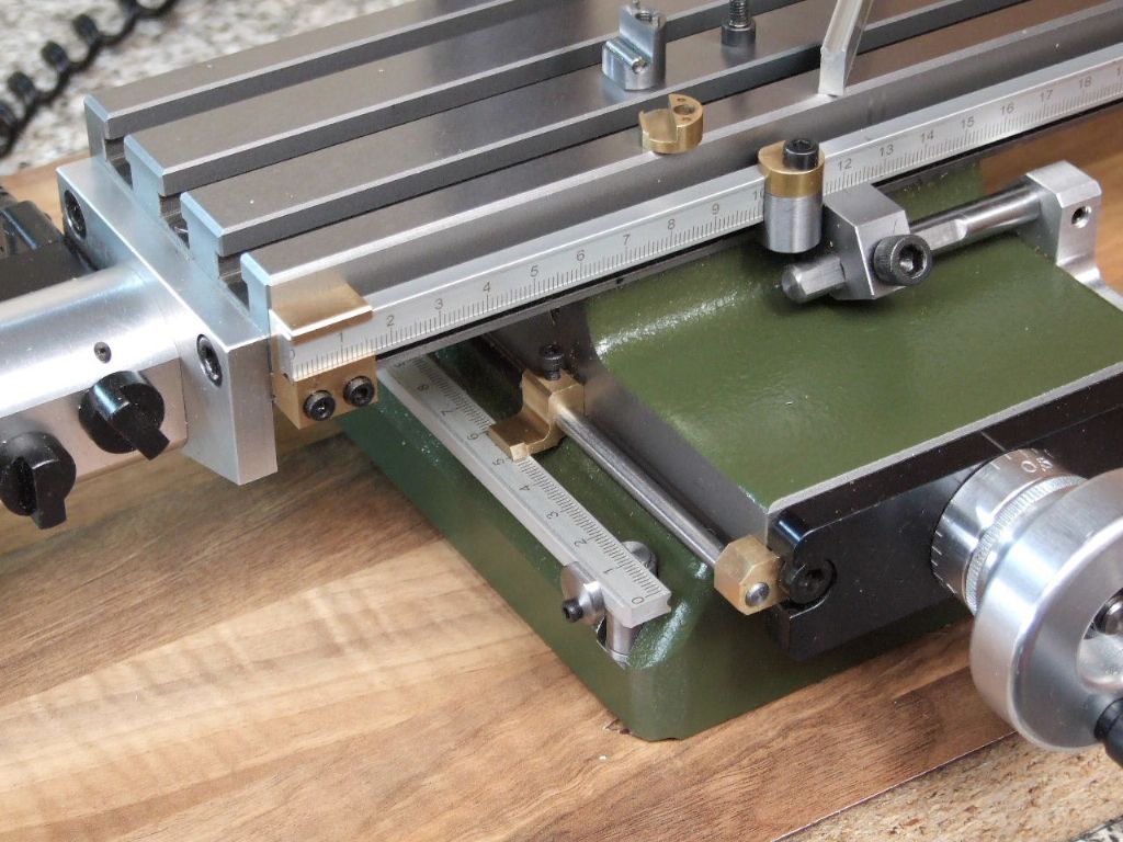

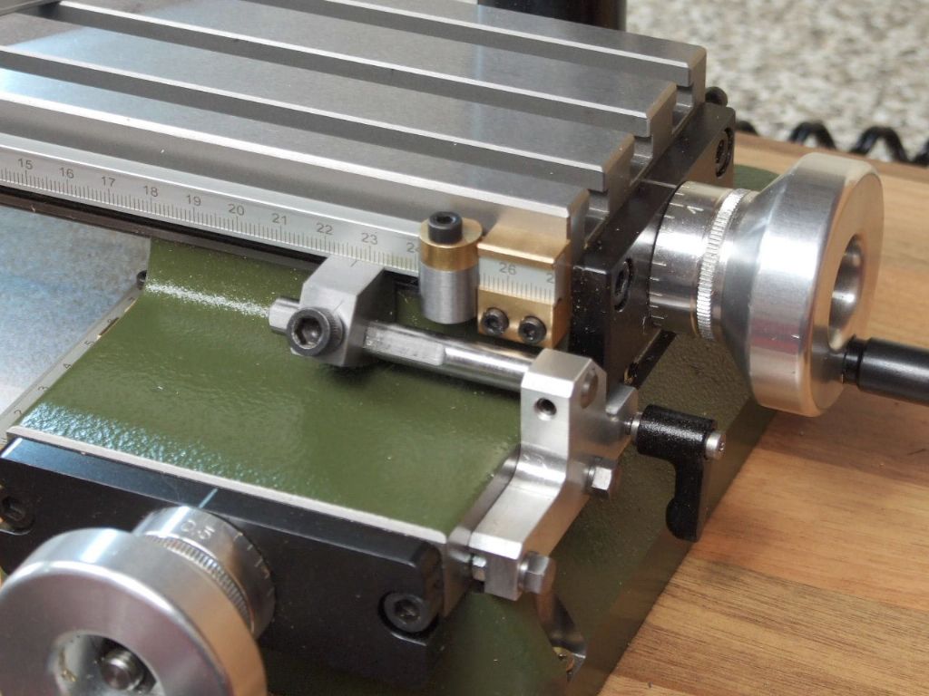

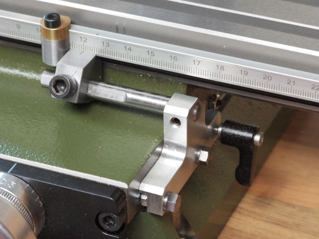

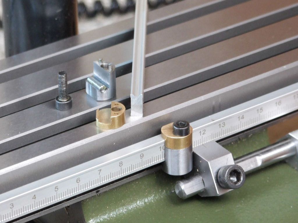

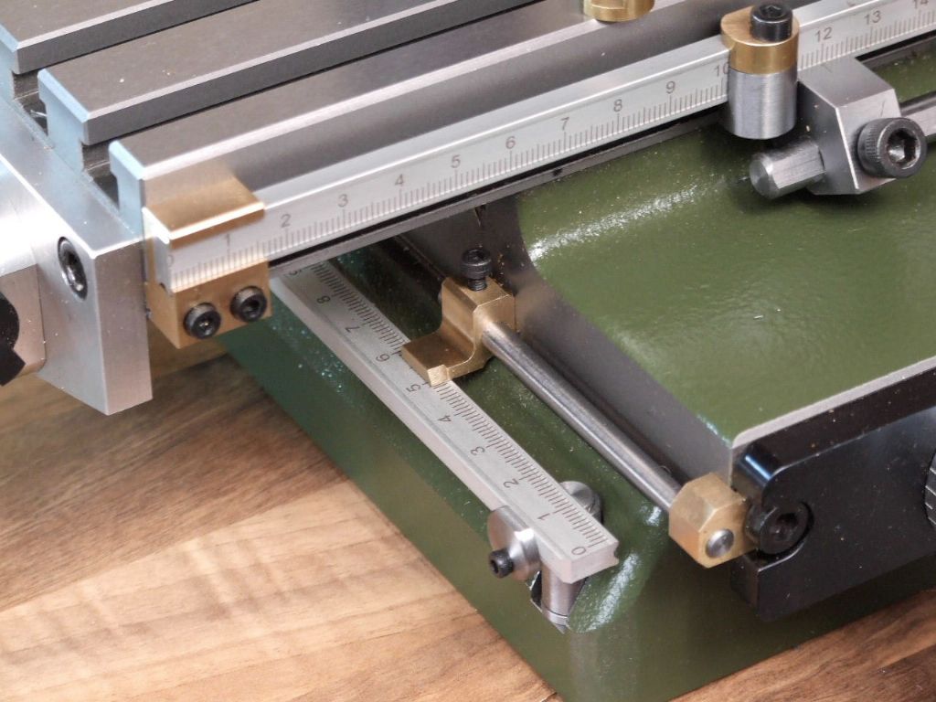

                                    It has been a while since I posted anything on the Milling machine mods so I thought I had better give you an update.
                                    This shows the fitment of some scales taken from a pair of cheap Aluminium Vernier Depth gauges. I has tried to get some 6 mm wide metric rules but these proved elusive at the time. In the end it worked out for the best as the X-axis Table Stops work better than I expected.
                                    I have tried throughout to fit these items without drilling and tapping the machine. The Y-axis utilises the mounting hold down bolt holes to hold the scale and one of the feedscrew plate retaining bolts to hold the pointer.
                                    The X-axis is piggy-backed onto the Gib adjusting screws. One Gib locknut can be seen in a clearance cut-out at the front of the aluminium bracket. The scale itself is held by two M3 cap head screws and these had to used tapped holes in the bottom of the old scale dovetail slot on the front of the table.
                                    The scales from the vernier have an inverted Vee in one face. The table stops utilise this Vee to locate a 3 mm dowel which is held in the stop with Loctite. A hook like up-stand on the brass clamp stops retains the stop during adjustment.
                                    This last view shows the brass block which holds the scale. A Tenon on the back of the block locates in the previously mentioned redundant scale slot.
                                    It may take a little tweaking to get the set-up just right but that will come with time and usage. I have already noticed I am quicker when doing a co-ordinated hole pattern.
                                    Regards
                                    Gray,

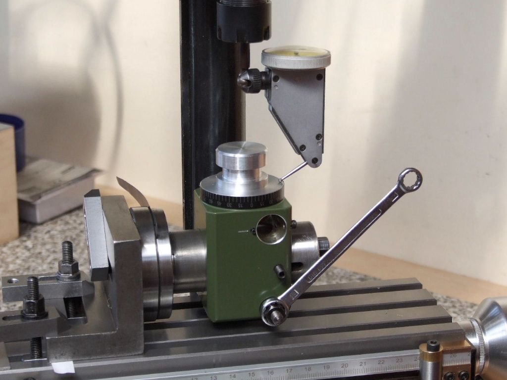

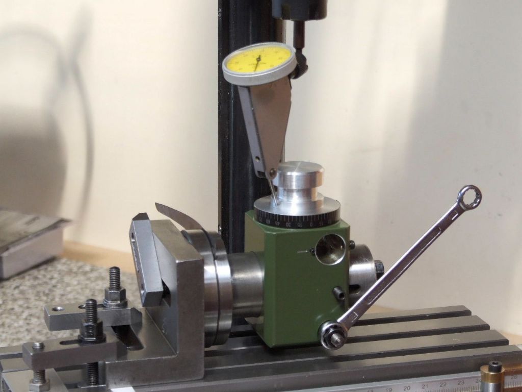

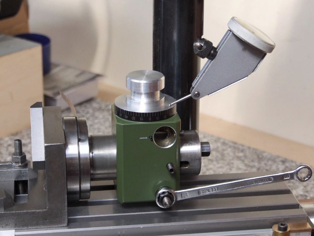

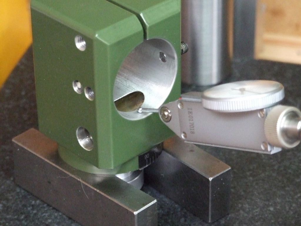

                                      A lot of the modifications are coming to an end, however there are one or two items that need rectifying. When I set this mill up for the first time. I decided to do some alignment checks. Tramming the head was a must and here I had a shock.
                                      There was nearly 0.2 mm run across the table when rotating the clock held in the spindle over the width of the table. This was not something I was expecting from Germany. Some of the run was attributed to the Column not being vertical.
                                      The column has a turned down portion on the end to fit in a hole in the base of the machine. The problem was there was 0.03 mm taper on this turned down portion. Smaller at the bottom of the column. Because two 8 mm grubscrews to the rear of the column are used to clamp the column in place. The bottom M8 screw was pushing the column over due to the taper on the spigot. This made it lean away from the operator.
                                      To overcome this I inserted a tapered steel plug inside the tubular column. This was drawn into place with an M8 piece of studding and a roller thrust race under the nut. This rectified the taper and also made the clamping area solid. The column now sat dead vertical as I would expect. Why the column is turned down 1 mm smaller escapes me. It is an un-necessary operation, why not make the hole 1 mm bigger.
                                      However the run still existed but luckily it was much less, but still more than I was willing to live with. Enter the milling head from a spare second-hand milling attachment. Clocking this head showed very little error. Thus there was a duff part somewhere.
                                      Thus it now has become the time to sort this problem out.
                                      This is the setup used to track down the error, above I am checking the first side before rotating the Quill housing on the parallels.
                                      These next two photographs show the the readings at these points.
                                      Whilst 0.04 mm might not seem a lot this is only half of the error across the width of the table. (The Quill Housing is half the width of the milling table).

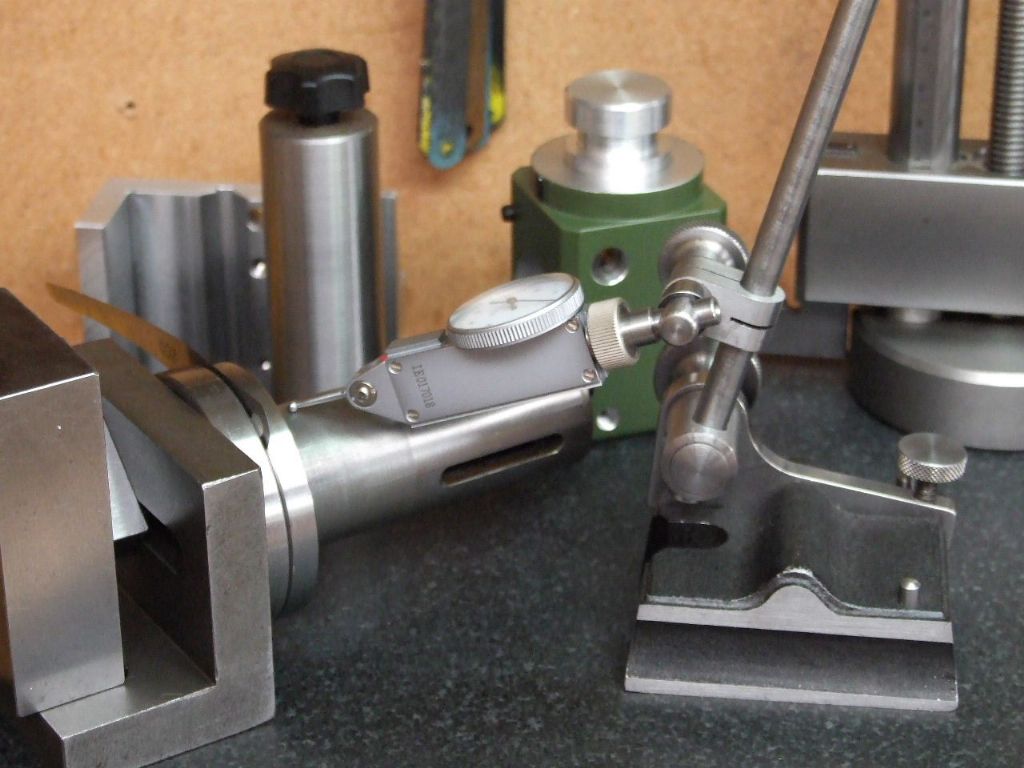

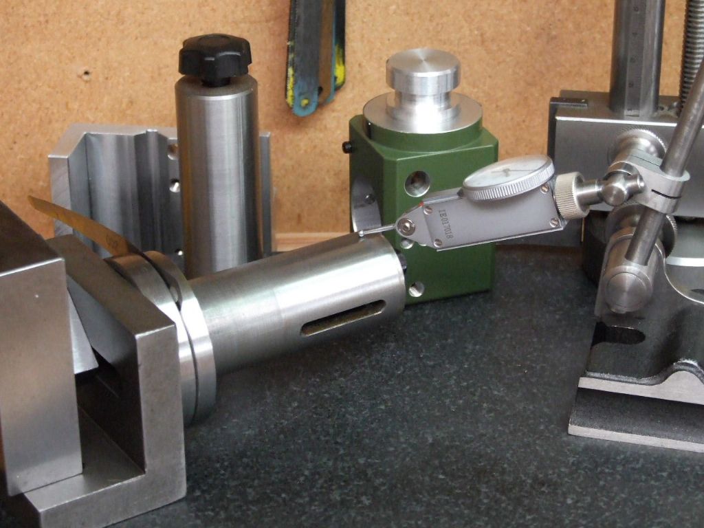

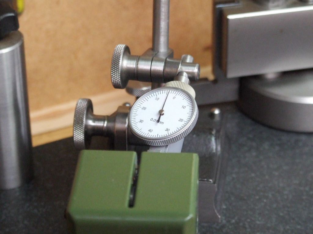

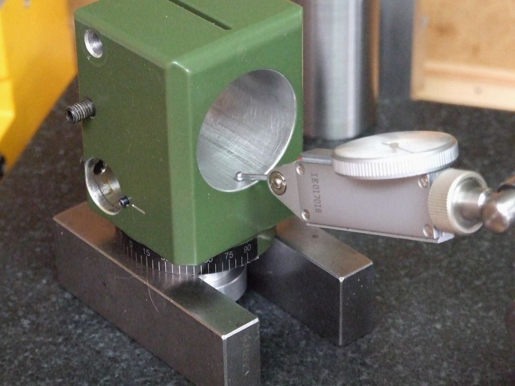

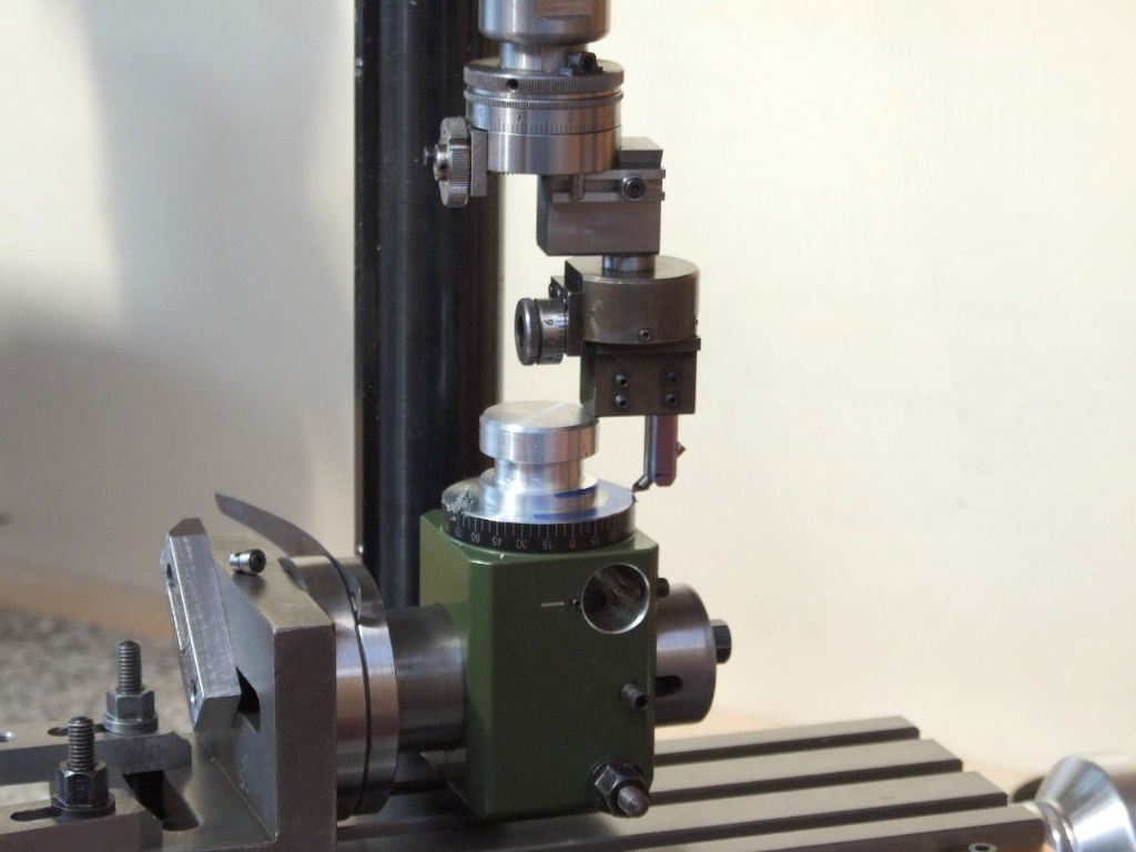

                                        To get the salvage scheme under way I decided to set the spare Quill up on an angleplate.clocking spare quill.jpg
                                        To get a Zero-Zero reading at either end of the quill a 0.05 mm feeler blade was inserted at the top of the Quill.
                                        Once the readings were the same the assembly was transferred to the milling machine table.
                                        While the reading on the surface plate was zero at both ends. When the assembly was clamped to the table there was a small error. Hence the piece of Cigarette Paper towards the rear of the angle plate.
                                        The offending part was then mounted on the quill and clocked true to the Y-axis and locked.
                                        The next check was to see if the initial run-out was in the same direction as it was on the surface plate, which it was. With the stylus of the clock at such an angle, the reading on the clock cannot be trusted as regards a measurement. The clock is merely being used to indicate a run-out.
                                        The last job for the clock was to bring the spigot onto the same centreline as the milling spindle.
                                        Another portion of the salvage shortly,
                                        Regards
                                        Gray,

                                              Thanks for the kind words, in an ideal world the part should have gone back.
                                              Unfortunately post Brexit things from the continent now take months instead of days. I had waited 3 months for the milling table base to go with the vertical attachment I already had. In the end I purchased a complete machine.
                                              Thus getting a part replaced under warranty would just take too long in my book. There is also the chance that the replacement will be no better.
                                              The actual amount of material removed was miniscule to correct the part, but I am not impressed with my set-up. It was hoped to machine the offending face of the component using my homemade boring & facing head. While the head had sufficient travel to do the job in hand, the head would not extend far enough.

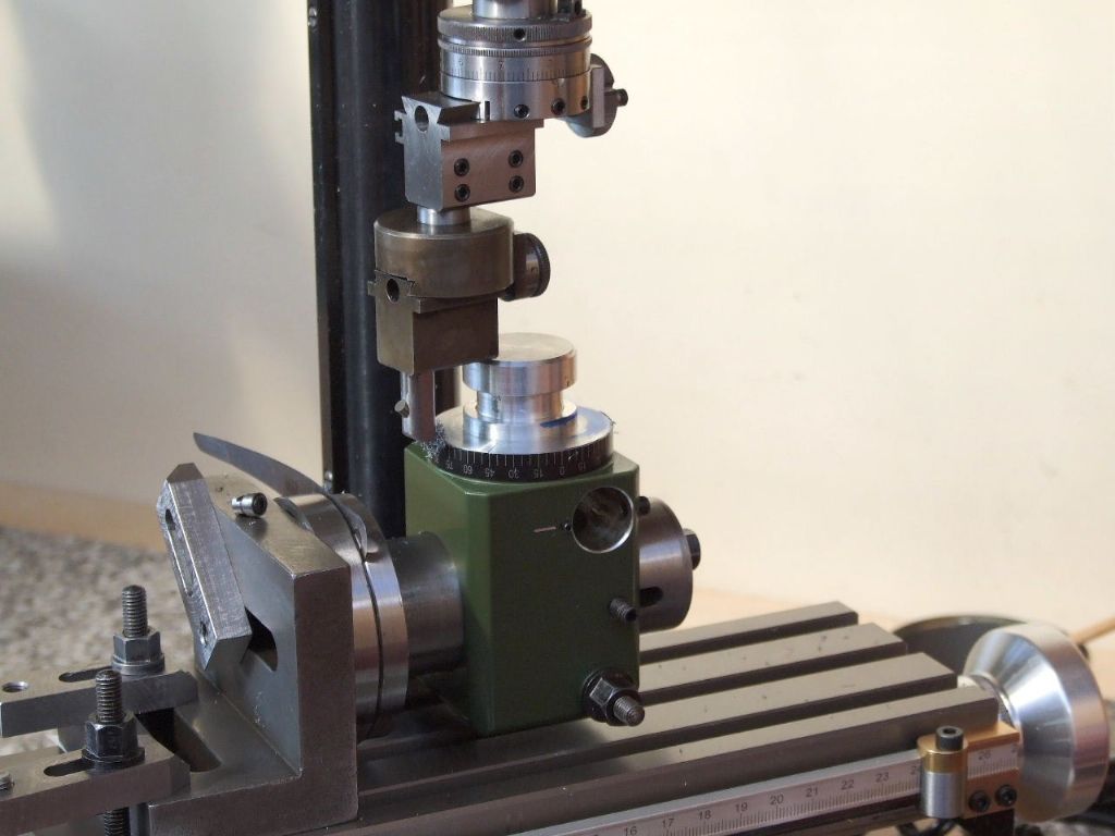

                                              As the Proxxon is now my only working source of milling machine, (The Unimat 3 is still waiting for attachments), it was either strip the set-up down and make an extension holder for the boring bar, something that is now underway. Or adapt something to extend the range of the existing boring head.
                                              I have had for some time a small manual boring head. This has a detachable 12 mm shank, so a new 8mm one was made and the additional boring head offered up. At the bottom speed of 280 RPM I was expecting the machine to throw a wobbly, but it did not show any signs of complaint.
                                              Whilst the set-up had more overhang than I would like it performed the job in hand to my satisfaction and produced an excellent finish. The swarf can be seen on the boring bar.
                                              Re-assembling the milling machine it would be nice to say it was perfect upon re-checking. I had decided I would accept a total run-out of 0.05 mm. Luckily it was less than this at max error of 0.01 mm, thus a mornings work including the photo session was well worth the effort.
                                              After all I had a result the same day. Despite the poor engineering of the machine it is still a good design and works well given its diminutive size. The Proxxon School Report would read "could have done better"
