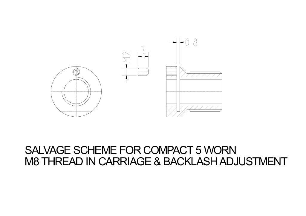

      I have also completed the salvage of the M8 feedscrew thread in the Old carriage. While doing this an idea came to me as regards a combined repair and backlash adjustment insert.
      Compact 5 Salvage
      It will mean some loss of travel, but this can be restored by making a thinner Aluminium distance piece similar to the one shown in the photograph below (above the feedscrew).
      Compact 5 extension
      This only needs to be about 6mm thick to restore the cross-slide to the correct position. Ideally a new feedscrew also needs to be made which is 6 mm longer. This will restore the cross-slide travel to the original settings.
      Drawings to follow on all the parts needed for this repair and those needed to fit a New Carriage.

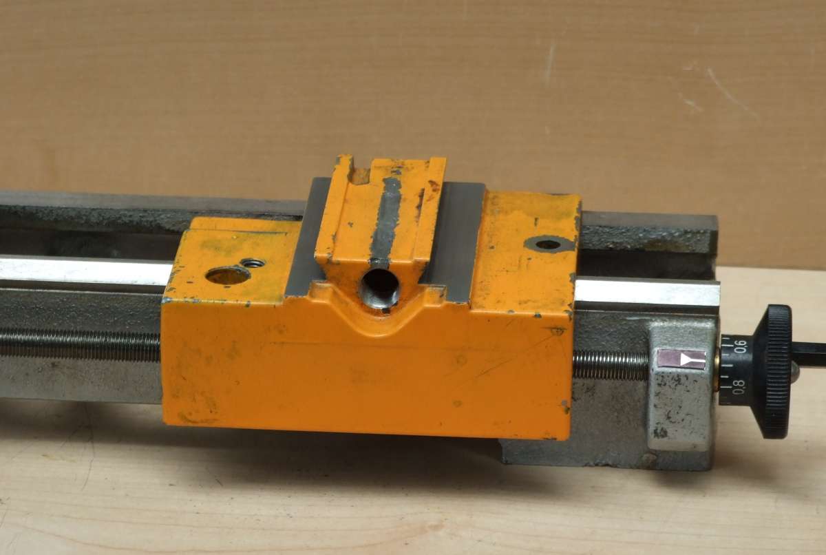

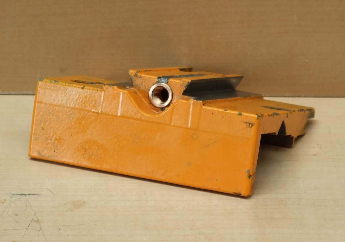

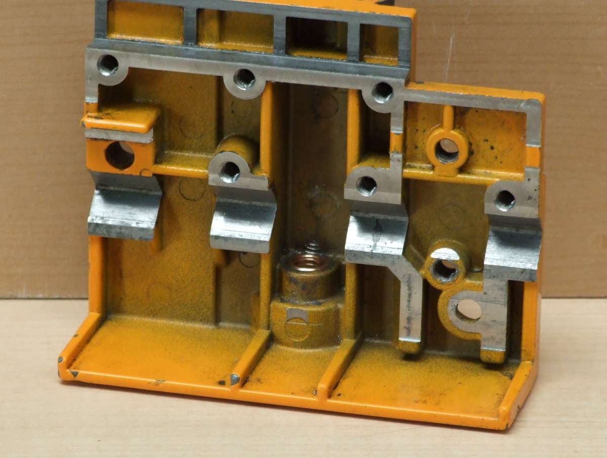

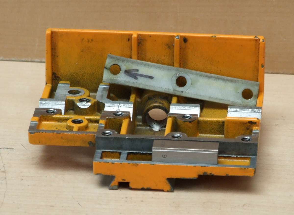

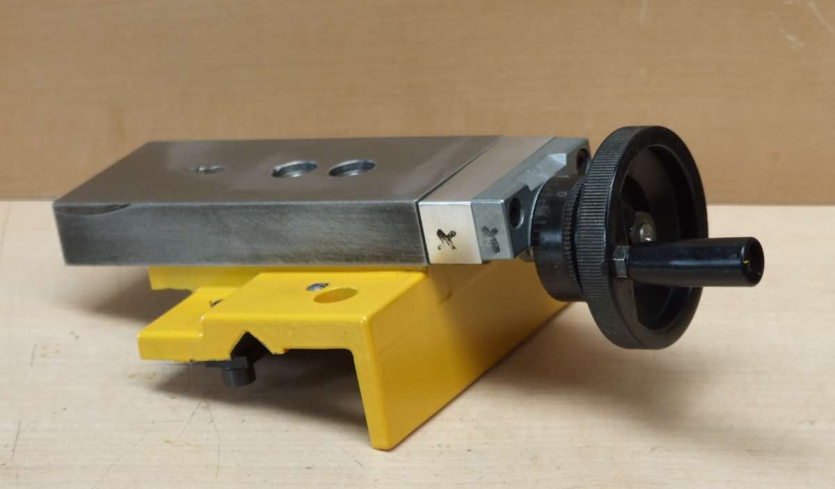

        I have finally had a chance to take some photographs of the progress on Roy’s C5. I will deal first with the salvage of the Old Carriage.
        Checking over the casting to see what was worn I was surprised to see only 0.01 mm maximum out of parallel between the Vee-way and the Flat-way to the rear of the machine.
        There is a dimension from the flat to the surface where the Plastic Gib strips bolt to. This should be 7.05 mm and due to the wear on this machine it was actually 7.20 mm.
        DSCF2817
        Thus the surface where the Gibs bolt to needed to be machined to establish the 7.05 mm dimension, see Slip gauges above. Also note in this shot the split at the end of the plastic gib. This is due to overtightening trying to take up the wear.
        DSCF2821
        This gives another view which shows the replacement thread is fitted. This shot also shows the wear on the Vee-way, two pencil marks on the way to the right of the new thread shows the extent of the wear, and also the machine marks left by the endmill when establishing the 7.05 mm dimension.
        DSCF2816
        This shows the carriage fitted to a brand new Unimat 4 Bed. This checks the Gibs are doing their bit and that there is no movement other than up and down the bed when the Gibs are adjusted correctly.
        DSCF2822
        This last photograph shows the replacement thread fitted. There will be about 1 mm loss of travel with this design.
        Regards
        Gray,
        #841739
        Graham Meek
          @grahammeek88282

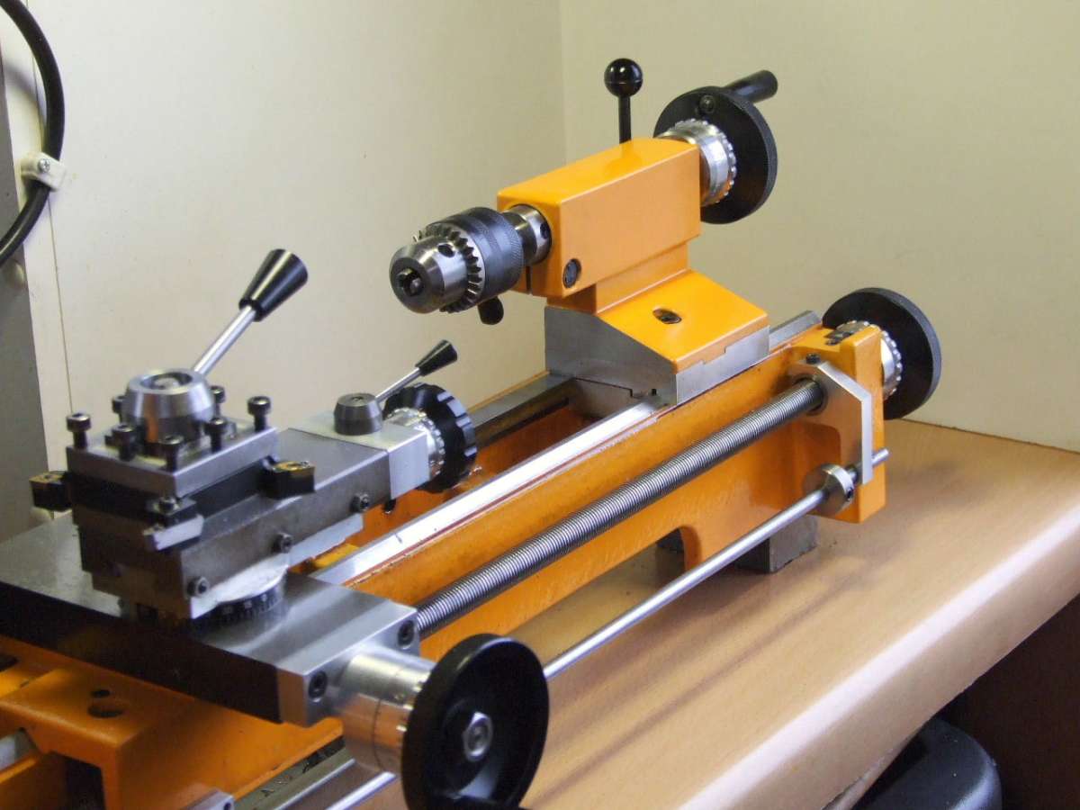

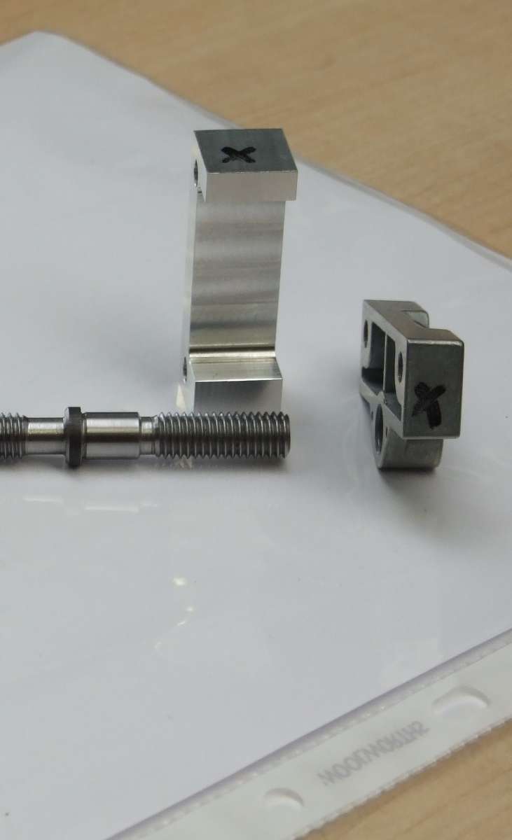

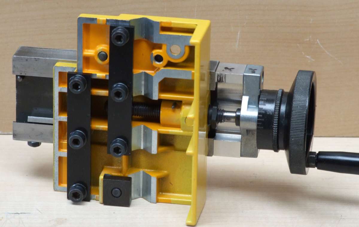

          Lastly here is the finished New carriage with the parts which I made earlier in this post fitted.
          DSCF2823
          DSCF2825
          In this view it is possible to make out the 2 mm Dowel in the yellow portion of the casting. This is to stop the Nut rotating when the adjuster screw is moved. It is half in the casting and and half in the Phos Bronze nut. Also note the new Plastic Gib strips which needed replacing due to the cracks in the Old Gibs shown in the previous post.
          I still have the drawings to finalise and hopefully Jason will post these in PDF format in due course.

            You determined a wear of 0.15mm of the carriage surfaces in contact with the bed. I assume you could measure the height difference between “gib surface” and “bed surface” being 7.20mm. But how did you measure the value of 7.05mm? Or is this a reference value measured on a new carriage?
            And then, is the “vertical” wear of the flat surface and the V-surface expected to be the same?
            Next question: how did you mount the carriage on the cross table of the milling machine? Was the C5 cross table on the carriage and was its top surface used as a reference for horizontal mounting?
            Kind regards,
            Jouke
            #841751
            Graham Meek
              @grahammeek88282
              Hi Jouke,
              To check the casting I place the two flat Ways of the cross-slide dovetails on parallels, on the surface plate.
              I know from experience, (see https://www.model-engineer.co.uk/forums/topic/emco-compact-5-modifications/page/2/    ) with C5’s. That the relationship between the flat surface at the rear is such that if a 10 mm diameter Roller is placed in the Vee-way. Then the dimension from the top of this Roller to the Flat way is 10.45 mm.
              This then ensures the cross-slide Ways are moving parallel to the bedways and the theoretical Horizontal centre-line of the Lathe axis, ie perpendicular to the lathe longitudinal centre-line, (Headstock to Tailstock).
              The 7.05 mm dimension is taken from 4 new Carriages that have passed through the Meek Workshop. They have all been spot on this dimension.
              I have a jig made from an Emco Unimat 3 Cross-slide, which is mounted on an 80 mm square piece of Aluminium Tooling Plate, (Flat to within 0.025 over a 300 mm Square). This has the dovetail of the U3 cross-slide uppermost. Thus the C5 Carriage can be loaded onto this and locked using the U3 Locking mechanism and Gib adjusting screws.
              Before machining starts the 10.45 dimension is verified to ensure the Carriage is sitting in the U3 cross-slide correctly. It is then a simple matter to machine the Gib surface with reference to the 7.05 mm Slips.
              I hope this helps,

                  The threaded Phos Bronze bush fitted to the Old Carriage is the first solution. I offered the Anti-backlash solution shown at the top of this page above for those who might want to have this facility. I do not intend making this version as I know this will work, plus other things have arisen which makes this impossible now.
                  Regards
                  Gray,

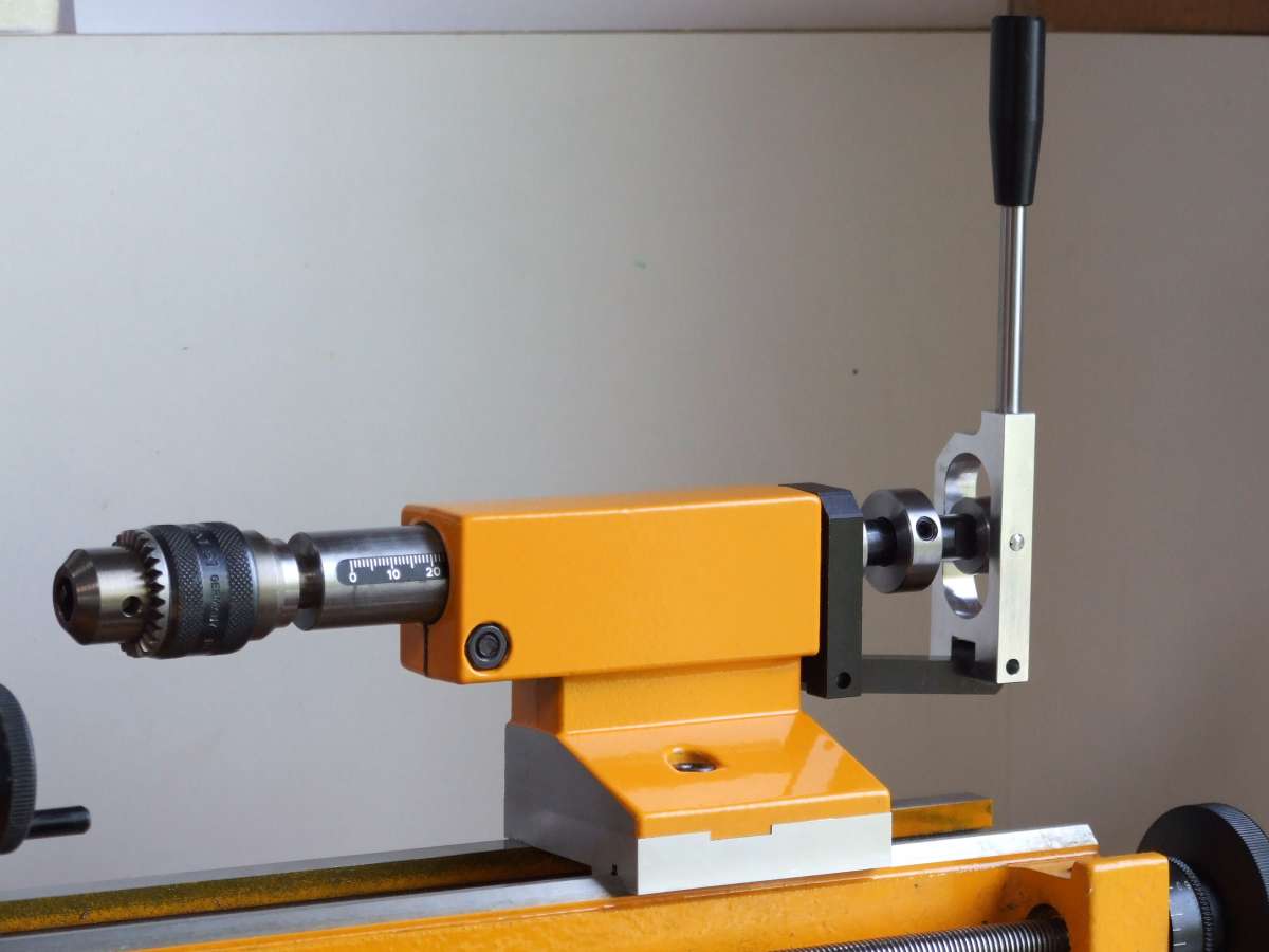

                    Did you ever design a lever operated tailstock for the Emco Compact 5?
                    Kind Regards
                    Roy
                    #841793
                    Graham Meek
                      @grahammeek88282

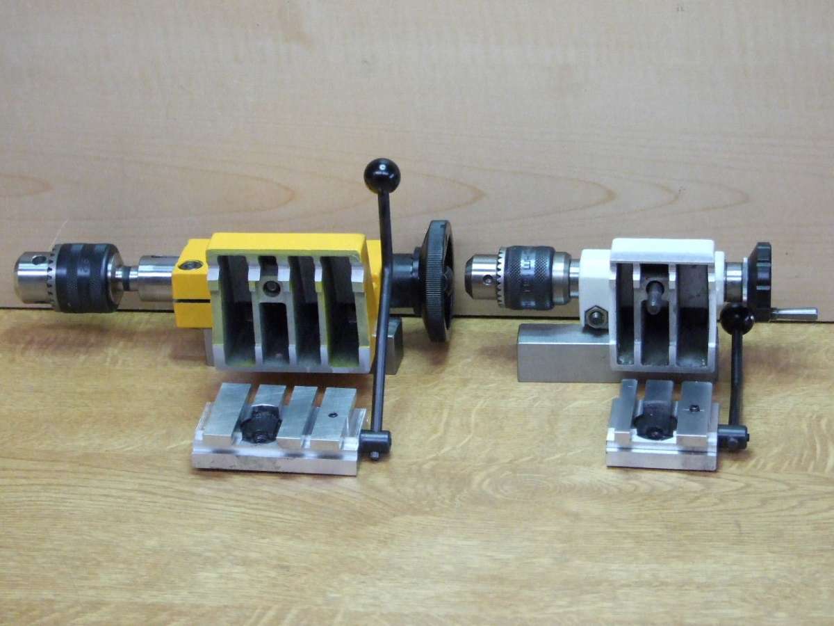

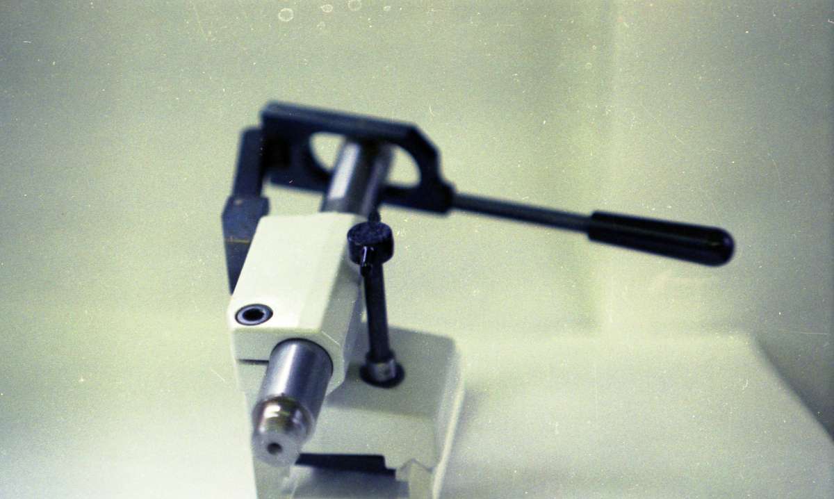

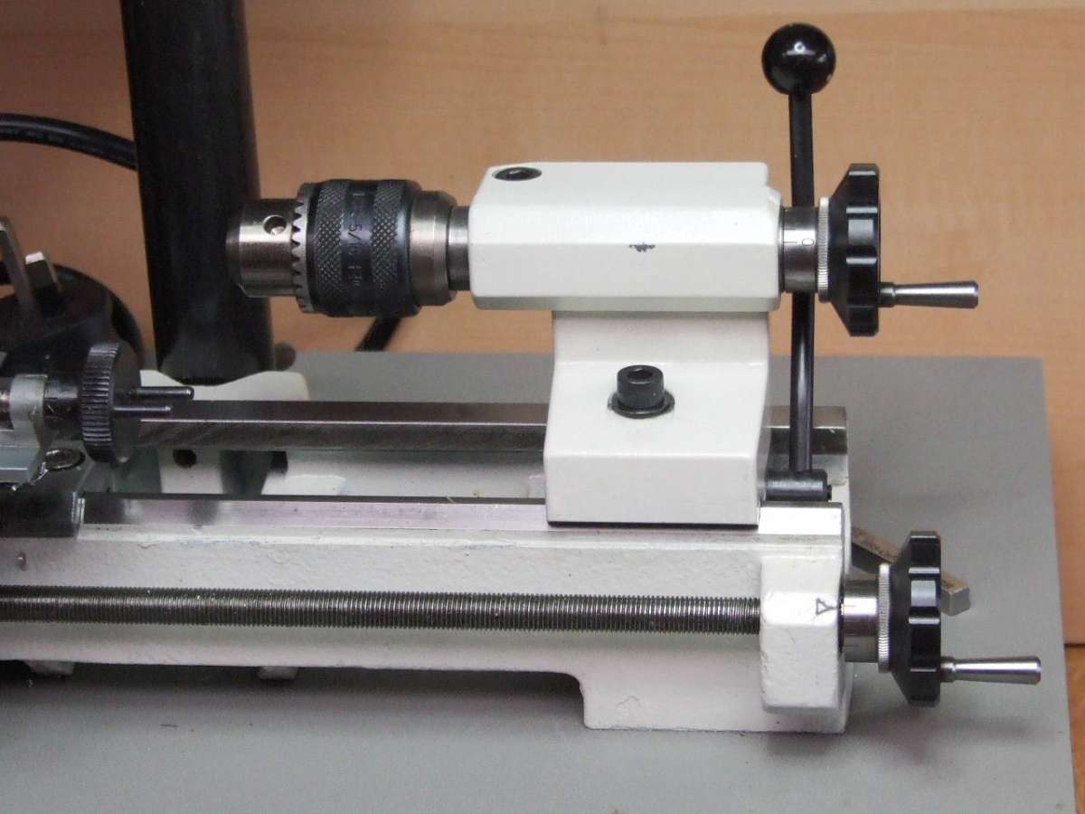

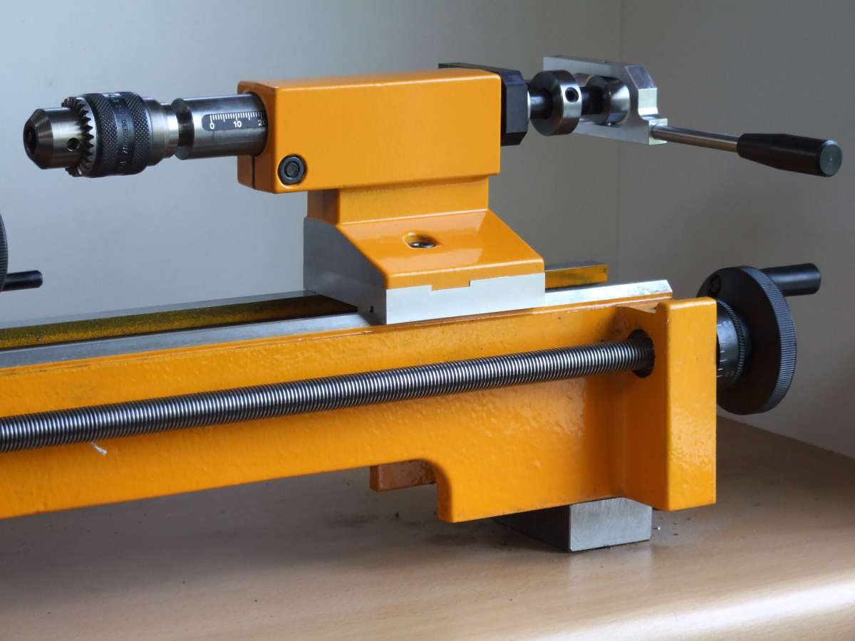

                      Hi Roy,
                      The Lever Operated Tailstock comes in two guises. The actual Lever Feed for the barrel, (which was originally designed for the Unimat 3).
                      Fig 1 Unimat 3 lever operated tailstock, apologies for picture quality taken from 35mm negative
                      Fig 7 Attachment in vertical position.Fig 6 Attachment in horizontal position.
                      Or the Lever Clamping Attachment which does away with the need for the Allen key or Adjustable Lever handle.
                      My C5 Lever Clamping TailstockTailstock Body fitted
                      There is one more photograph of the latter parts which I need to load in a new post.
                      Regards
                      Gray,
                      #841796
                      Graham Meek
                        @grahammeek88282
                        The missing photograph,
                        Assembled parts about to be fitted to Tailstock Bodies
                        (There was a spare version of this in the box of parts)
                        Regards
                        Gray,

                            The thread on the outside of the PB Bush is M11x1 P. This was screwcut at the same time as the M8x1.25 P feedscrew thread was produced for absolute concentricity and squareness. The 45 degree chamfer for the locking face is also machined at this time.
                            The Old Carriage was mounted against an Angle Plate bolted to the milling machine table. Two parallels were used which located the flats of the Cross-slide Dovetail Ways against the Angle Plate. A parallel on the milling machine table located the machined upstand of the Bedway rear Flat Way, this is the face behind the slip gauges.
                            DSCF2817
                            This keeps everything square.
                            A spigot was then turned which was a good fit in the core diameter of the worn thread. This then gives something to “clock” to get the milling machine spindle aligned with the old thread. A 10 mm diameter slot drill was then used for the tapping size. A 90 degree countersink was then used to provide the locking face for the PB insert. The last operation is to tap the hole using the machine spindle to ensure squareness.
                            Regards
