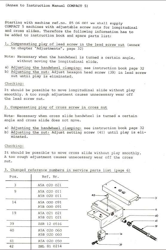

            #835779
              Graham asked me to post these images of an early and later Compact 5, the later shows the provision of adjustable nuts which an insert would not give.
              c5-1
              c5-2

              Roy Birch
                @roybirch29994
                I presume that I would then need parts 39,40,41, and 42 to hold part 40 in place?
                #835786
                Roy Birch
                  @roybirch29994
                  I would also need the instruction book that covers the set up for the adjustable backlash nut as all I have is a pdf that covers my lathe which did not have this setup.

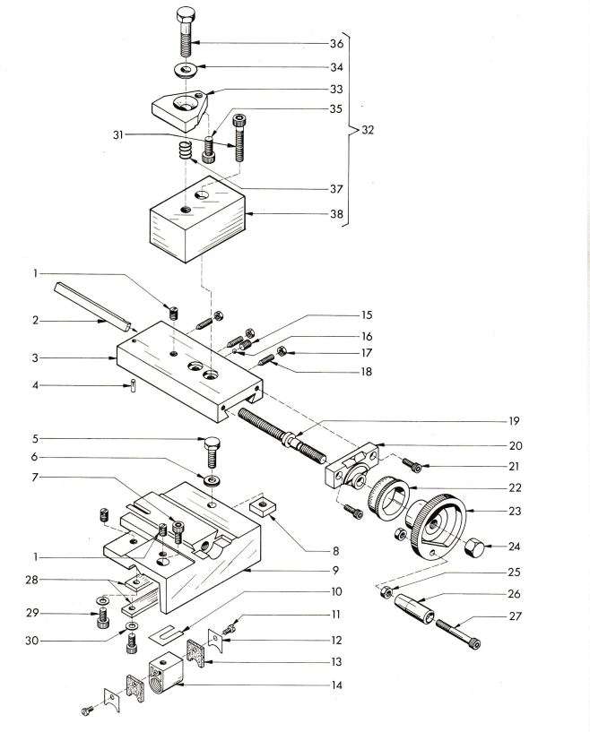

                  #835791
                  Roy Birch
                    @roybirch29994
                    looking at the diagram, I see that part 40 goes into the front of the carriage, it appears to have a groove and it looks as though a screw or pin part 42 holds this in place, The new carriage that takes all of this does not have a hole where part 42 goes so does anyone know how you place this hole, a picture of the new carriage is below, or am I reading this wrong?

                    #835792
                      That guys ebay listing says they are for the compact 5 PC not the manual machine.

                      Graham Meek
                        @grahammeek88282
                        The part number listed is the correct one for the Compact 5.
                        The groove shown in the drawing is in fact a slot, (one of two), which allows the nut to be compressed thereby adjusting the backlash. The pinhole is drilled on assembly. Although on the machined from solid version of the Carrige which Jason has shown above this hole is predrilled.
                        The only other Carriage I have seen is the one for the C5 CNC which is made from cast iron and uses a ball screw and stepper motor for the Cross-slide. This is the same set-up that is used I believe on the Emcoturn 120 Slant bed.
                        Regards
                        Gray,

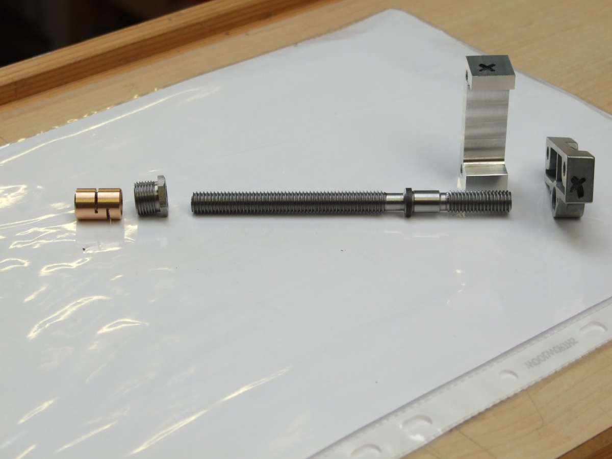

                          #838022
                          Graham Meek
                            @grahammeek88282

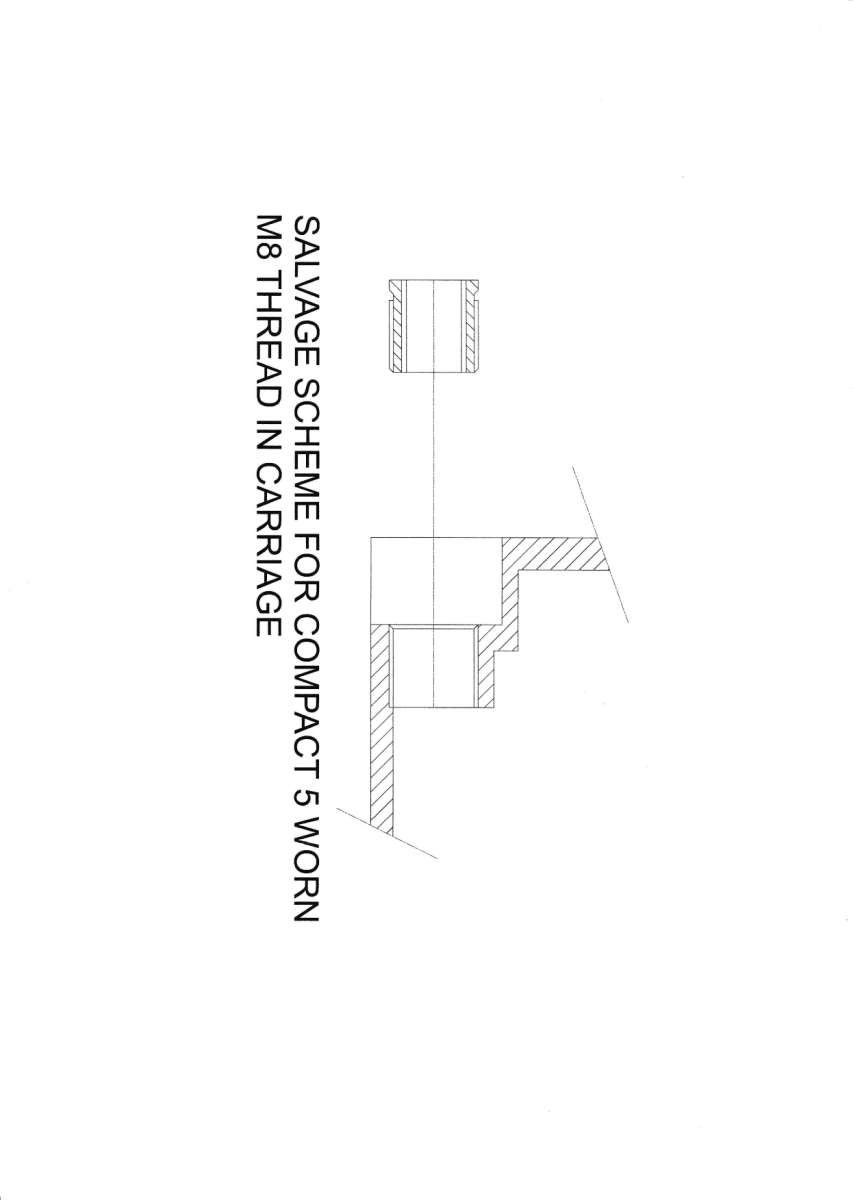

                            Over the past couple of days I have been making the parts required to fit the latest C5 Carriage to the Old Style C5 lathe which has the Cross feedscrew thread actually in the Carriage. As Roy’s lathe is above. The parts actually took about 6 hours to make for those who are interested.
                            Conversion Parts
                            The Emco End Plate is of course already in existence, it is shown so that the relative position of the Packing Piece is clear. The photograph shows the Packing Piece is handed, i.e. this will only fit the one way due to the cross-slide dovetail being off-set to accommodate the Gib Strip.
                            The Packing Piece allows the use of the existing C5 Cross-slide. The newer Cross-slides are longer.
                            While a new feedscrew and feed nut are available as a spare part. The Hex Adjusting screw is not. I guess the spare  feedscrew and nut were only really intended to be fitted to an existing machine with the latest Carriage assembly.
                            Once I have proved to my satisfaction that the parts are correct for fit and function. I intend with Jason’s help to post the drawings for all the parts on my “Emco Compact 5 Modifications” post on this forum.
                            When the new Carriage arrives I will show the complete assembly.

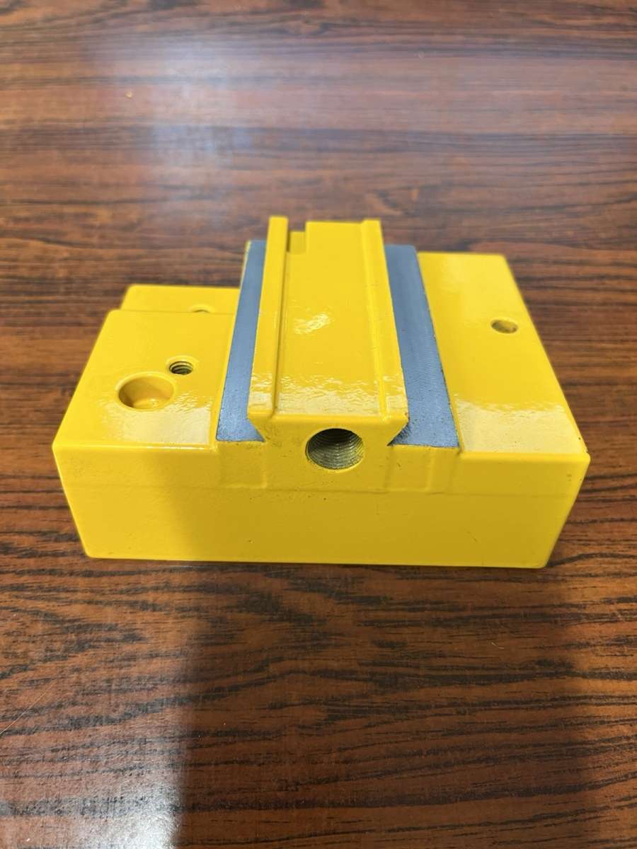

                            #840159
                            Graham Meek
                              @grahammeek88282
                              Just a quick note to say I now have an old style C5 Carriage to work with and I have come up with a workable salvage scheme which I hope to implement over the coming couple of weeks.
                              C5 Salvage scheme
                              Regards
                              Gray,

                                #840233
                                Graham Meek
                                  @grahammeek88282
                                  The sample carriage that I have has worn to such an extent that I can pass a 7.5 mm drill shank through the tapped M8 hole. The Feedscrew is 7.9 mm outside diameter. This gives 0.2 mm of engagement on each side of the thread, provided the screw remains central. If it drops to the bottom where it might be in full engagement the crests of the top of the thread will be in fresh air.
                                  This replacement Nut will be far easier to replace when worn. Plus it returns the lathe to the original status.
                                  The Backlash elimination above is an Emco design change, which over comes the problem of the worn thread and provides the luxury of backlash adjustment. Repairing the worn thread at the moment is my priority for other users.
                                  Regards
                                  Gray,

                                    #840341
                                    Kiwi Bloke
                                      @kiwibloke62605
                                      That looks neat! I’m a bit surprised that there’s enough meat in the saddle to hold the replacement thread insert, but Graham Meek certainly knows what he’s doing, so I’ll just be surprised… I guess that the thread insert could be split, so that there’s an adjustment and backlash-reduction facility, if the insert halves can be prevented from rotation.
                                      #840348
                                      Graham Meek
                                        @grahammeek88282
                                        While a backlash facility would be nice. The problem comes with using a worn feedscrew. Most of the wear on the cross-slide feedscrew is going to be when the cross-slide is on it’s inner most travel. Thus if the backlash is eliminated at this point then the feedscrew will not be able to come out of the nut totally as the outer end of the feedscrew is larger.
                                        The only way this anti-backlash system is going to work is with a new feedscrew.
                                        Having tried the old feedscrew in the tapped hole of the Phos Bronze nut shown above it is not that loose which is really surprising.
                                        Regards
                                        Gray,

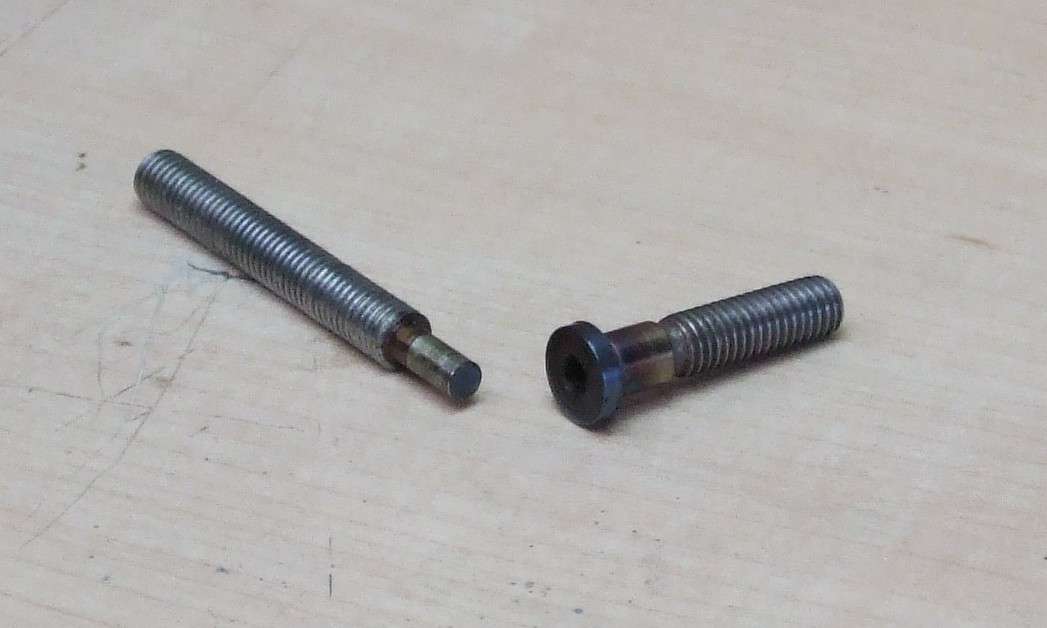

                                                Well Roy we need not speculate any further. I have taken the liberty of applying a little heat to what I suspected to be a joint.
                                                C5 Feedscrew
                                                This view shows that the feedscrew was made in two parts and the roughness of the thread can just be seen in this view.
                                                Regards
                                                Gray,

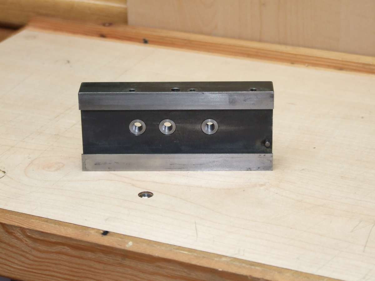

                                                #840534
                                                Graham Meek
                                                  @grahammeek88282

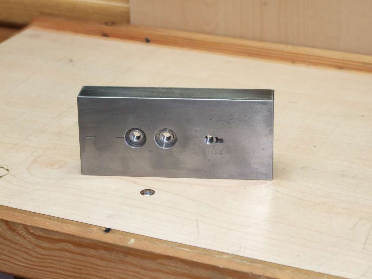

                                                  The Cross-slide on Roy’s C5 lathe has had a hard life. The M6 tapped holes which retain the Topslide, (aka Taper Turning Attachment), the Machine Vice or the Milling Table have at sometime all been stripped.
                                                  A repair had been made with Helicoil wire inserts. As I have mentioned earlier, or elsewhere, these are in my mind only intended for semi permanent attachment purposes, not for repeated disassembly. The effect on the cast was such that the Helicoil thread itself had failed in one hole and where the insert was still in the hole it was only attached at either end of the thread. The centre portion acting like a compression spring in a drilled hole.
                                                  DSCF2803DSCF2802
                                                  The above photographs show my solution to this problem which I know others have had.
                                                  The existing holes were clocked from above so that the new thread was concentric. The holes were first of all opened up with a slot-drill before drilling and reaming 8mm diameter.
                                                  Turning the part over in the vice the underside of the holes were counterbored 10.5mm diameter by 1.2mm deep, this dimension is kept constant. Two different lengths of threaded M6 Top Hat bushes were turned from 10mm diameter High Tensile steel to be a press-fit in the holes.
                                                  This will be the 3rd cross-slide I have repaired in this way and I have had no reports of any failures so far. Of course if a thread is stripped then it is a simple matter to press the old part out and press in a new one.
                                                  Regards
                                                  Gray,
                                                  #840559
                                                  Ian P
                                                    @ianp
                                                    On Graham Meek Said.
                                                    Regards
                                                    Gray,
                                                    In my experience wire thread inserts (often Helicoils, but there are others) are mainly used for two reasons, one is to provide a stronger fixing for the same bolt diameter often in softer materials, the second reason is to provide a robust threaded hole for fixings that need to be frequently removed and replaced.
                                                    I’ve never come across an insert only attached at either end, I would presume it was very poorly installed.
                                                    Ian P
                                                    #840572
                                                    Graham Meek
                                                      @grahammeek88282
                                                      Hi Ian,
                                                      I don’t doubt for one minute that what you are saying is correct.
                                                      My experience with Helicoils starts with the Fuel System bodies for jet engines. At each Fuel System overhaul the inserts were removed and replaced. In other words single usage. The installation of the new inserts was done to the book in this instance and every “Tang” had to be accounted for.
                                                      There have been two other occasions that I have used them with success. One to repair a stripped sparkplug hole in a cylinder head and the other to repair two stripped tapped holes in the Unimat that I renovated elsewhere on the Forum.
                                                      Those repairs that I have come across during my working career on Production Tooling, drill jigs, milling and assembly fixtures, has always been after a failure. Such tooling can be used many hundreds of times in a day. In every case the mating thread was so badly worn it had to be replaced. As well as a permanent repair to the offending tapped hole.
                                                      Like the above I cannot say if the inserts were installed correctly or not. As regards the Cross-slide both the remaining inserts were flush with the surface. On the Fuel System bodies, and those repairs I did myself, the inserts were always inserted one and a half threads below the surface.
                                                      Regards
                                                      Gray,
