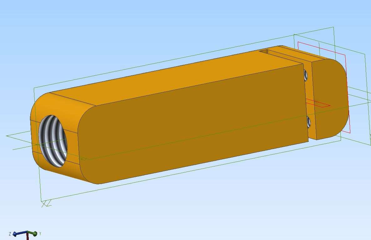

                                      So you are doing it more for the need of wanting less backlash rather than an unusable machine and you have the  option to do any milling on one of the Myfords.
                                      I’m not sure how backlash free a fit you will get with a helicoil and at just under 10mm major dia for the tap could get quite close to the top of the carriage.
                                      Having engaged my brain for both you and Kiwi’s benifit If there is a real need to eliminate backlash as much as possible then I might get a bit more drastic ( I”ve not got one to check ifthere is enough metal but should be no more than a helicoil would need. Assuming your carriage is much like the one in Gray’s thread then I would open out the existing thread to clear the M8x 1.25 screw. Then mill a pocket to a depth of 1mm below the nominal 8mm of the existing hole with say a 6mm milling cutter as that will go deep enough. Some M2 clearance holes from below will also be needed placed where they best fit.
                                      pocket
                                      Then taking a piece of bronze hill it to fit the pocket with as much material above the hole as possible, but leave it about 6mm short. Cut a slot say 5mm in from the back and tap two M2 holes through to that slot. Plus a couple more shallow M2 hole sin teh bottom positioned to best suit cap or CSK socket screws up from the bottom of the casting.
                                      Now put two M2 cap heads into the holes in the rear so they just touch the opposite side of the slot with a mm or so tread still clear out the back and mount the new nut in the pocket up against the front edge and secure in place with the screws from below
                                      Now set the csting complete with new but up on the Myford then form and thread a M8 x 1.26 hole. The two M2 screws at the rear can be used to wedge the back of the nut apart which is a commonly used way of adjusting out backlash in the screw threads. A shortened allen key will get you into the gap.
                                      c5 nut
                                      Before doing any of this worth also checking that any backlash is not down to movement of the leadscrew in the front housing rather than play in the screw/nut. usual Emco method to adjust this out is to loosen the nut in teh middle of teh handwheel and turn the handwheel on it’s thread to reduce any gap then retighten the nut.

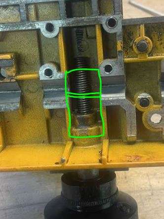

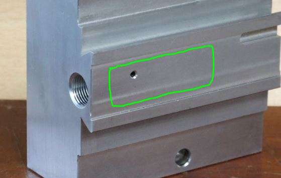

                                          The photo above shows the latest Carriage with the M12 backlash adjustment thread. The original casting has a step at the front of the Carriage to clear the collar on the cross-slide feedscrew.
                                          It could well be possible to machine the cast step and plant a replacement nut on this step. It would reduce slightly the travel of the cross-slide with the standard set-up. The status quo could be restored with a new endplate as shown in my thread on Compact 5 Modifications.
                                          Generally
                                          There might be enough material for a Heli coil repair but I am unsure how this would wear with regards to the feedscrew. It may wear the latter quicker? Heli coils in my experience have only ever been used for anchorages.

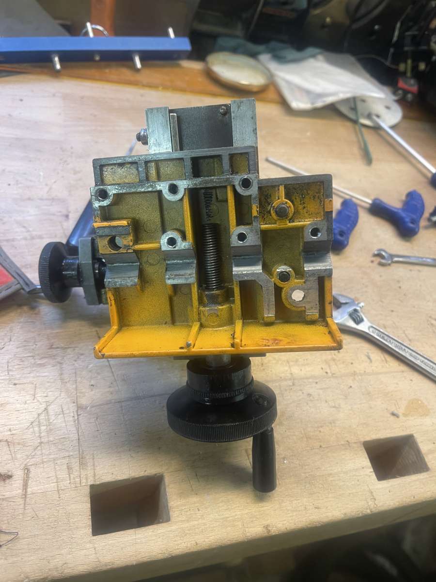

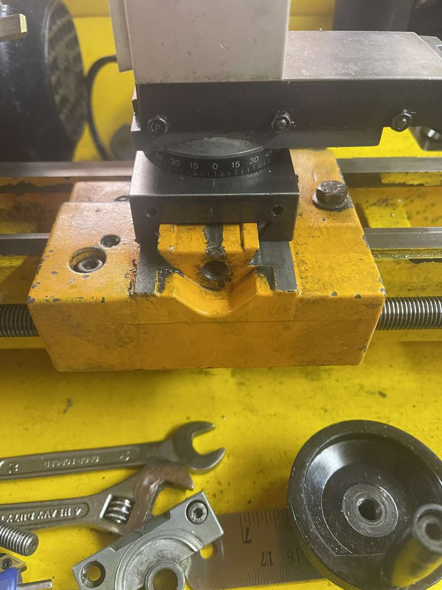

                                              This Picture shows the carriage, the nut shows sign of wear.IMG_1696 IMG_1694

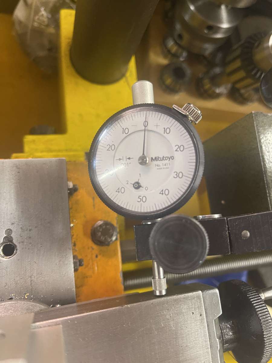

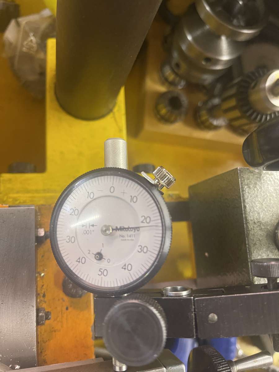

                                                These pictures show the amount of backlash which is between 20 and 25 thou.
                                                IMG_1697IMG_1698
                                                #835727
                                                  20thou backlash, I’d just get on and use it.
                                                  But from the photo you almost have a ready made pocket for a split nut similar to what I showed. Mill out some of teh existing threaded material so th enut sits towards the front and you won’t loose thread engagement. It may depend on how much clearance there is vetween th ecrest of teh vee bed and the screw though part of teh nut could be scalloped out for clearance.
                                                  under nut
                                                  #835732

                                                    I think to be fair if I could get the backlash less then the amount I am likely to use this lathe it would be unlikely to get much worse in some years, I am now considering just making a new nut similar to the Myford cross slide nut assembly and screwing it in, I know that a split nut would be good but will I ever have the need?
                                                    #835738
                                                    Graham Meek
                                                      @grahammeek88282
                                                      For my part I would be more inclined to tap the hole out a larger size, preferably with a finer pitch thread.
                                                      A headed Phos Bronze bush, which is screw cut on the outside diameter and tapped M8 would restore the thread with minimal loss of travel and ensure alignment of the two threads axially. The bush could be retained with a thread locking compound.
                                                      This method has the advantage that the bush can be made longer and there by giving greater thread engagement which in itself will prolong the life of the thread. It also reduces the amount of work needed to salvage the Carriage.
